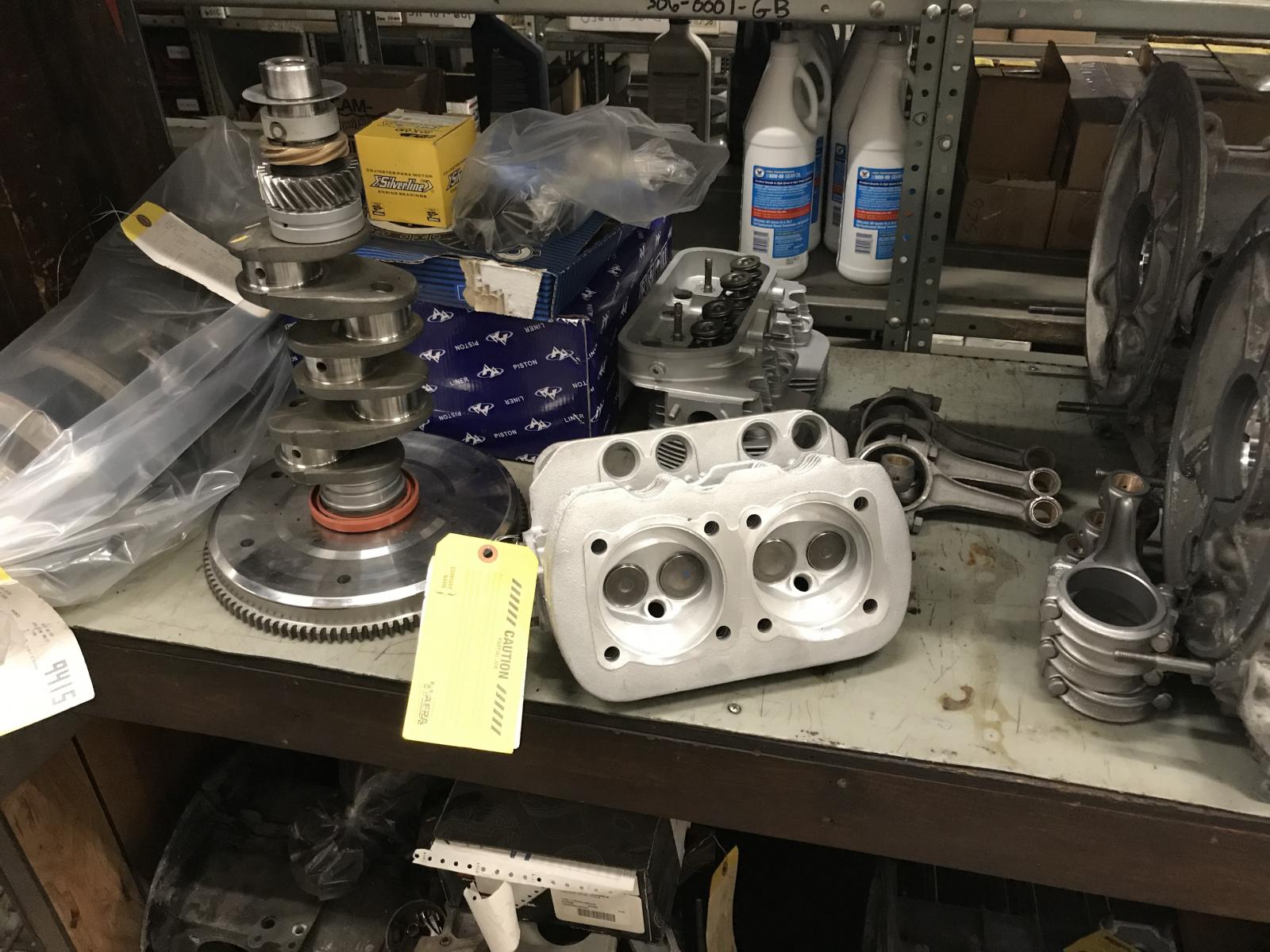

The project has been a little slow in the last few weeks, but I did pick up the engine parts from the machine shop this week and have started putting the 40HP 1200 together that will power the car. This is my first air-cooled engine rebuild and I couldn't have asked for a better machine shop. Automotive Machine and Supply in Cleburne, TX did the machine work and completely rebuilt a set of '65 373 heads I picked up on eBay for $30/ea. Now to get a running engine hung on the chassis before the body is ready to drop on.

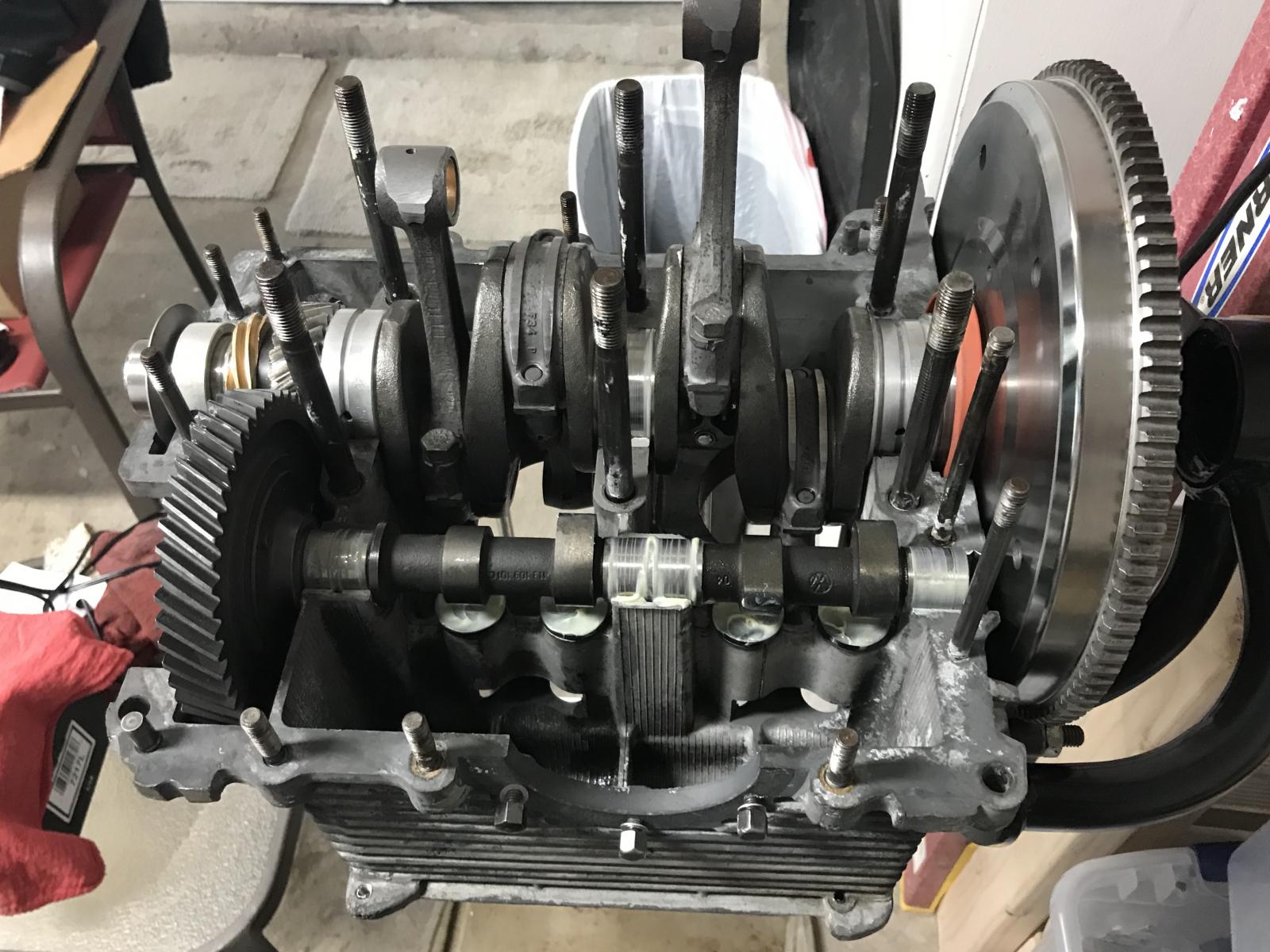

Slowly getting the 40HP back together. I got everything together and the halves joined and the upper rear camshaft stud threads were trashed. I tried to repair them while the case was together, but just couldn't. I decided to pull it all back apart, repair the threads, clean all the internals, and have a second go at it.

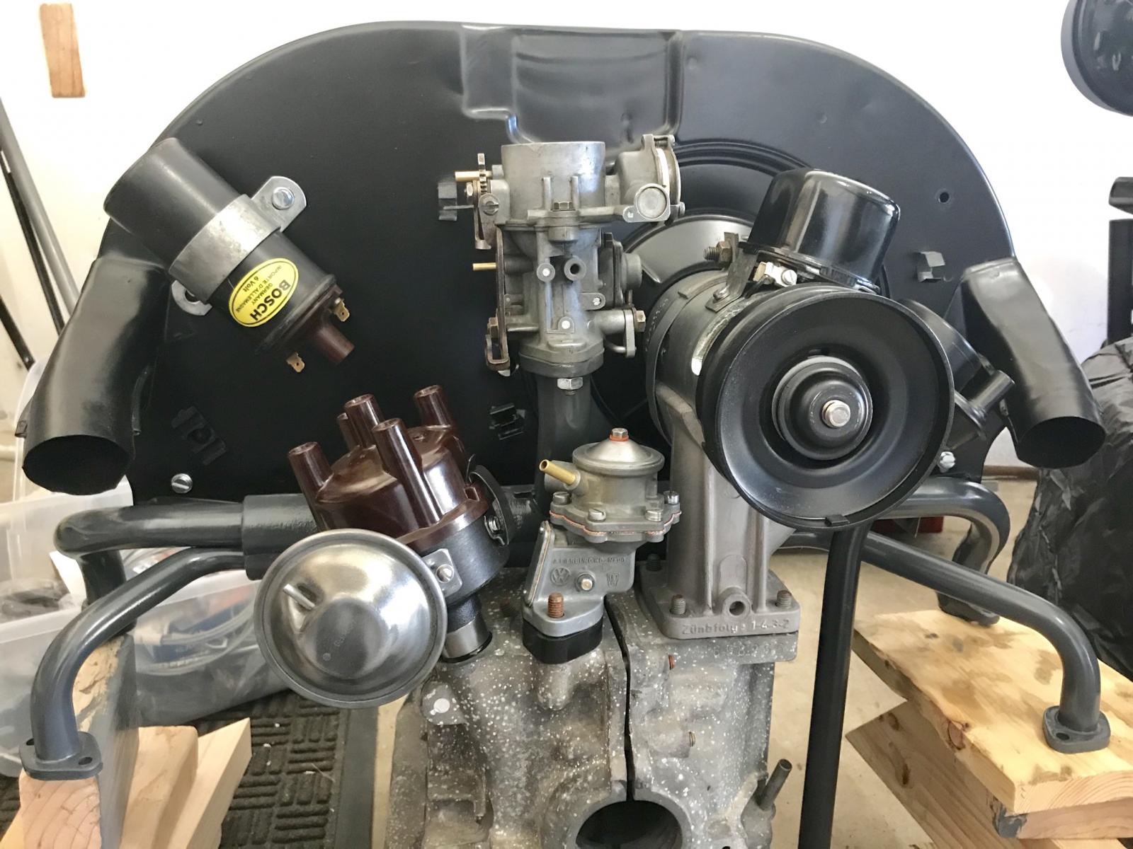

I have been working here and there with the engine to get it running as good as I can. I ran into fuel pump leak problems during the first run, but managed to suspend a fuel can over the carb to bypass the leaking pump. I thought I had one of the bad rebuild kits so I purchased another from the classifieds here. Upon rebuilding a second pump it leaked the same as the first so I tried tightening the six pump half screw VERY tight and that stopped the leaking. I've got about an hour of run time on the engine and it is running superb. The carburetor I pulled from the junk yard has a throttle shaft that is a little loose and will drip fuel if any is sitting on top of the throttle plate, but other than that it is okay. I will work with it for now and look into a solution later before the car hits the road.
Now to get the transmission back together and onto the pan..
A photo of the nearly completed engine on the test stand this evening after some more runs to test the rebuilt fuel pump. I will have the rear engine tin fitted soon.

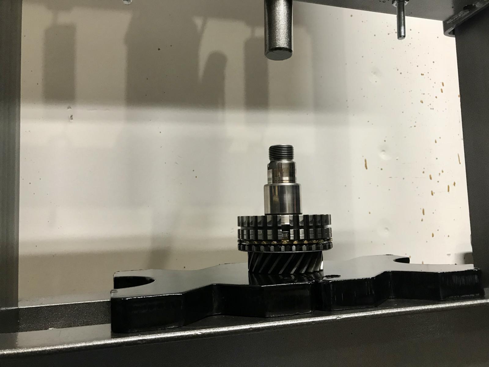

Inspired by anthracitedub and his transmission tear down and rebuild thread I set out to get the transmission apart that came in the car when I bought it. This was a good running transmission that had no problems from the little that I drove the car before starting the restoration.
I was hesitant to dive deep into the transmission as I have never messed with them, but I finally decided to give it a shot.
This evening after our family dinner date we went and picked up a cheap twelve ton press. The rest is history....
I made it through getting both gear stacks and gear carrier disassembled and the parts mostly cleaned up. It may be a little overkill, but I bagged the parts as this is a total newbie that will be putting it all back together. I have to say this is amazing fun to get to learn how this box of gears really works. Very Happy
