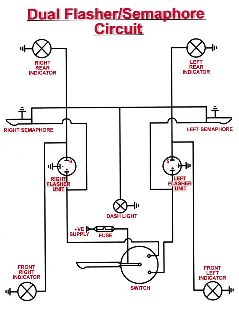

Jeremy, question for you that maybe you’ve ran across before. Using the deluxe VW kit, do you think it would be possible (well anything’s possible I suppose) to also hook up semaphores in addition to turn signals? Semaphores are 6V, rest of car is 12V.
I've built a couple harnesses to add in semaphores before, and what I had to do was: Run a keyed hot wire to the turn signal switch, then come off the turn signal switch, feed the semaphores off the left and right turn wires and feed 2 different flashers (1 for left and 1 for right)...then come off the flasher load terminals directly and split off to front and rear turn signals. I think I actually found the diagram here years ago. The idea is not running the semaphore power through a flasher, so they don't flop up and down. I've heard guys say they will, and others say they won't, haven't had a set personally to play around with. Here's the diagram I based the wiring on if you want to mess around with it

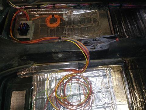

Jeremy, do you ever use threaded standoffs on the back of the fuse block to mount them to the surface? I am thinking about doing this and using machine screws through the fuse block since I am mounting mine under the seat, plus there is a quite the bundle of wires in my harness since I ordered the extras.

That will be fine. I’ve had guys use metal or plastic spacers with long nuts and bolts...or make brackets with welded nuts on it and long bolts. I might have some pictures of a guys beetle with an underseat panel that I can send. Derrick Johnson used the same deluxe bug underseat kit in his last beetle build and I think I’ve got some pictures of it

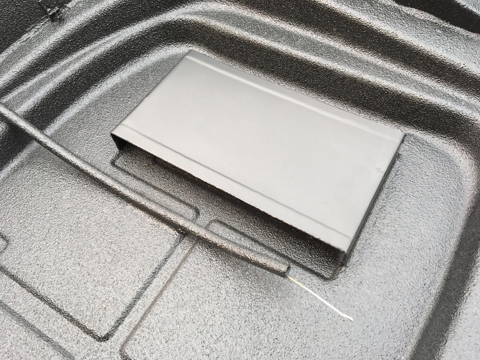

That would be cool! I built a platform for mine and like I said was thinking about using threaded standoffs to hold the actual fuse panel in place. I think I need to leave some room on the left for the defroster relay.

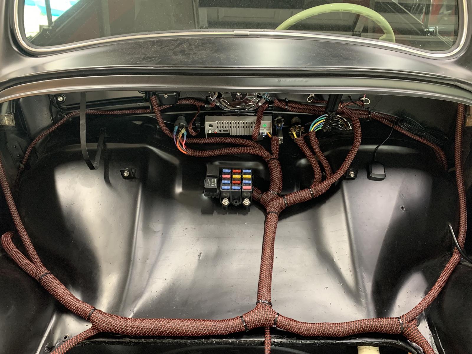

That looks really good man! I think you've got it. Here's a couple pictures of Derrick Johnson's latest car. You might have also see his build "Das Speedster" built with a rotary engine and wired with our harness. Check out Unique Coaches on Instagram, he's got more pictures there. He made some covers for the front wiring and a false firewall in the rear, so no wiring is showing when it was finished.

Ah I see, he made a hole through his bracket for the wires to go through. I still think I am going to use standoffs so if I have to remove the body again in the future (I.e. doing a roll cage) that I can just undo the 8 screws and the harness can go with the body. Also I will be using Deutsch connectors and making a terminal strip in the engine compartment on the firewall so I can remove the engine easily and have the harness split in that area as well.

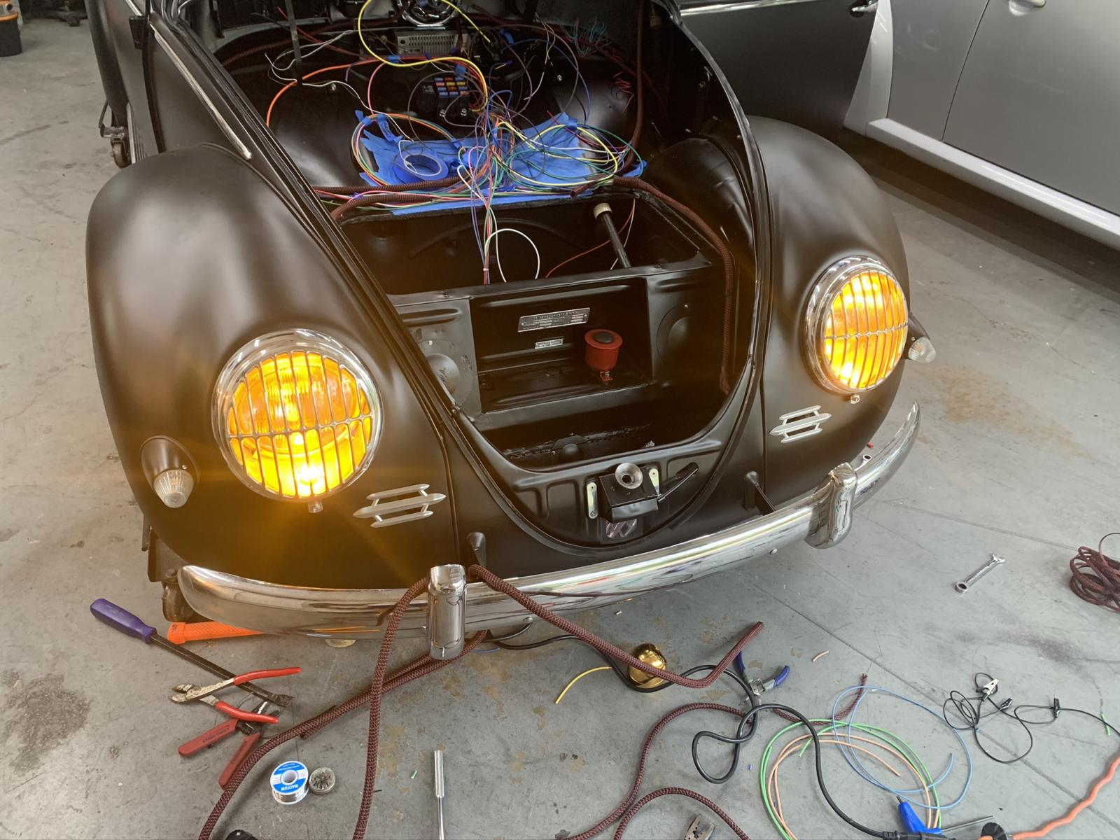

x10 for Jeremy and Rebel wire. I knew I didn't want a stock harness as i'm including modern elements in my bug (1957) and wanted something cleaner and easier to keep track of. I did have electrical knowledge but never an entire car and Jeremy was extremely helpful and answered everyone of my questions. I created a spreadsheet layout of the fuses to keep track of my used and unused fuses and laminated it to keep in my glovebox.
