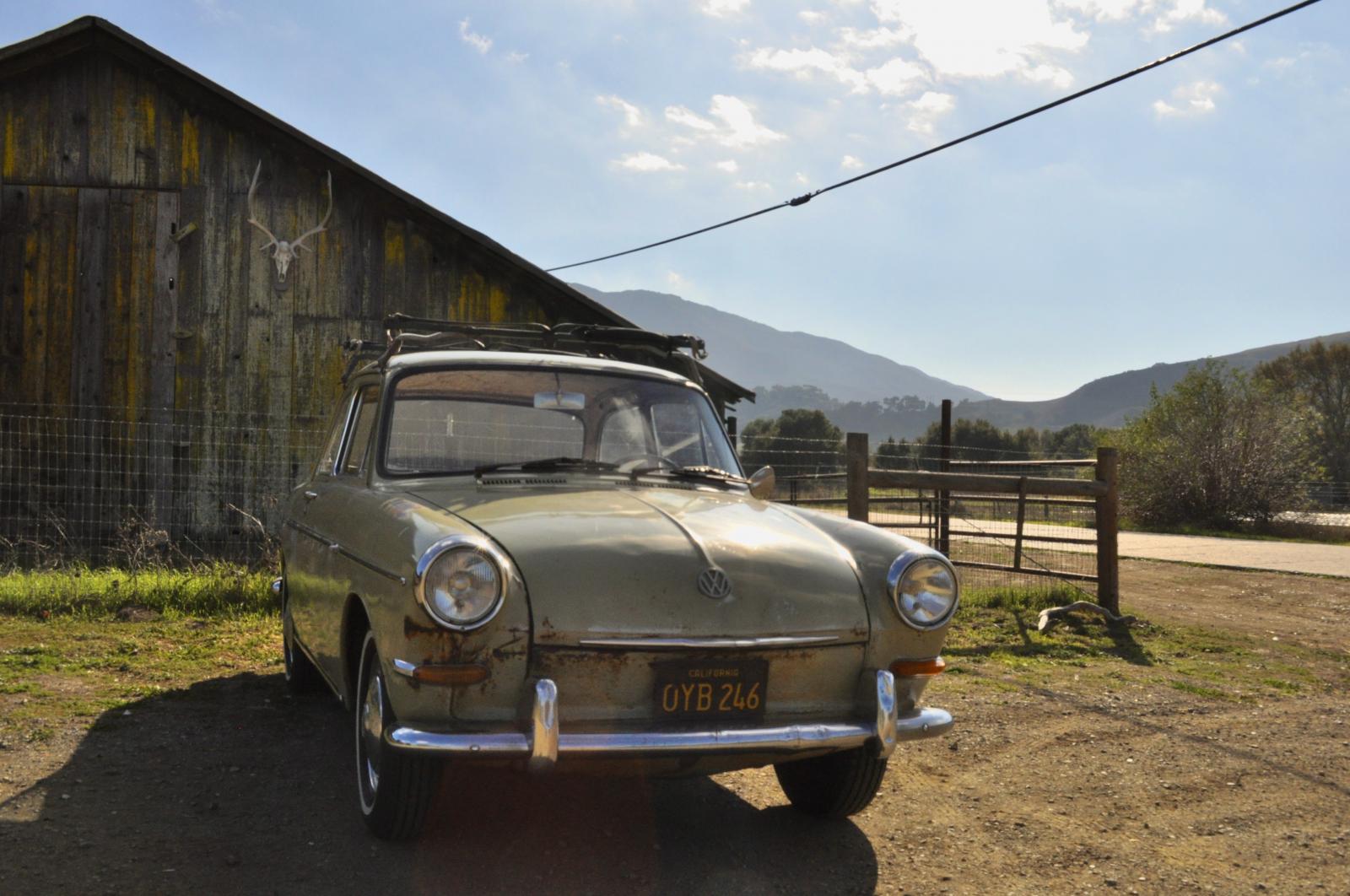

PostPosted: Tue Mar 22, 2022 3:32 pm    Post subject: Re: 1964 safari beige notchback preservation Reply with quote
Looks like you might have a torn ball joint boot in the background of the pic

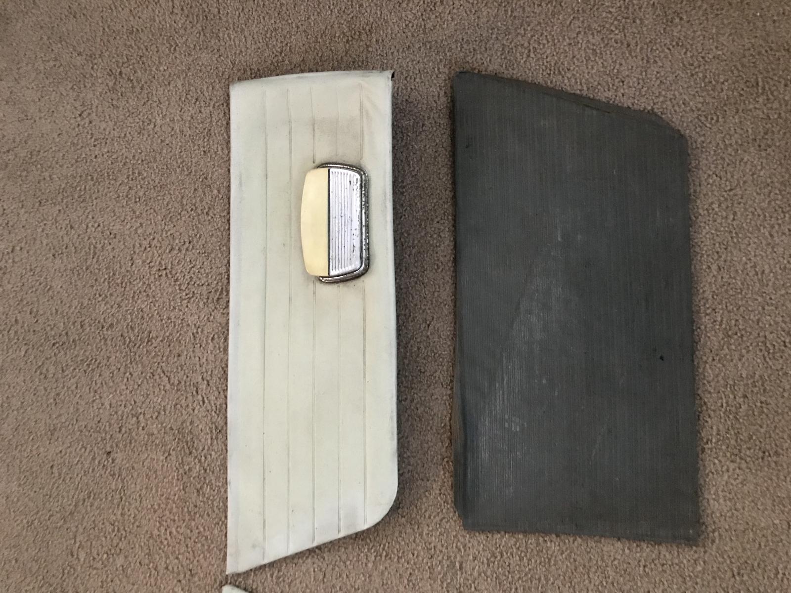

The 5 year mark of ownership came up 2 days ago. Felt like I should do something for the ol' gal. Haven't had much motivation to get stuff done since work, school, and general life has been getting in the way and exhausting me. I got a couple days off and decided too finally tackle the small project of matching my lower interior panels in the backseat. Originally gray.
I met up with Jack and Pedro at the "famous" type 3 factory in San Diego a while back since jack had a couple things for me. Pedro suggested I use the panels I had and paint them with a vinyl paint. He had some mixed for me and I finally found it in me to tackle it. I would say the color turned out pretty good!
I couldn't help but test fit the panels when they were done drying. I had to see how they matched up with the factory original fronts.
Not bad I'd say. I have some smoothing out to do before they officially get put in the car for good but hey, more than half way done I'd say.

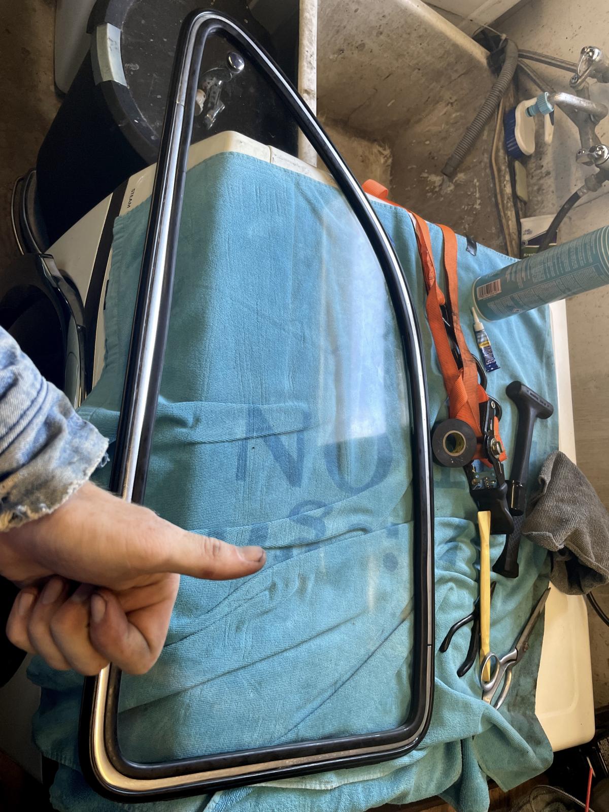

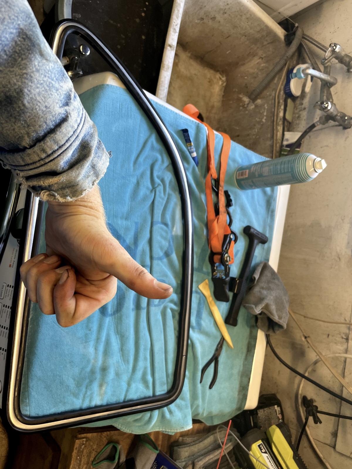

Some things I forgot to update with as well.. A while ago I decided to tackle the pop out windows. Man.. I gotta say what a Royal PITA!!! Mad Heard from numerous sources that patron and lots of swearing helps and then more patron. Too bad I don't drink.. Rolling Eyes the installation of the rubber wasn't so bad with silicone spray and some working around and what not..
Also had a little helper through the process. I think Billy likes it in there! Laughing
The hardest part I'd say is definitely the reinstallation after everything is back together.. Not to completely give up but man.. maybe I shoulda started drinking cause that sucked.. I ended up driving over to ISP West and had them show a young aspiring padawon such as myself the ways of installing these things. In a little under an hour and poking fun at me we had the windows in and am confident I can do it next time without their help. lol Laughing. Also finally got the correct style early wrap around dash for the car. Can't say its the prettiest or nicest dash but shoot.. I'll take it! Extremely hard to come by and I had to jump on it. its better than the incomplete one I have in 4 pieces..
I decided to give it the ol' install so I didn't have to look at the metal dash anymore. It'll have to come out again when I install a headliner eventually, but for now wanted it in to make the inside a little more complete.
In my 5 years of ownership of my second type 3, it sure feels like I've done a lot but at the same time It feels like I've barely done much to the car. Lot's of gathering the correct things and correcting Previous owner doings. I gotta tell ya though; being able to daily drive a stock type 3 is AWESOME! I love both my type 3's and love how I can daily drive them and be confident that I can hop in at any given time and drive any given distance without a hiccup. Especially driving in style Cool . Here's a couple photos from a somewhat recent trip into Santa Barbara I took. This car has a long ways to go before it's "done" (I don't think it'll ever be completely "done" though), but it sure does have a lot of character and I intend to keep that for now and it sure does look good driving down the road. Cool

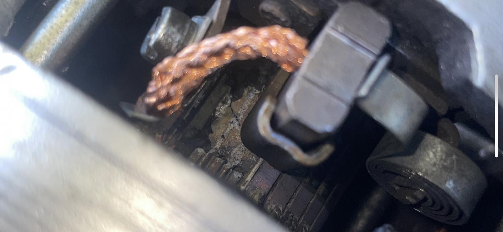

I guess I jinxed myself with my last post by gloating about daily driving a type 3 Laughing . So I was driving home from work Tuesday night and noticed the headlights and gauge lights were very dim and brightened up by a lot when I raised the RPM's. I figured it was the voltage regulator so I replaced the old unit with what I thought was a good used one. turned the car on and everything seemed to be working as it should.
Fast forward to Wednesday. I'm driving to San Diego and everything seemed fine when I left. I stopped at a buddy's house on the way and noticed that the gen. light did not light up as it should with the oil pressure light in the pre-ignition turn. I was poking around and thought okay well maybe a bulb burned out.. drove down to San Marcos to spend some time with the girlfriend and the car drove fine except for that light not in operation.

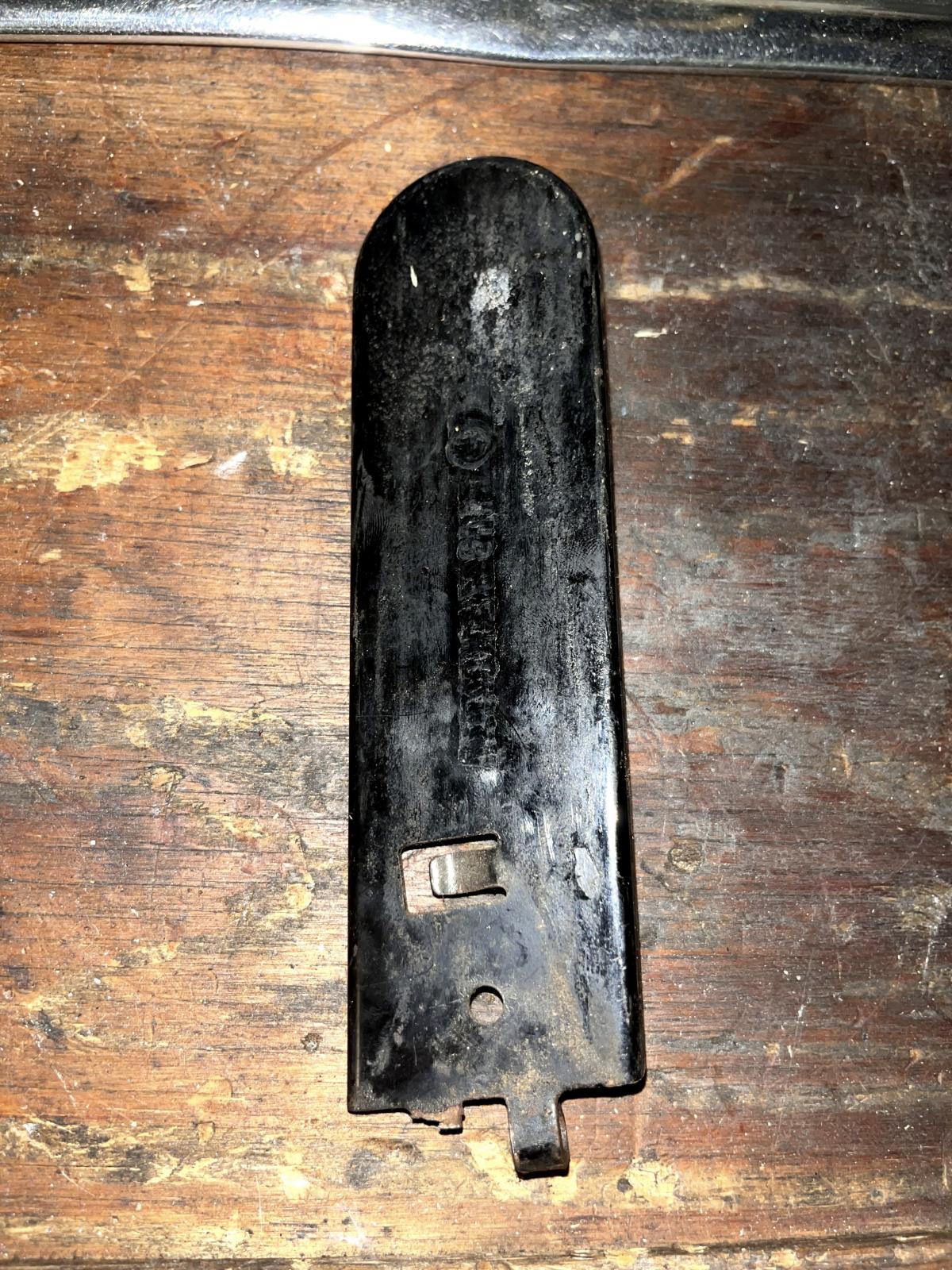

Now fast forward to today, I get in the car and it's dead. no lights, no click, no nothin. It's dead dead.. I go and get the battery tested and sure enough, it was cooked. Got a new battery and a new voltage regulator and installed them. Red light on during pre-ignition, turn the car on and it stayed on.. I tried polarizing the VR but even after the light stayed on. So I go back to the engine bay and look at the generator. BOOM! There's the problem. One of the brushes had literally popped out of its seat and I inspected the other side and not only was the other brush on the bottom severely worn down, the copper braid attached was no longer attached.. So I do some more looking becuase that should NEVER happen.. that's why those springs are there to hold them in place to contact the commutator. My further findings were not good..
My theory is that the VR I put in was not "regulating the Voltage" output of the generator and it ended up getting so hot and frying itself along with the battery.. Here's the kicker. Since I am trying to keep this car as stock in appearance and as close to being stock as mere possible I have all the workings of a 12 volt system and have made it appear as 6 volt like early cars had. So the commutator was converted to 12v and put inside a 6v casing with all the 6v shrouds. Can't just run up to the local parts store let alone ISP and get a new one.. and it'll be a pricey fix.. The price you pay to do things "nice" Laughing Rolling Eyes
Been in contact with Notchboy and He's been awesome in coachin me through and talking about the issues at hand. Awesome to have a type 3 veteran coach the youngin. Currently still in San Marcos and here til Saturday evening. new battery should get me home, but ya.. gonna have to get that fixed and cost a pretty penny
New voltage regulator
Broken Brush
Broken and burned commutator

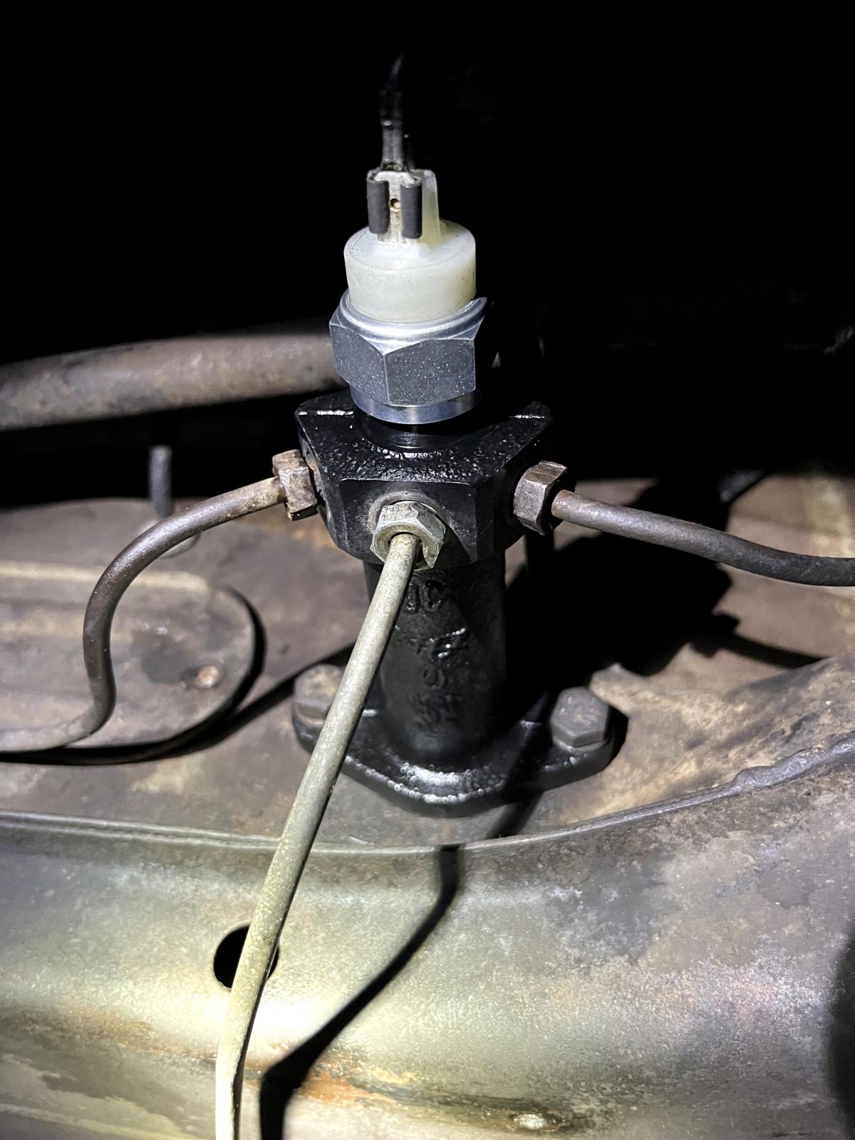

So the saga continues! Hopefully onto greener pastures now. Like I was saying before.. Sure did feel like I was getting my ass handed to memoir a bit there. Just one thing after another.. But hey, that's part of reconditioning and driving old cars, right? right. Wink Rolling Eyes Where to begin.. I guess we'll start where we left off with the generator issue.. Well I feel bad for the generator builder. I ended up returning it 3 times..
This is what caused the whole thing. After that I replaced my battery and got a new bosch solid state voltage regulator.. welllllll, that new voltage regulator I got ended up being the cause for the rest of my problems... I got the new generator back the first time and it was making weird noises and then all of a sudden it went dead after I shut the car off one day.. Something had to have shorted somewhere but I still do not know where or how.. cause I received this picture after I sent it back out.. all that happened was the starter wire got loose and fell off and when I turned the car back on the generator light came on..
So now the last time I got it back I put it in and it still wasn't working.. I reached out to the Sensei Pedro cause I was more than confused now.. I checked continuity between all wires, checked voltage everywhere and I couldn't figure it out.. well after Pedro graciously spent 3 and a half hours going back and forth with me over the phone (amigo I owe you some patron by the way!) we finally decided to swap the voltage regulator out with this spare I had for giggles
and whaddya know.. all of a sudden it was working.. even though prior we received good readings on every terminal but the D+ which goes to the generator..
Generators fixed and i was happy! could finally drive this thing again.

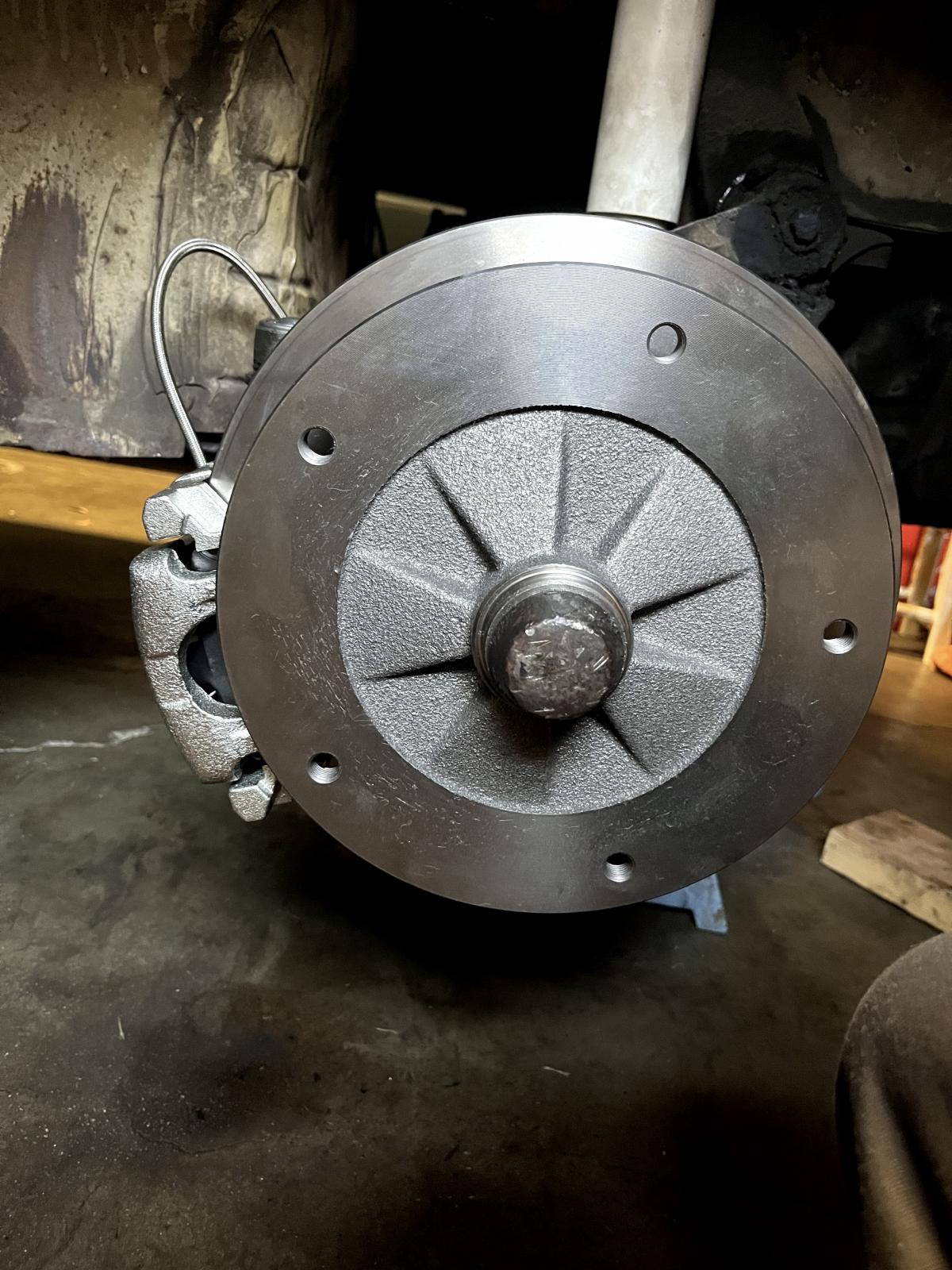

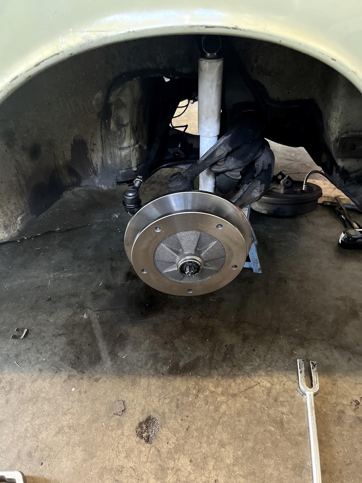

Fast forward to about a month later, beginning of September. I'm in San Marcos spending time with my girlfriend and her family, I'm meeting my dad and a friend of his at San Onofre for a surf. On my way down I smelled something burning, like rubber burning. It's about 6:30 in the morning and I'm driving through camp pendleton when I smell this and I thought it was odd but I didn't' hear or feel anything odd and just figure it was the Marines doing something weird and it was carrying over. Boy was I so wrong...I'm on my way back to San Marcos after surfing and I'm driving on the 5 south through Pendleton again and I start to smell the burning smell again.. Traffic is slowing infant of me and I push the pedal in and it goes straight to the floor.. Shocked Shocked Luckily I was smart enough and definitely lucky enough to lightly pull up on the Emergency brake handle and move over to the shoulder and I got out and the right front drum was smoking... Something had to have been sticking.. I got it towed home and dove right into it, well here's one thing I found

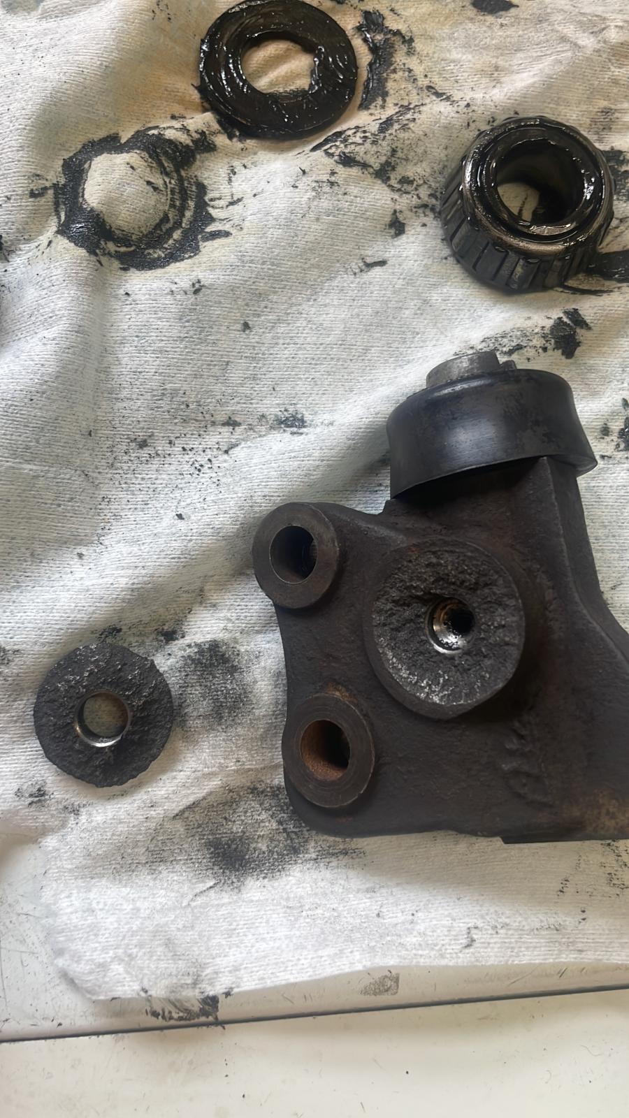

When I was taking everything apart I found this on one of the wheel cylinders.. I've asked around and everyone was saying that that's a first..nobody has seen that.. Lucky Alex at ISP had a couple rebuilt ones and I had a new rear That I was able to rebuild the other good front wheel cylinder with.. I went through that wheel. I replaced all rubber hoses all the way around the car, new inner and outer wheel bearings for the right front, rebuilt wheel cylinders, new shoes, cleaned up drum. Took it out for a test drive with some hard braking and that wheel was still getting way hotter than all the others.. I'd been wanting to put a disc brake kit on the car for a while now.. I daily drive this car. Not only do I daily drive this car but I drive this car probably too much.. if that's a thing.. I mean shoot.. From my house to my girlfriends in San Marcos is 93 miles one way, plus all the driving I'm doing when I'm there, and i'm going just about every other week and driving the car a bunch around home too. I was talking with Michael and I figured a practical safety and economic upgrade would be good for the long run. I went with the AC Industries kit that ISP sells. Along with that I still wanted the car to look correct so I kept it single circuit and got the 66' Only Master Cylinder to go with the kit. Who knew used spindles would be rather hard to find when you're impatient.. lol. Rolling Eyes Ended up buying a whole front beam for 240 bucks and figured I'd just part it out later.. I spent some time this past weekend finally putting everything together. I finally went for a good drive yesterday for the first time since the brakes went out.
Along, with swithching out for a disc brake kit, I also replaced the accelerator pedal that was more annoying than anything. One of the tabs at the bottom where the bolt goes through at the bottom was broken so the pedal would move a bunch and I didn't get a "Full Throttle".
Ordered an NOS one from Mario and the car feels so much better with the new pedal in.. big difference! Very Happy

KylanC wrote:
Oh was your master cylinder painted? I believe 356s used the painted version. Cool

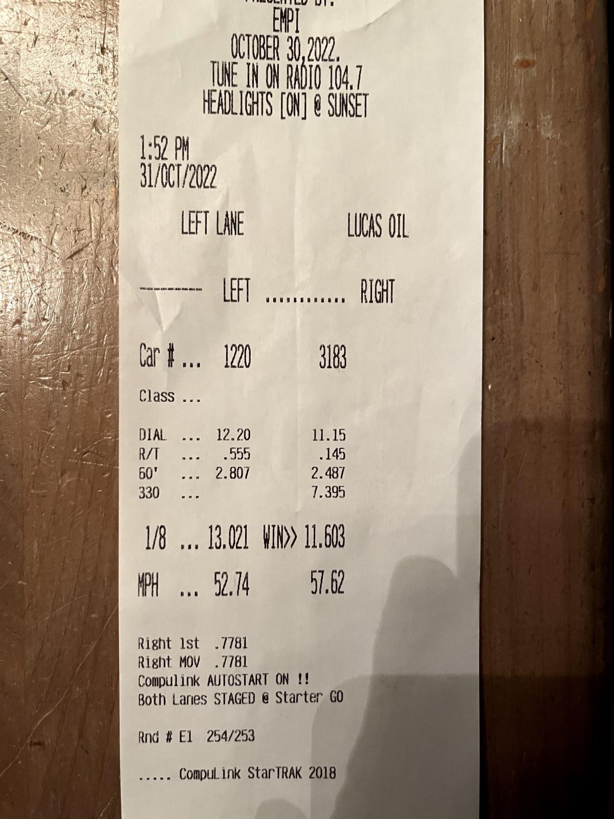

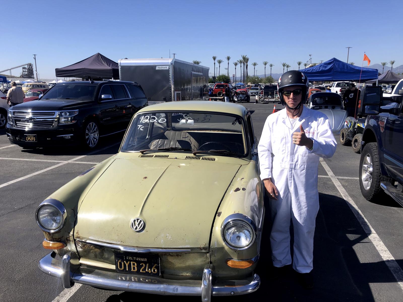

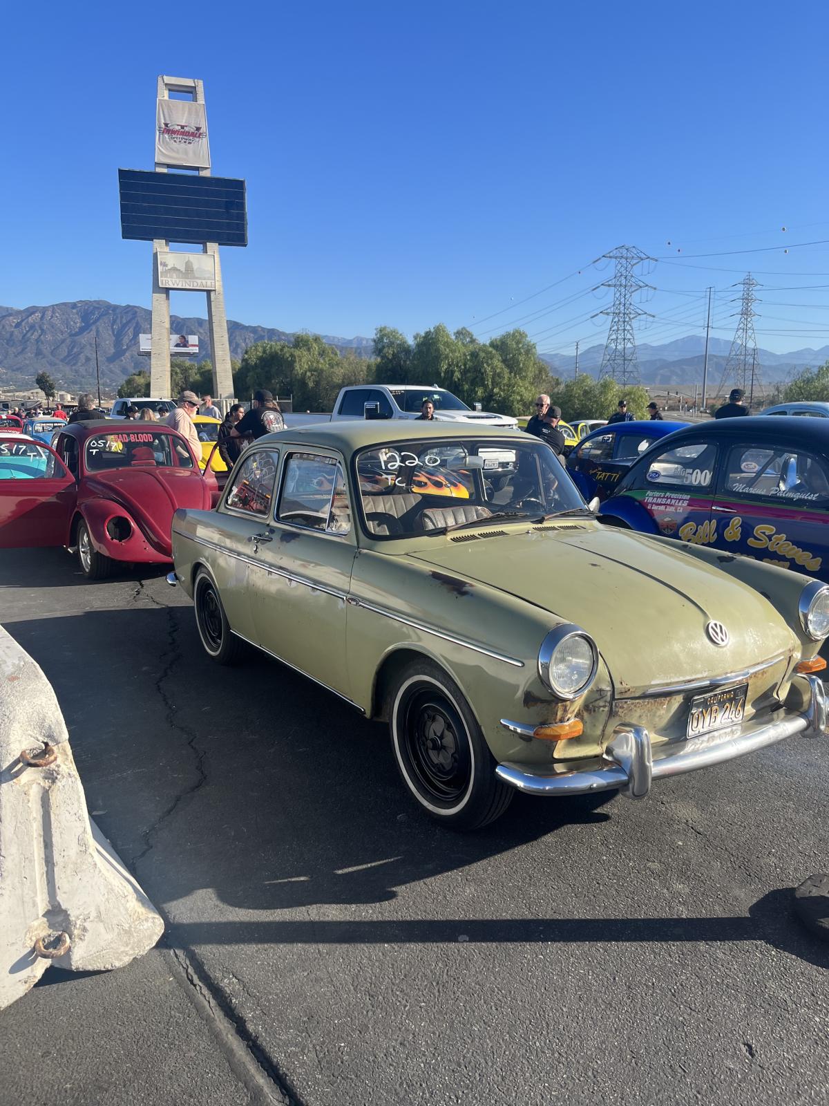

Had a little fun the other day. Went out to the Hot VW's drag day with the notchback and decided to run her down the strip a few times. First time ever doing that, Both for myself and the car.
Honestly, I didn't really know what to expect other than I knew I wasn't gonna win.. lol.. Laughing I entered the trophy class since that's what's open to any vw and I'm running a totally factory bone stock 1600cc.
Alas, it was totally fun and totally cool just to see what a completely stock powered type 3 will do in a 1/8 mile strip even if I'm running against suped up bugs and newer golf/jetta's Rolling Eyes Laughing
My reaction time coulda been lot better but that glare on the lights was really bad on the left side and I was put in the left lane each time. I got to run 5 times down the strip and just had a blast. times and speeds were fairly consistent so that was pretty cool too.
Here's some photos from the day, enjoy Cool

I love it. Super cool, Ky.
You look like a younger jimmynotch. Laughing
