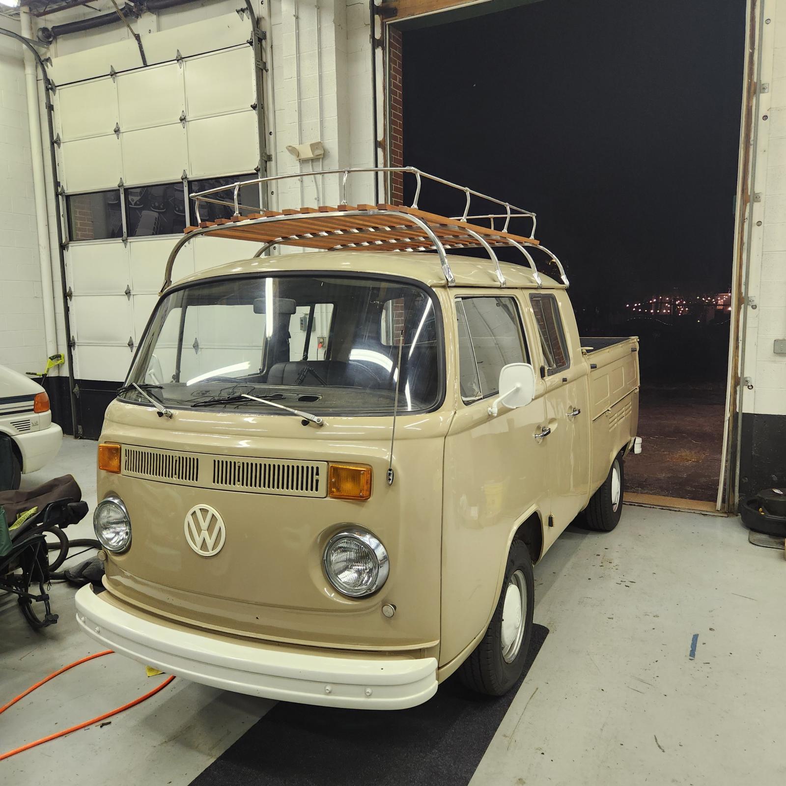

been a minute since I posted an update on the SA double-bubble..
With hardly hours to spare, I did manage to get my flaps, thermostat, new fuel lines, etc all installed and motor back in in time for the big fall St. Louis show "Volkstoberfest" put on by Russ & Jodi Gelbach of Air-Cooled Antiques.
Took home 1st place Bay! Hooray!
I spent the next couple of weeks driving it almost daily on my commute and any errands..
working on evening out that trucker tan!
and also assembled and put on a repro 4-bow roof rack from CIP1.
Major setbacks involved the bullshit Chinesium hardware. I had to order new stainless screws from McMaster-Carr and chase the threads on a couple of those upright bits.. and replace a couple of the 13mm M8 bolts.

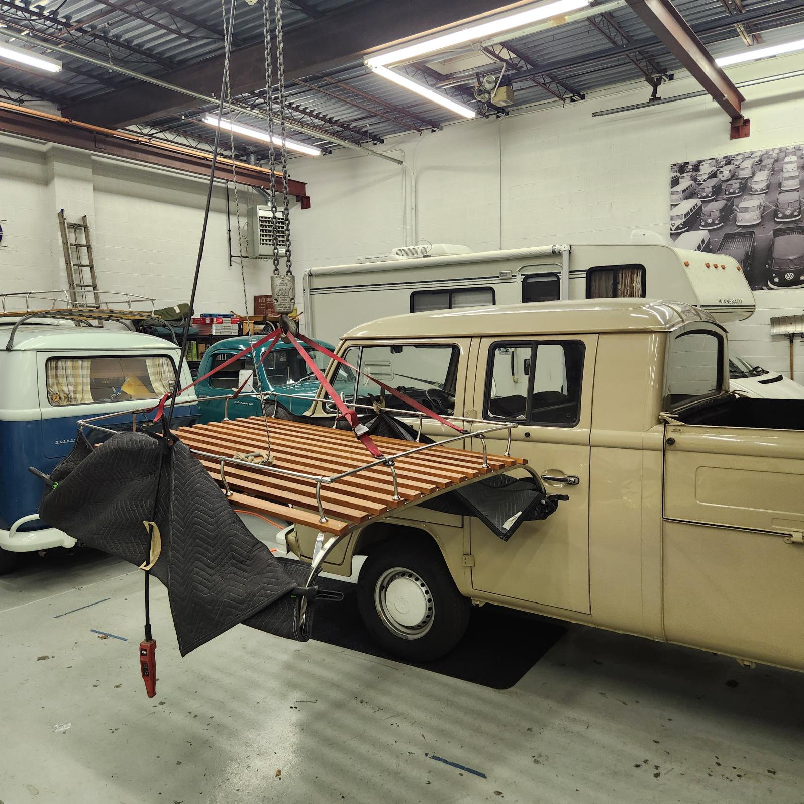

Luckily my shop has a huge overhead gantry crane so I was able to get it on myself.

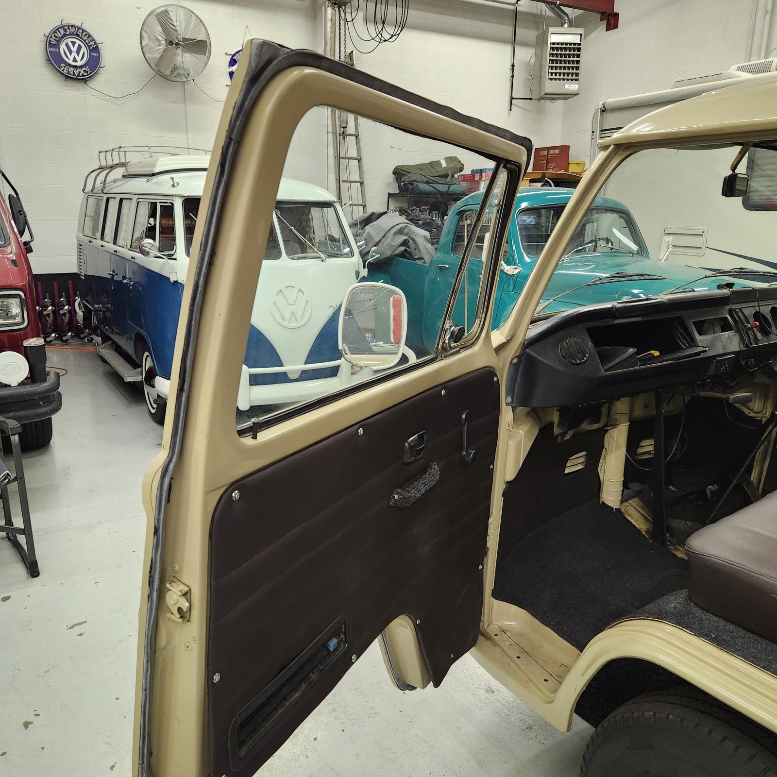

also in those weeks I installed new front door seals from Wolfsburg West. They fit great and it was an easy install

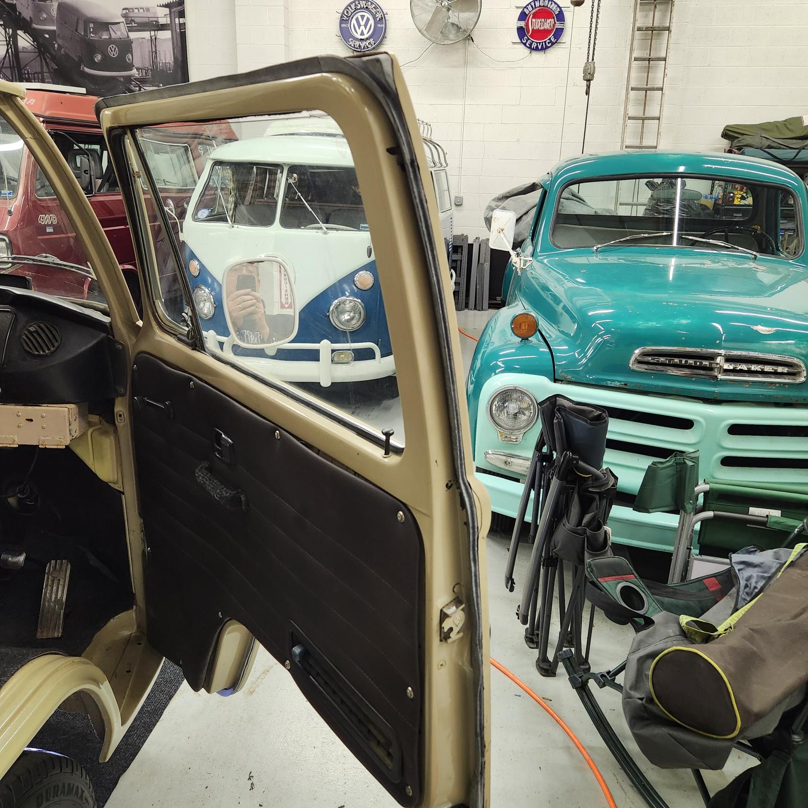

Question - Who knows where I can get new seals for a late bay doublecab 3rd door? The seals for a splitty door are much thicker and do not fit!

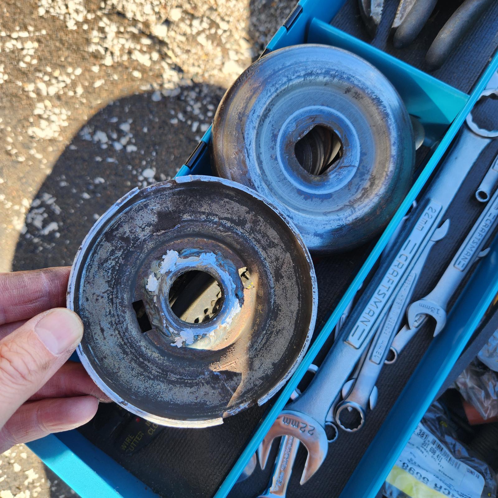

While we were on our way to meet up with the crew, the wife says to me... "something smells like burning rubber"... and then the motor seemed to get a lot quieter..
I looked down.. GEN LIGHT ON!
I pulled over right away so hopefully little/no damage was done, but our day was definitely over. Sad
the pulley even wore into the alternator and CUT THROUGH one of the ribs! Obviously it had been going bad for a while and I'm just too damed deaf to have picked up on it! Crying or Very sad
One of our club mates who was caravaning with us but bailed out right away after he could barely go up to 50mph, came to rescue the wife and our dog while I sat on the side of the interstate and waited for the tow truck.
One of our club mates who was caravaning with us but bailed out right away after he could barely go up to 50 mph, came to rescue the wife and our dog while I sat on the side of the interstate and waited for the tow truck.
During the late-1980s, I used to use an electric overhead travelling gantry crane, to move 2 metre x 2 metre masonry cavity wall test-specimens in RSJ - rolled steel joist frames around the guarded hot-box thermal-transmission test laboratory, at Celcon Blocks (manufacturer of AAC - autoclaved aerated concrete building blocks) in Grays, Essex, England.

In April 1991, whilst driving home on the M25 London orbital motorway, from RMCS - Royal Military College of Science, for the Easter vacation, my 1973 VW 1600 Type 2 suffered alternator-shaft seizure, completely disabling the cooling system and the alternator's radial bearing-housing supports were cut through by the pulley, in exactly the same way as yours.
https://en.wikipedia.org/wiki/Royal_Military_College_of_Science

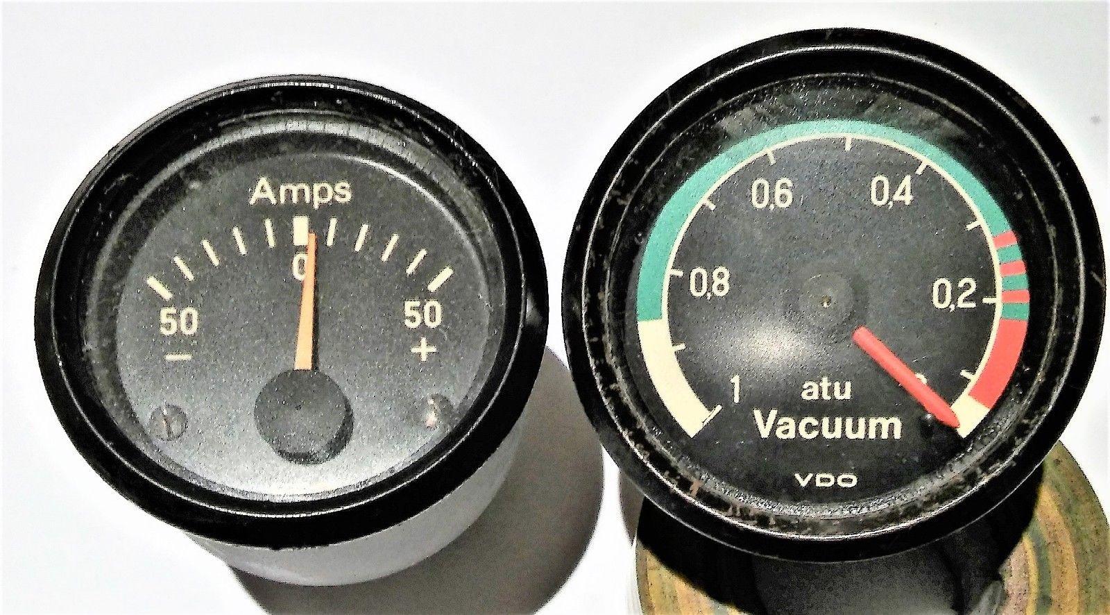

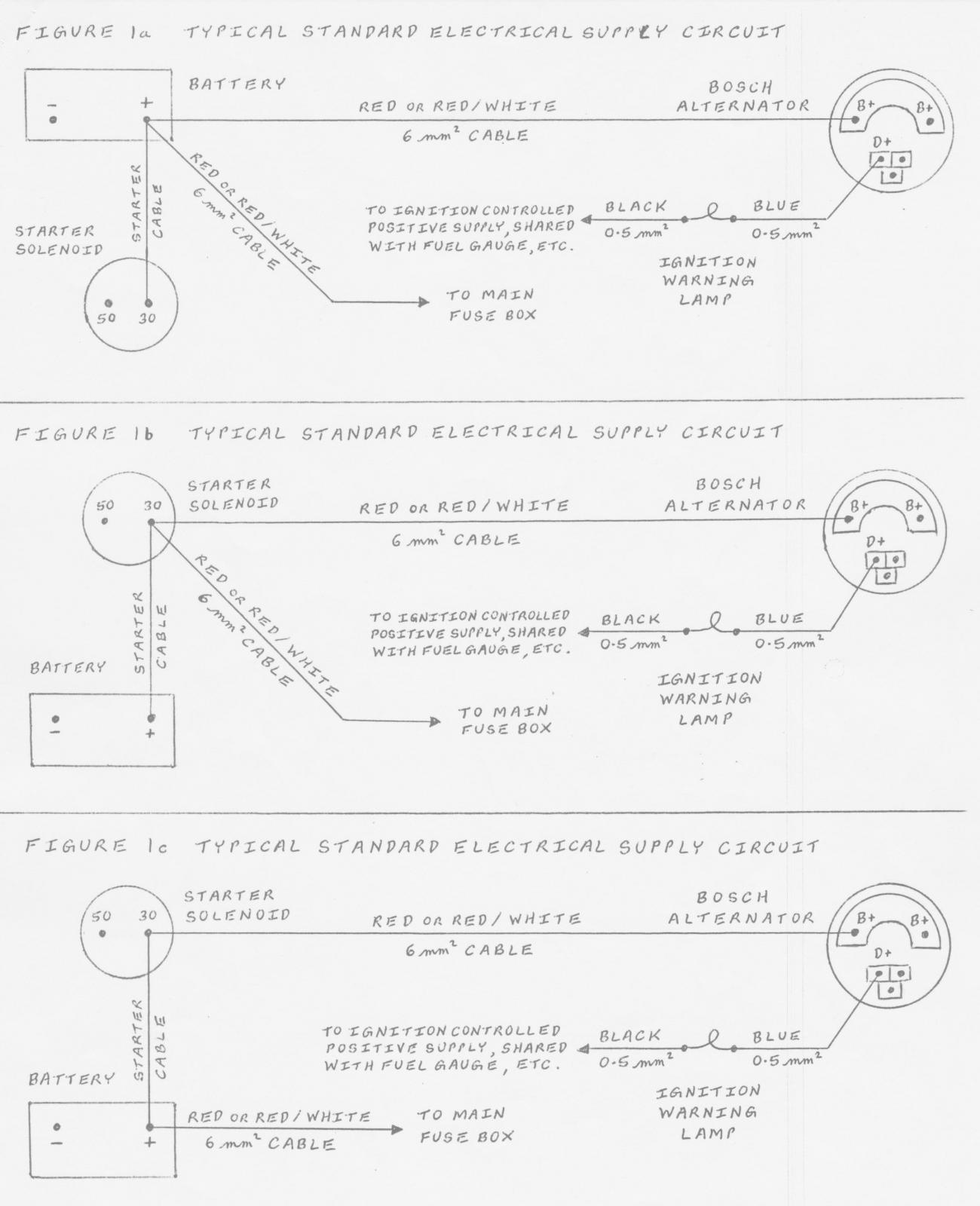

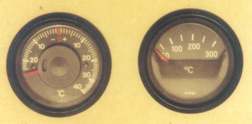

I was alerted to the shaft seizure by the sudden illumination of the ignition warning light and rapid increase in the reading from my VDO Cockpit cylinder-head temperature gauge, which increased by circa 100 ºC in the time it took me to coast to a halt on the motorway's hard shoulder. During that short period, the oil-temperature underwent no perceptible change!
This was one of several reasons why my father and I chose to substitute a VW Type 4 style air-cooled engine.
At that juncture, I did NOT have a voltmeter, which in light of various experiences, I would also regard as a vital gauge! Voltage regulators have been known to fail, resulting in excessive supply voltages of 17+ volts even at engine idling-speed; resulting in the battery's sulphuric-acid electrolyte boiling off, resulting in the battery plates buckling and damage to the surrounding paintwork in the engine compartment. Crying or Very sad
I have yet to get around to transforming either my NOS VDO Cockpit -30~0~30A or -50~0~50A internal-shunt ammeter into an external-remote-shunt ammeter, whose shunt can be inserted directly between the alternator and battery without any need for long, thick cables to & from the dashboard.
Regards.

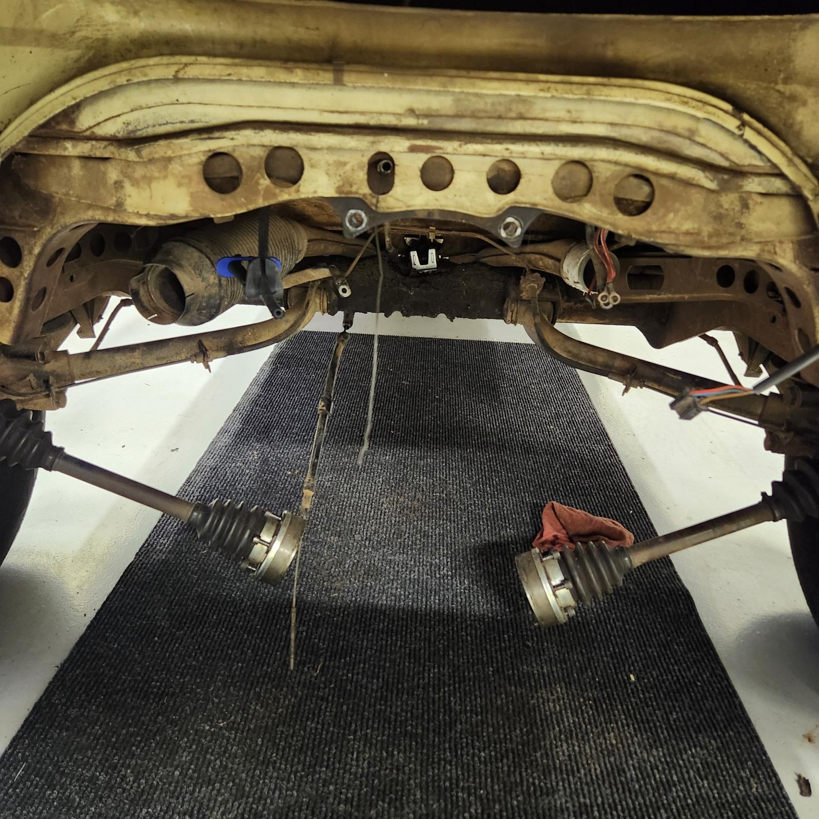

Had a few hours at the shop yesterday.. when I wasn't busy doing property upkeep I managed to get the motor & trans dropped.
As you can see it's a 3-rib. We'll check on any maintenance it may need while it's out. already I may want to replace the front shifter rod bushing & seal.
took a crack at separating the front shift rod half and of course that didn't even budge. then found I was out of MAP gas.. so called it quits for the day.
Stopped at the harware store for gas Cyl..
in the mean time it's soaking in PB Blaster.
any hot tips for separating the front shift rod section without destroying it? I don't think I've ever accomplished that feat.. Confused

speaking of 3rd doors.. There's no door seals at all on this bus and I'd like to rectify that. The front doors are readily available, but I haven't found anywhere listing a bay window dcab 3rd door seal.. much less a RHD one. It looks like it *might* just be plain square seal like a splitty, but I haven't seen another one to compare it to yet.
anyone got a lead?
First, as a fellow RHD DoKa owner, congratulations on your find. That's very cool. And, given the odd M-code plate, is that a TKD (totally knocked down) vehicle, assembled in South Africa?
Re the crew cab doors... Indeed they have unique seals, and right is different from left. But if you ever find one let me know!
Since on the RHD DC the stock crew cab door is on the left, you have an opportunity, here. An opportunity that I took on mine, and that was to install another door on the right. The problem was finding a B-pillar, right side door, and the C-panel. But once found with a lot of patience and just damned luck, I now have a 4-door DC.
uuuhgg.. OK, I guess I'll float this question over on the Kaapse Kombi FB group.. thanks.
I have found myself wishing that the 3rd door was still on the right/starboard side.. but this sounds like a lot more work than I'd be interested in doing to it.. cool mod though!

The pieces of sheet-aluminium were off-cuts I salvaged from the scrap-bins at university.
The push-button switches, are six of eight that I salvaged from a Citroën Visa car at my local car breaker's yard sometime during the early or mid 1990s.
www.citroenet.org.uk/passenger-cars/psa/visa/visa01.html
https://citroencarclub.org.uk/visa-ln-lna-axel-c15/
The gauge-panel has two-pole changeover switches so that in one case I can switch the cylinder-head temperature gauge between separate thermo-couples on the left & right hand cylinder heads.
