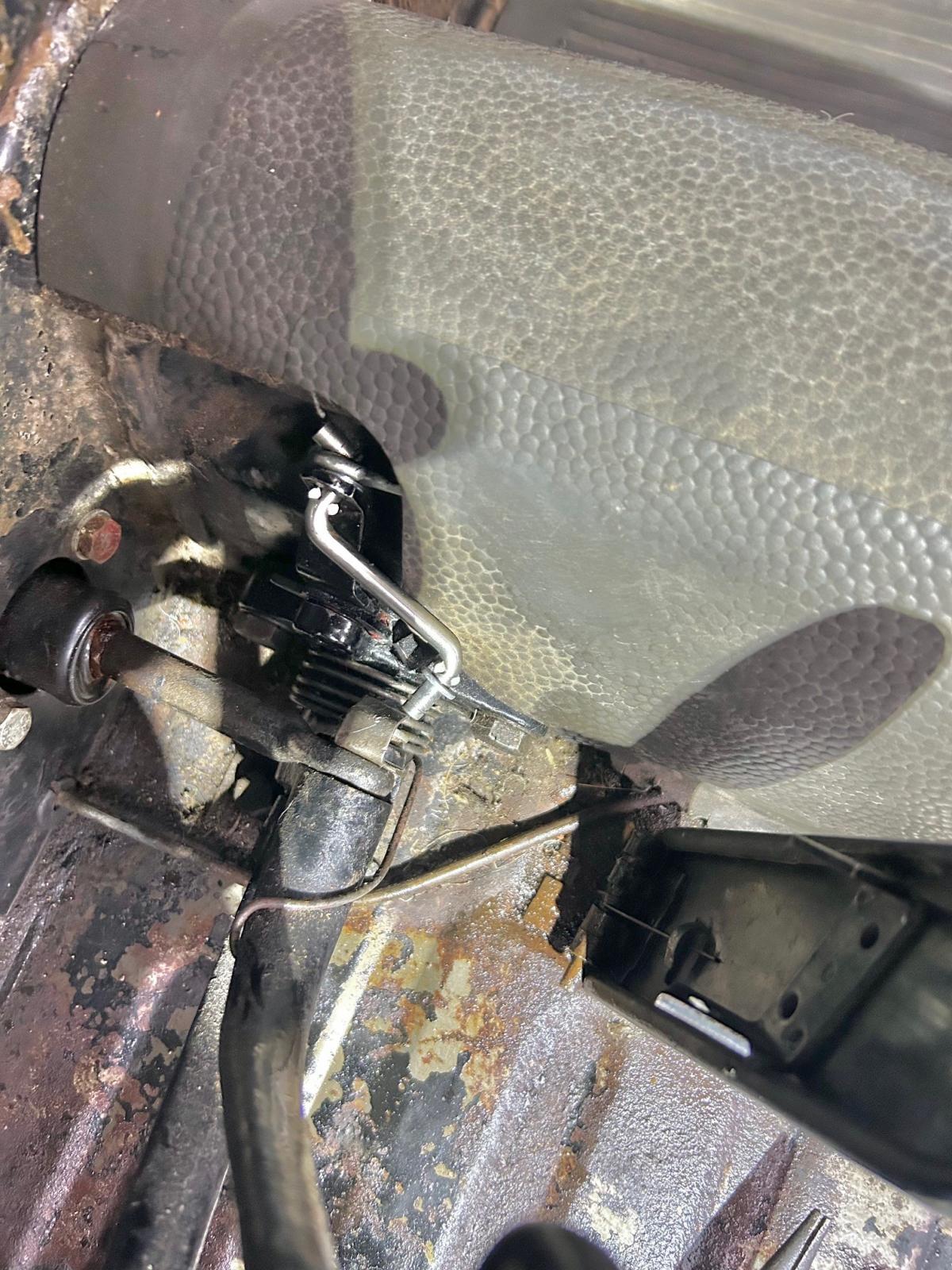

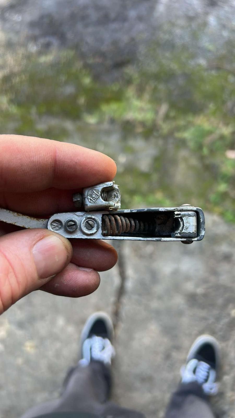

Spent this Saturday Fixing up the Sticky accelerator due to some slop in the pedal. The pedal pin removal was a bit finicky and corroded in place. Also the return spring on the pedal had rusted through and snapped. When replacing the pin I had to do a bit of tweaking on the pedal bracket so the fit was tight enough that it didn't slip out whilst driving.
It is all cleaned up and rebuilt, I noticed a massive difference.

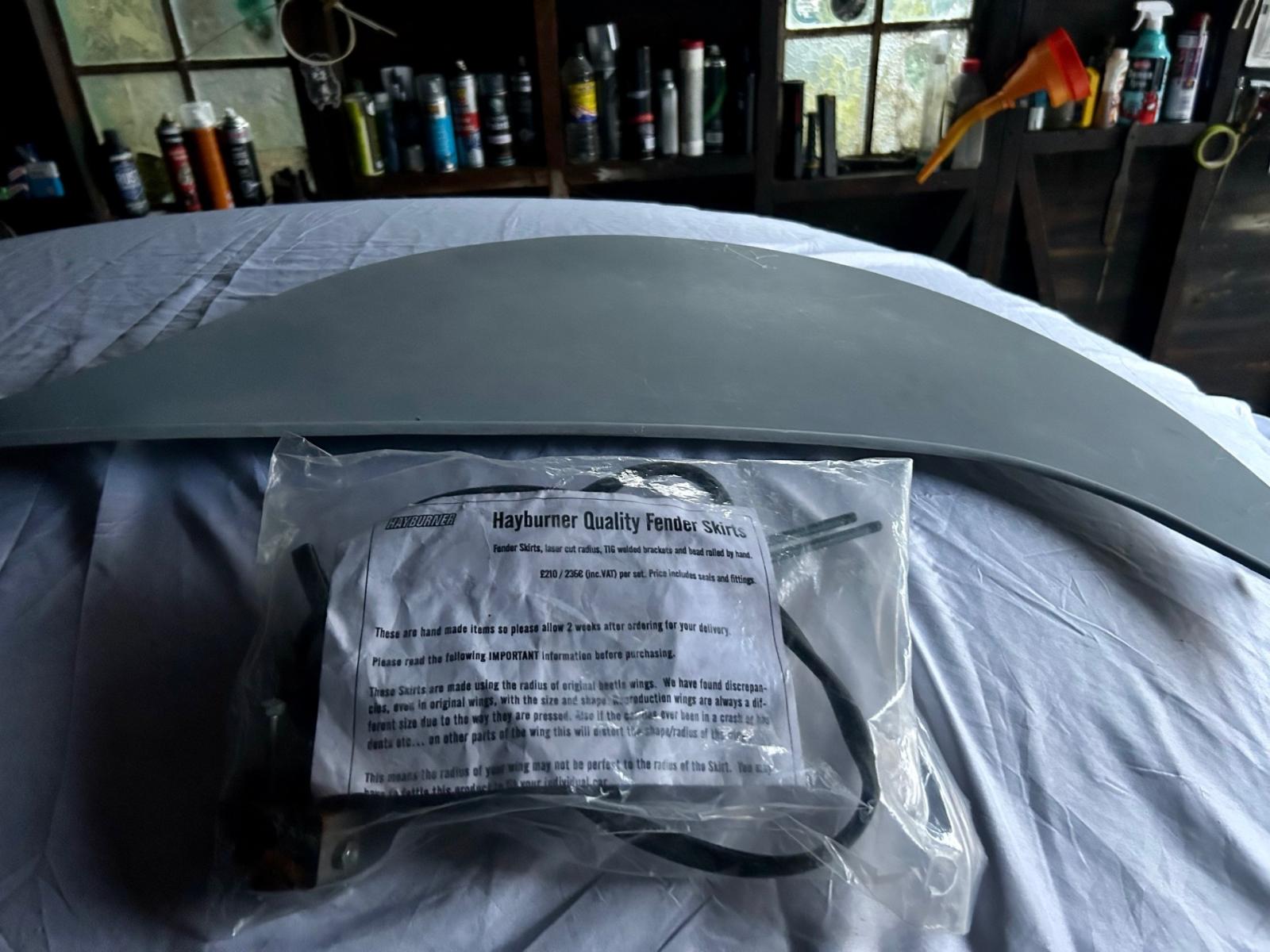

I recently purchased some Hayburner rear wheel skirts/spats off Facebook market place. Looking at getting them colour matched and on ready for some summer driving.

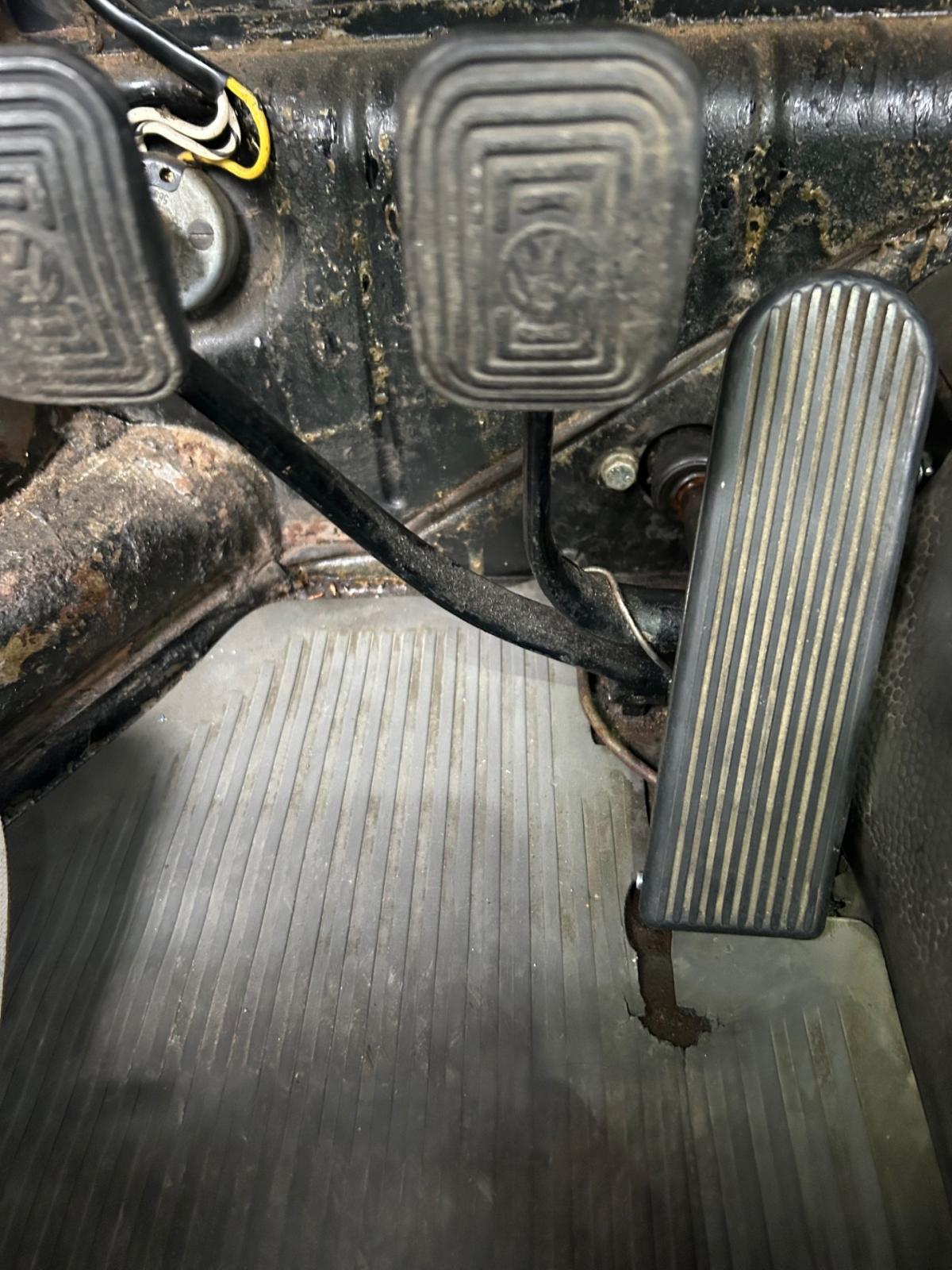

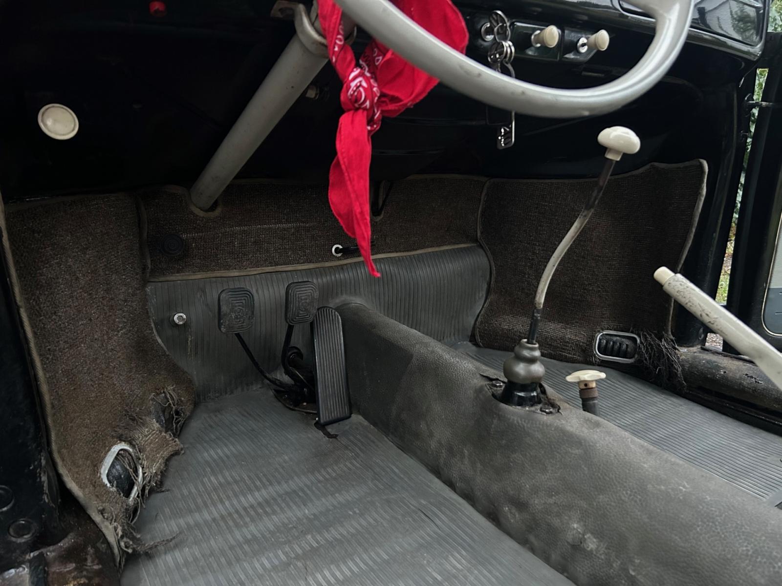

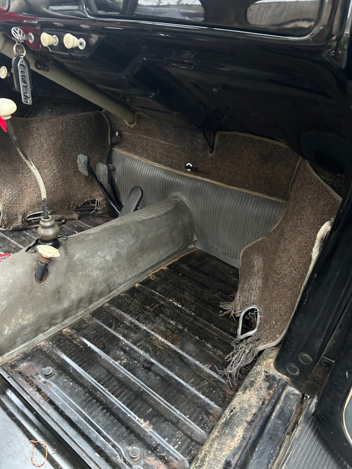

Did some cleaning of the original front firewall carpet and rubber mat this week in preparation for re-installation. It is very tatty around some bits but keen to keep it as it is original to the car. Bit hard to dry in this cold weather but managed to sit it in front of the fireplace for a few days.
Today I rust converted some bits on the firewall and along the heater channels prior to gluing it back into place. Where the carpet previously was installed it still has the original nails. I decided not to remove them and just leave them in place. I know some time in the future I will remove the carpet again to do repairs on the heater channels. The Sill carpet pieces have been washed and just waiting on them to dry prior to gluing them back in. All of the floor pans are original to the car an i can only see a bit where the drivers side has had one patch. Still have the original grey floor mats for the front and one in back on the battery side. Searching for the second one.
I also discovered a possible foot press fuel primer or vacuum near the high/ low beam switch. I am possibly thinking of connecting it to the front washer bottle if so. When i have been under the front i know it is not connected to anything. Need to do some more investigation.

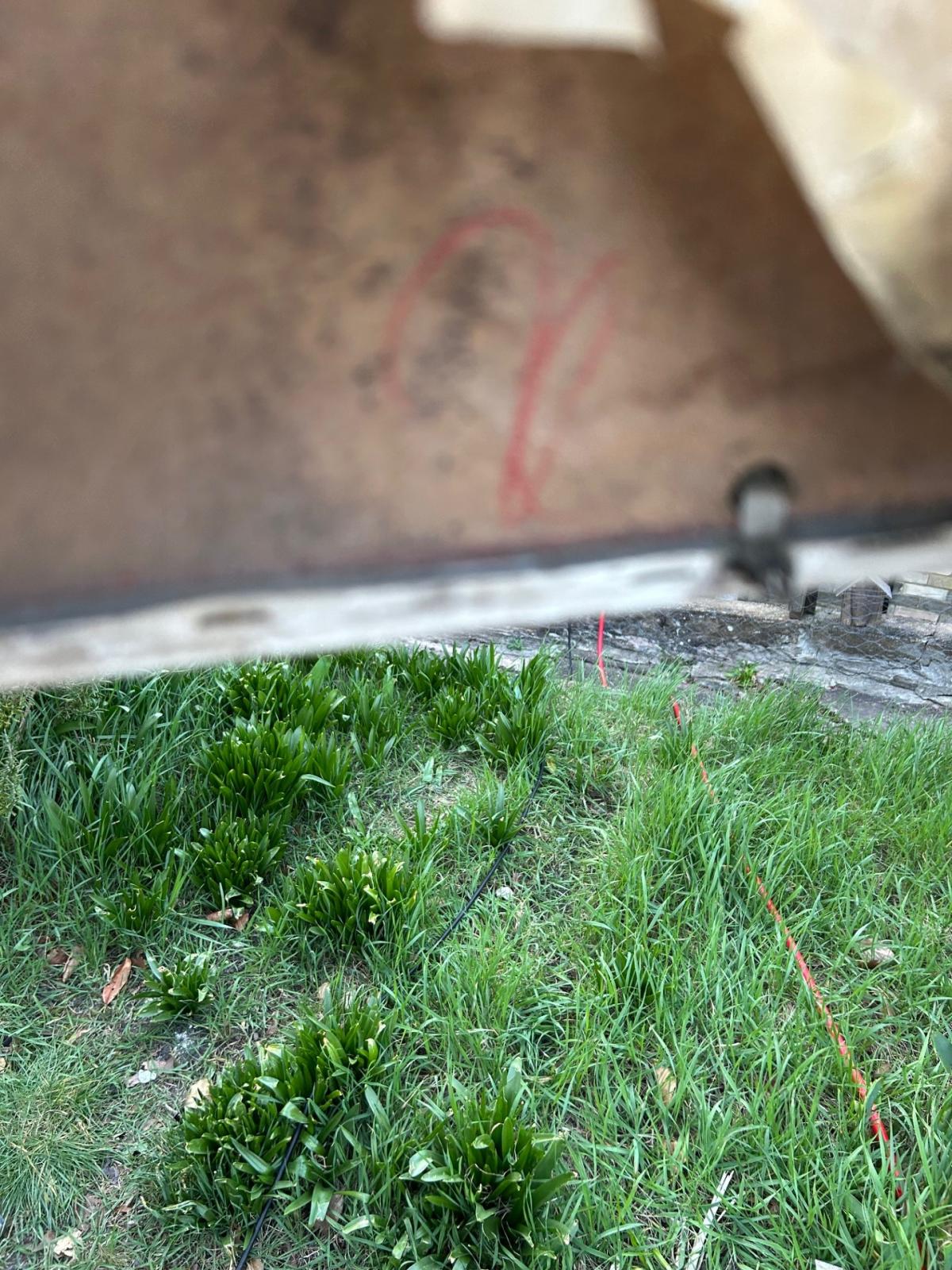

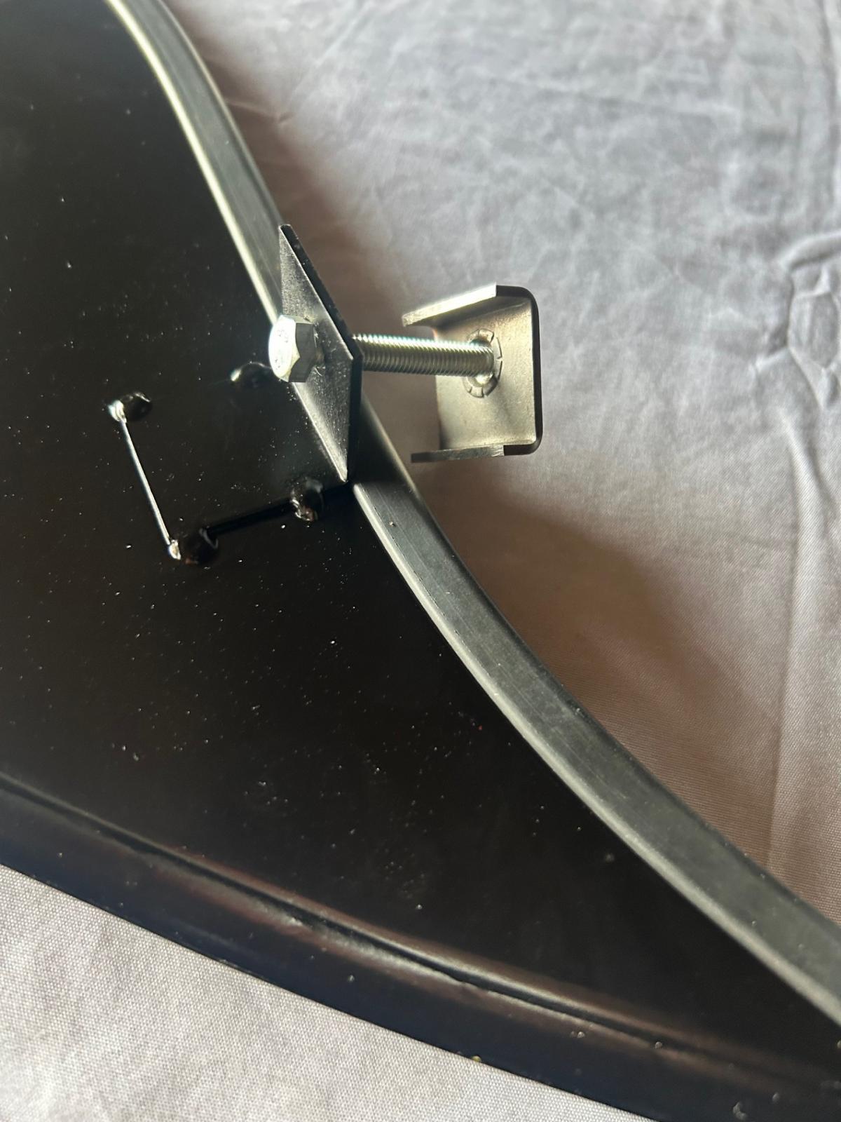

Here is the below mounting solution. A bit different to the other options but seems to work okay. The skirt doesn't have a upper lip to run under the fender this makes it a bit tricky when installing.
I have managed to fit the RHS with a lot of messing around. The hard part is making sure it sits under the fender whist you tighten every thing up. These have been based off a NOS fender but every beetle is different which I found out for the LHS. (Previous whiskey dents and bumps).
This is the RHS.
This is the LHS. As you can see i need to heat up and manipulate the fender to fit and maybe get at it with a grinder. Bit silly of me for not doing it prior.

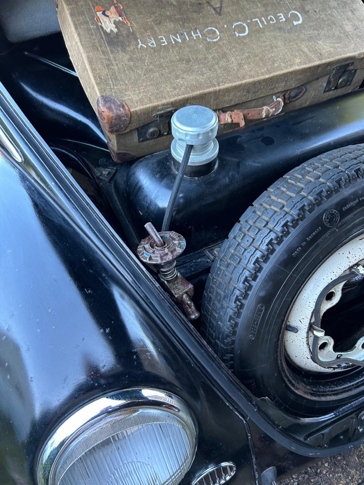

I have also spent some time finishing up the front under the hood. I replaced some hubcap clips that had fallen off the original wheel as well as adding a original Volkswagen spare belt. I got some fuel line for the Swedish fuel tank breather. Still need to get a OG jack & handle as well as a wiring cover.

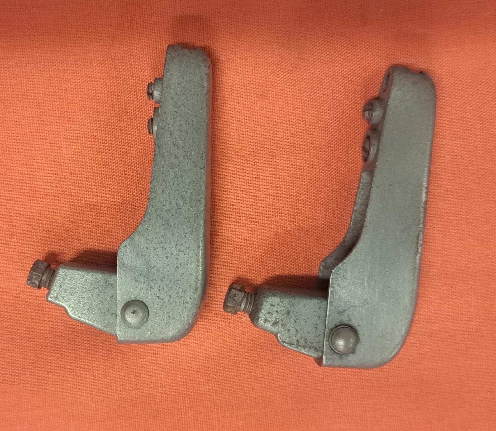

The VW SWF wiper mount had cracked and eventually snapped. I managed to score some sandblasted SWF ones off a fellow UK Samba member at a reasonable price. I have since painted and put back on.

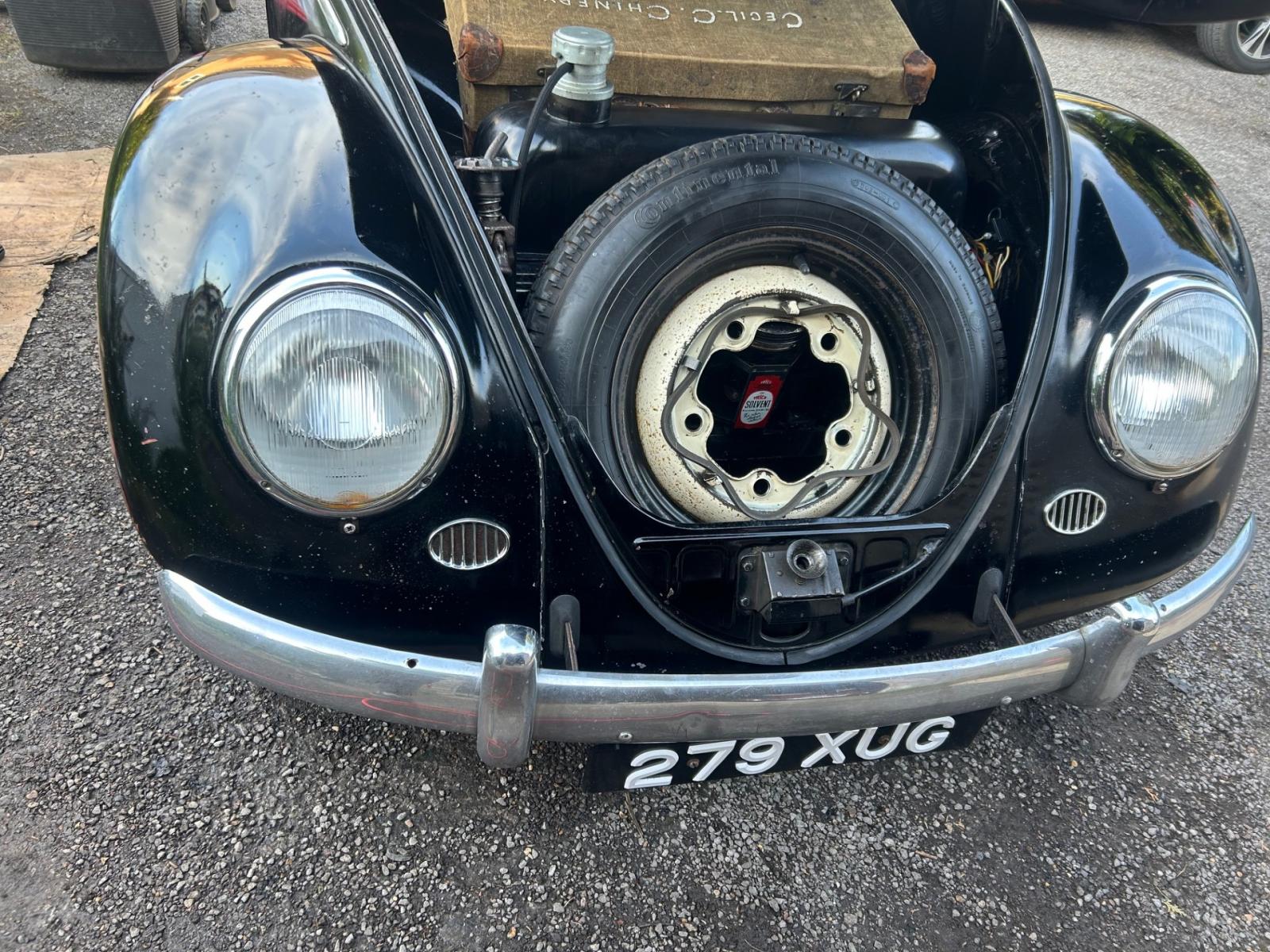

I had the pleasure of driving over to Belgium on the weekend to Freddy Files VW event in Nninove. It was the biggest drive the beetle has done since it was parked up in 2007 in the UK.
We had a great weekend with the beetle driving over 5 hours each way. The only issues we came across was a leaky fuel pump diaphragm and seals. I already ordered a rebuild kit and will be getting on to it straight away. We met so many epic VW enthusiasts and saw over 1000 VWs.

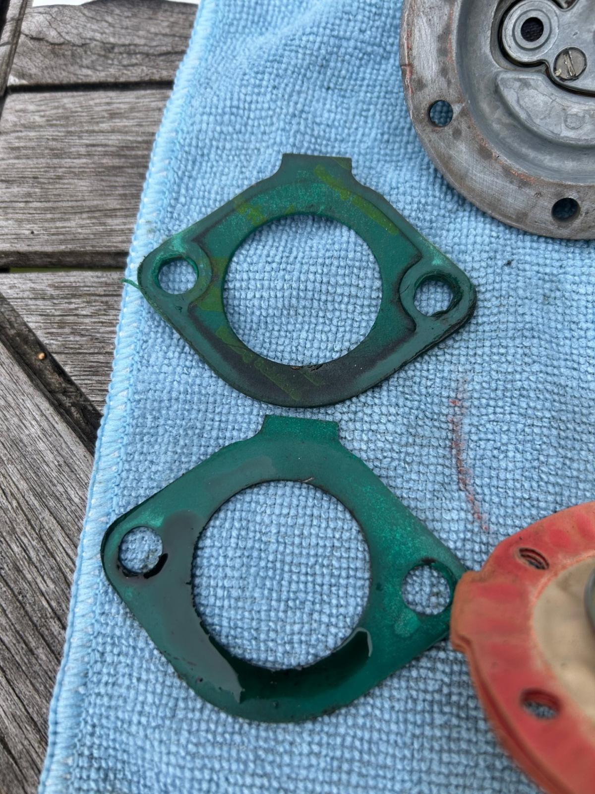

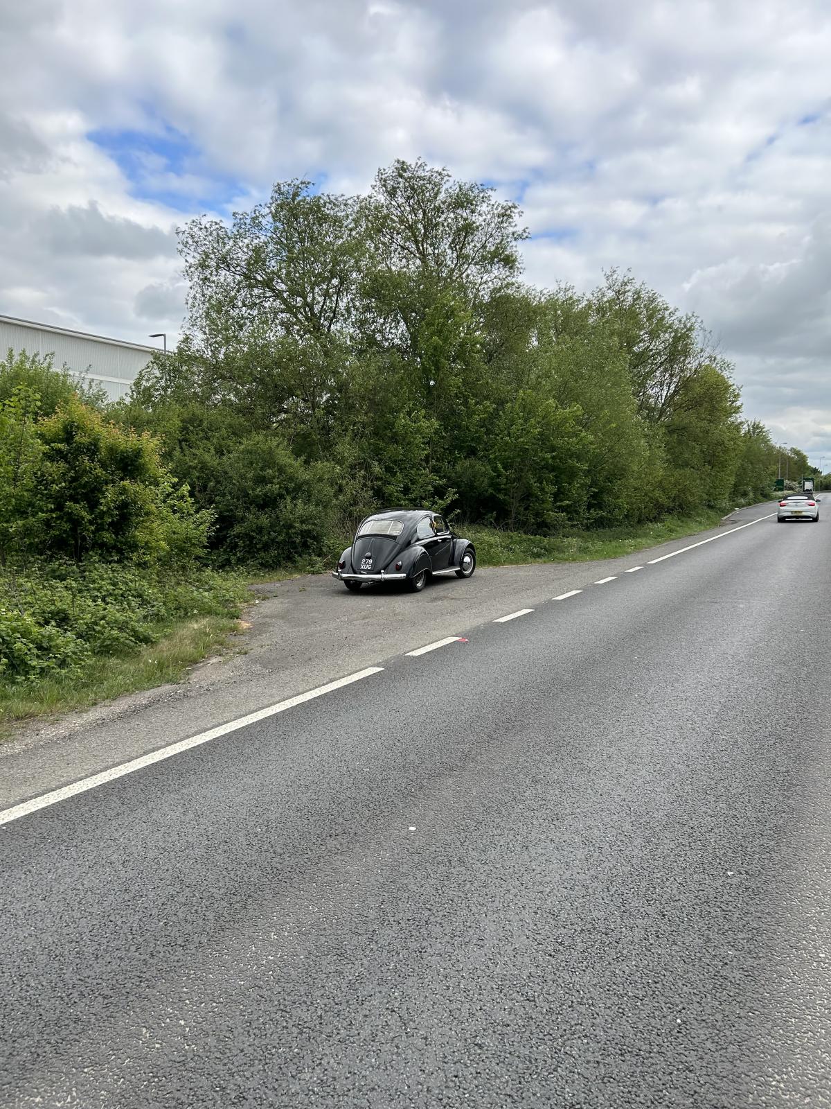

Whilst driving back from Belgium to the UK the fuel pump started weeping then leaking. I tightened up the 6 screws around the top and monitored it during the drive. It seemed to be okay whilst driving but when stopped it would seep out.
So when we got back I knew it was going to need a quick rebuild. I jump online and ordered the parts.

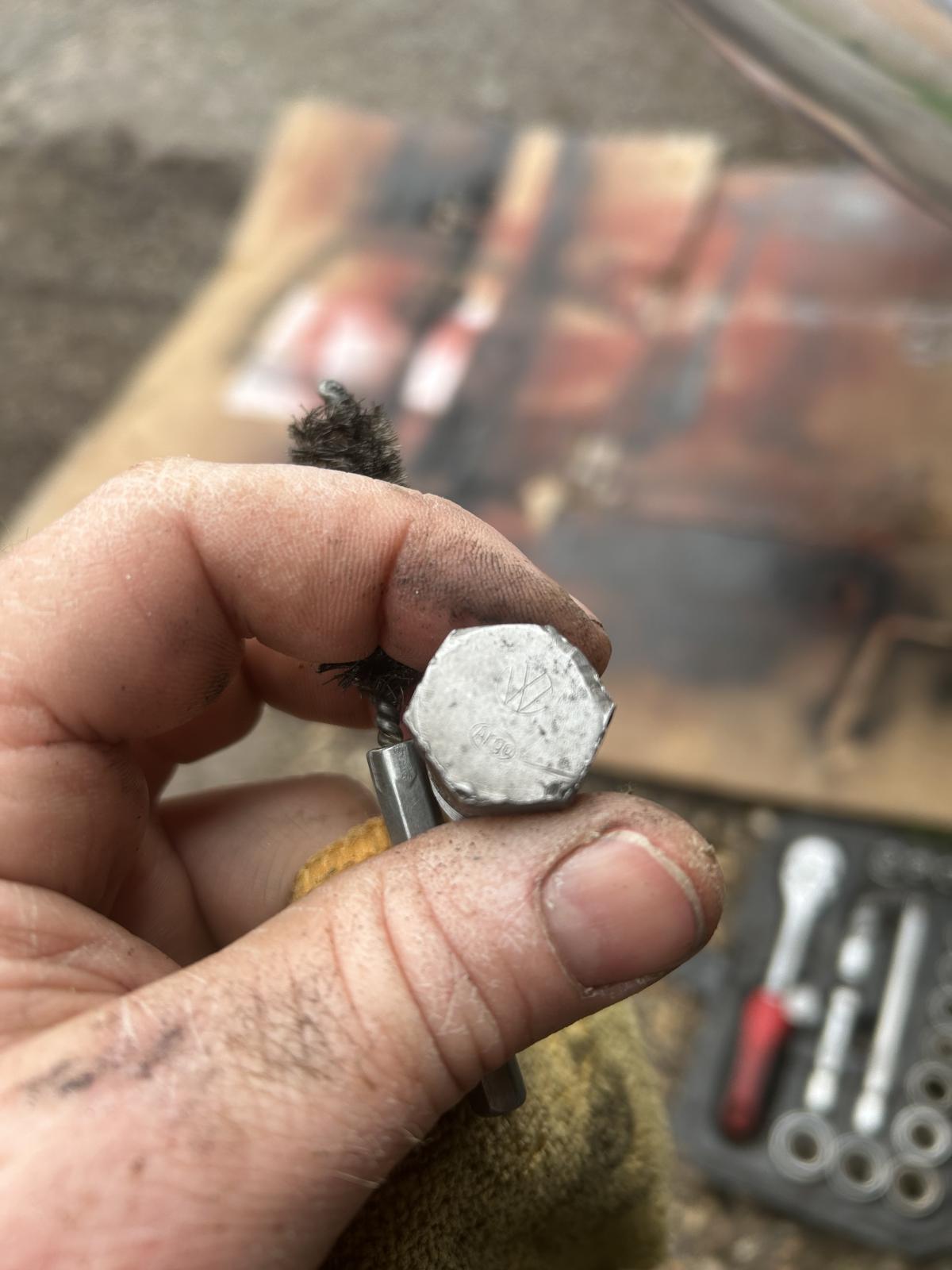

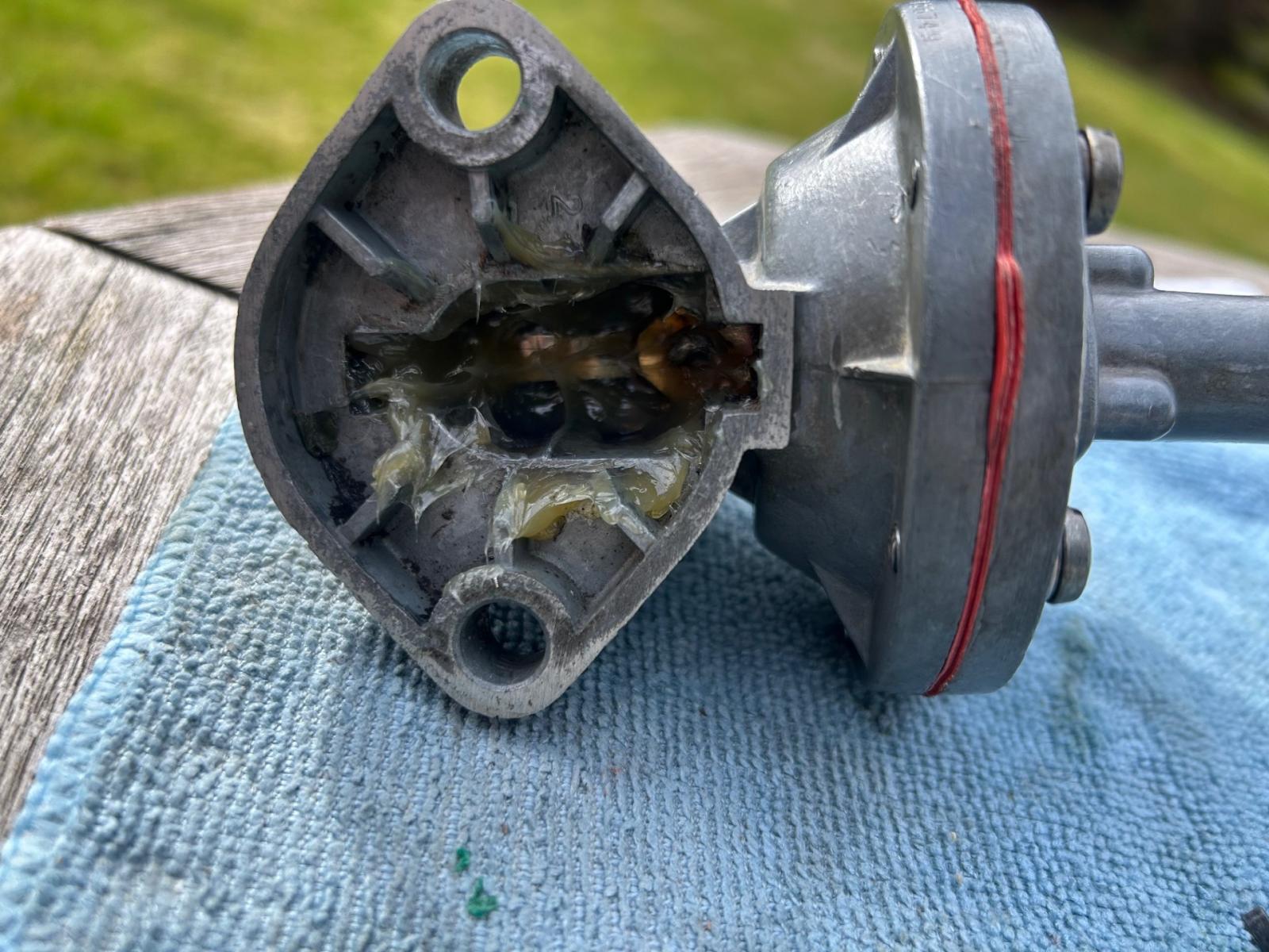

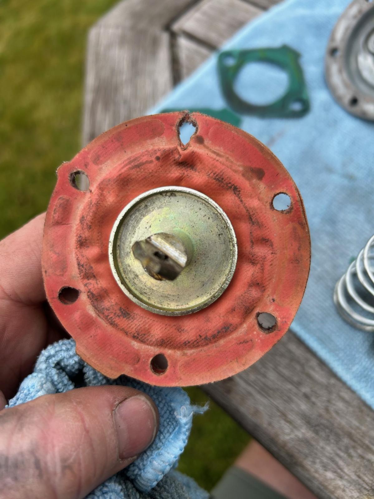

During the rebuild I discovered a few things wrong with the fuel pump.
- The lower half threads were all buggered and I needed to re tap them. One was so bad that they had placed a through bolt with a nut on the bottom. I managed to re tap it and so far it is all good.
- I needed to replace a few screws due to the above issue so I went to the local fastening shop to see what I could get. You can see the difference on a few photos but i am lucky i used them in the end.
- The Diaphragm was torn and stiff from age.
- The pump has had a poor rebuild in the past, the main spring was stiffer than the rebuild kit (I was advised on youtube to use the original, hopefully it was but based on the engine running well on our recent long journey I kept it in)
The green seals had a slight leak.
The fuel pump looked like it had had 80grit sand paper used to flatten out the surfaces, I ended up using 180 grit sand paper on a bit of flat stock to flatten out both surfaces after using a blade to remove the old gasket.
The Diaphragm was torn and very stiff.
After the first rebuild. You can see the waves in in the diaphragm. I did create a makeshift tool to bring the gasket down level and flat but I believe that the original screws didn't have enough bite to bring it together flat. After this i did install for a test and it leaked like a sive.
I regreased the lever.
After the initial rebuild trying to reuse as many original screws, I decided to utilize the new flat head ones i bought earlier. I went through and realigned the diaphragm so that there were no creases and once again used my tie rod remover tool as jig.
After a 30min drive to town and a few laps around our village it was leak free. And running smooth as ever.

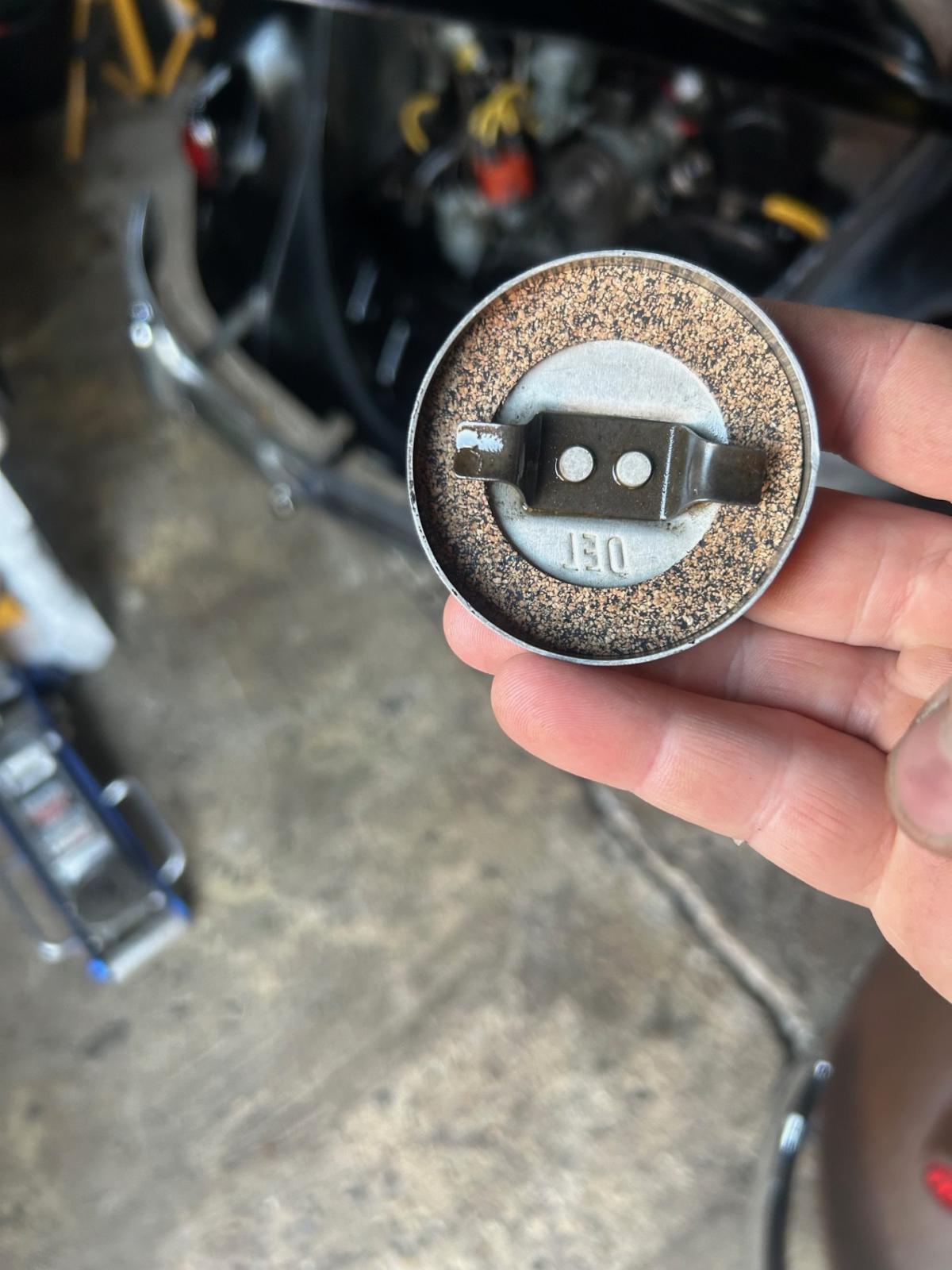

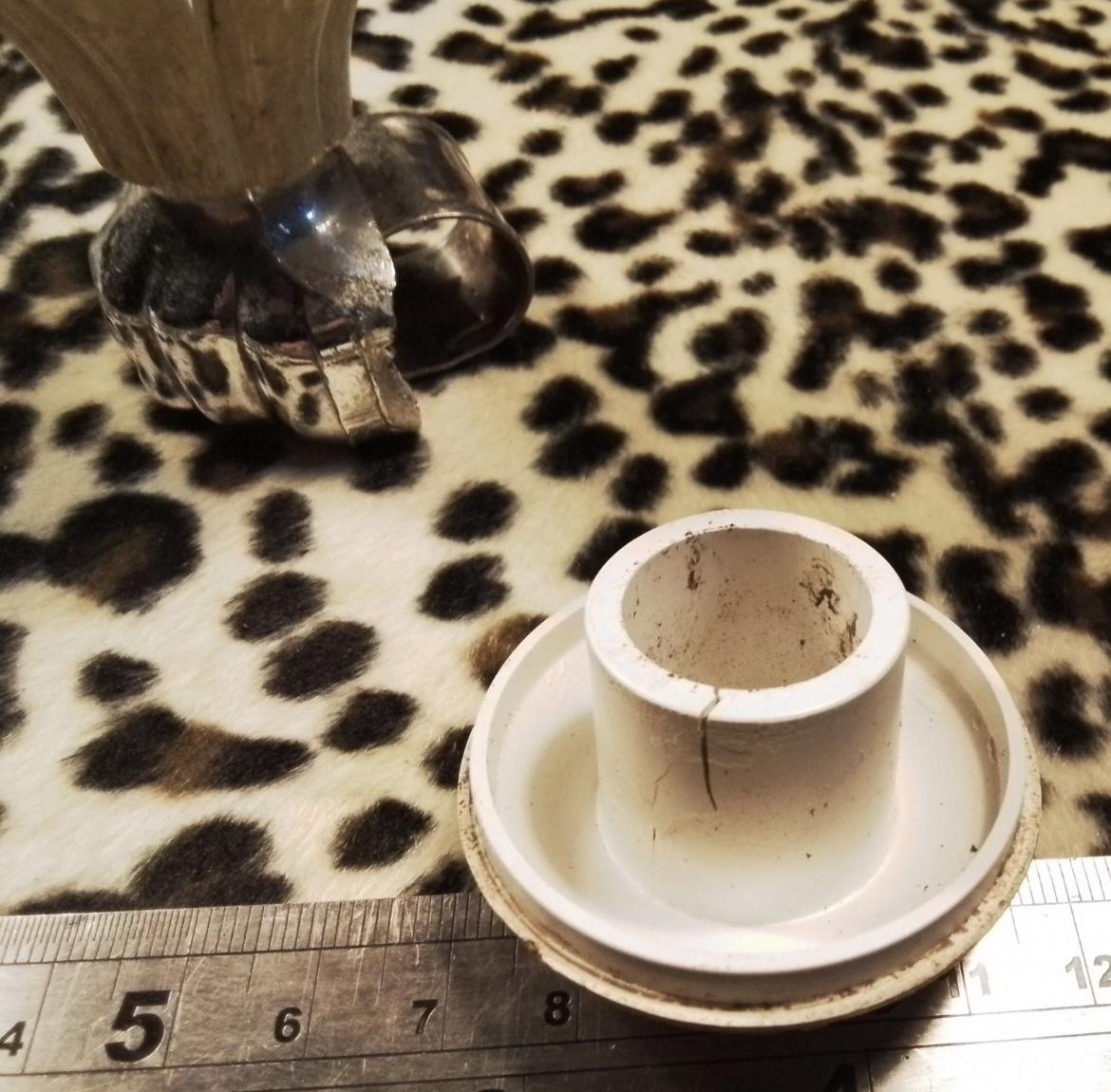

I also changed the oil later that day, whilst filling it up I added a filler cap seal.

That pivot pin for the fuel pump is notorious for walking out and leaving you stranded due to no functioning fuel pump. Since mine disappeared entirely I replaced it with either a shoulder bolt or a pin with circlip grooves so it can't fall out. You could probably bend up a piece of sheet metal to hold both sides of that pin captive for extra piece of mind.

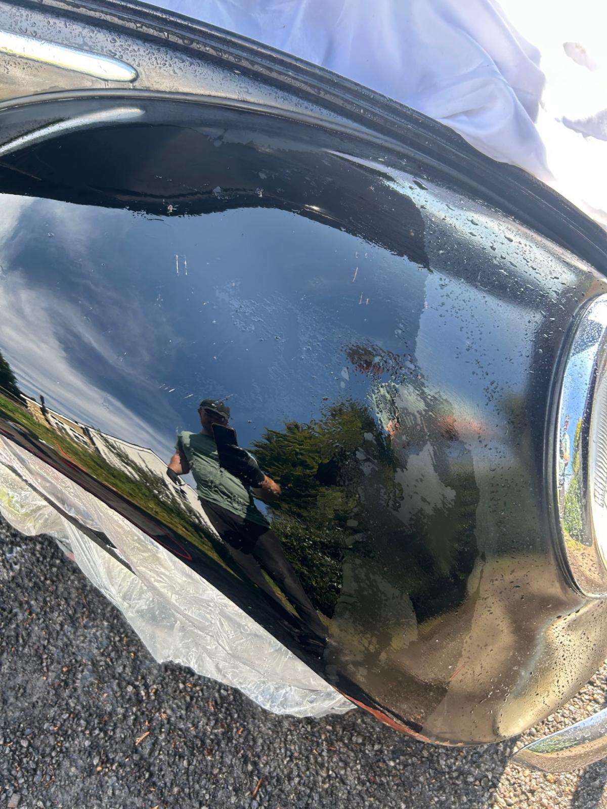

Over the last few days I have been removing the old paint off my beetle with oven cleaner. It is always a initially a scary thing taking a bit of fine steel wool to an alright car. Some of the paint is from old repairs and can be seen to look like it was brush on. I am looking to get the beetle back to its completely original paint. It is very slow and time consuming as there are many different layers and almost every panel requires a bit of a different process.
I have been using:
- oven Cleaner (well known to get that original paint) couple of brands
- Fine Steel wool & Green dish sponge
- Plastic blade
- Rubber Gloves - Have been burnt in the past
- A lot of elbow grease
I started on the drivers side as it was the worst area. The front fender and quarter were the OG paint besides where they had repaired a small accident behind the bumper.
Drivers Side:
The Passenger side was just the front guard as the door and rear quarter are OG paint.
Passengers Side:
The Front had a repair and some red oxide primer. I turned out okay. I also used oven cleaner in the front wheel well.

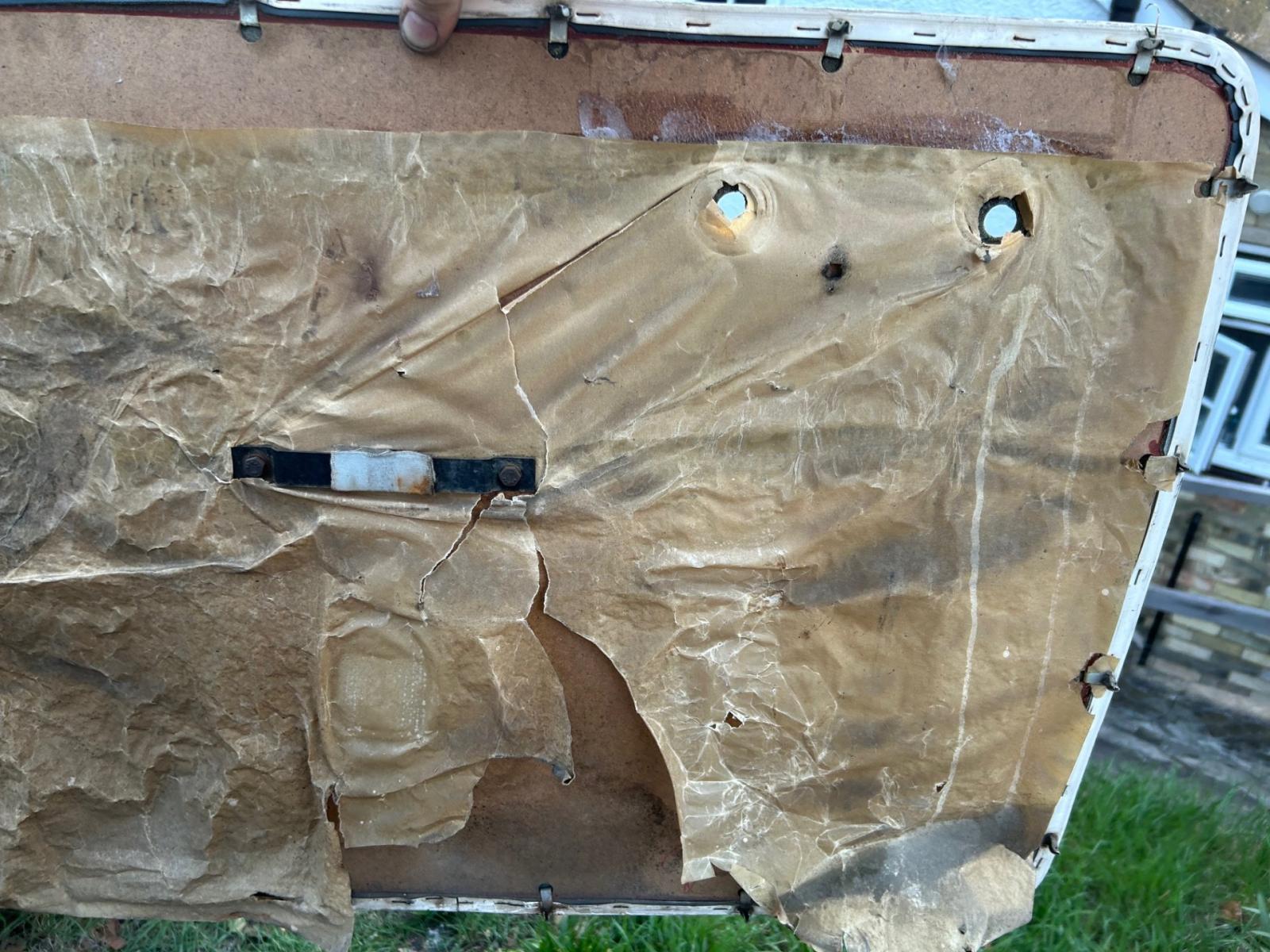

There was also a rattle in the passengers door due to a loose screw holding the center bar in, also the winder mechanism was missing a bold that was in the bottom of the door. I also noticed a few sections that seem to have a wax crayon marking that could be original form the factory.
Door Card/ Passengers Door:

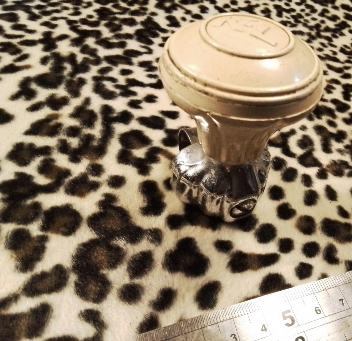

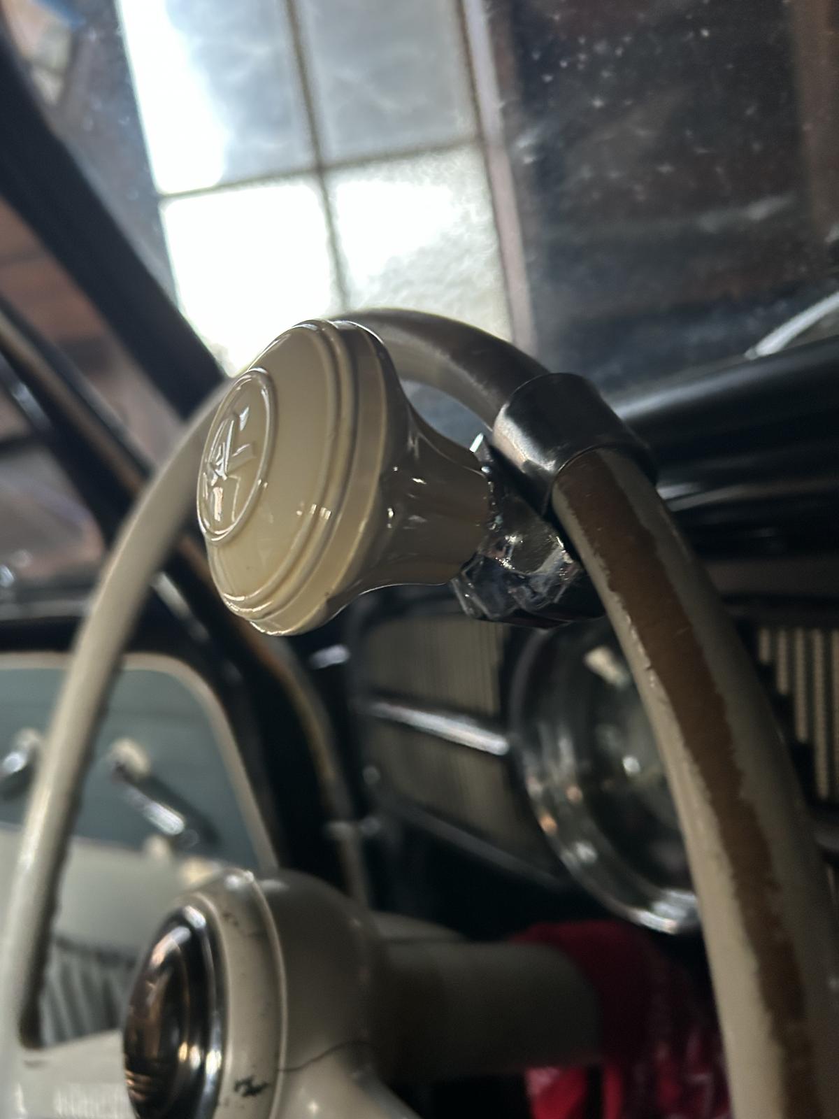

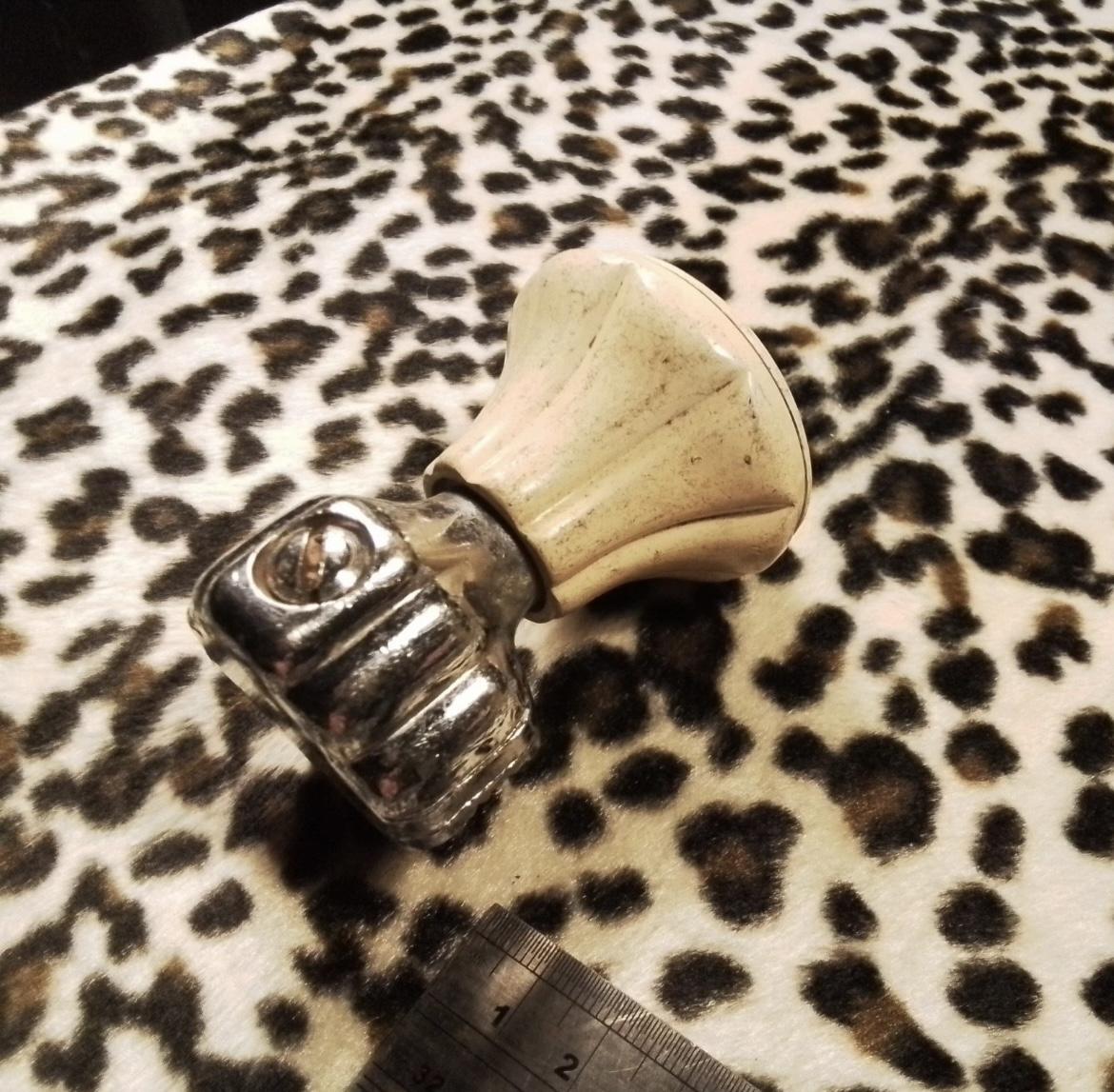

Had a quick few minuets to tidy up a K-L steering knob that I got off eBay. Forgot to get some before and after shots so just using the listing ones. It doesn’t have the bezel but I think it goes pretty well without. It had some cracks on the top so I super glued it up. Then used some jif cleaner to scrub it down. It took away most of the sun damage and discolouration. My thoughts were to make it shine so I clear coated the knob and stripped and polished all the other bits.
Before
After

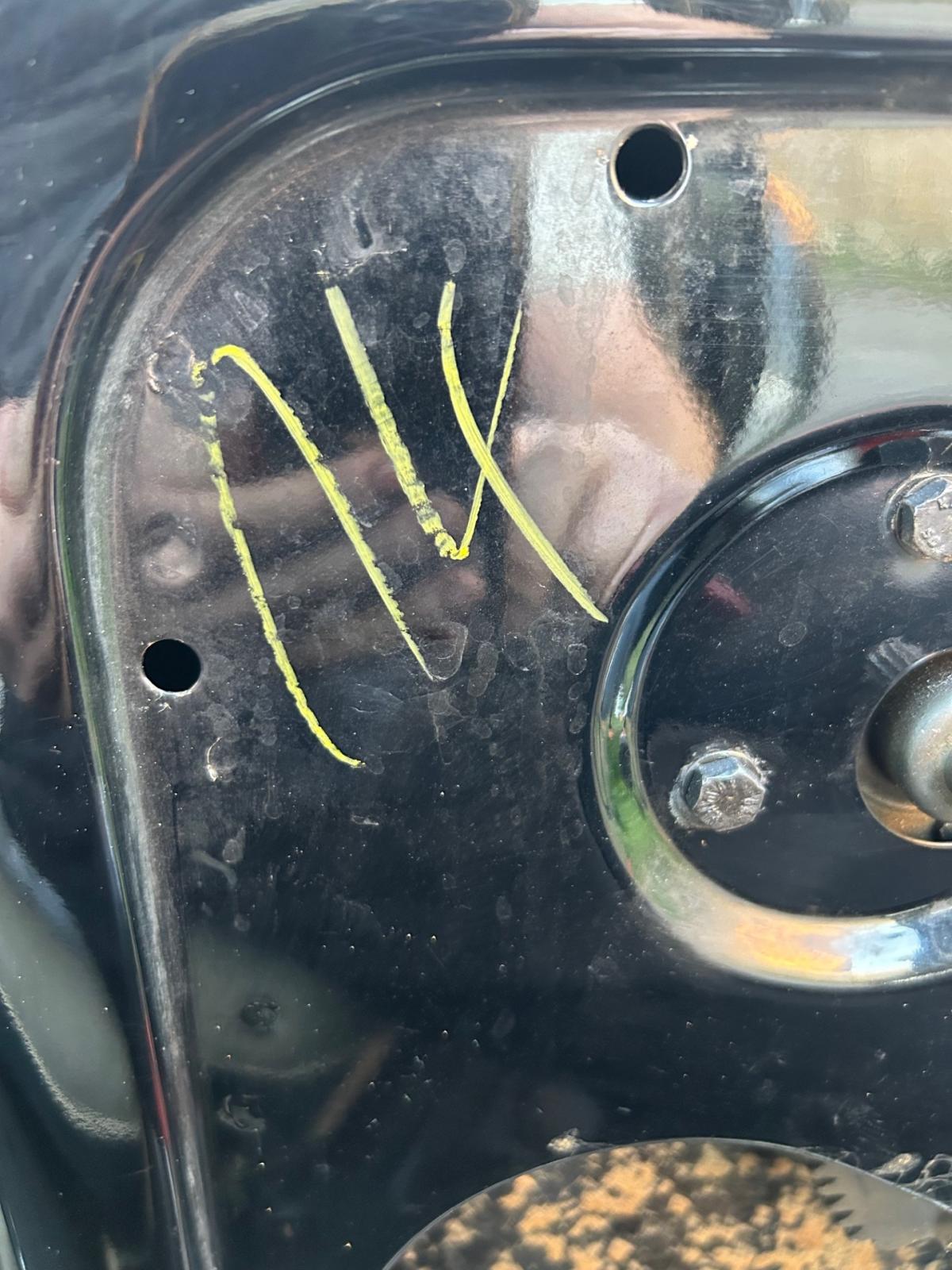

After all the driving around i thought it would be a good opportunity to refresh the gearbox oil. Drained it and was surprised to see it still had the original drain plugs and fill plug. I suspected it was a little low so it was worth doing. Mind the grubby mitts.

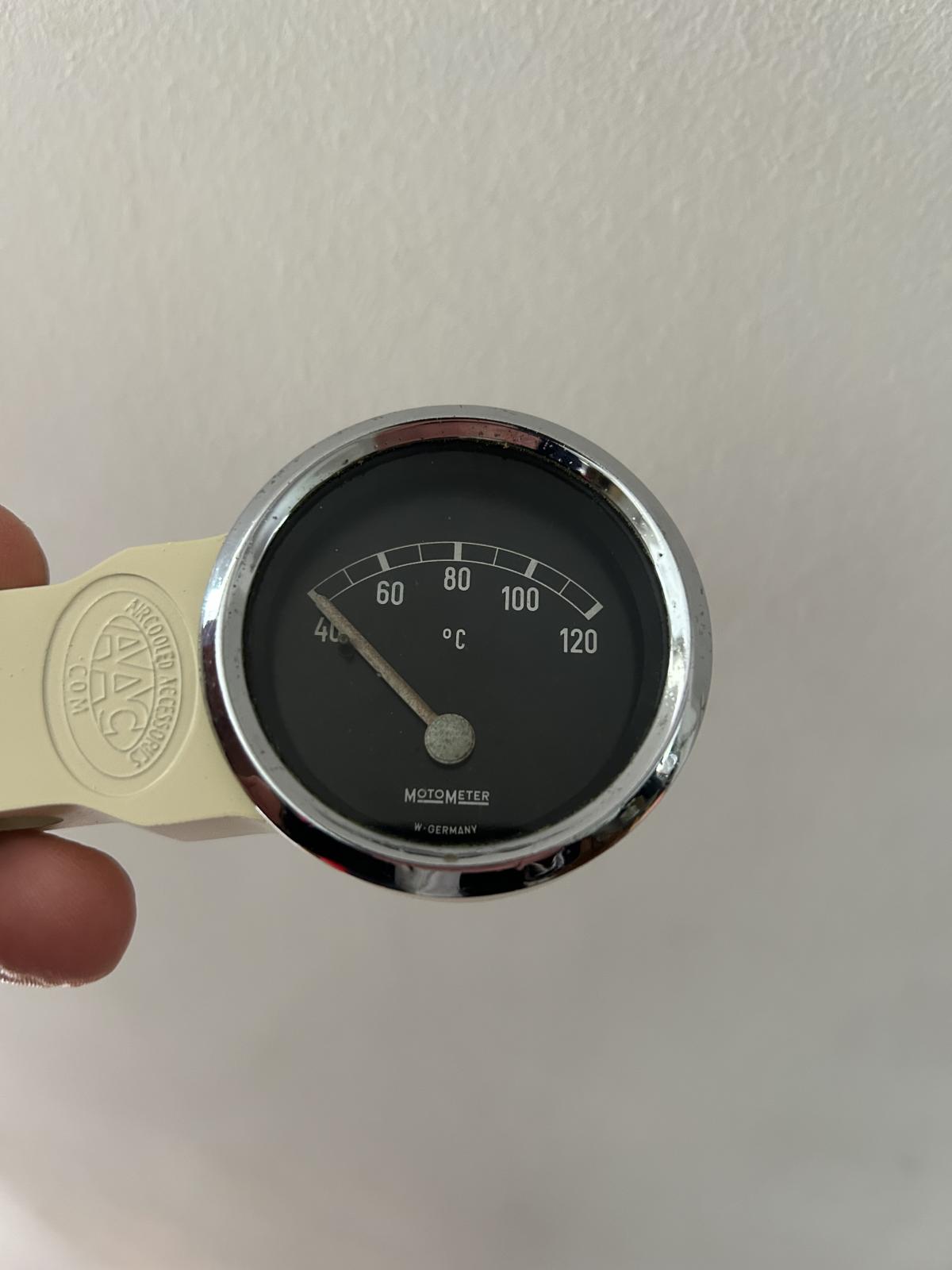

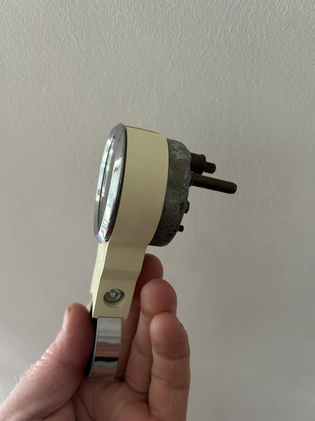

At Stanford Hall I picked up a few goodies, one was this Motormeter temp Gauge which I manged to mount using an AAC mount in Ivory. I need to get the gauge rebuilt to work properly.
