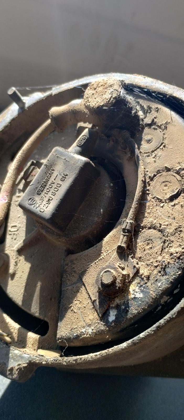

PostPosted: Wed Jun 18, 2025 8:51 am    Post subject: Re: 1979 VW bay window alternator Reply with quote
I am also working on replacing my alternator, wiring harness, external voltage regulator and cooling boot. I'm concerned about frying the wiring harness as I watched bckyrdwizkids video on Youtube. My old alternator had this little rectangle piece, unsure of the material as part of it broke off, kind of felt like dried up wax paper, under one of the nuts. You can see some of it left in the photo of the alternator. The new one I ordered from Heritage doesn't show that piece. bckyrdwizkids video mentions the necessity of creating space between the screws and back plate to reduce possibilities of fire. Not sure what this item is, if I need to buy it or if the new alternator doesn't get as hot as the old one.

PostPosted: Wed Jun 18, 2025 2:16 pm    Post subject: Re: 1979 VW bay window alternator Reply with quote
you really need to be careful of the stud length because it can short out to the backplane. There are many threads here on TheSamba regarding that problem when replacing the alternator.
