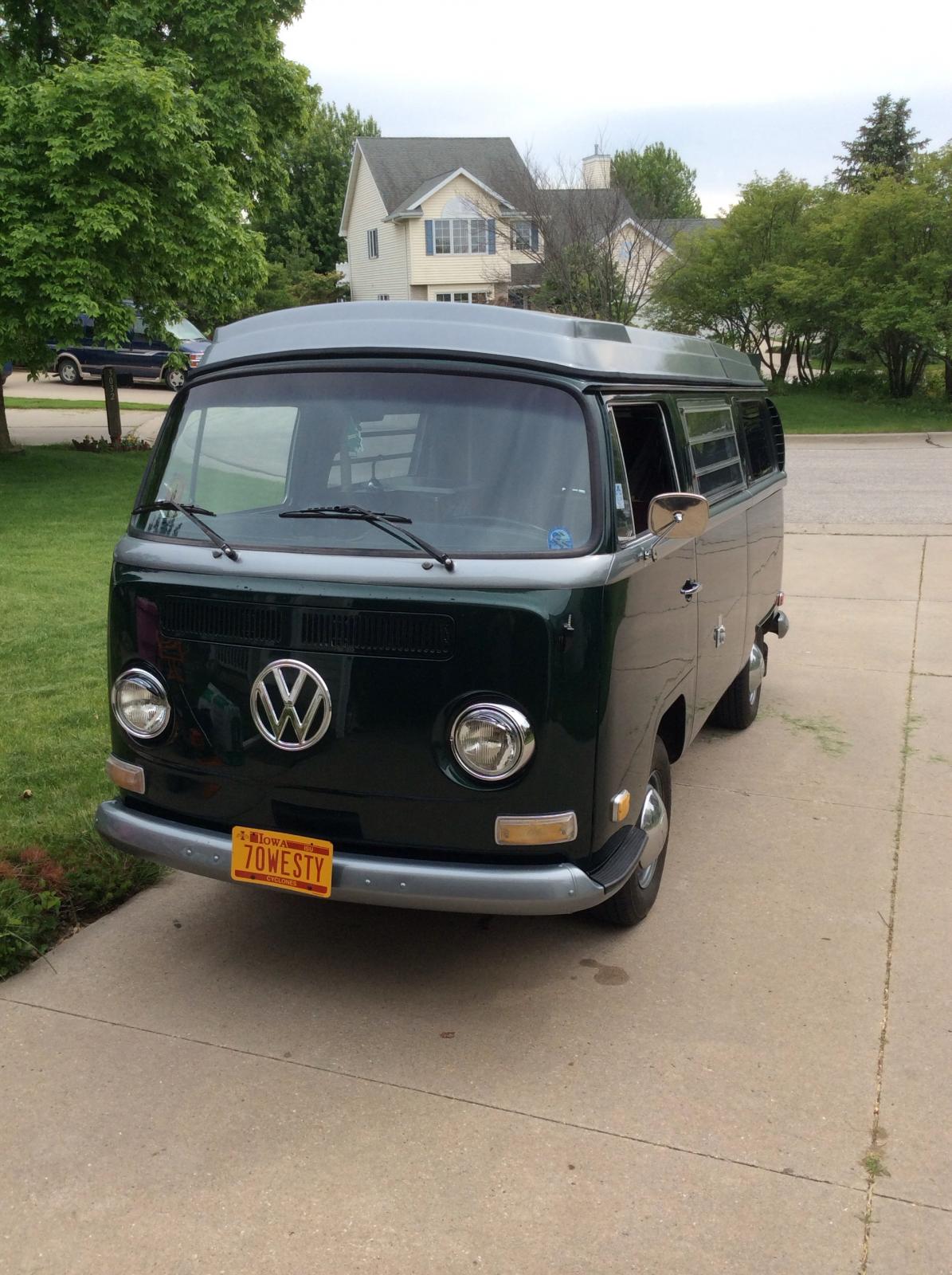

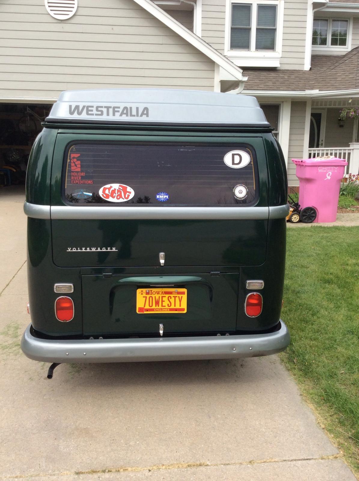

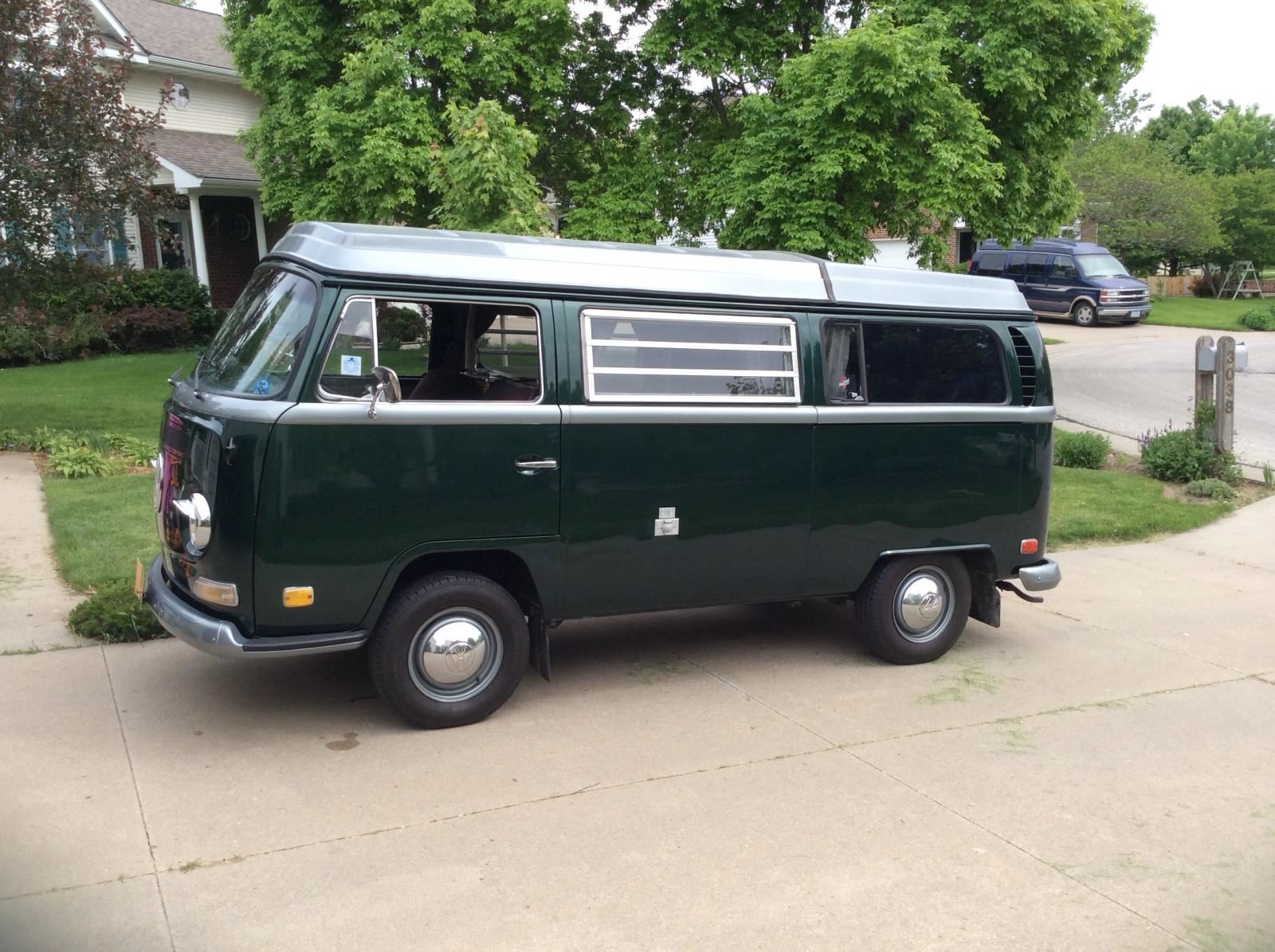

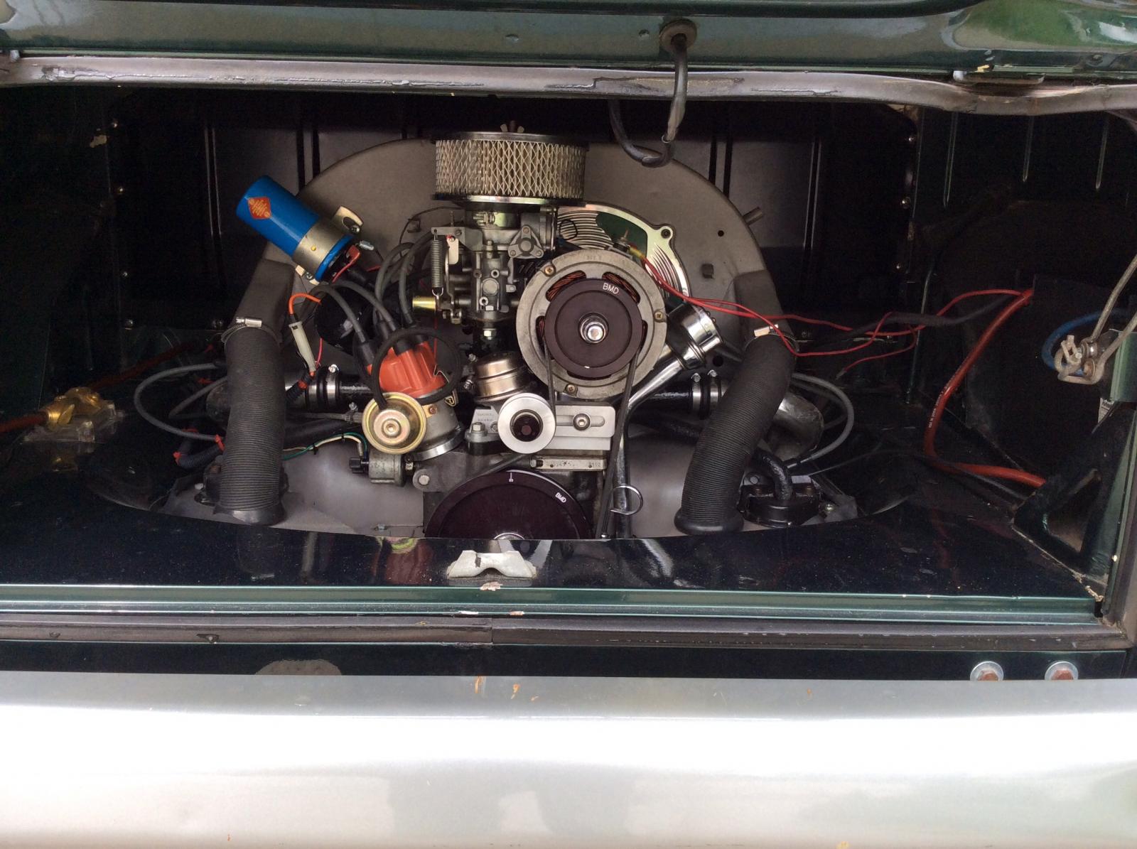

I bought this bus from a guy in Utah sometime around 1998. It was a pretty rust free bus sporting a terrible Earl Schibe paint job. I had it painted and did the interior in 2000. It was my daily driver until the paint job, then it became my weekend cruiser/camping machine. Got married in 2008, and the bus got garaged after a not so smooth family road-trip in 2012. While it sat, the brakes rotted away and it gathered some bumps and bruises from life being shoved in a garage with the yard tools, kids toys, and everyone’s bikes.
Here are some pics from 10 years ago.
Here is how it sits right now:

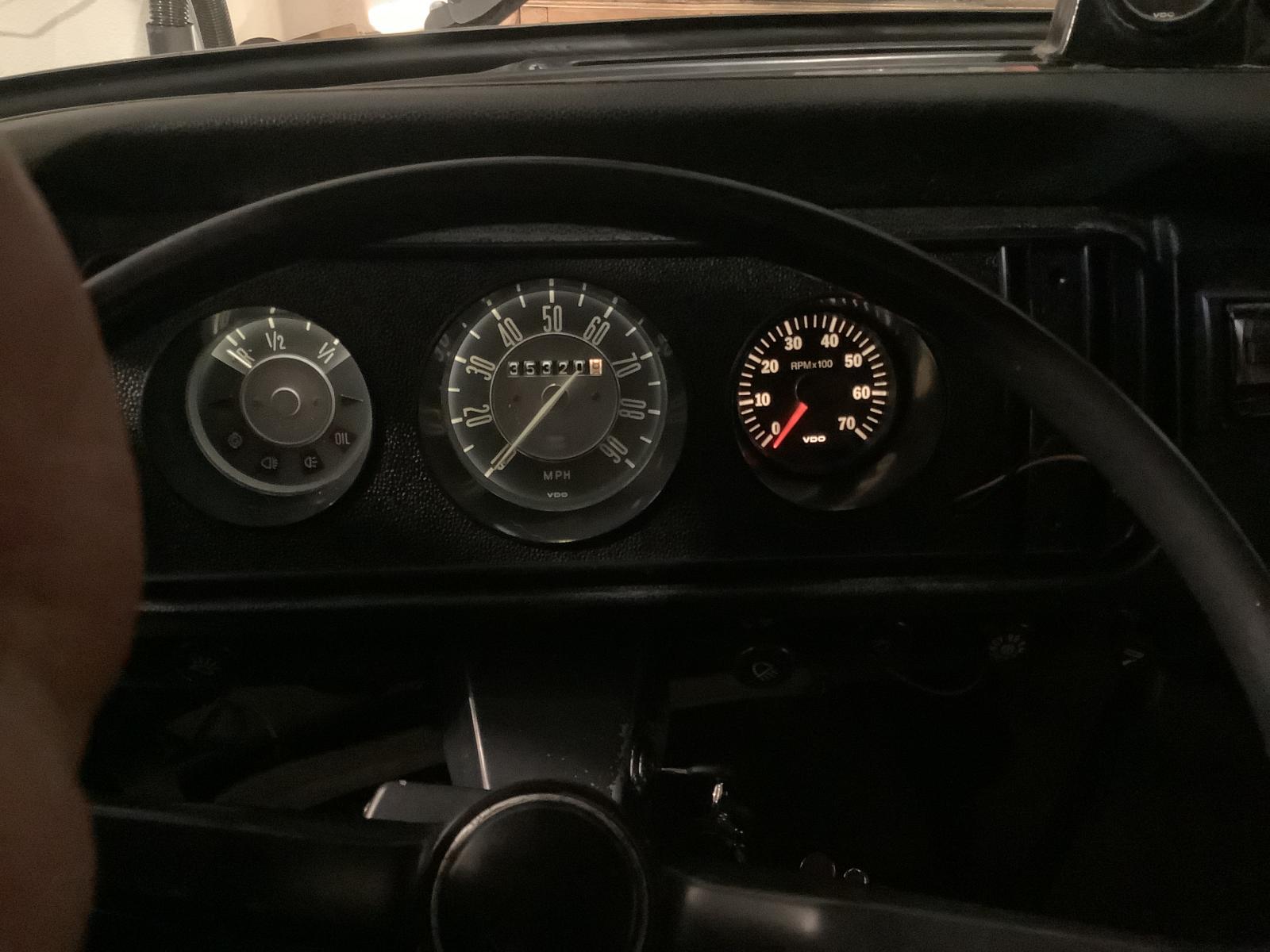

The instrument cluster was cracked, so I found one in the classifieds, installed some LED’s, and transfers all my gauges.

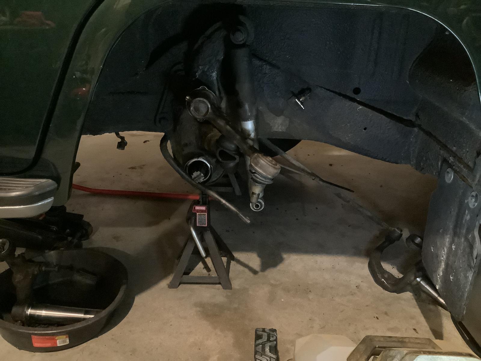

This is the current state of the driver’s side front suspension:

I think I’m going to give up on the C-Clamp press. I have gotten it terrifyingly tight, wracked the arm with a hammer, and heated the arm with a torch. Haven’t gotten a one to budge.
I may try to cut off the flange, but I don’t own an angle grinder. You think a dremel with a cutting disk will cut through the flange on the ball joint?
I may have access to a proper press at my FIL’s farm.
I might call the local machine shop to see if they’d be willing to press the old ones out. I’m minutes from having all 4 arms out of the bus.
Is it easier to press the new ones in, or should I have the machine shop do it?

Press out , press in …
The presser…..
Or go to Harbor Fright and buy one
Ceckert64
Joined: September 16, 2015
Posts: 2122
Location: Houghton, MI and WV
Ceckert64 is offline
PostPosted: Mon Sep 15, 2025 8:06 pm    Post subject: Re: Bringing my 70 back from Hibernation Reply with quote
When I did my ball joints I had to take them out with a grinder/ sawz-all. I had a 20 ton harbor freight press and it maxed it out and still wouldn’t come out. Honestly, just see if a shop with a huge press will do it or cut them out carefully.
There is a strategic method to removing them with a grinder and sawz-all that’s posted on YouTube somewhere and is pretty easy and it took me an hour or so. If you do it right it doesn’t damage anything, maybe better than pressing them out since it doesn’t wear out the trailing arm bore Question
Unless you want to be there for a whole day, I wouldn’t use a dremel
