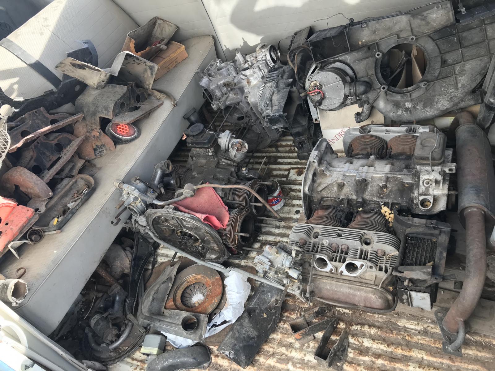

I just bought a 1974 Kombi for $2000. The catch was that the motor was in 3 large boxes. Some of that tin is hard to figure out but it is all finally back in one piece. And your diagrams were the key ingredient. Thank you so much for all the time and effort that has gone into this page..
You're a legend Mate!

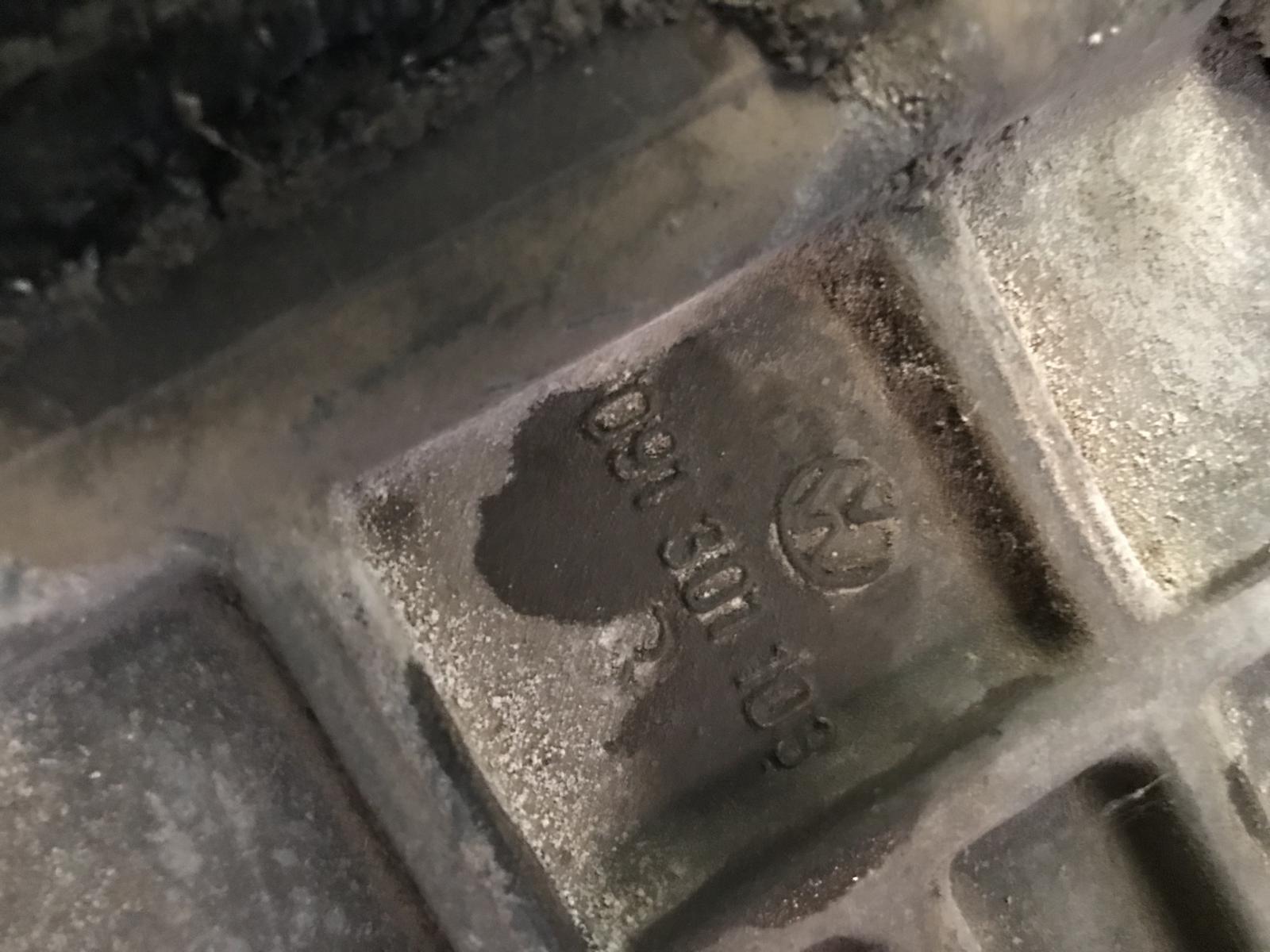

Is there a thread with info on what motors mate best with what transmissions? After reading some of these more experienced builders and bus owners, it seems that tossing a type 4 onto whatever trans came in the bus doest really work out.
Like my situation for instance. Guy finally gets a bus, engine has been pulled, trans "looks" like it was OEM to the bus. I source a few engines but all three are different CC's and production years. How would I figure out (other than R&D real life experience) what engine is best paired with what trans?

First you have to define "best." I am guessing that you mean shorter term as in easiest and least costly to put in, rather than which engine and trans will I be happiest with in the long run.
The easiest and least costly is usually to inventory what you have. When you can't test drive a car you don't really even know if what you have is good. That said, look for the code on the trans and how many ribs on top. That will tell you what it is. Then you can decide if that is what came with the bus and go on from there.
Holy awesomeness! Thanks for those and all the fun studying I get to do now!
In my meaning of “best,” I was looking for what engine and trans paired together have the “best” mechanical lifespan. I don’t want to dive into building one of the engines I have and come to find that the XX case doesn’t match well with the gearing of the XXX trans. I don’t want to wear out one of those components because the other is being outperformed due to the other underperforming? Hope that makes sense... I wasn’t clear in that “best” meaning before, my bad.
2012 Tiguan 4motion
2 Corrado's
3 Beetle's
76 Bus
2 Baja's
66 Pigalle Squareback
80 Rabbit
80 Rabbit Pickup
and still collecting!
Wildthings
Joined: March 13, 2005
Posts: 52329
Wildthings is offline
PostPosted: Mon May 21, 2018 7:32 pm    Post subject: Re: The Type 4 Engine Thread FAQ Reply with quote
I ran for years with a stock 6 rip and a slightly upgraded 1800 engine. Good combo in my mind. You can of course use a 6 rip with a 2.0L as per '76 and later vehicles. I have not run a 6 rib with a 1700 but would think that it wouldn't have enough torque to be able to push a vehicle well.
On the other end of the scale, I doubt a 2.0L engine would be all that great with a 3 or 5 rib tranny if you intended to drive at 65 or above very much.
I now have a worn stock 1800 and run it in conjunction with a three rib with a longer than stock 4th, it seems to be okay, but doesn't like running at 75 as per my old setup.
Mating engines and trannies is pretty subjective, each to their own. Wink
The Dubbernaut
Joined: June 01, 2011
Posts: 166
Location: Kennewick, Wa
The Dubbernaut is offline
PostPosted: Thu Jun 14, 2018 7:55 pm    Post subject: Re: The Type 4 Engine Thread FAQ Reply with quote
So here is what I’ve collected so far. Bottom left engine is a GE, top left is an AW, and bottom right is a CB with heads. I have a fan shroud matching the AW case, and an extra GD fan shroud. Any time I see something VW Bus or Type 4 craigslist ad pop up, I buy the lot. So these are all parts I’ve gathered up so far.
These are the only numbers I can find (right now) on the trans. The bus was moved to my new place and I don’t have a jack, stands, or a lift here yet so I can only crawl so far, and reach random photo positions lol
I’m happy to start building whatever engine would best fit that trans! I’d like to run dual carbs, and I have no issues spending good money on top of the line parts. I’ve got 3 bug motors too and if anyone is in the Spokane Washington area, I’m happy to trade parts for help!
Almost forgot, these parts were dropped off in a garbage sack after I moved into town. Almost threw them away until I heard the metal clinking around. Are these type 4 parts?

timvw7476
Joined: June 03, 2013
Posts: 2488
Location: seattle
timvw7476 is offline
PostPosted: Thu Jun 14, 2018 8:15 pm    Post subject: Re: The Type 4 Engine Thread FAQ Reply with quote
Nice collection.
What Wildthings mentioned is a nice swift VW bus engine/ trans combo.
The earlier AW engine, with slightly bigger intake valves works well with
an 091 box, which is the one you have an image of. Ditto for dual carbs as well,
1800cc pistons (the actual size is 1795cc I believe) 93mm diameter.(work with 091)
Those final pieces are ducting for heat exchangers, through the tin to air
hoses linked to engine compartment fan, ducted forward under the chassis.
The lump second from the right is a charcoal canister.
