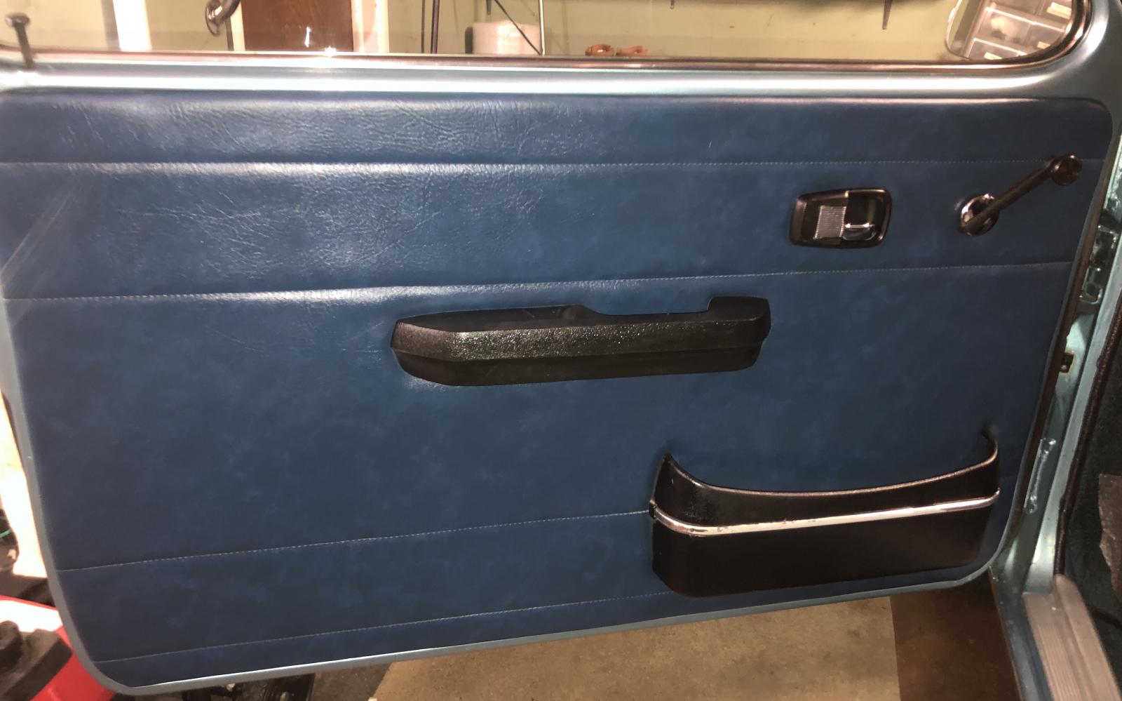

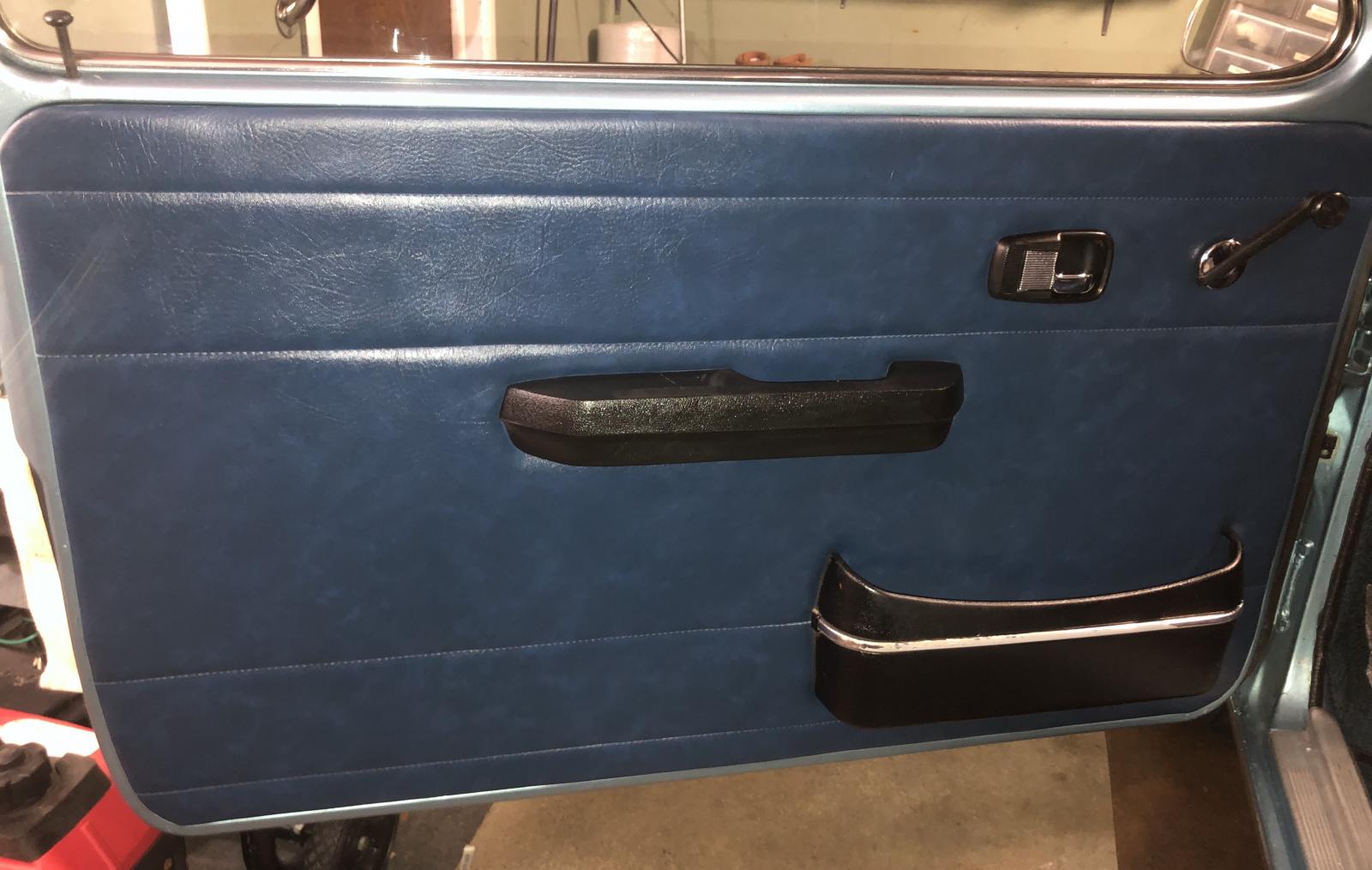

I finally got around to starting work on the door panels. A friend and I put these together using the old ones as templates. I did add a thin layer of foam under the vinyl; whereas the factory did not do that on my model. I'm pretty happy with the fit. The only thing I need to button up is the trim on the bottom storage pocket (it's peeling off). Should be a quick fix.
Thanks to Ray, I now have the correct clips to attach everything. The finished (well, semi-finished) panel came out pretty good:
The driver side is now complete. There is already a huge difference when I shut the door and the car is much quieter. The Q-pads along with the foam under the vinyl in the door panels really makes a difference.

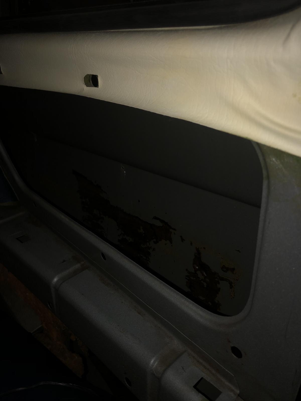

I also was able to do the driver side rear panel:
I just need to find the part that goes under the rear seat side armrest. It looks like another panel piece fits in there, but they never came with the car, so I'm going to have to wing it and make something up. There was a large void under the rear seat side panel. I applied Q-pads there too, hopefully, that will keep down highway noise. It looks like there was a sound deadening pad in there at some point, but it basically turned to dust and I picked the pieces out from the bottom. Hopefully, this week I'll get to the passenger side and the rear trunk panel.

The interior panels look wonderful! The car will become so much quieter after you get them all in.
Glad it worked out for you Ron and Walter to get those trims. Alex Pegado has probably sold out all those trims he had specially made by now.
