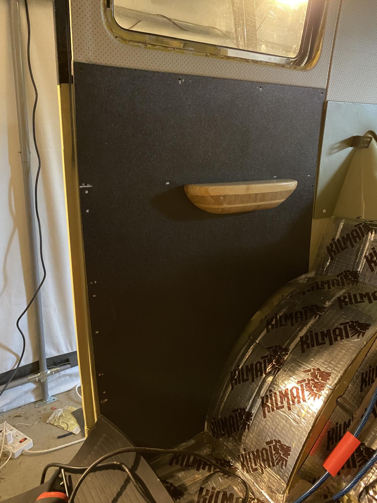

I wanted to continue on with the cargo area, so I completed the left side upper and lower install.

I have seen that before, and it does finish the lower cargo piece nicely. I don't have any of the pea green welting for that. Plus I opted for trying to hide as many screws as possible. The 2 screws in the centre of it will be behind the spare and the other 2 at the front edge will be hidden by the seat back, leaving a clean look.
I had thought of running the headliner bead from the B-pillar all the way back to the hinge cover. Just have to investigate if it can be done the same on both sides. I'm not a fan of asymmetry.

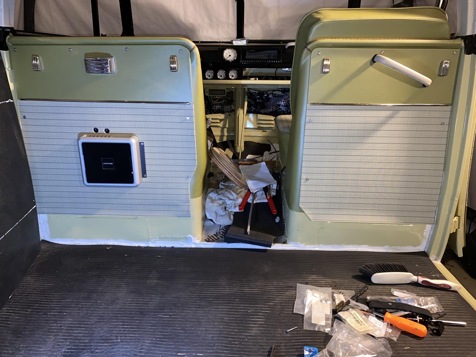

So, it's time for another quick update on the Bus project.
I just had to go through a covid-19 test due to an eye infection (one of the lower level symptoms of Covid-19). Test results were received in 48hrs...negative for the corona virus. Not sure if anyone has had to have a test yet? But, as it seems that the test is conducted different ways in different places, even across Canada. In B.C. the test is a rather unpleasant one. A swab, about 7" long is shoved into your nose directly at your brain stem and then wriggled about for half a second. Words can't really begin to describe the sensation, but it'll make you wash your hands a little more thoroughly from then on.
Now onto the Bus, as I missed a couple days at work I was able to dig into the door panels a bit more.

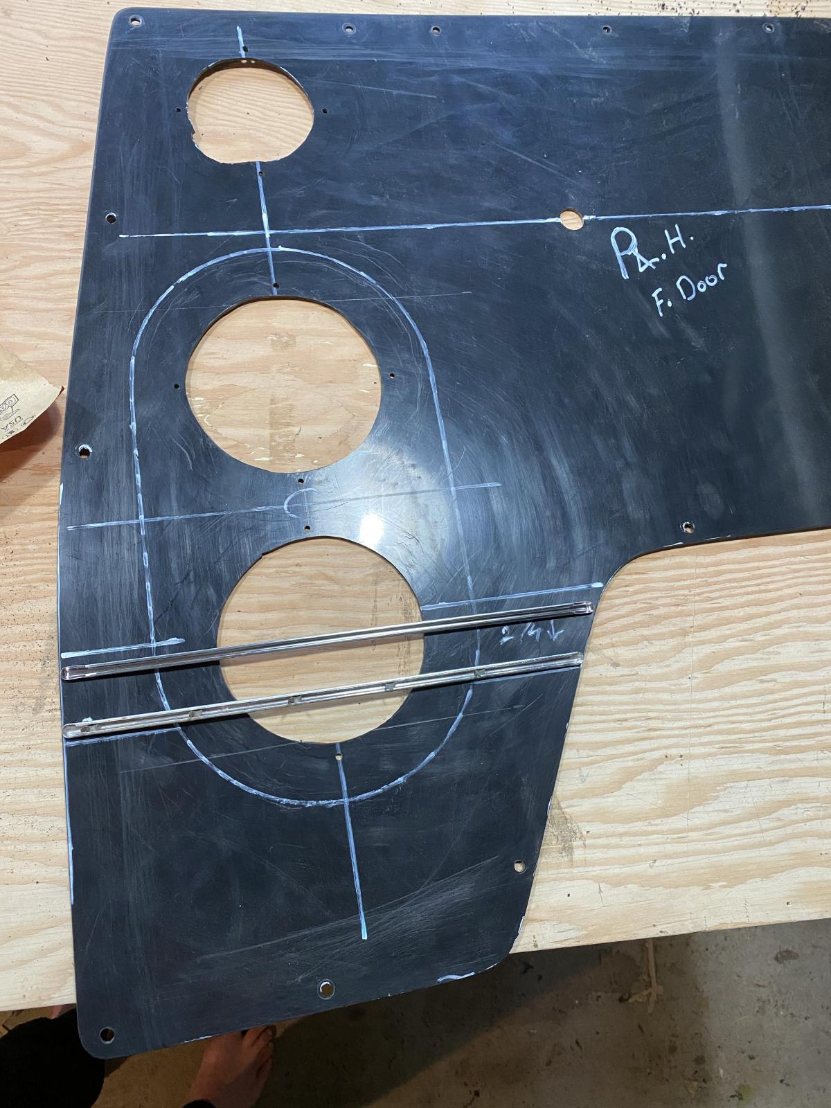

I found an issue with the interior trim that I purchased from Wolfsburg West. The front door lower trim bits are about an inch longer than my original ones. If I was to us them, it would move the colour break on the lower section up 2". Not a big deal....unless I want those lines to line up with the cargo doors. I know what your thinking....just move that line up too. Not a problem, unless I want the cargo doors trim to line up with the walk-thru seat backs. The trim for the lower rubber kick drops down to where the trim should be if I used my original front door trim.
Now looking at the gallery I see many door panels that have the lower trim where my original is, and many that have it where the Wolfsburg West piece would sit. With little rhyme or reason based on year or trim package.
In my case, as I am not strictly conforming to the M-code, or any sort of stock conformity, I will be able to place the lower trim in a position to align all panels with the rubber wrap around trim. The front door speaker pods will be forcing me to cut the trim to fit, so the length of the lower pieces is a moot point, thankfully.
I have all panels cut to shape and mounted (accept the driver's seat back) and I'll begin the process of marking where the previous trim will go. Then the trim will be mounted and then dis-mounted before the upholstery goes on the panels.
This whole thing is a much longer process than I had anticipated. Bully to all those who do this, or have done it in the past.
Just have to install some nut-serts for the walk-thru seat backs rather than using rivets as done originally.

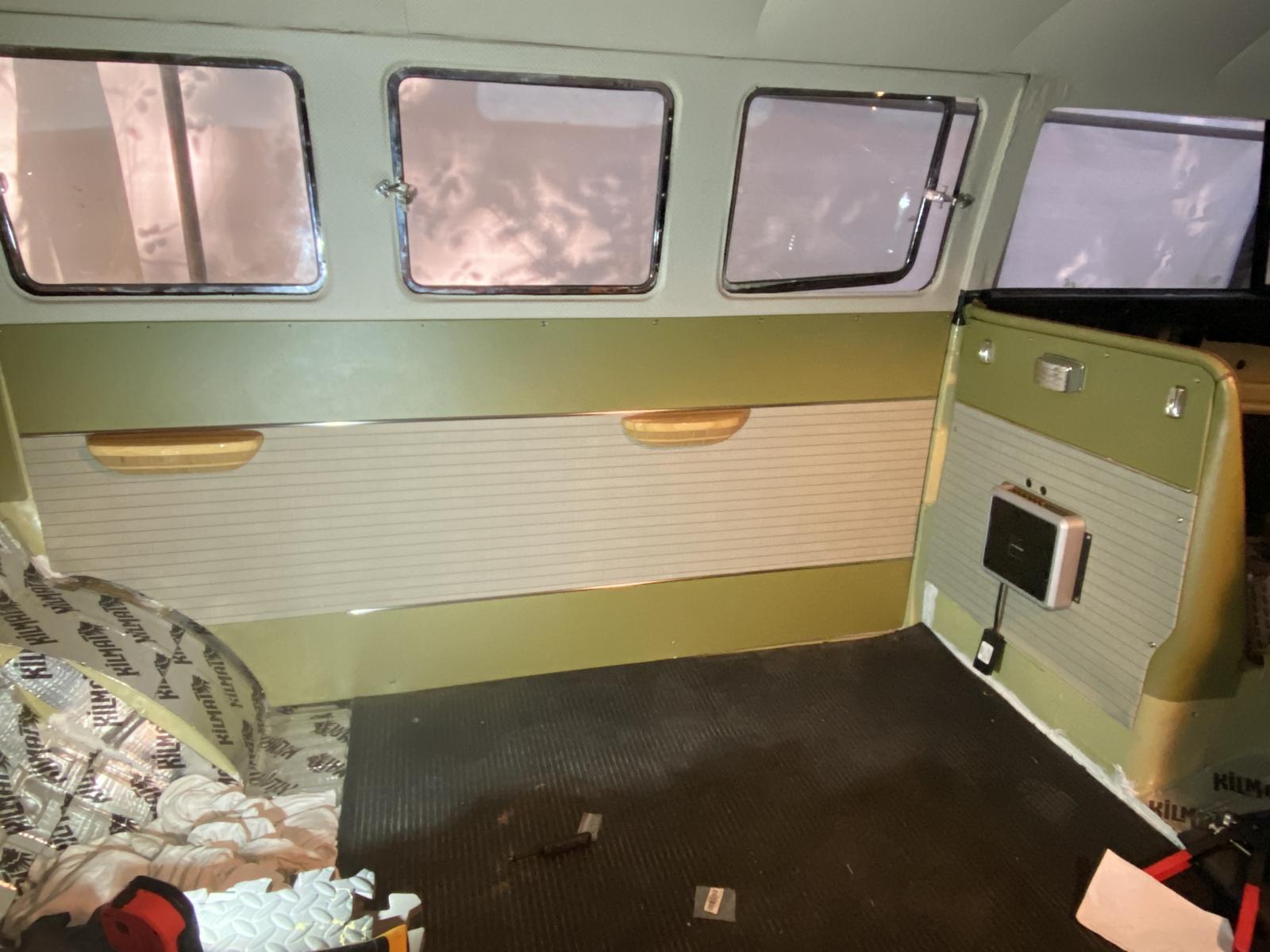

The last panel is now fitted. The Alpine PXE-0850S Audio Processor mounted in it's location with holes for all the cables punched through. I will still need to fabricate a cover for 10 RCAs to keep it tidy looking. I know that is not the correct location for the ash tray, but the back of the middle seat looks so clean without it. I think it looks alright there. The other little stainless pieces are small fold down hooks. Thought they would be handy for hanging towels, beach bags, or shopping bags.
Now I can mark out where the division of each of the panels so it all lines up. Once lines are drawn I will begin the task of drilling all the mounting holes for the trim.
I should be getting on with the upholstery pretty quick. Maybe that's how I'll spend my Canada Day.

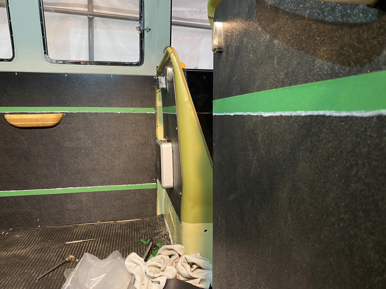

The lower trim lines on the door panels alignment reference point starts at the trim line for the lower rubber wrap around kicks on the walk through.
The upper trim line aligns with the centre of the door handles on both the front doors and the cargo doors.
The trick, in my case, is using those references to align all of the trim lines. Using careful measurement and the application of masking tape to eyeball verify the alignment.
I then rechecked that I had enough of the Silver Beige material by marking out a rough cut line for each panel. One bonus to the Silver Beige material is that my centre panel measures 15.5" , which just happens to fall directly on the more solid lines in the pattern, making for easier precise cutting.

One last alignment check before I start drilling holes for the trim.
Notice the front door line looking through the walk-thru.
Think I nailed it, hopefully I can drill that straight.

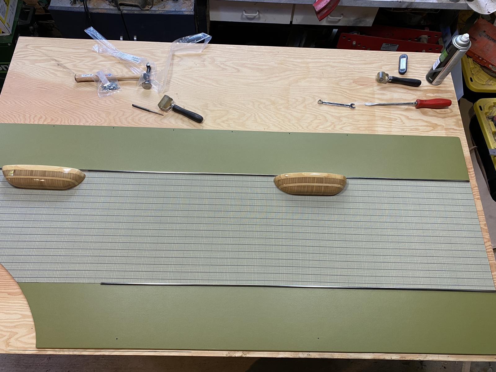

Well, all holes are drilled so there's nothing holding me back from laying on the upholstery.
One done...

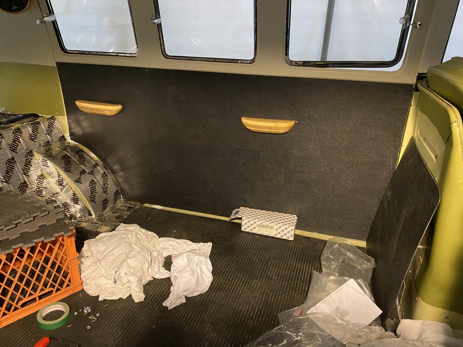

So the wax paper idea would be great, however, I can't seem to find wax paper in rolls wide enough for this purpose. Still looking.
I have managed to put together another cargo door panel and mount them on the doors. All trim lines still line up nicely.

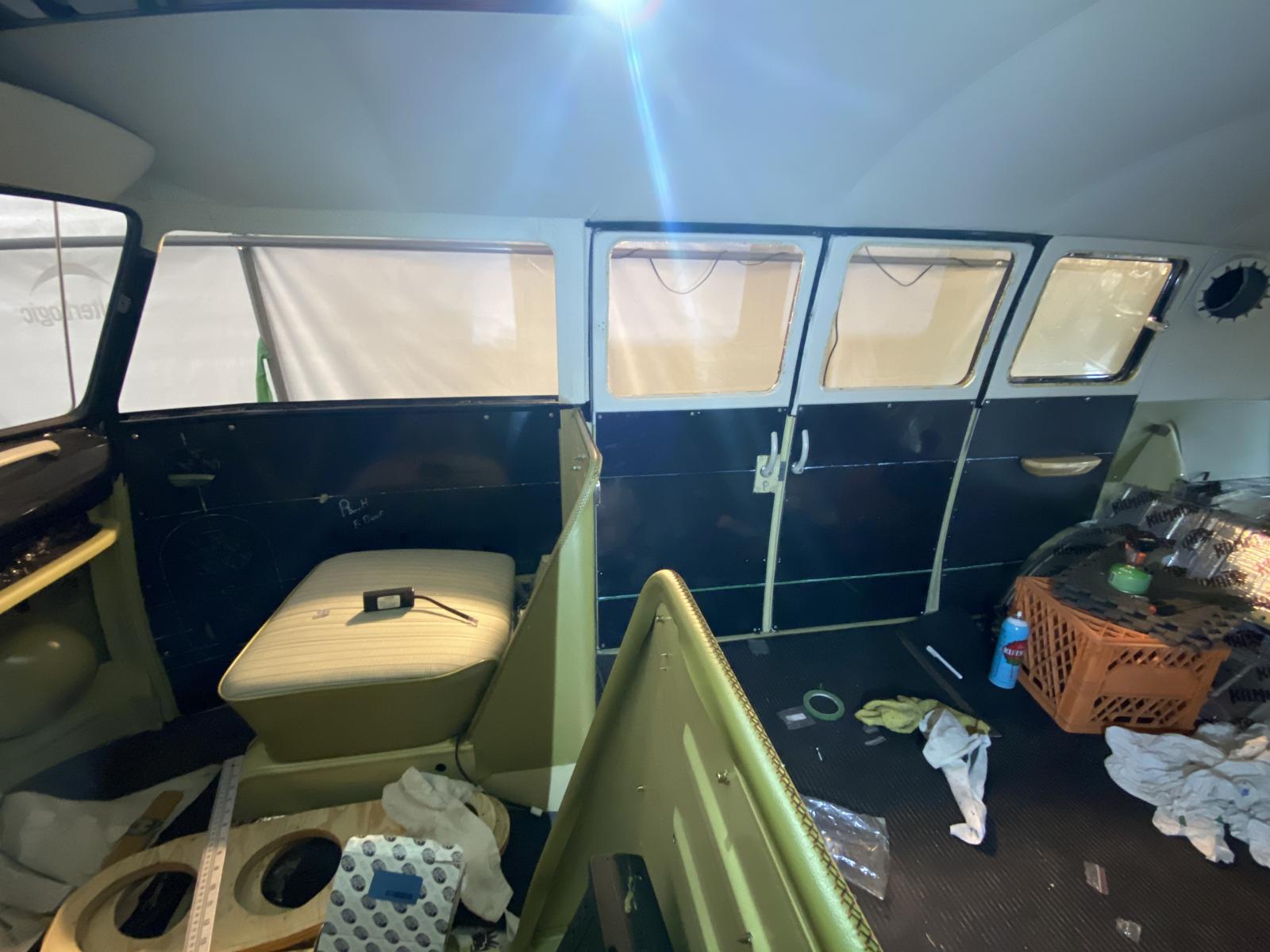

I am trying to get one panel done a day (after working a full day and making dinner for my family). The next panels are going to be the tough ones; the long panel and the front doors.
Here is where I'm at now.
I found a new trick for aligning the upholstery when sticking it down. I am now aligning the piece unglued, taping it along on the mating edge, then folding it over to apply the contact cement. Once the cement has set up , slowly fold the material over laying it down gently while smoothing it out. This may help a boatload on the long panel.
Gordo.

PostPosted: Sat Jul 18, 2020 1:21 pm    Post subject: Re: Canadian 1967 11 window restoration. Reply with quote
Well there is always something that comes up that seems to weasel it's way in front of the Bus project for time and money. This time it was the septic field... shitty job, but someone has to do it. Fortunately for me, my Brother-in-law used to do this for a living and I used to work for him. So we did it all in a day.
So now my weekends are being taken up with clean-up and yard work I just have evenings to work on the Bus.
One of the main reasons I chose to make my own door panels, was that many of the big guys (TMI in particular) does not offer the long panel in one piece. Most likely because of shipping sizes.
I was able to lay the material out, tape down the one edge, glue it and flip it method. Which seemed to work well for me.
The arm rests are made of bamboo and a 1/4" layer of Birch plywood. The bamboo was sourced form dollar store cutting boards, which were cut, laminated and then shaped. The coating on them is West systems epoxy resin and then coated with a lacquer to help with UV stability.
Now I am starting on the walk-thru rubber kick wrap around and trim. I have my old pieces of trim which will help in the shaping of them.
