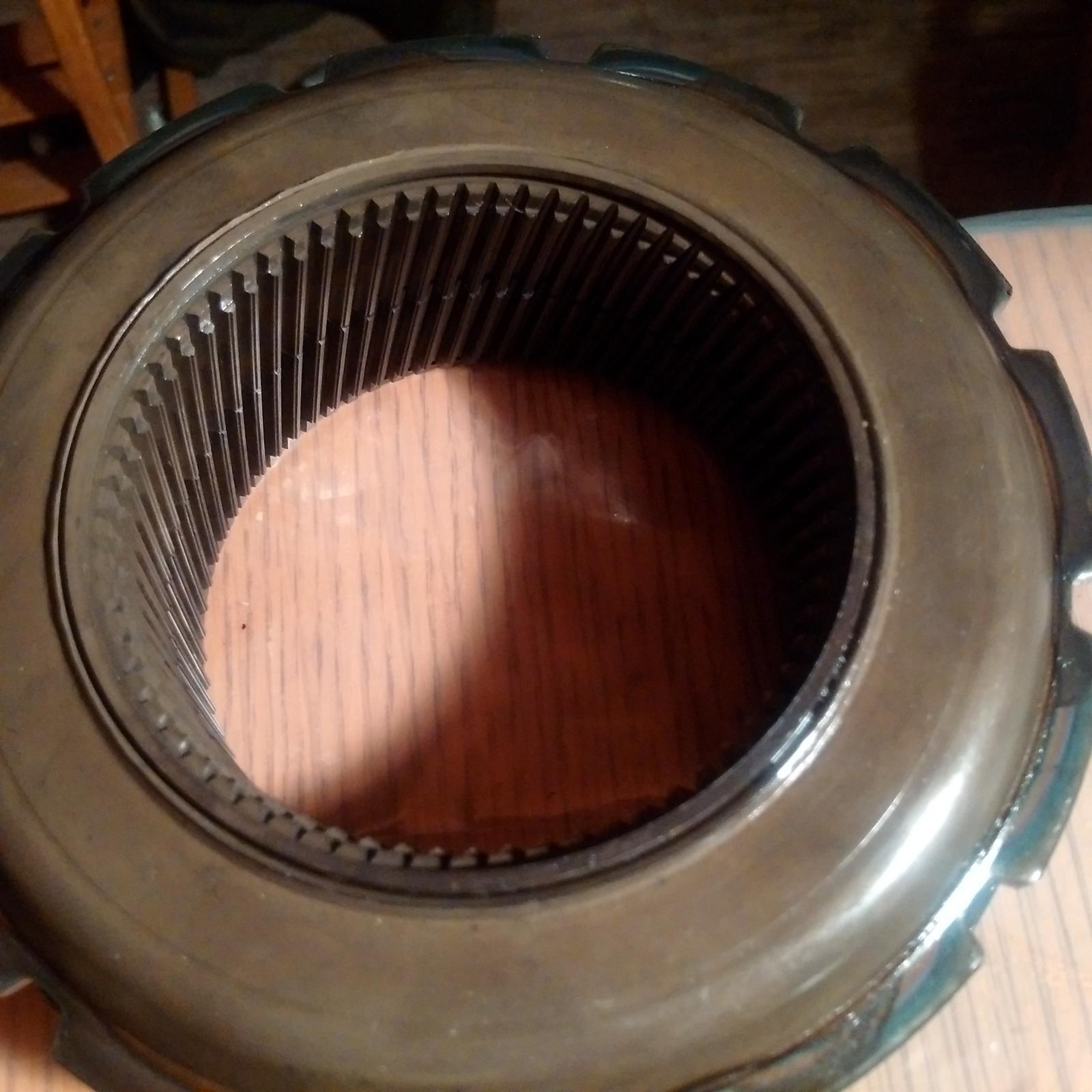

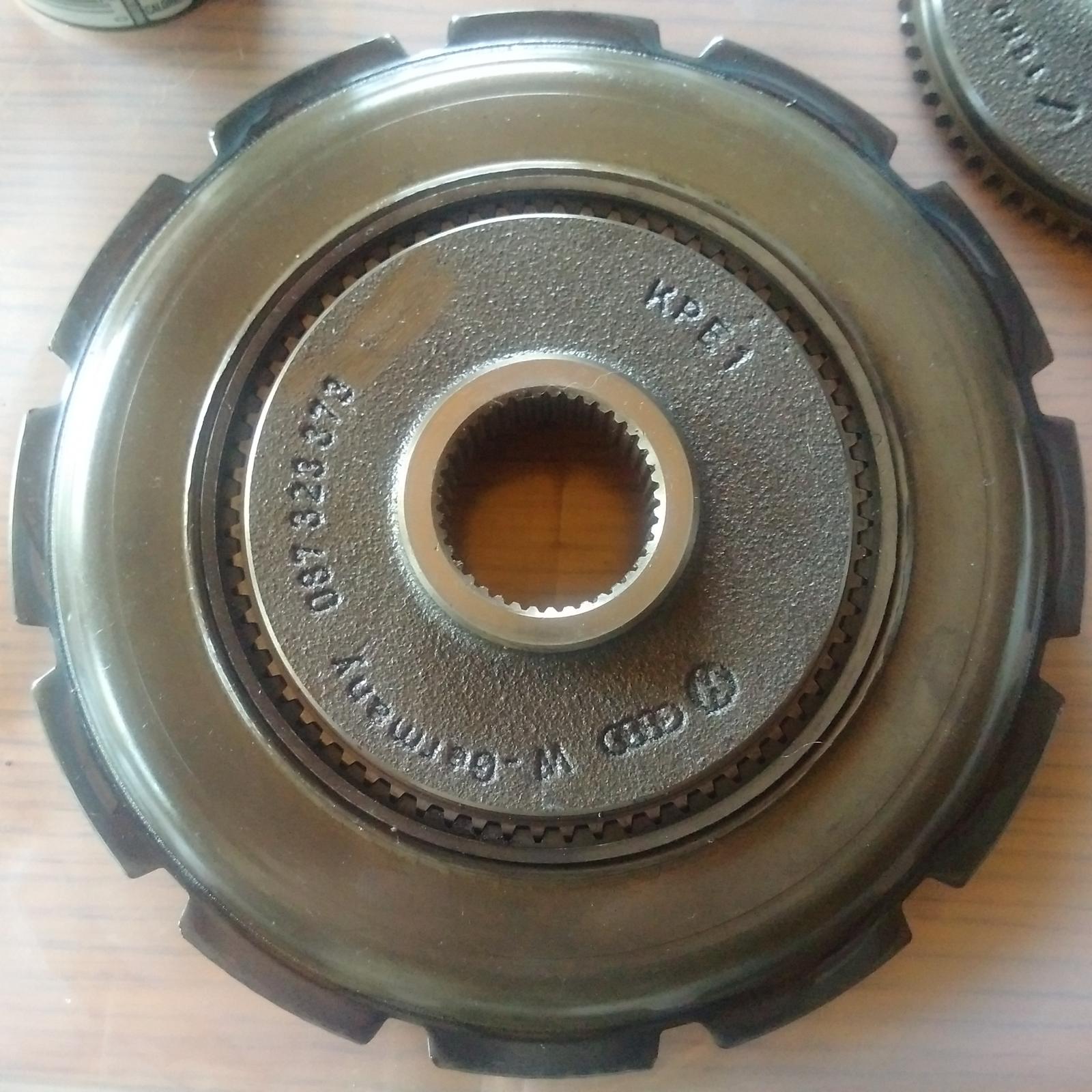

Correction (When using the LATER Audi 5000T transmission),
If building a 5000T enhanced transmission you must use the Audi 5000T direct drum because the Turbo Shell will not connect to the Vanagon direct drum.
Above is a photo of the Audi 5000T direct drum and 5000T shell connected together
Above is a photo of the Audi 5000T direct drum and the Vanagon shell that cannot connect. The Vanagon direct drum and shell is narrower on the outside preventing using the Vanagon direct drum from being compatible with the Audi upgrade.
None of the Vanagon frictions and steels will work with the later Audi 5000T direct drum as they are larger. I reused the 5000T frictions as I didn't order them.

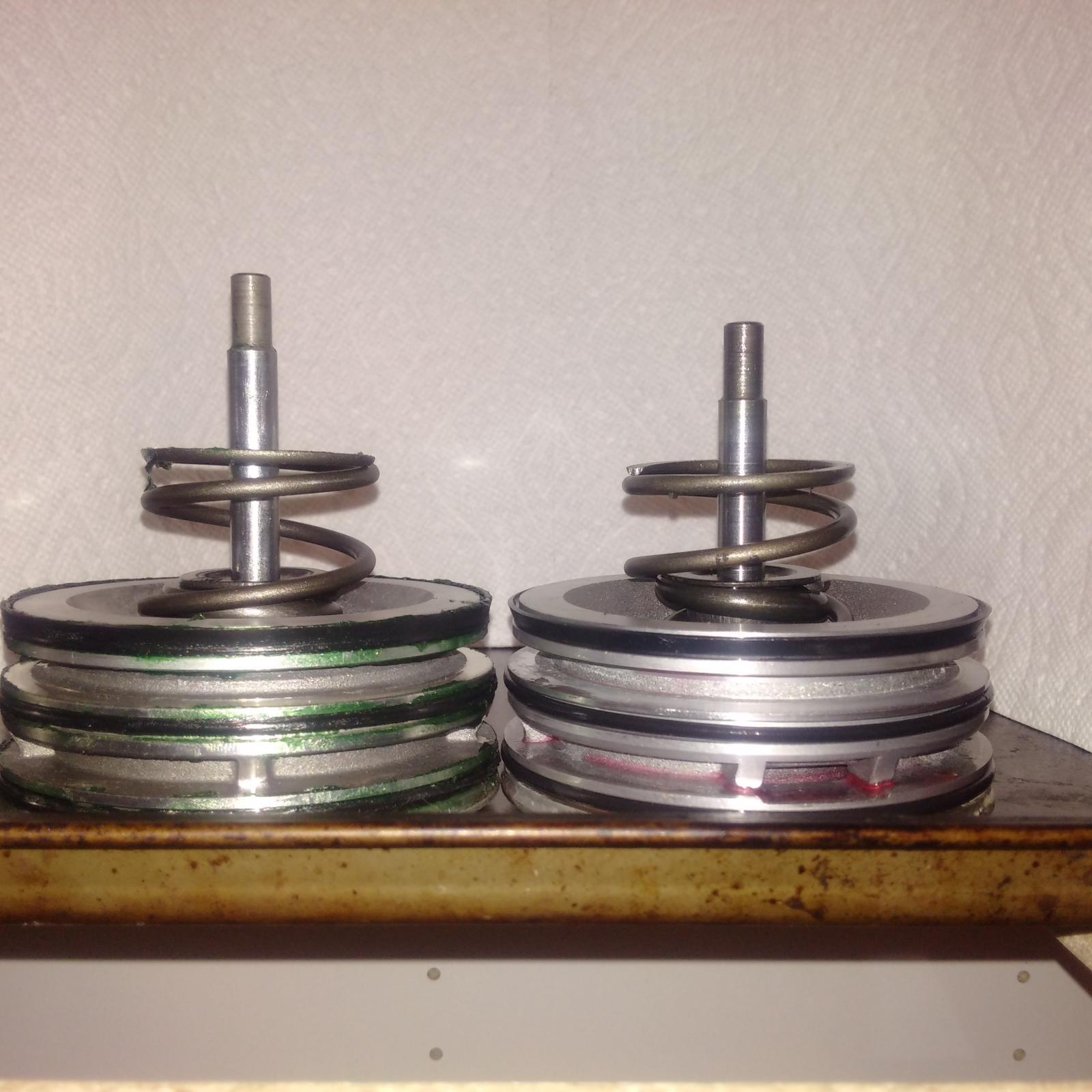

You will also have to use the Audi 5000T 2nd gear brake band piston as the rod that goes to the brake band is shorter to compensate for the larger direct drum.
Vanagon brake band piston on left 1984 Audi 5000T on right
No criticism Kourt, your 1982 5000T is just different than the 1984 5000T that I am using. This thread is absolutely incredible, I'm just adding addition info where I can.

Someone at some point put the 2.55/1.44 gear set into this transmission.
Fortunately the box of parts that I got with the trans had the reverse ring gear in it from the 2.71/1.5 gear set.
So these are the three pieces that I have available.
This is part 604 in the diagram I posted earlier.
the first one is the piece from the Audi as evident by the 087 that starts the part number cast in the piece.
This part fits in the ring gear for the Audi and the 2.71 Van gear set but the ID is too big to fit on the Van Diff splines.
This is the 2.55 van reverse ring hub.
You will notice it starts with an 090 instead of the 087.
Well I guess technically it starts with an A but you get my point.
It's a van trans part.
It fits the van diff but does not fit the larger Audi or van 2.71 reverse ring gear
This last one is the part I need.
No "A" at the front and ends in a B but also has the 090 at the beginning.
This is the hub for the 2.71 van reverse ring gear.
It fits the larger Audi reverse ring gear but naturally fits the 2.71 van rev ring gear.
Here is the larger Audi hub in the smaller van ring.
no worky.
Obviously the larger van hub also fits similarly in the smaller van ring.
Here is the smaller van hub in the larger ring.
Here is the difference between the big (2.71) ring and the small (2.55) ring.
So obviously, once again, the big ring and the big van hub fit over the 4 planet Reverse planetary and also fits the splined shaft on the Van diff.
So that's one problem solved.

The last issue that I came across was likely on account of some slightly out of spec pistons that seem to be all over in the van trans rebuild world.
With my old parts you can see that the little relief valve in the 1st/reverse brake piston lines up real nice in the shell
With the new piston it did not line up so well.
I made an executive decision and decided to take a file to the hole to open it up to clear.
It worked a treat but I did not get any pics of the final product.

I had a clutch plate in the Direct Drum break. I do not believe it was a "stacking issue," but as we have narrowed down here, an issue with the piston for the direct drum. I'm going to order a new piston to confirm.
I was just rolling back through this thread and noticed something in one of your pictures.
Just looking at this pic I can tell you that the top surface of that piston is way thinner than the one I bought.
I am pretty sure that you have already come to this conclusion but I would feel pretty confident that that piston is the cause of your excessive gap and likely the cause of your failure.
I don't have any pictures of my piston but I am sure you will see a difference once you get the new one.
