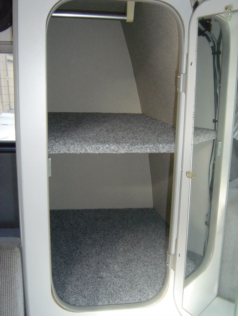

fabricated some shelving for westy closet. Botton shelf has a hole in th middle so that you can pull it up to access the cabinet bottom. Both shelves can be easily removed and stored at the bottom of the closet in case tha full height of the closet is needed. I aslo took in consideration the fact that I will be installing a GoWet 3-point driver side rear seatbelt so the belt will run in between the shelves.

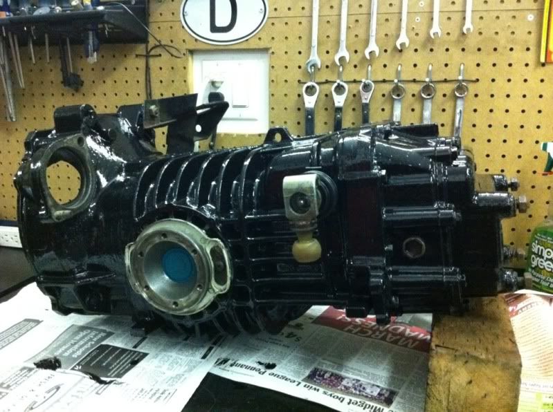

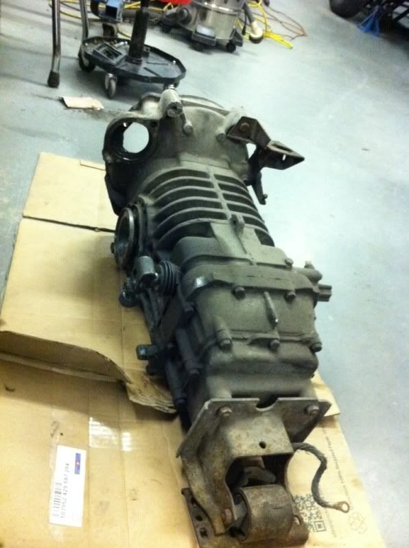

Not today, but over the past week. I pulled the gearbox to sort some leaks, so after disassembly, checking things, cleaning, resealing...more cleaning, and paint to keep the case from further oxidization...
Before:
After:
FWIW, the old input shaft seal and shift bushing/seal were loosey-goosey, now much tighter. The oil slinger was seated good & tight so didn't need to touch that.

Finished www set up and cut a new carpet piece for over the engine compartment back end. I'm going to use the original brown matching carpet for bare spots in front (cut & glue them in). Did work around Auto Shop as I'm going to need a bit of help to lift the dash back in. When I get my order from BD then I can put the clamps on the flapper cables and get the front end FINISHED. Cool. Then I think I'll drive it for a week before taking on the fuel tank. It's full of fuel anyway. I'm probably going to give some diesel away as its full from putting it into storage).
