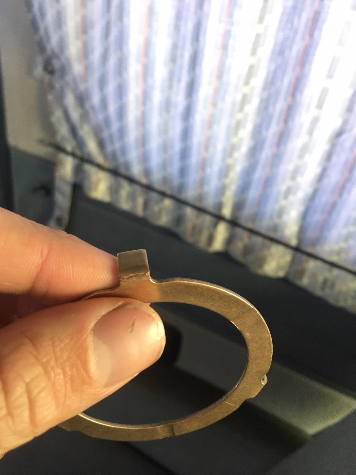

Well I don't have any extras lying around but I do have a solution.
https://www.mcmaster.com/3088a368
You may see from my pic above with the shims in place that the shims are not a tight fitting piece.
The ID of the stock shim is 1.315 inches but the shaft they slide over is only 1.18 inches.
The OD of the stock shim is 1.676 inches bu there is more than enough room for one that is 1.75 inches on the OD.
So, the one I listed about is 1.25 inches ID with a 1.75 inch OD and it .015 inches thick which equates to 0.4mm.
I am fairly confident that they will work.
These are not really a wear item as they simply sit between two moving parts that are rotating at the same speed to keep the two parts a specified distance apart.
I would not hesitate to run them in my trans given that there are not a lot of other options.

Has anyone used the bronze thrust washers from Cobra? Both of the ones that I got have visible tears/creases where each tab was bent down. It makes me a little nervous to use them in case it eventually snaps. The OEM washers didn't look like this.

Yeah I probably would not use those.
Obviously, that would be a bad thing to come loose and have rattling around inside the trans
I ended up using old ones but I did have three sets to pick from so I tried to find the best ones.

Yeah, those were my thoughts too. The crease doesn't seem to go very deep, but it would be incredibly frustrating to put it all back together and then have one of those tabs break off. For any future readers - don't bother with the bronze thrust washers from Cobra!
