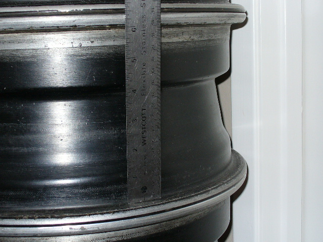

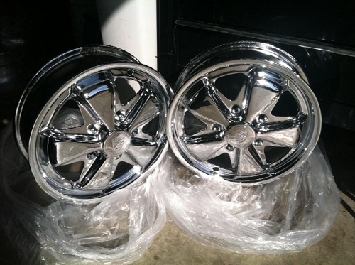

And now with pictures!
Both pics are with the shiny sides up.
5½":
If you can't read the ruler, here are the dimensions. The drop center starts 1½" from the outer rim, and about 1-1¼" from the inner rim. Since the drop center is much deeper at the outer rim, it may be that it's easier to mount the tire from the shiny side.
6":
On the 6, the drop center is a full 2" away from the outer rim, and again, it starts about 1-1¼" from the inner rim.
I've personally wrestled with tires trying to mount them on deep 6s. While trying to mount from the outer rim, I had to stop at the point of doing damage to the tire's bead. By mounting from the backside I was just barely able to get it on the wheel.
Use lots of bead butter!

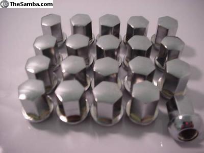

I sell chromed steel ones on this site here... http://www.thesamba.com/vw/classifieds/detail.php?id=868624

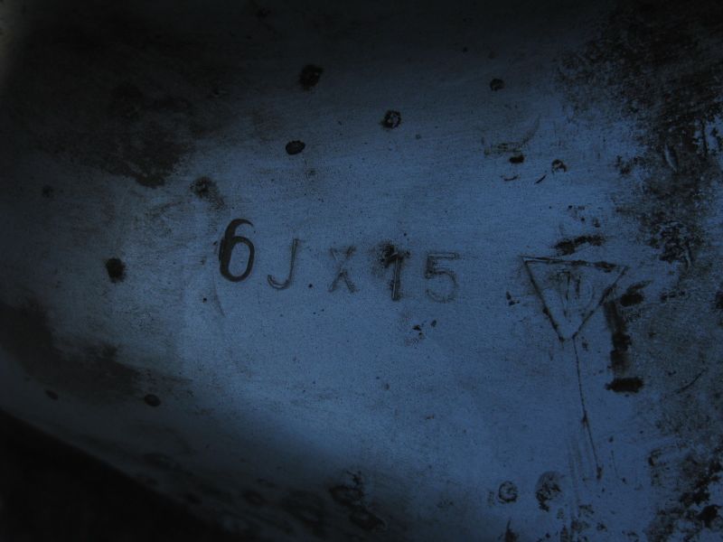

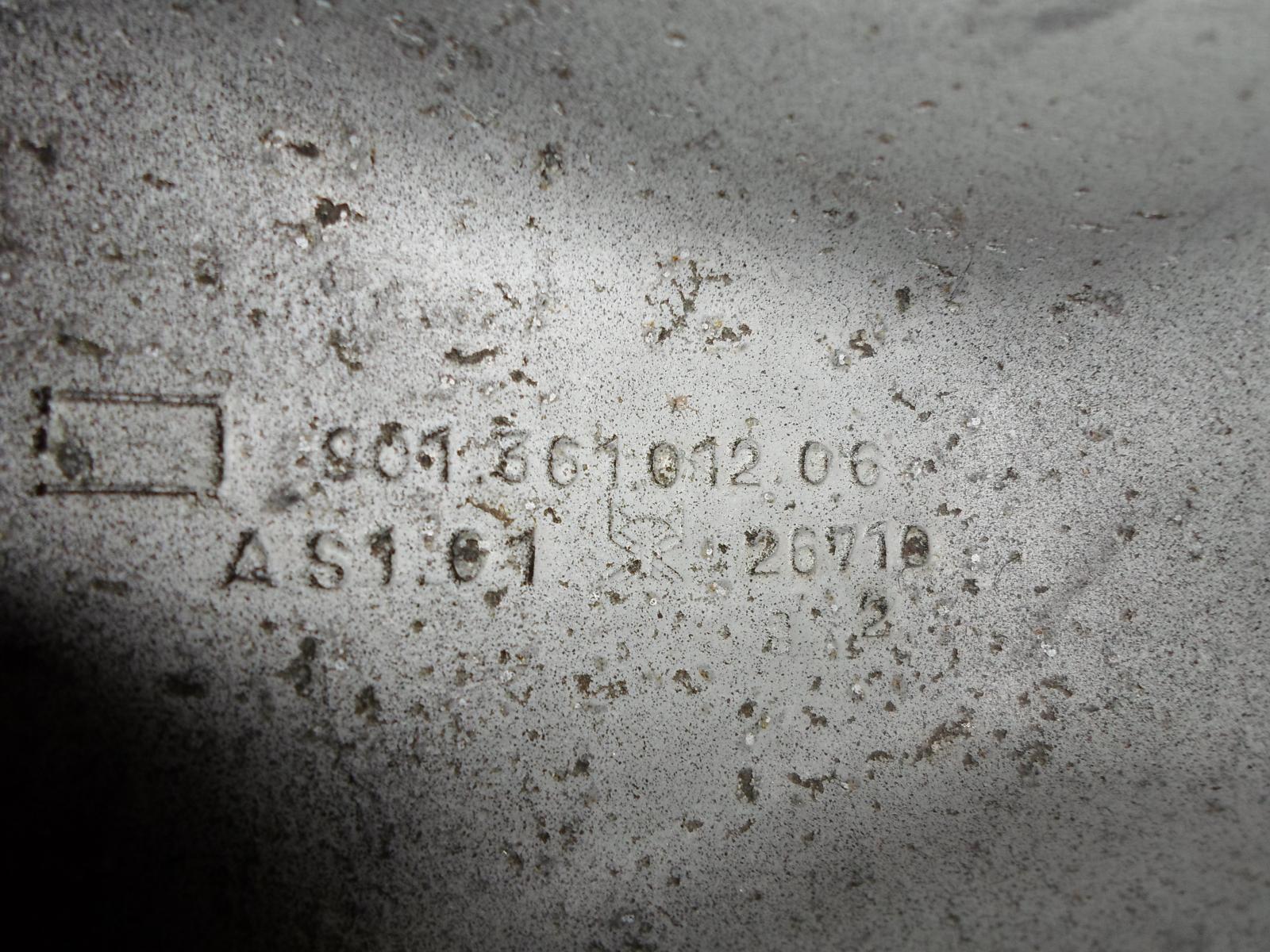

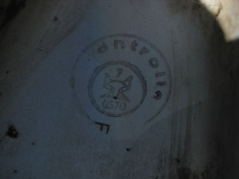

I have a set of five Fuchs that I've been keeping around for about 24 years but I'm not sure if should have them repaired and put to good use. The issue at hand is that these rims are rather beat up and have lots of rash and marks on them. I'm not sure if they can be repaired; I'll post pics of them later but in the mean time I don't know what I really have on hand here. I've taken a few pictures of the inside markings in hopes that you guys will help me identify what I have. Also, where can I send them to get the road rash fixed?
In the mean time here are pics of the markings:
vic
Joined: August 31, 2005
Posts: 1670
Location: Fontana, Califas
vic is offline
PostPosted: Tue Mar 27, 2012 6:23 pm    Post subject: Reply with quote
looks like a later flat 6 fuchs and part #. These wheels can take a beating and are fairly easy to repair. My deep 6s had a lot of curb rash and they came out killer after they were repaired and chromed.

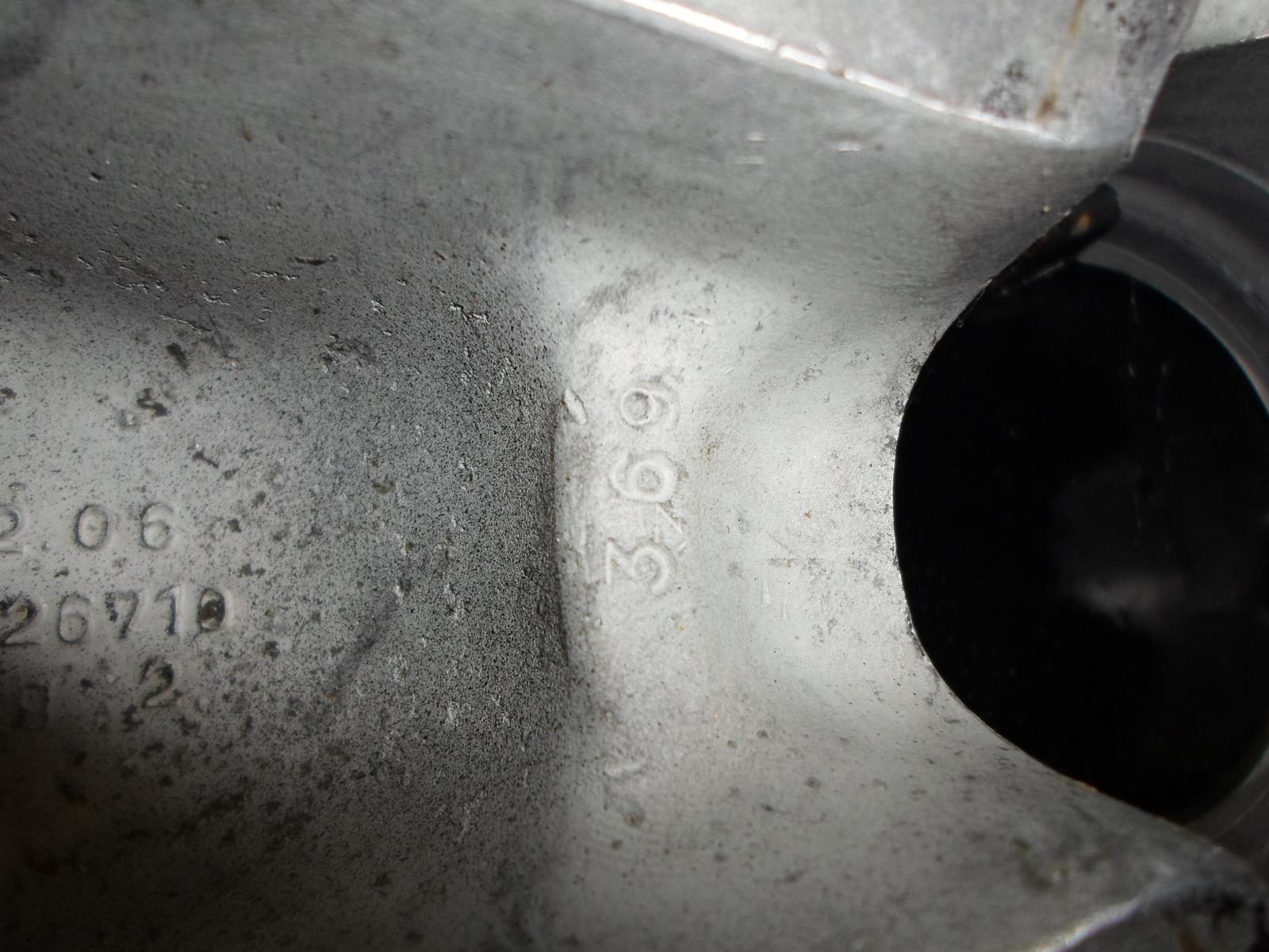

I have some '69 6" fuchs wheels that have "g" and a "2" under the 26710 number on the back of the wheel.
What does the g and 2 mean?
Does anyone know?

I'm a little late to this post. I just read it and noticed Rich asking for a pic of # ending in 06. Here is a pic, lights were out in garage so sorry for quality.

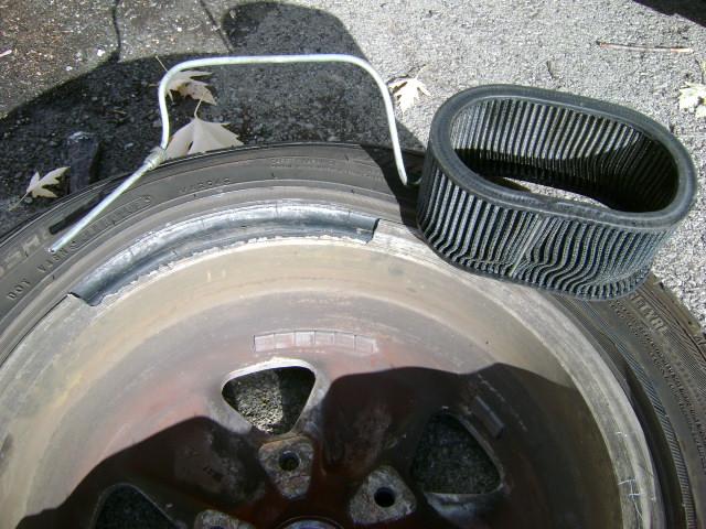

So is this fixable?
mr. warehouse
Joined: February 27, 2001
Posts: 5002
Location: Nor Cal 707
mr. warehouse is offline
PostPosted: Wed Nov 13, 2013 2:58 pm    Post subject: Reply with quote
roberto wrote:
So is this fixable?
Yep.
Get a late 6 then cut / weld. Heck, make it a 7R while you're at it. You wouldn't be the first guy to do so.

Yep.
Ha! I'll just stop at getting the late six. Wink That's what it is, any ways.
Is this common? I didn't hit anything, just cruising down the highway.
