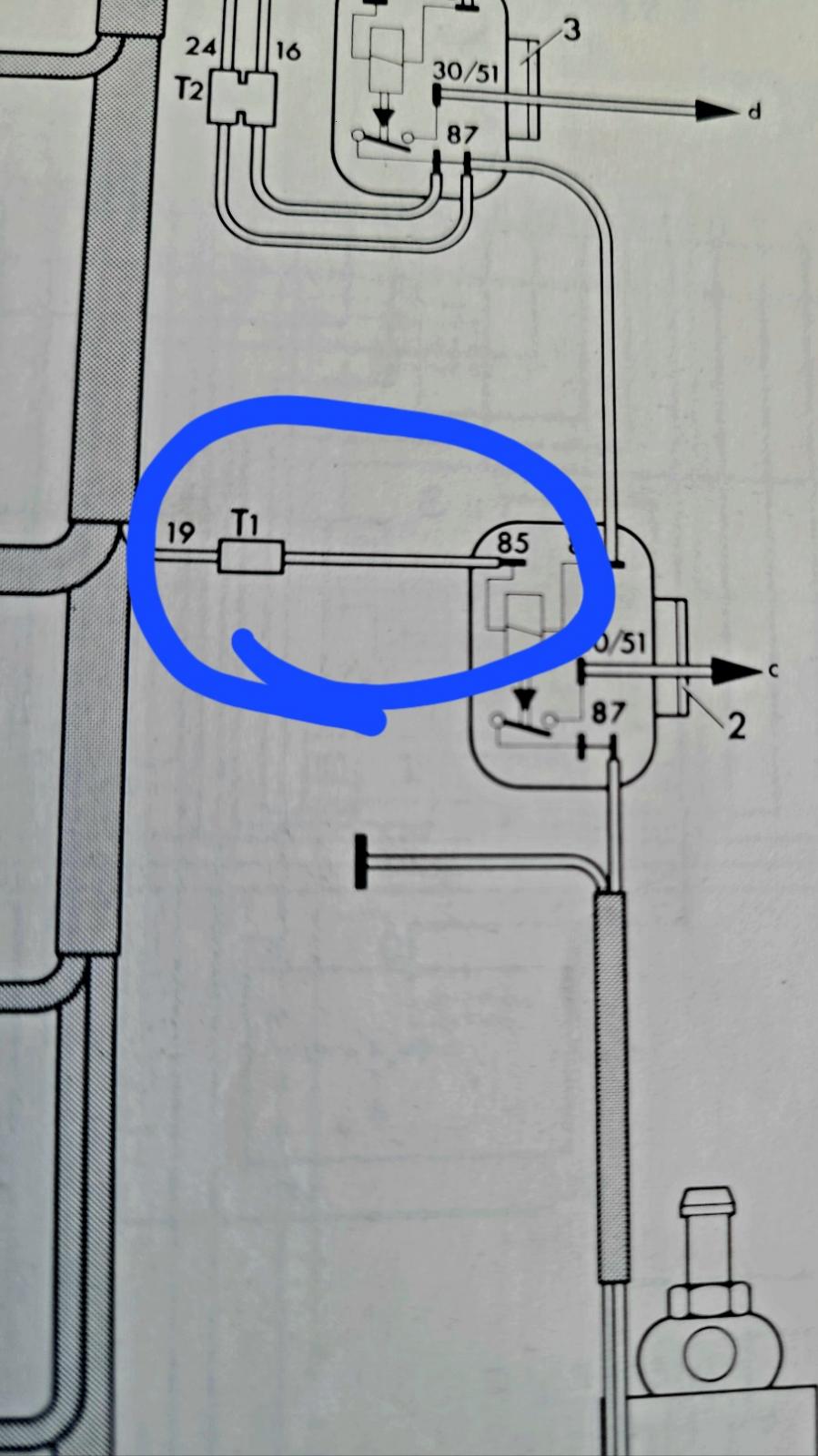

PostPosted: Fri Sep 29, 2023 1:19 pm    Post subject: Re: Fuel injection relief here! Reply with quote
Wondering if anyone knows the color of the wire 19 to connection 85 on the pump relay? I'm currently missing this wire. Have a few wires under the dash disconnected. Looks like a ground from ECU
Jason in Austin Texas

PostPosted: Fri Sep 29, 2023 2:13 pm    Post subject: Re: Fuel injection relief here! Reply with quote
It is a white wire, and that T1 connector is in the engine bay, left side, forward of the left intake tubes.
This is an aftermarket crimp on connector, but the clear plastic VW connector goes here also.

PostPosted: Fri Sep 29, 2023 2:18 pm    Post subject: Re: Fuel injection relief here! Reply with quote
Thx. Found it. Someone spliced in a blue wire. That fixed the fuel pump not coming on. Starts, runs fairly well with 2 caveats.
Lopes like cammed when cold
Super rich. Black soot on bumper and black smoke.
69 Notch Auto FI
Seagul Blue

PostPosted: Fri Sep 29, 2023 2:27 pm    Post subject: Re: Fuel injection relief here! Reply with quote
jasle wrote:
Vacuum leaks often cause these symptoms.
Check hose from plenum (IAD) to pressure sensor (MPS, under left side of engine bay floor).
Then a systematic check of all hoses for vacuum leaks.

PostPosted: Fri Sep 29, 2023 3:15 pm    Post subject: Re: Fuel injection relief here! Reply with quote
KTPhil wrote:
jasle wrote:
Yup, that was it. Many Thanks!
