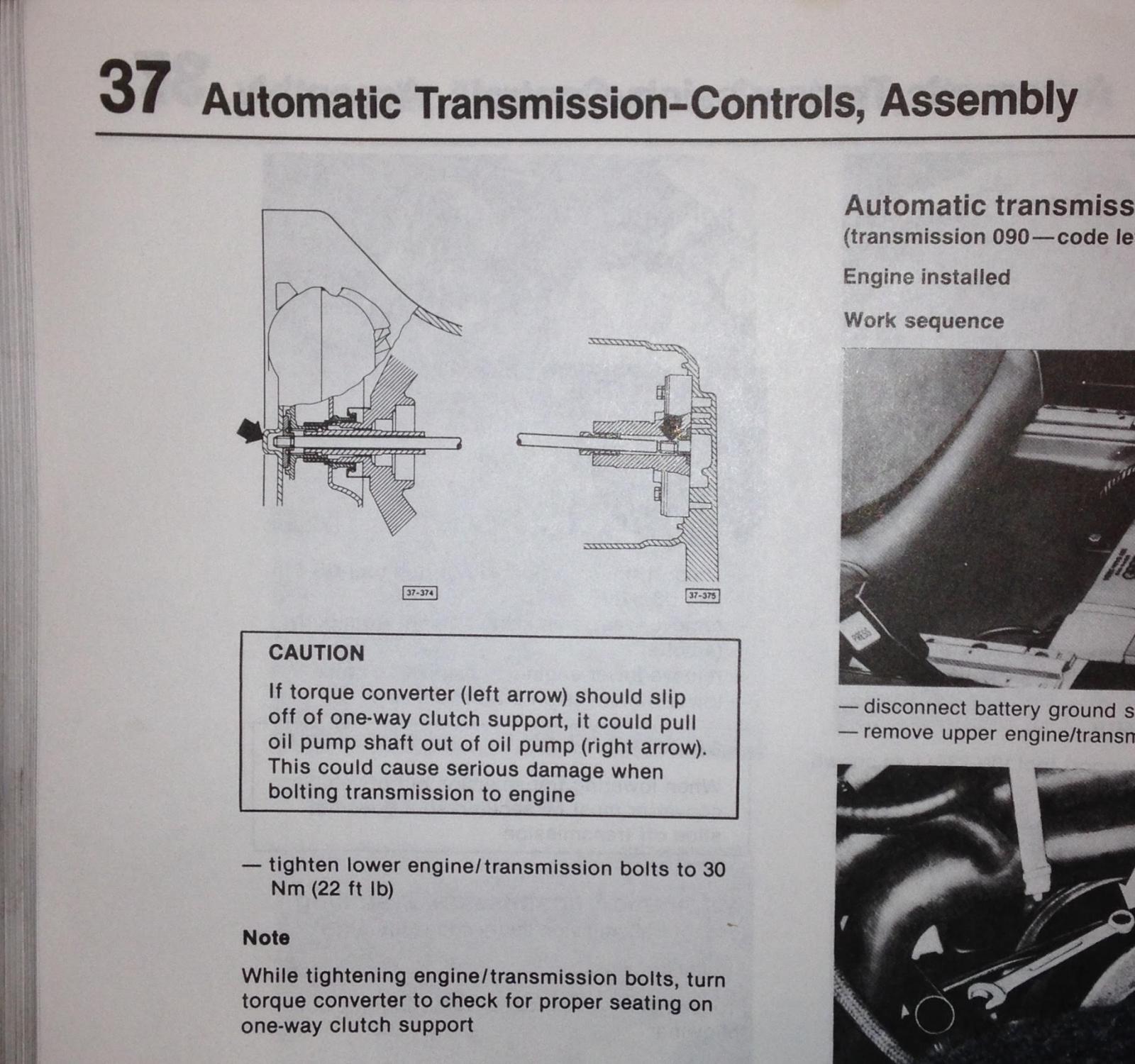

I have been fighting to get the converter to drop back on for the last couple hours, oil pump feels fine, its not dropping into the stator for that last ~3/8" unless I pull BOTH of the other shafts... Got the trans used and went through it, found some stupid prior rebuild issues (axial scratches on governer shaft at seal etc, polished out) but it was mostly pristine, amazingly the diff was still OK.
Does anyone have a good reference pic as to how far the 3 shafts should be sticking out when all is right and ready for the converter? Getting paranoid, have the trans on end and it still won't drop.
Have verified no burrs on all 3 shafts etc, converter drop into place but the input shaft has to be out.
EDIT: Figured it out, I think.
Reversed the process, the input shaft splines barely engage/go into the converter.
Deburred the splines on the input shaft a little, but they look fine.
I'm wondering if this is why the input shaft had some visible pliers action from being jammed in one way or the other. Gently tapping the input shaft into the converter mating hole with a brass hammer doesn't do anything except make me want a bigger hammer, so I'm going to dig out the Vanagon converter I was planning on using anyway
(I just wanted to quickly stuff it in the car and do a trial fit with the motor etc... and grabbed the converter it came with. Great way to spend the evening.)
Perhaps that why the transmission looked so clean inside//seals all still in great shape etc... It may have been parked for decades. Either that or this is the wrong converter... but it looks right, not a whole lot of cars used air cooled converters. (although they were mostly all Borg Warner, which the 003/010 etc are, licensed by VW)

Figured it out, the converter that came with the trans was pooched.
Input shaft won't drop in the converter splines more than ~1/4", if that.
The vanagon converter ~fell in place in after a few twists and wiggles as expected.
That 30 second job took hours and a lot of violent cussing due to some PO or idiot mechanic.
The flex plate bolt pads on the converter should be appx 1/2" in from the trans flange face.
That's the go/no go measurement to be concerned with.
(amazingly happens to be about the same distance the flex plate sticks out from the engine flange)
Noticed the late Vanagon (090) pump shaft projects a touch more and is... pointed, and the splines taper down to the end to center/engage very easy.
The early 003 pump shaft just has a small bevel to center.
The input shaft should be ~even with the stator (outer) spline bit that doesn't move on the trans, and the pump shaft should stick out a bit less than 1/2", and you should be able to feel it engage, slide in a bit and feel it turning the pump when its engaged.
(resistance, but smooth, feels-like-turning-an-oil-pump resistance)
Closer inspection of the bad converter revealed the circular shaft centering bit around the splines was oval shaped like someidiot had been using a prybar in it.
The shaft seems to have been hanging up where the bearing area starts, wouldn't go fully in the hole as the sides had been pulled in.
I'm guessing It had probably been hammered in previously.

I edited my post above... I forgot to include the picture of what it is supposed to look like with the shafts properly seated. It's now included!
As far as using a hammer on any of this... I would think the need to do that would indicate problems.

PostPosted: Sun Mar 04, 2018 5:50 am    Post subject: Re: Automatic transmission installation Warning Oil pump driveshaft Reply with quote
The transmission on my 1987 Westy is starting to slip in D, and in surfing the Vanagon Bentley manual I found this Caution on page 37.6, which I did not find in the Baywindow Bentley. Turning the page to 37.8, there is a similar in-the-box Caution: Torque Converter must be secured from sliding off transmission when lowering transmission out of vehicle.
Seems appropriate to include this info for this thread!

PostPosted: Sun Mar 04, 2018 8:03 am    Post subject: Re: Automatic transmission installation Warning Oil pump driveshaft Reply with quote
Great points, wish I had this info when I dropped my motor a few years ago. Bent the shaft on the way down.

Have you read this whole thread and have you disassembled your trans yet? look on the 3rd page of this thread. You might be able to do what wasted did and get a different model pump and just swap the damaged part out.

...and note the part that typically gets damaged, the pump drive "flower" is a consumable part and is available from multiple sources, stock cast or billet CrMo.
Same part on 003 and 090/010 transmissions, the 010 version was used in many VAG vehicles, mk1-2 Golfs/Jettas/Dashers, Audis of same era.
