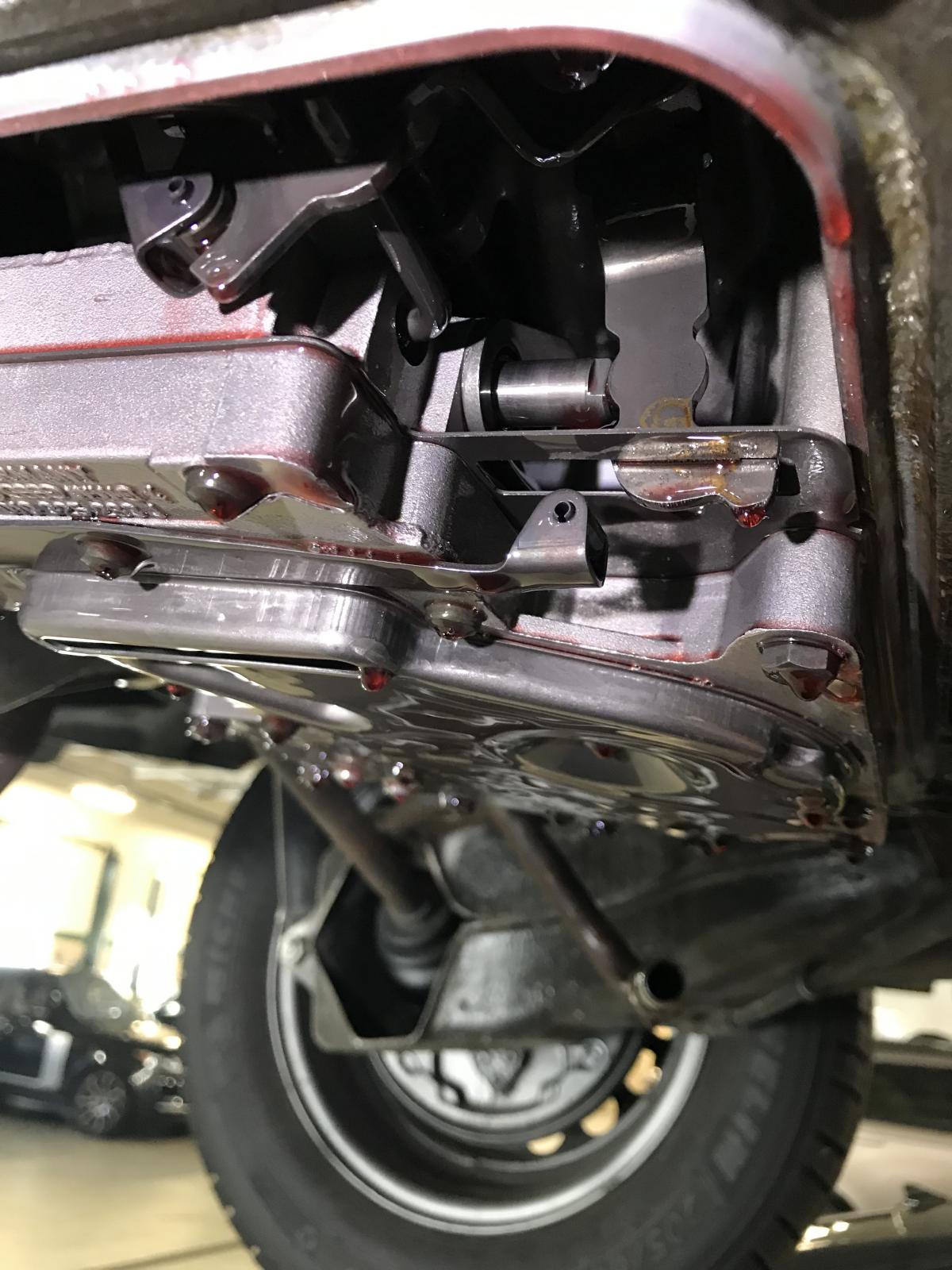

danfromsyr wrote:
to themadcap
try reaching up there and giving the slotted shaft a twist with some long nose pliers. it should turn towards the front of the van. leave it parked in the middle. and go for a ride.. see if it behaves/shifts better
I do not recall if it'll stay put or self rotate/adjust..
jlrftype7, not sure which image you are referring to.. I went back a page or 2 and don't see what you are referring to.
. Previous page where I posted a picture of my manual valve and related linkage for another poster who needed a clearer view of how the kickdown rod sits.

you mean this pic? I can't tell how/where your manual valve 'relay lever' is positioned in this pic.
jlrftype7 wrote:
Is either one of them anything like this[ my '84 Auto]
