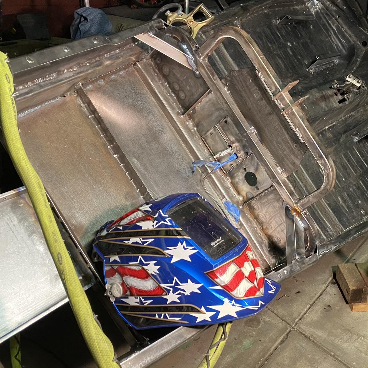

Yesterday was the first of two Christmas dinners at our house. Everything went off fine, and there were no disasters. Her family was here, and tomorrow it’s mine.

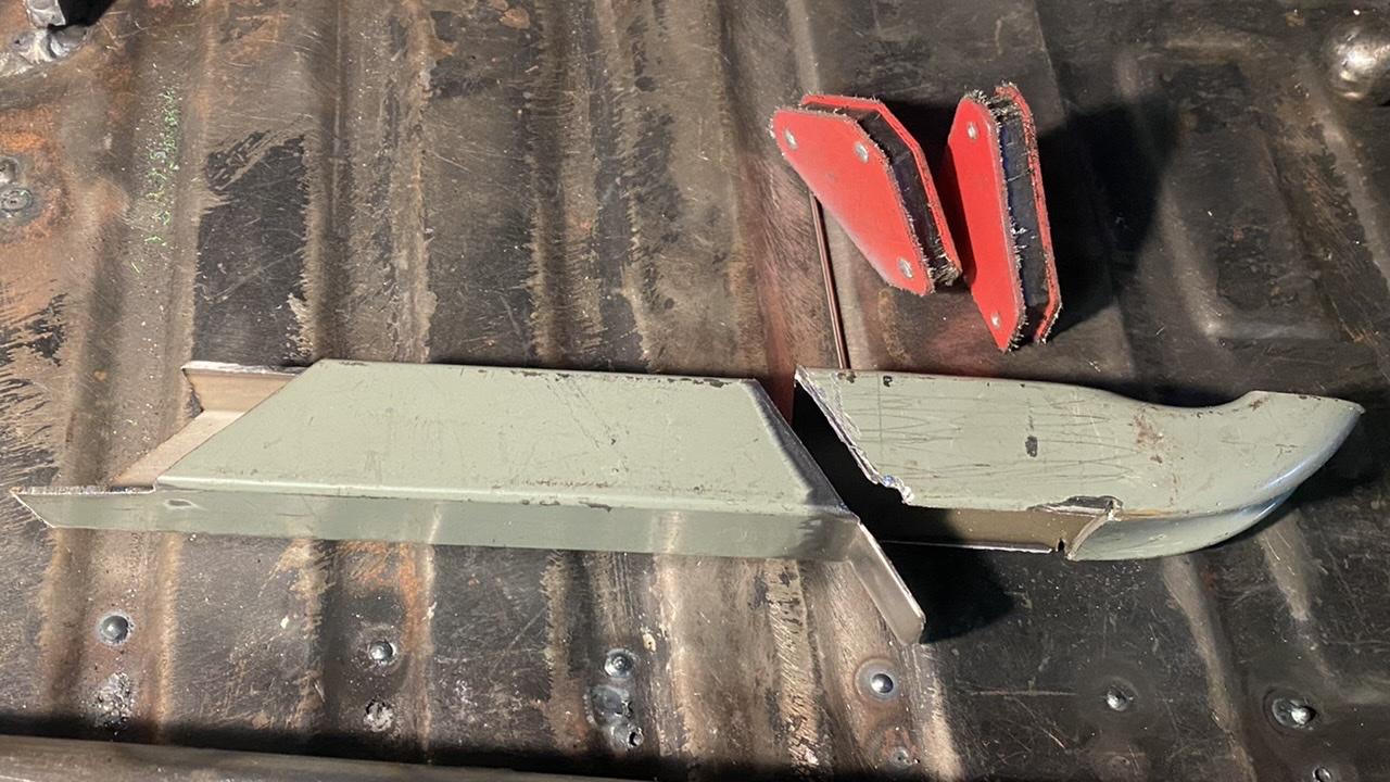

Things didn’t start until 4pm, so I still managed to cut some pan bracket reinforcement bars for the car and get them cleaned up & welded in. The seat risers are now welded in too
I also got some more rust cleaned up, and prepped for the last bits of welding.
It was a lovely day in the mid 60’s & it looks like prime painting weather tomorrow. Maybe it will happen today, because my family starts showing up at noon tomorrow.
But there is still more welding needed on the fuel tank support. I need to make some more crossmember gussets too.
We were supposed to get a little rain this morning but it came in the night. I am hoping for the 68F they posted for today’s weather.
Here’s wishing you all nice weather for Christmas!

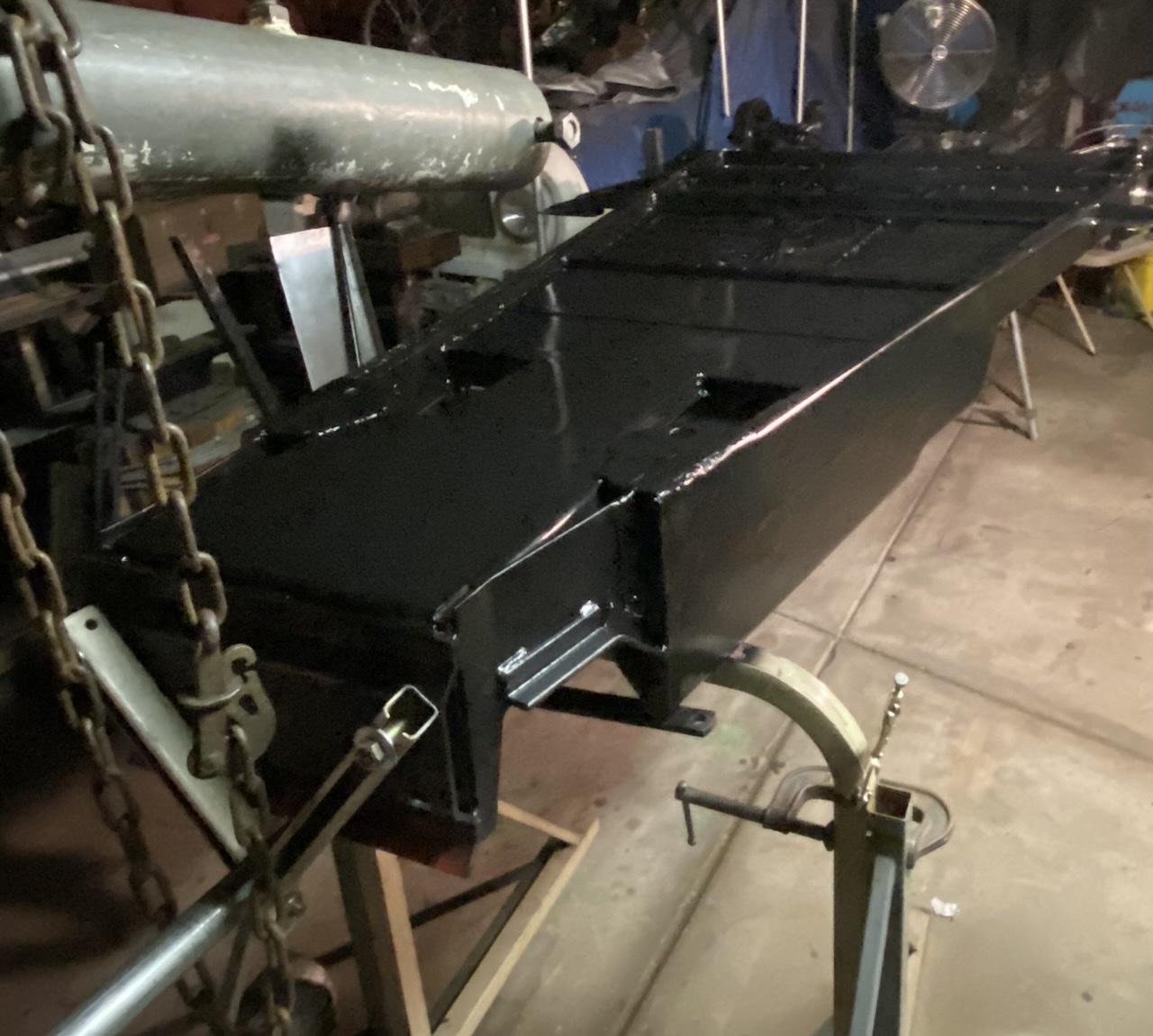

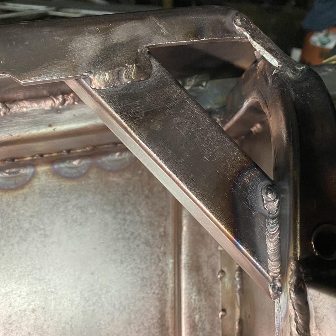

Well everything waits for Christmas, but I am finally back on the case.
I made these gussets from some scrap tubing.
It stayed warm until sundown, so I flipped the frame upside down, gave it a cleaning, and shot 40 oz of satin black. I’ll do the top later, because of the weather.
It’s raining, but somehow I just barely managed to beat the rain. The finish won’t be great, but at least it won’t rust up during assembly.

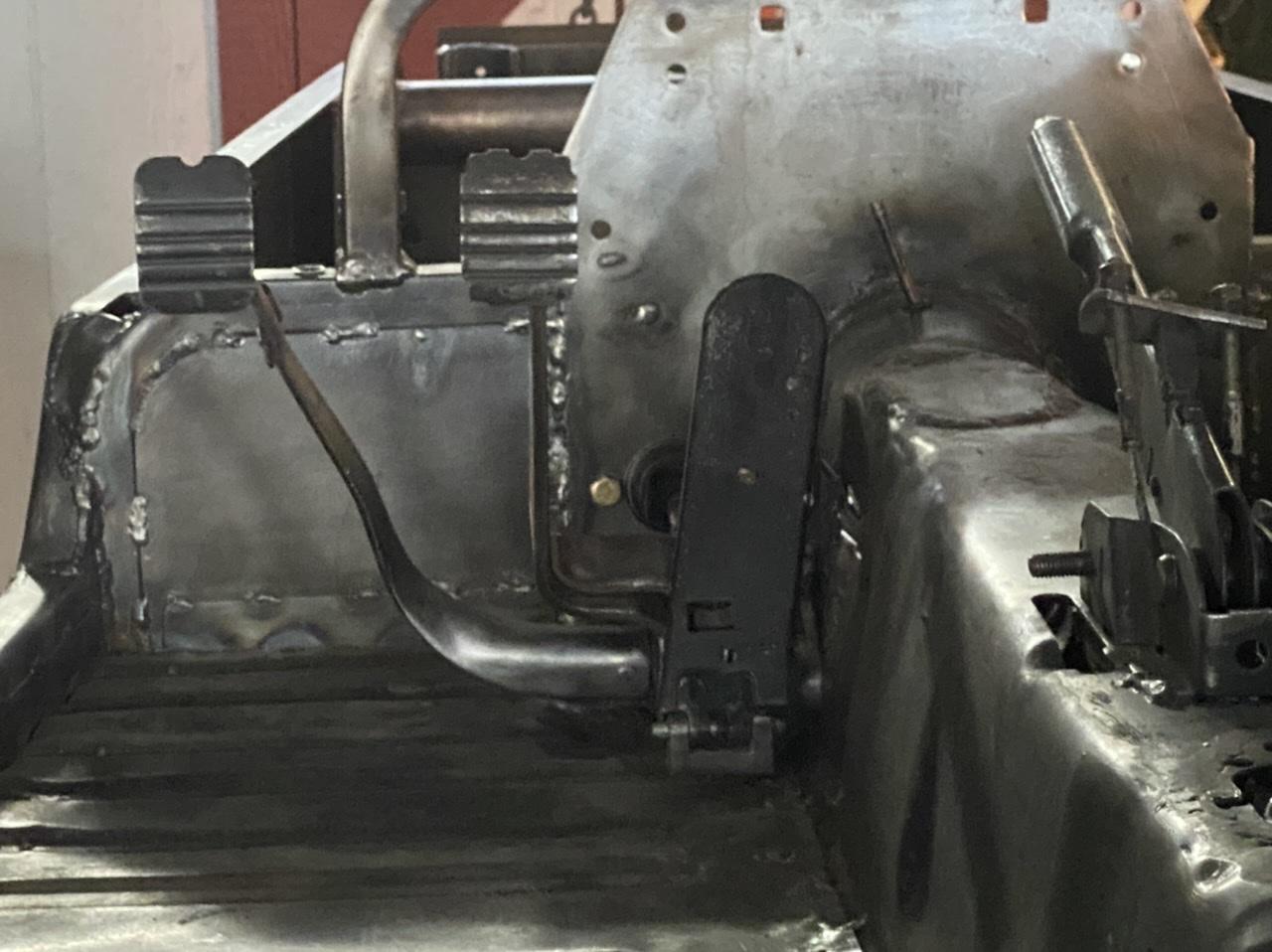

But I finally got back to my VW relic yesterday.
I put in the new brake lines and master cylinder, pedal set, control cables, and now I’m trying to locate the brake hose brackets.

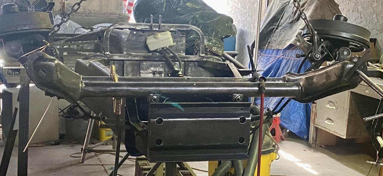

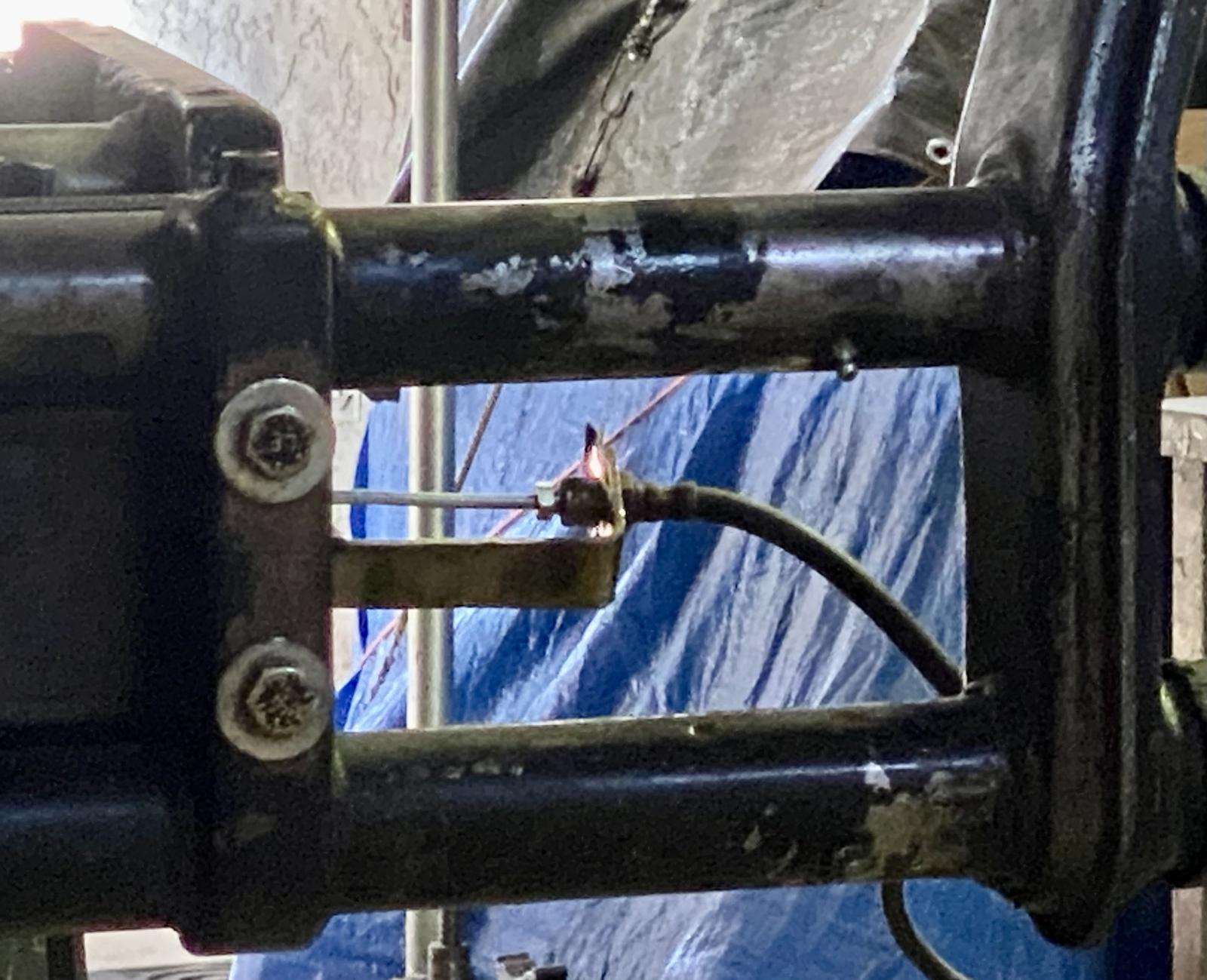

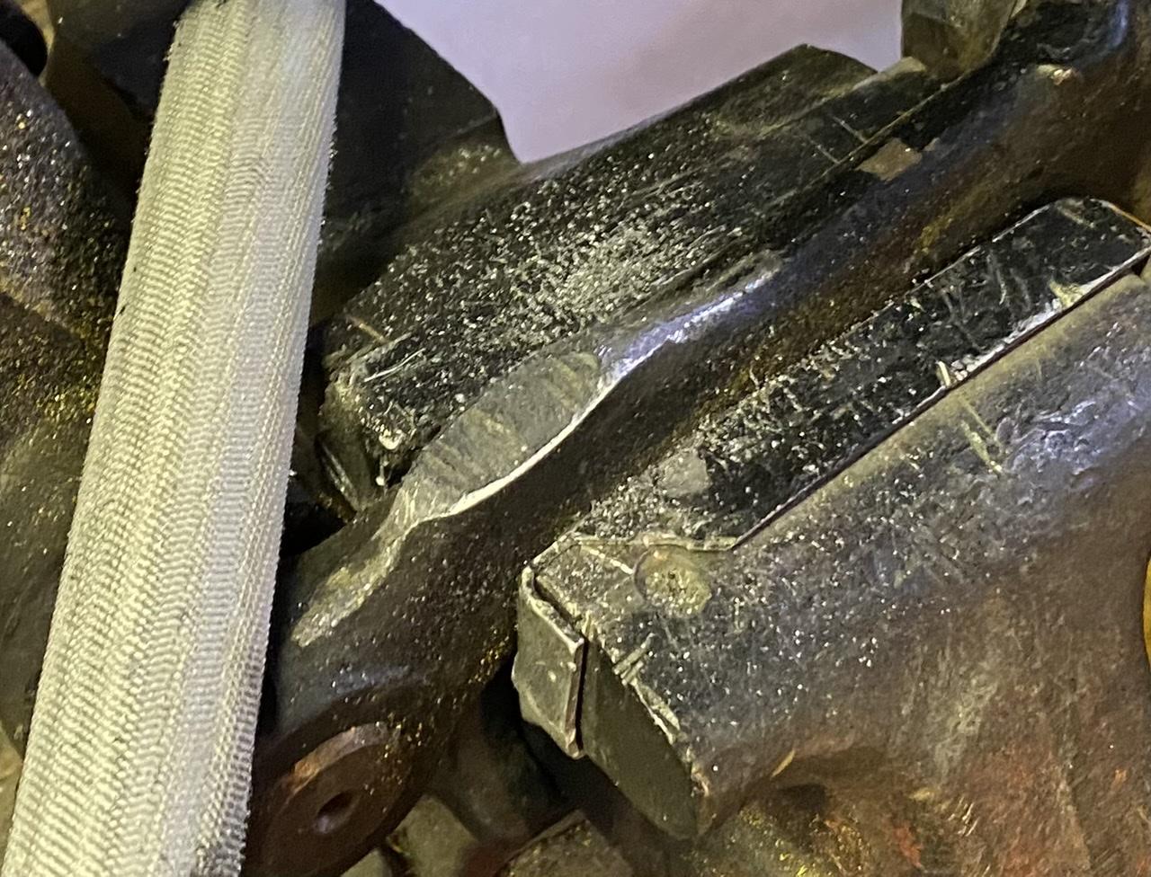

The front axle and all the steering are filthy and I took it apart for major cleaning.

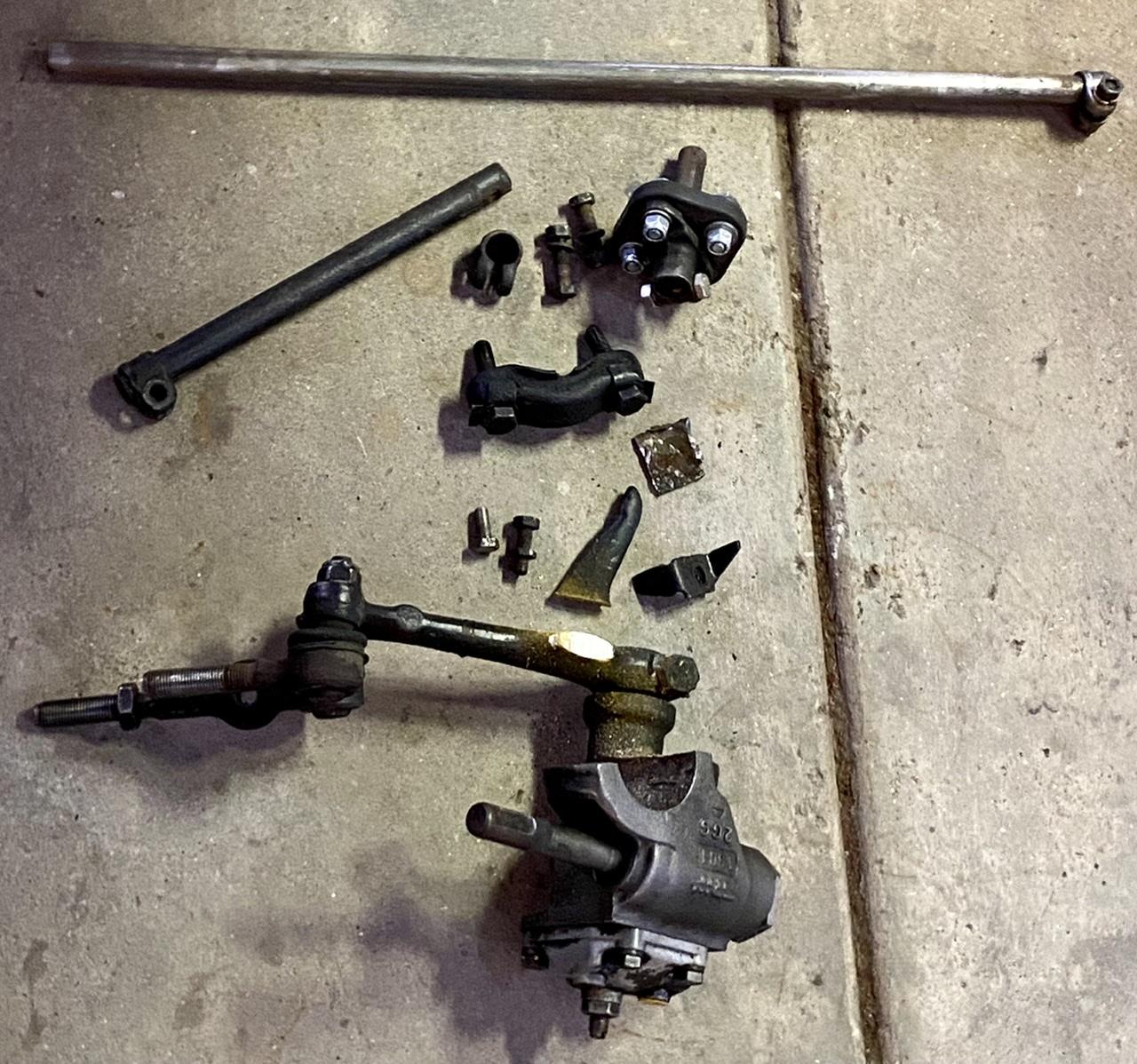

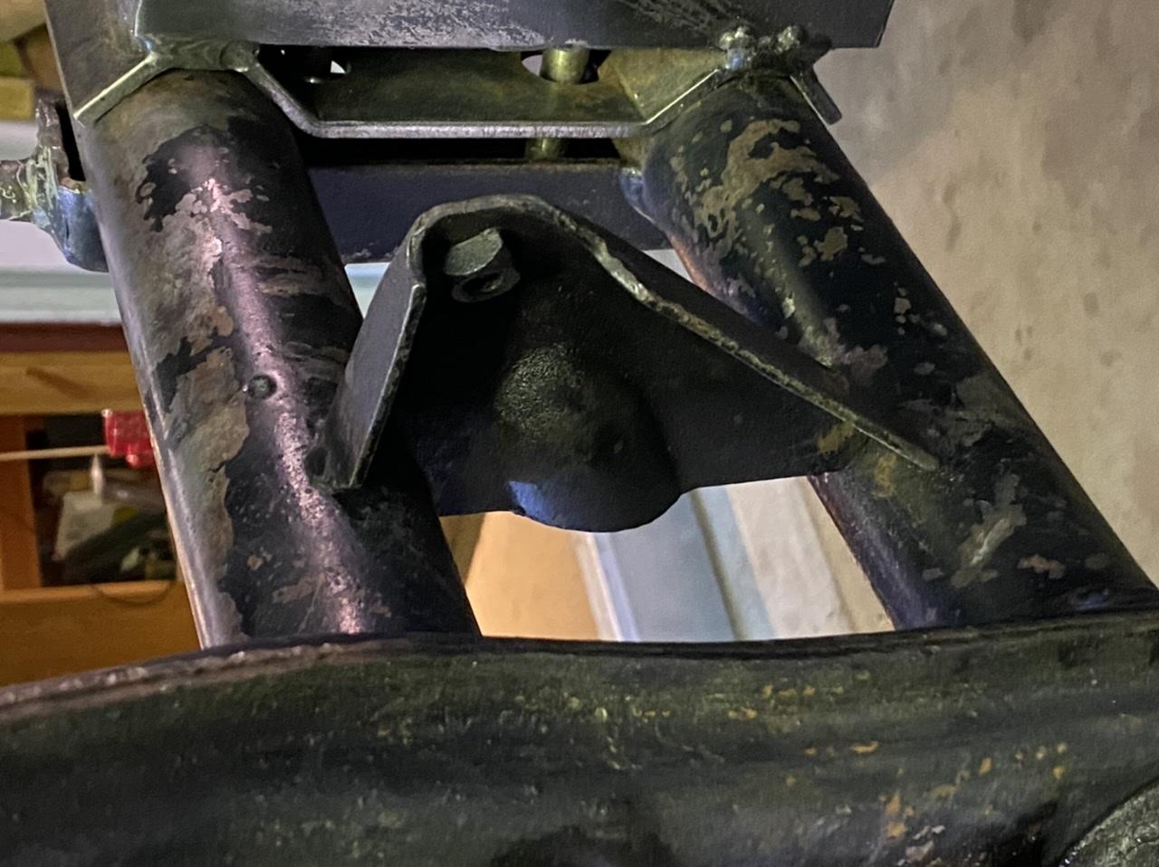

I bobbed off the unneeded “finger” from the pitman arm. Also the stop it could never hit anyway.
It’s on this stamped ugliness, which will get modded for easy access to steering adjustments.

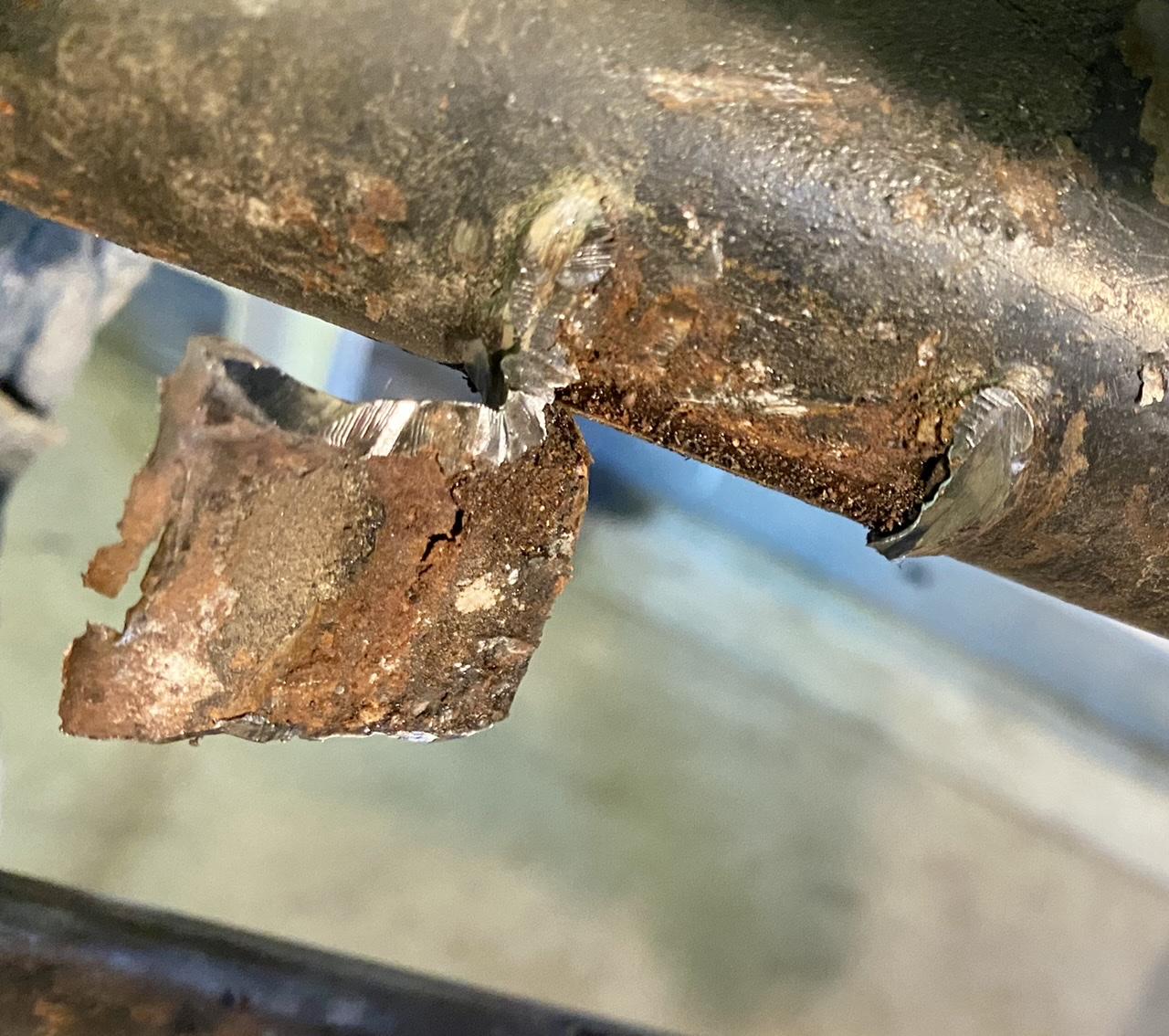

Also the steering stabilizer bracket had to go.
There’s the last bit hanging by a thread.
That area is all burnished down now, but much cleaning remains.

Not going to use a steering dampener? Maybe I missed it in your thread but why not? Or are you just mounting it differently?
Ulu
Joined: April 21, 2020
Posts: 826
Location: CenCal
Ulu is offline
PostPosted: Sun Sep 07, 2025 5:49 am    Post subject: Re: SS100 "replica" Kit Kar Reply with quote
I drove this car without it because it rubbed on the body. With the long wheelbase it doesn’t seem to need it.
Today was just cleaning and painting small hardware. Not much to show, but, this is the pitman arm. You can see where I cut off the unnecessary stop “finger”.
This was filed clean and sanded free of scars. You don’t want stress cracks here.
Steering stops and damper bracket get junked.
Also this stop bracket is just in my way & will come off.

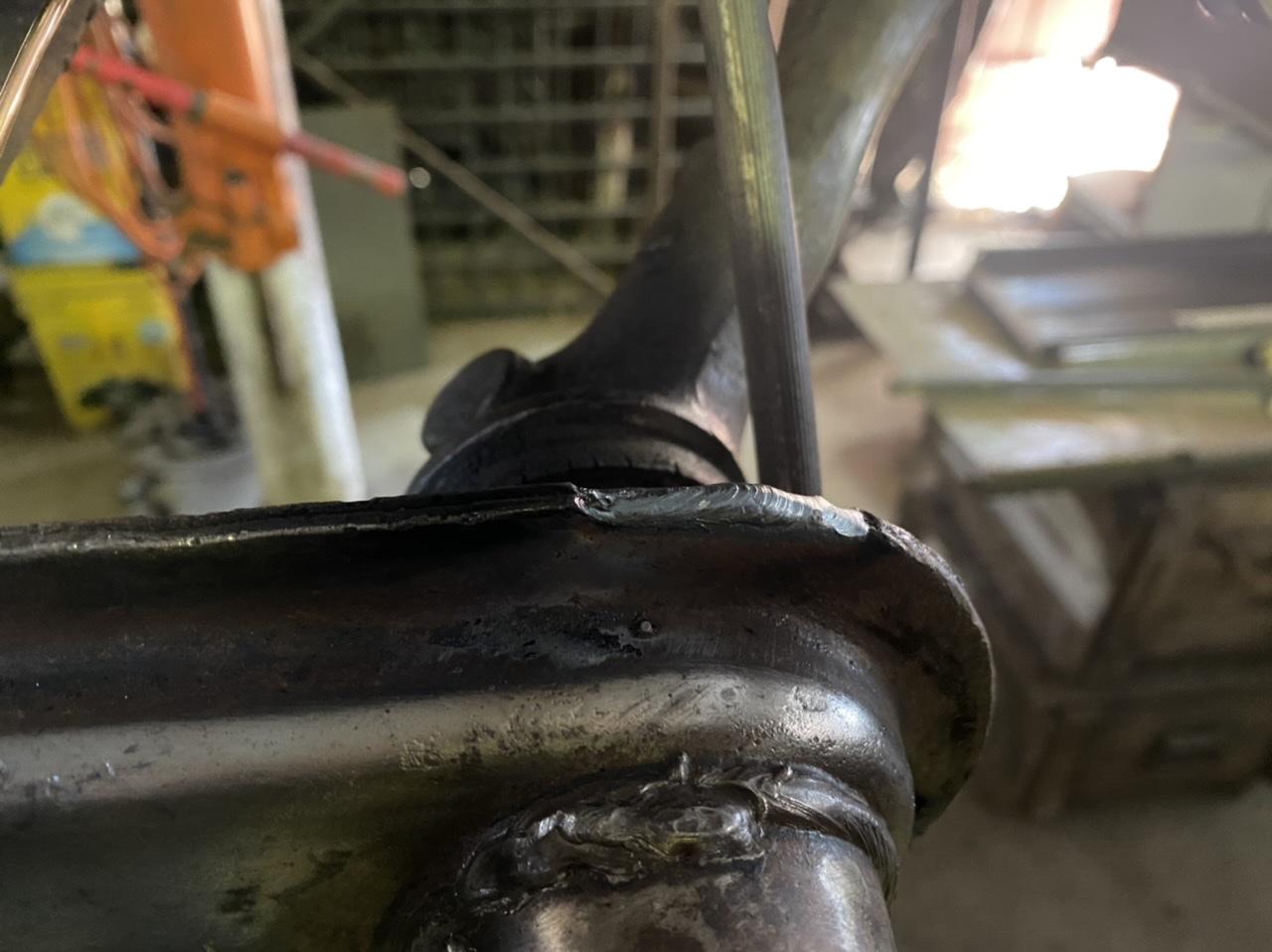

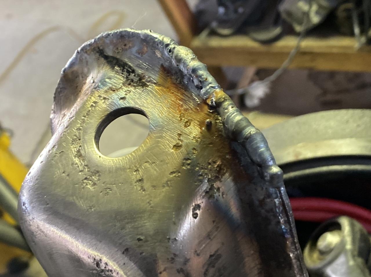

I wanted to weld up the front shock towers before paint. I didn’t want to see a rusty seam in my paint later.
Also these are just spot welded & old, and wanted reinforcement. I went all around these, except for the drain port on bottom. I didn’t use filler.
These tubes were filled with grease to make the springs slip, and it keeps water out. It also burns. There are rubbers inside too, so I did six feet of short 2” welds, skipping around, and switching sides, to let it cool. I also cooled it with water around the rubber bushings & seals.
The tops had been trimmed a bit ragged, but needed welding. Also filler here. Though dirty and old inside, I still eventually got solid welds by argon purging.
Flipping the axle flat so I don’t have to weld out of position.
