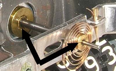

Well, with the magnet removed there still are like, two other bushings that support the shaft the needle fits on. Sounds like one of those is bound up. This is a photo of a mid 60s speedometer pointing out those other two bushings:

Okay, I've never had to do any speedo work before but recently acquired a 68 bus thats having some issues in there. Everything is fine until I reach about 50, then it started increasing slower(had someone driving next to me to speed check), and the needle would not decrease properly either, would stay at 50 or 60 or whatever it was last at, even while not moving.
Pulled the speedo out and can feel as I manually turn the needle that it gets "sticky" past 50 and actually feels like there is a little notch that the needle can sit in at 60, and is "sticky" up to 75 on the face, then moves freely after that.
HOWEVER, if I gently pull the needle away from the face(there is a little play back and forth in the needle) while I am turning the it, it moves freely throughout the entire range and does not get held up anywhere.
