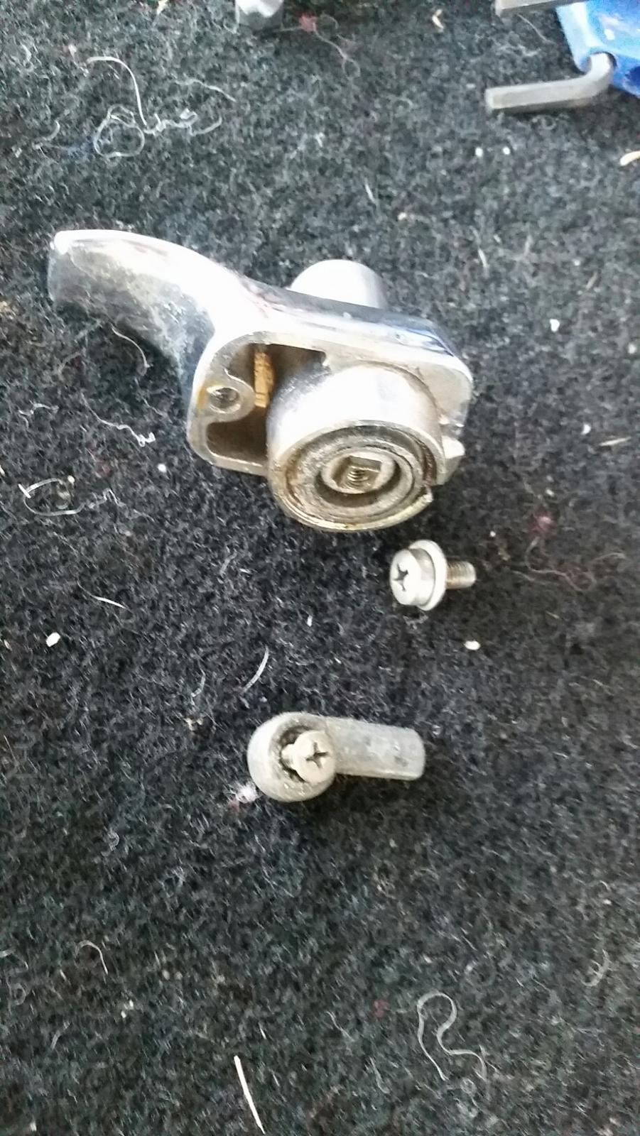

PostPosted: Wed Oct 14, 2015 10:14 am    Post subject: 72-74 Rear hatch lock Reply with quote
72-74 Rear hatch lock. Why would this lock cylinder not come out?
Thank you
Tcash
vwwestyman wrote:
I have the lock out.
The middle screw didn't seem to release the cylinder from the lock, it just seems to be holding the latch push bar in place.
The push bar and screw are seen in this pic further away from the lock.
The screw closer to the lock is what held it into the bus. The latch itself must be removed to access this screw.
If I push the button with the lock out, I can see a very small flat head screw-this appears to be what holds the cylinder in.
However, noting the info about the sliding door handle, it sounds like that might be easier.
busdaddy wrote:
The one in the very middle retains the lock cylinder, remove that without having a key in it and you'll spray wafers all over the floor.
The lock assembly is retained by a single screw above the part visible from inside, directly against the inner surface of the outer hatch skin..
Key codes are also on the slider handle on a 73, remove the screw in the inner handle and push the outer handle as well as the bezel out.
