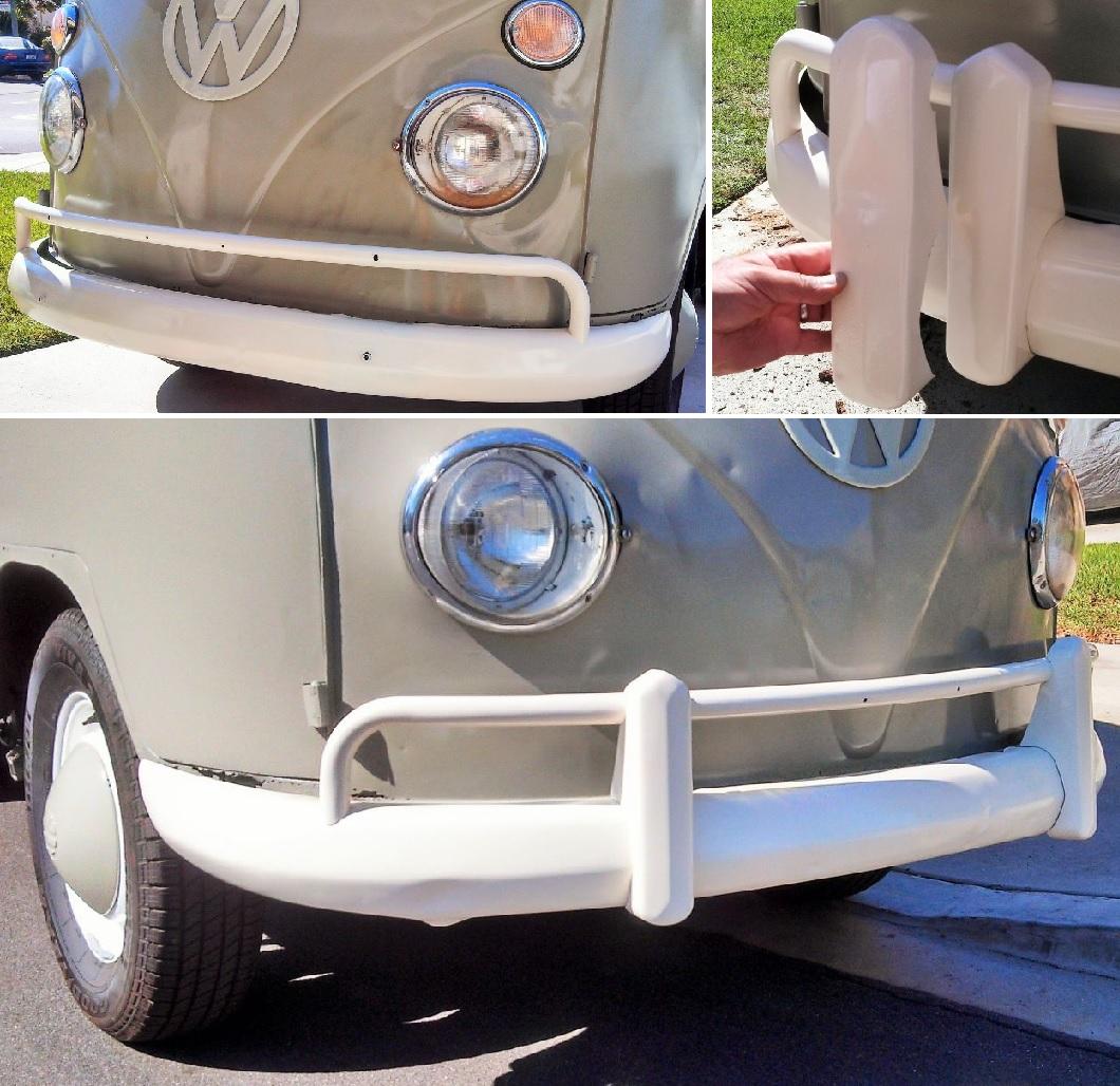

Sunday (after the Chargers beat the Raiders) I stripped the rear bumper to bare metal and primed it with etching primer. No major rust, no major dents, just a nicely used bumper.
After researching a suitable Krylon spray paint color to Silver-White, everyone recommended Dover White. But WalMart didn;t have it in-stock and neither did the Sherwin-Williams store. So I ordered 12 cans for four bumpers, rims, front emblems, etc and the guy at Sherwin-Williams said it'd be ready in a week.

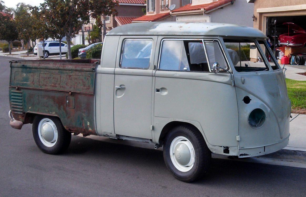

Another Friday ... so more paint stripping today. Got all of the cab section (except the center of the roof) stripped & primed today. Painted the windshield frame section, right side, and some of the left side (until I ran out of L345 Light Gray spray paint). Looking good so far, nice clean metal underneath the nasty exterior when it arrived.

After I mounted the front bumper I noticed the guards were looking really beat-up. So I ordered a new pair of them from WW ($45 each) and they arrived today. Painted them with the matching Krylon Dover White and they mounted up just fine. Interesting that there are no rubber seals joining the guards to the blade (like T34s have), just metal to metal. Definitely looks better!

Saturday after the kids soccer games I got to work stripping the left-rear panel. Within an hour it was down to bare metal & prepped with rust-conversion gel. Primed with etching-primer & painted with L345 Light Gray. Except for the obvious cancer at the bottom, the panel looks great! The neighbors are starting to say "It's beginning to look good!"

Sunday (no Charger game today) was spent stripping the right-rear panel under the drop gate. It was by far the most rusty but came out fine. Jeffrey (12) lent a hand learning how to use the DA orbital sander with 80/240 grit sandpaper disks. He did a great job but didn't like the paint dust flying around. I ran out of L345 paint before finishing the panel.

Another Friday here (Halloween) and the last day of October too. Got the last nasty paint removed from the roof and primed & painted it gray. That's a tough place to reach!
