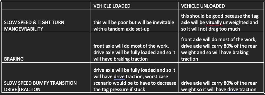

PostPosted: Thu Feb 10, 2022 5:57 pm    Post subject: Re: Building the Volkshauler Reply with quote
As mentioned earlier, I decided on air suspension. This would give me a way to deal with a vehicle weight which would potentially double when fully loaded. I would also help with the loading and unloading because I could lower the rear and raise in front to lower the deck height and increase the loading angle. Air suspension is pretty new to me. My only experience was with an old front wheel drive GMC Motorhome which had tandem axles with airbags in the rear. It worked well but had no fancy controls. It had a 3 position switch; full pressure, travel pressure and no pressure. My recent homework on air systems suggested that the best way to control the bags is with ride height sensors. These systems have sophisticated computer controls to maintain ride height under various conditions. But I had 3 concerns around the tag axle; maintaining drive traction under all conditions, dealing with manoeverability due to the tag axle dragging in tight turns, and ensuring braking grip under all conditions.
The solution I came up with was a “conventional” ride height controlled system for the steering and drive axles and a pressure sensitive system for the tag axle. The idea is to set the tag axle to approximately 20% of the drive axle pressure when there is no load. When the vehicle is loaded the drive axle would be set at 80% of drive axle pressure. I would be able to vary these tag axle percentages as I learn how the vehicle handles.
I also decided only to put brakes on the steering and drive axles and not the tag axle.
Here is a table to check how this idea works under various conditions:
As I said this is all pretty new to me so if any of you have advice I will gladly receive it. And its not to late yet because I have not purchased or installed the control system.
Thanks for following along.

PostPosted: Fri Feb 11, 2022 6:39 pm    Post subject: Re: Building the Volkshauler Reply with quote
In my opinion it appears you have thought it through. I know the GMC vehicle you are referring to.

I though I would provide a bit more details on a couple of the design decisions.
WHY A TANDEM?
As touched on earlier I decided on the tag axle idea because of the aesthetics and load carrying capability . I drew up a bunch of scale drawings with different amounts of stretch and different axle configurations. A bus with a 4’ stretch with just one rear axle looks a little too lanky. I know it might sound crazy to design suspension around aesthetics but I believe in the philosophy that its got to "look right to be right". The other big factor was payload. If you are using low profile tires the load rating is only around 1000 lbs per tire. I am planning on a GVW of around 5000lbs so the truck will easily exceed the tire rating if there is only 4 tires. I need low profile tires in the front to be able to lower the bus without tubbing and having low profile tires in the front and tall tires in the rear wouldn't look right. In addition I would not be able to lower the rear (with the air bags) for unloading because tall rear tires would hit the top of the inner fenders. So tandem axle was the solution.
HOW TO BUILD THE TAG AXLE?
The next question is how to configure the tag axle suspension. I have seen quite a few pictures of tandem axle split buses but I don't know how any of them built the suspension. One of the design premises is that as much as possible should be VW or Porsche parts. This was to have a consistent theme but also to use parts which I have and or parts that I am familiar with. A swing axle wasn’t going to work without using a dummy transmission, which seemed impractical. I am not familiar with any solid axle designs or parts so that was out. So it would have to be some kind of IRS. If the tag axle was in the regular orientation then the separation between the tag and the drive axle would be too great. So….why not invert it like Porsche #1? Seems like it should work! All I would have to do was get a second rear frame complete with torsion tube, convert to IRS and weld it in! I hope to be splicing the frame together in a couple weeks.
