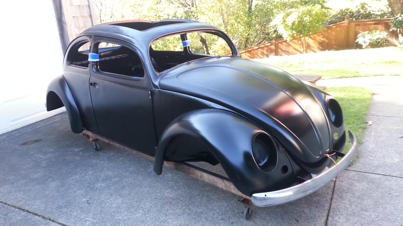

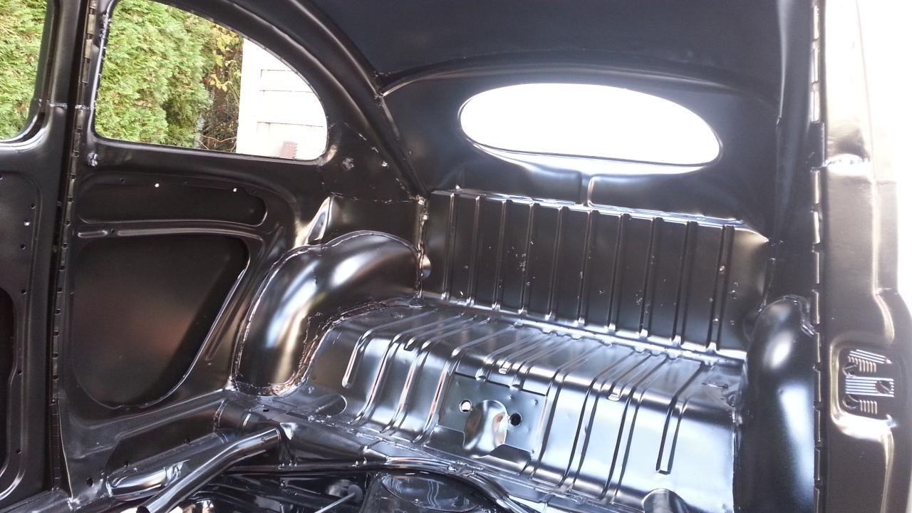

October 19 2018 - Today I get my second invoice from Rust Blasters for re-blasting my car : pull all of the hoods, doors & fenders off, hang the body in the air, blast everything, get rid of all of the blasting medium, hang everything for paint and then reassemble. That was another $2,338.01 Shocked
An insane amount of money spent altogether for the blasting and epoxy primer Sad
Ugh... life and the build must go on.
Here she is back at home waiting for another option for body & paint :

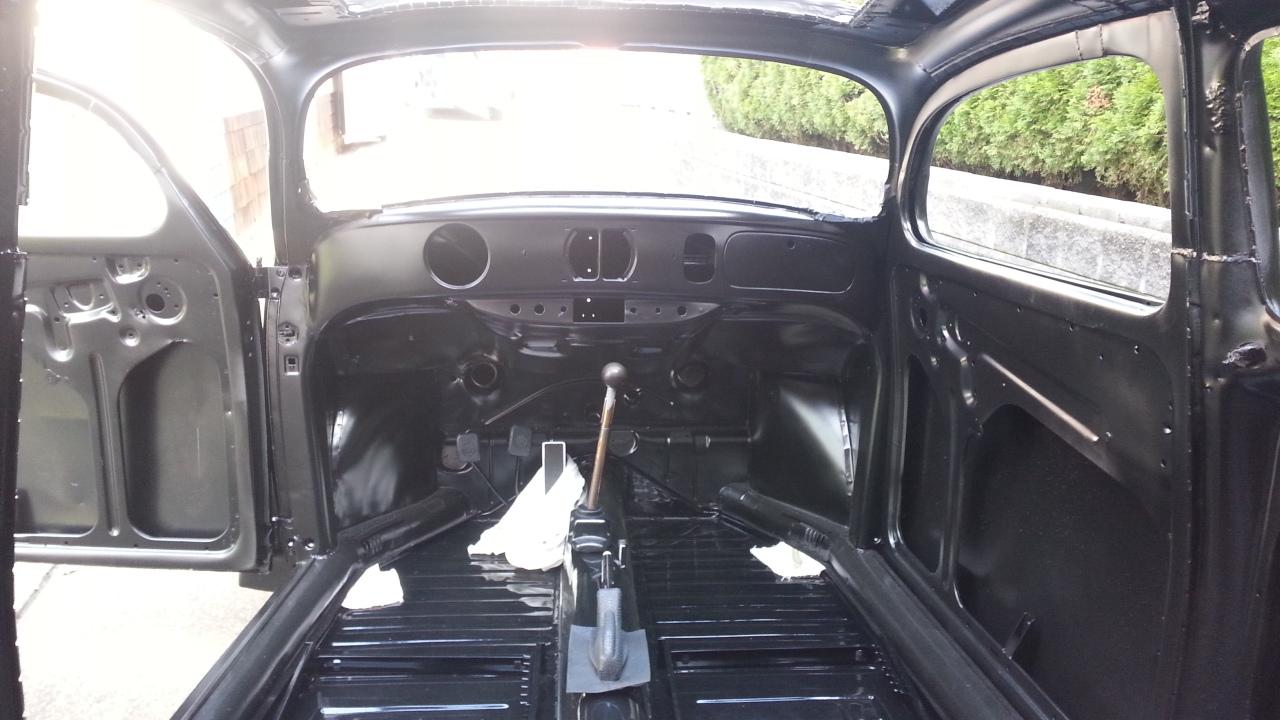

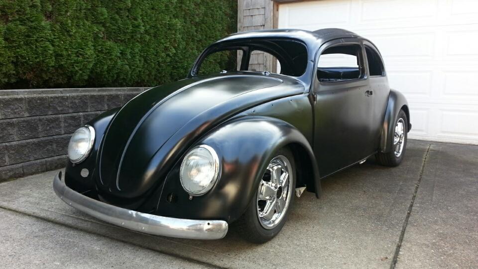

A few days later some friends popped by so that I could get the body back on the pan.
Now that the car is painted black, you can really see the dents, waves and distorted metal from all of the chopping, cutting and welding this car has seen. It's certainly a Frankenstein of all kinds of different years of body panels. Whoever the final body shop will be will certainly have their hands full straightening this one out!

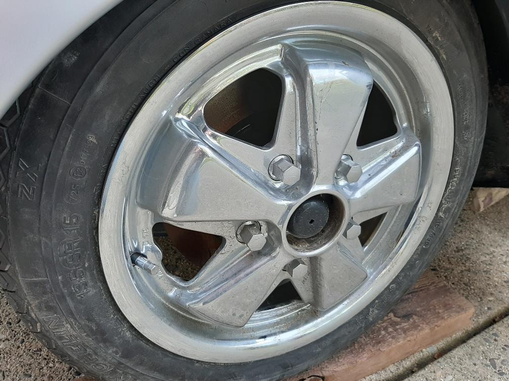

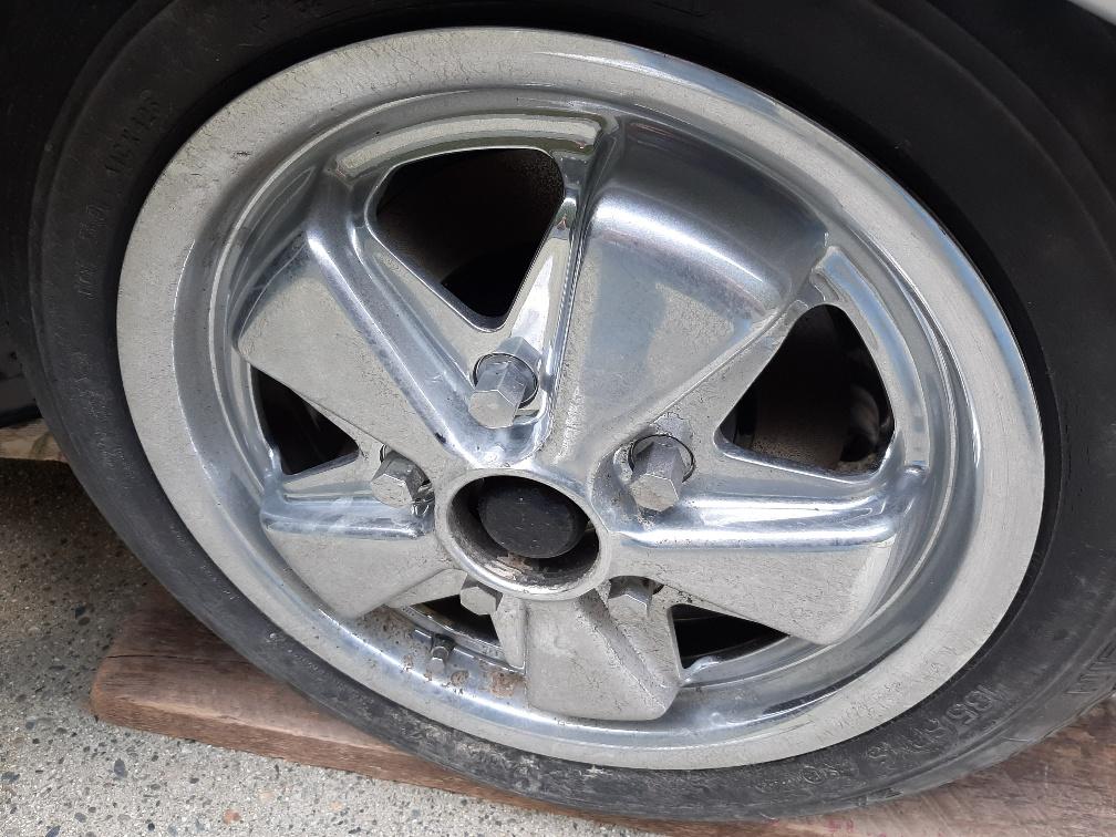

Frankenstein or not - can't go wrong with chromed Fuchs....they make any car look bad ass!

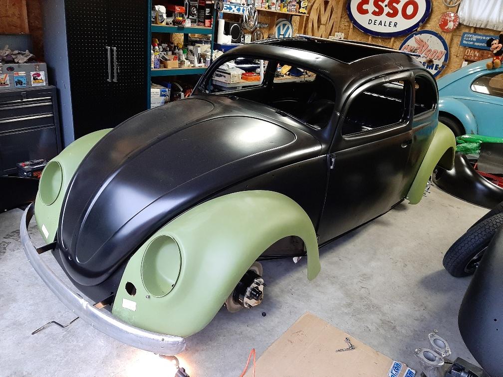

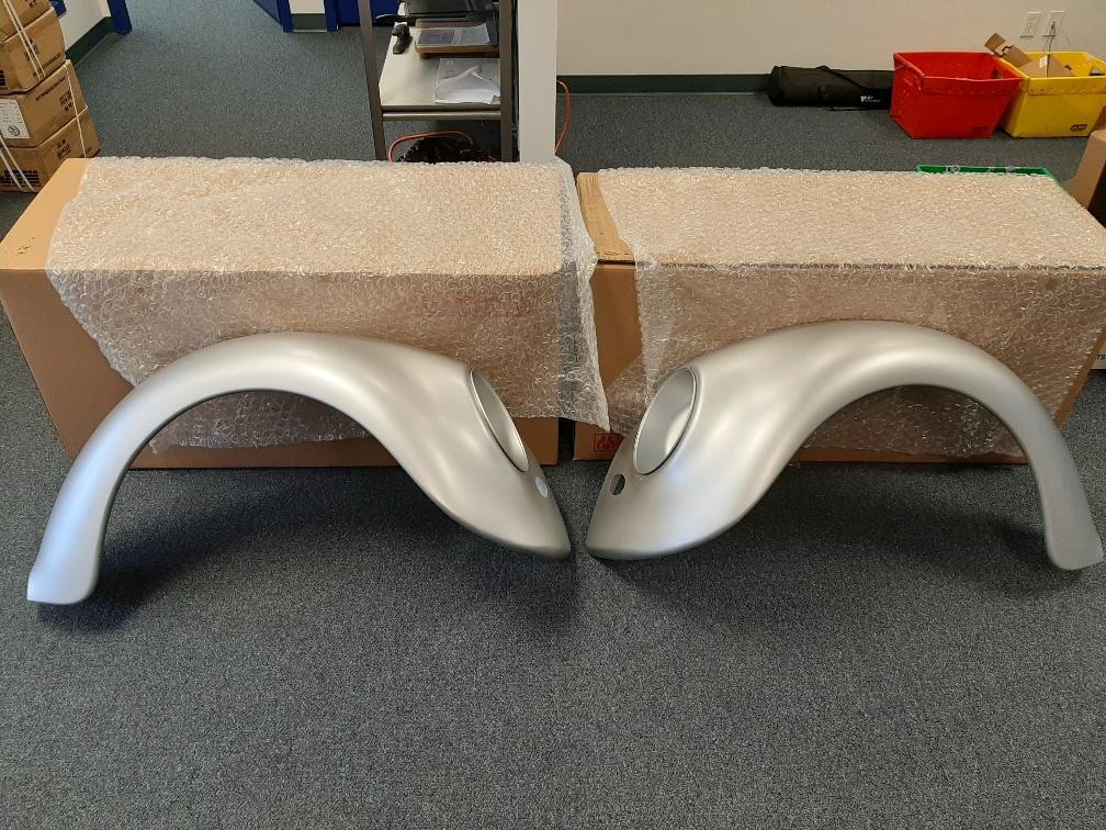

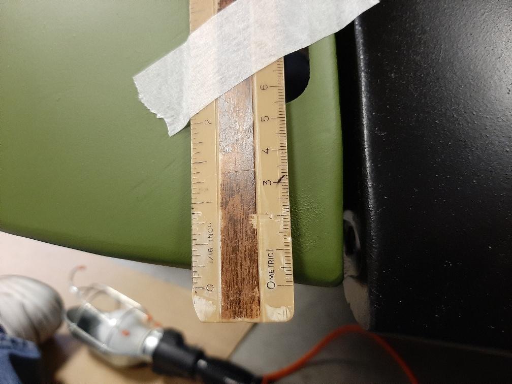

I've now been waiting pretty much a year for my friend to get his new shop opened and fit me in, so I decide to pull the trigger and get the green fenders ordered.
I missed the FedEx delivery at my house so now I had to drive out to Vancouver airport to pick them up. This was all the day before my Bug was scheduled to get picked up to head over to the body shop which is a 4 hour drive from where I live. I figure I'll have all 4 swapped around within an hour or so. Hmm... didn't work out that well.
The green fenders are made of super thick metal - very heavy. After checking them out, I didn't like the stampings of any of them. I tried fitting the front fenders but only 3 bolt holes lined up per fender. The rest were way off. The flange was stamped wrong and would require some cutting, bending and re-welding as well. Crap! Once I had them loosely bolted in place I noticed that the headlight buckets on the fenders are sticking out too far! They would need to be cut loose from the fenders, re-positioned and welded back in place. Oh man Crying or Very sad
Here you can see comparisons between the black German fender and the green. I fitted a German headlight assembly. Even adding the headlight to fender seal wouldn't make any difference :

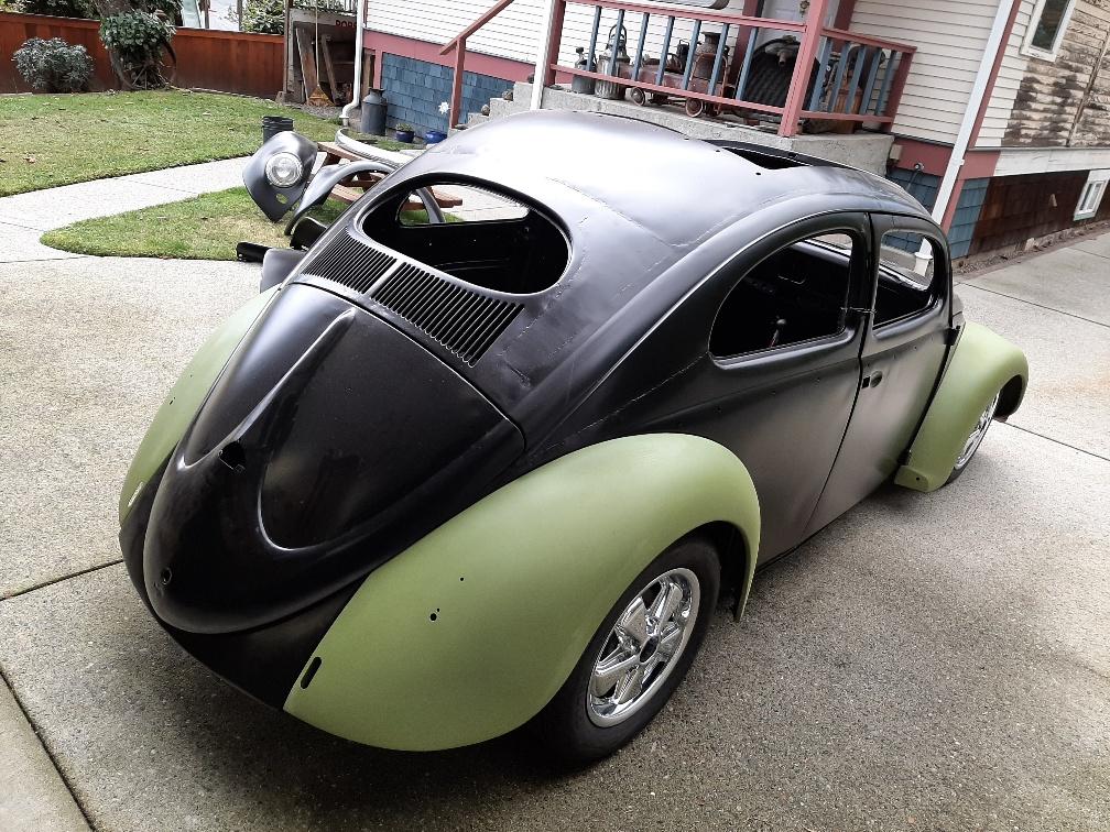

Hopefully better luck with the rear fenders... Well, no... Sad
What the heck? Now the green ones are too short and don't line up with the bottom edge of my apron! And I can't get all of the bolt holes to line up. Ugh! Plus there are other small fitment issues.
I don't know what's going on. The original German front fenders and the Brazilian rear fenders fit absolutely perfect.
Here are some of the obvious problems with the rears :

November 24 2019 - I have the fenders fitted... barely. My friend swings by my place to pick the Beetle up and says he'll have to modify and custom fit all 4 green fenders Sad Crap! Well I'm in this deep so we load the car, I give him a $4000 deposit to get started on it and away she goes...

This whole ordeal with the green fenders needing major modifying to fit was really wearing on me. More money outta my pocket. Then I hear that BBT is coming out with their own front fenders and I see all of the tooling they created on their blog. These must be good!
I make the decision to ship all 4 green fenders back to Gerson. They were really good to deal with and wanted to help me out. They offered to help pay for any extra body work or would send me another set of fenders. I said no. I just didn't want to deal with it any more.
I called my friend and said I wouldn't be using the fenders. He was rolling through town soon and said he'd drop them off at my house. I boxed them up and sent them back for a refund.
July 15 2020 my new BBT front fenders arrive!! I'll stick with my IGP Brazil fenders for the rear.

Those BBT fenders look nice. I hope they fit…

I'm surprised that Gerson didn't nail those fenders, especially the bucket depth. Why ship if it ain't shape. I've pondered ordering his fenders for my mid-sixties Bugs just for the pure heft of them, but that's disappointing news.

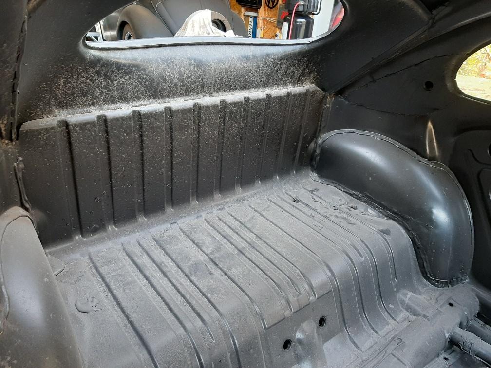

When I get the Bug back home, I have this mess to deal with :
Car is filthy. It's covered in dirt and road spray with salt - it was hauled to the body shop at the beginning of winter on an open flat deck trailer. The salt has been sitting on my new EMPI alloys for 11 months! Damn I hope they clean up ok.
So... I never got any of my money back Evil or Very Mad , I spent 2 days with the bug up on jack stands trying to clean my suspension and the whole body inside and out. What a nightmare. The sooner I can forget about this and put it past me the better off I'll be.

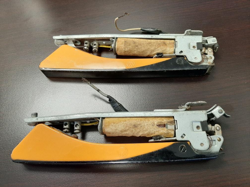

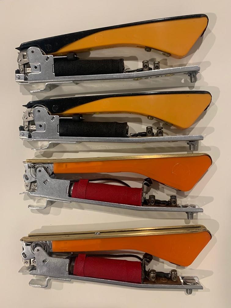

I've collected a bunch of semaphores over the years and since I need a set for the chop top, I decided to contact Matthew Ross and have him rebuild a bunch of them for me :
https://www.thesamba.com/vw/forum/profile.php?mode=viewprofile&u=16303
Matt is definitely a semaphore freak! He really knows his stuff. I wound up sending him 9 very early ribbed semaphores for pre 1953 VW's and one set of extremely nice smooth SHO semaphores for the chop top.
Matt stayed in touch with me during the restoration process giving me updates as he progressed. In the end, I got back 4 pairs of the ribbed and the one set of smooth all fully rebuilt - all disassembled, plated, wired, new springs, lenses, covers etc. They turned out beautiful.

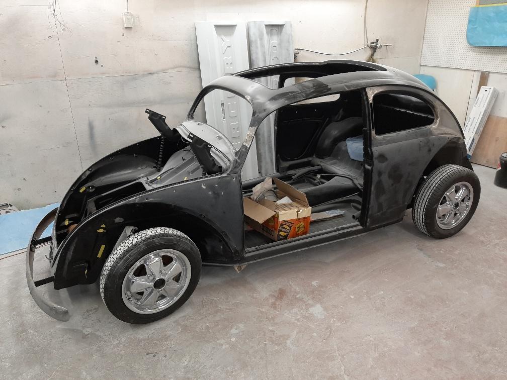

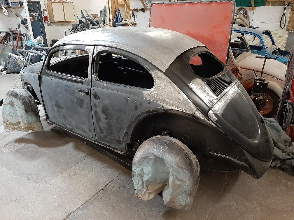

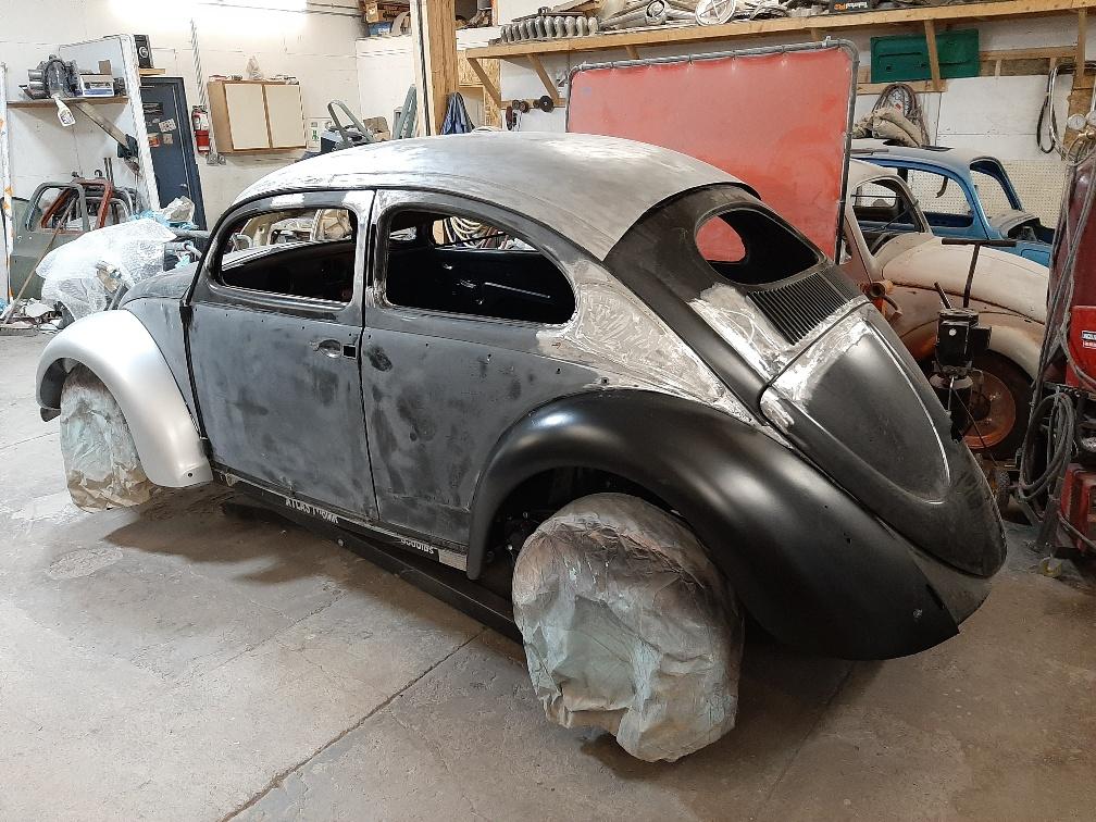

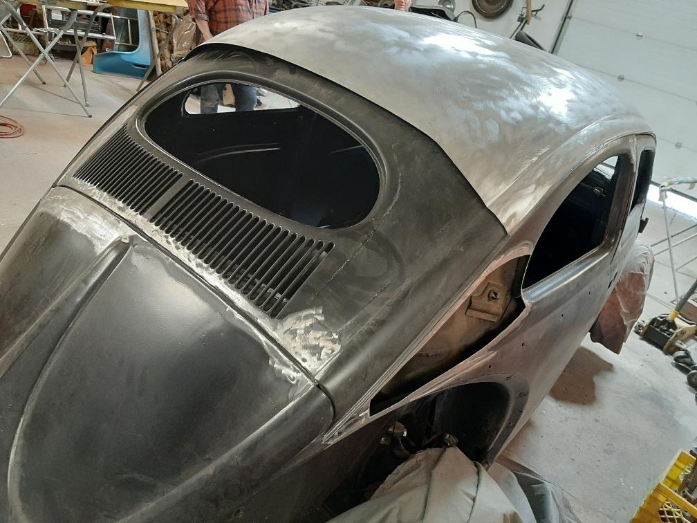

December 28 2021 - These guys don't mess around. In the course of 1 month they have completed a ton of work. They've replaced the rust along the bottoms of both doors & body worked them. All 4 fenders are body worked as well as the front hood and deck lid. Now it's onto the body :

PostPosted: Wed Jul 06, 2022 3:52 pm    Post subject: Re: 1964 Chop Top Build Reply with quote
A few photos from December 21 2021
