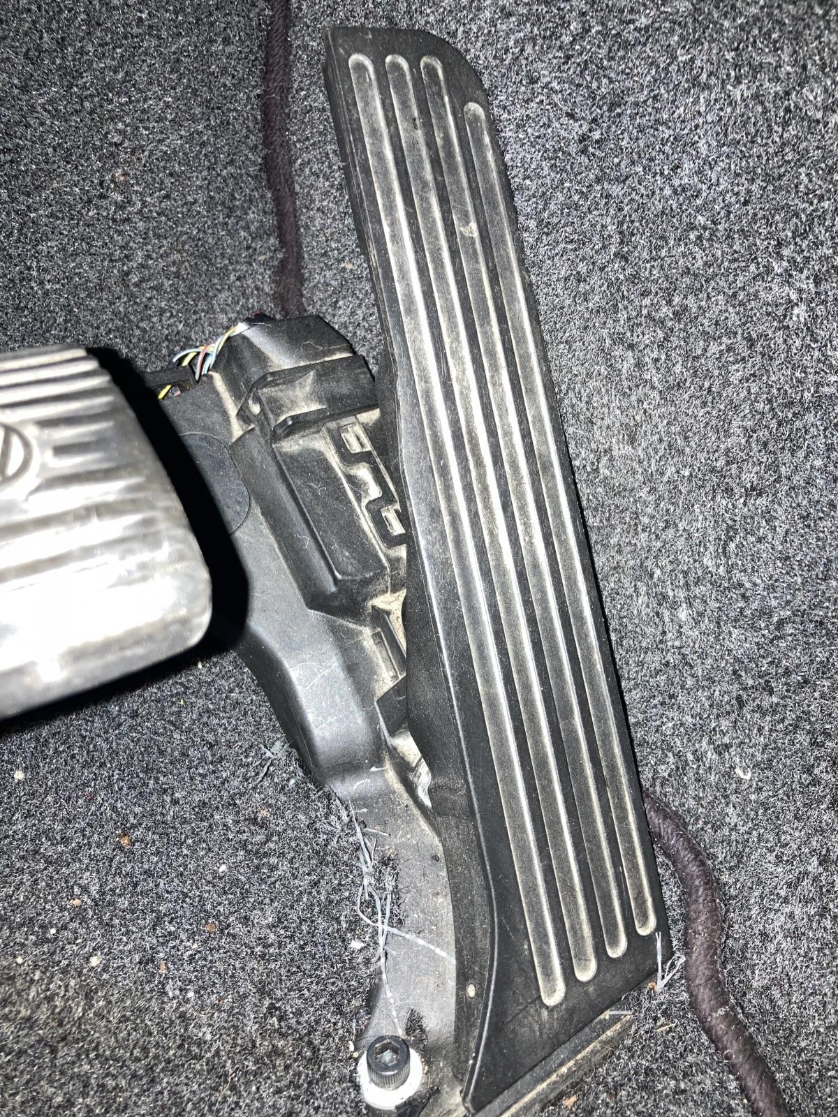

Little follow up to the swap. I know a lot of you guys have done both diesel and Subaru swaps that use electronic pedals. The Mk4 VW pedal is top swing and is a popular choice. I used the mk5 pedal from a Jetta which is bottom swing like the original vanagon one. The wiring is the same even down to wire color. The plugs are different though so I just soldered a jumper loom on the the cable extension provided by my harness constructor. That was originally done for the mk4 pedal. There is a little grinding required to get pedal to fit nicely on the floor and a bracket to hold the top section. But overall a nice piece that looks fairly original.

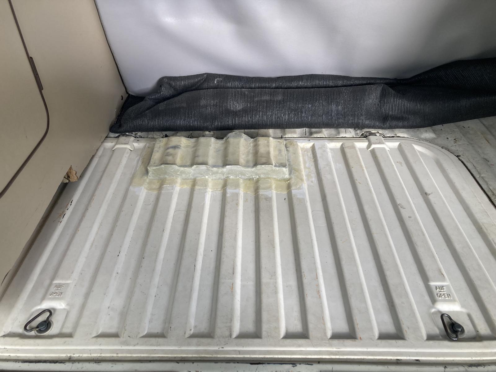

This is how my engine cover lid ended up. Small bump.
