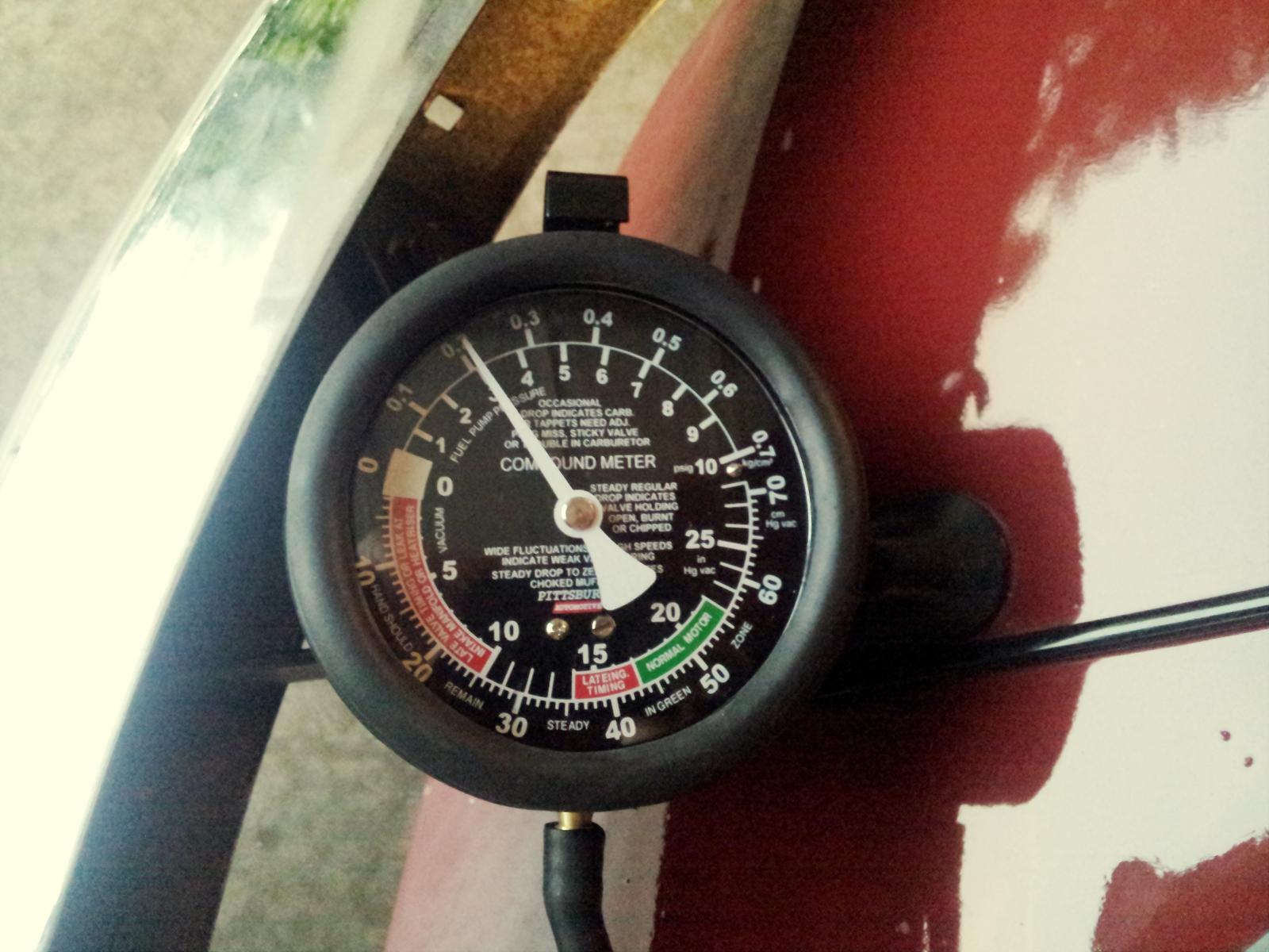

Does you "Hmmm" mean you're running w/the DVDA side disconnected after timing it w/both hoses connected, as it's supposed to be done (at least on a "known good" motor)?
Click to view image
Save the Supers!!
