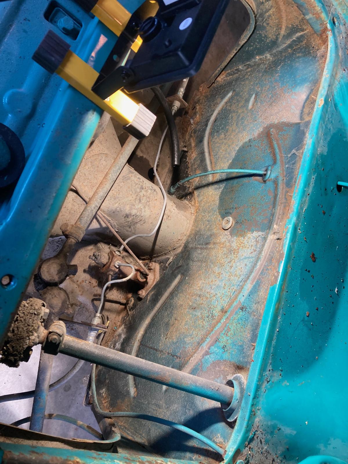

Weather warming up. Removed gas tank to find more rust at bottom of front firewall. This matches rust evidence in the front heater channels inner firewall. A couple more green panels ordered.... Master brake cylinder wiring not attached but will be addressed on new harness install. Maybe add new steering coupler to list. Also the new gas line shown (cut) in the photo was looped around the passenger side steering tie rod. Every time the steering wheel turned the fuel line rubbed against the steering tie rod.... mainly caused by not replacing the original fuel reserve valve/filter and using a direct gas fitting to the tank!

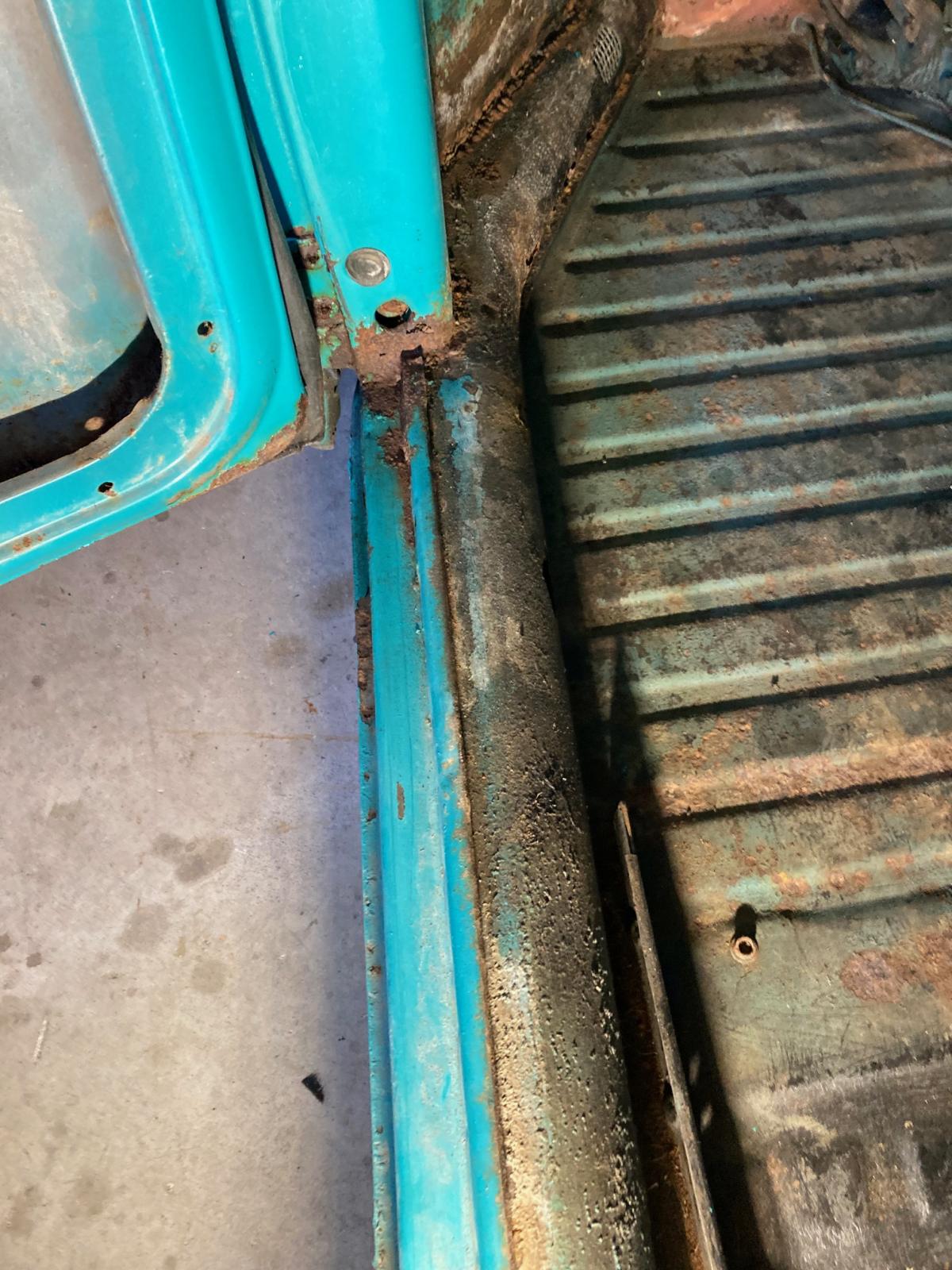

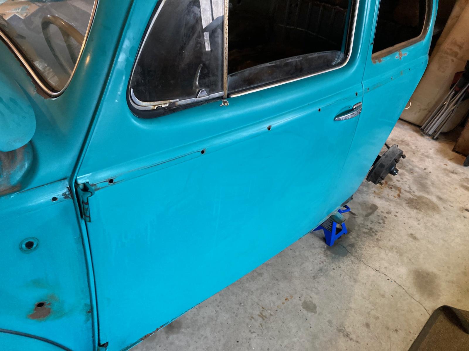

PostPosted: Sat Mar 01, 2025 1:23 pm    Post subject: Re: New project - 1954 VW Beetle Deluxe w/ VW Canada prodn plate Reply with quote

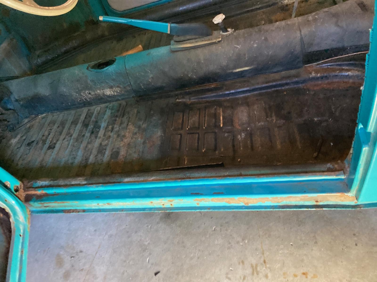

So had to cut the drivers side newer running board off because a previous owner had used stove bolts. This would not come off otherwise without damaging the OG fenders. All but three rear 14mm fender bolts remain plus a bumper bracket bolt. Tomorrows task as it gets warmer. The 14mm bolts so far have come off easily with a wee bit of heat.
Drivers side heater channel holes made by gentle pressure with screwdriver. Also lower hinge and door repair required.
Passenger side looks fine on floor pan and channel except at front firewall and inner.
Will see when we open it up.

Nice looking ribbed door!
The A pillar bottom and heater channel are shot! You might want to keep the door in place when you remove the pan. Been there, won’t do that again!

A pillar and heater channel definitely gone... door shut and ......bracing also?
Heater channel and rear quarter are solid it appears. Got drivers side rear bumper bracket off today and bumper mounting point shows no rust or prior accident. Two more fender bolts to go and being careful to not strip them!!
Passenger side work requires sale of another car and clean out of garage......
Pictures to follow...

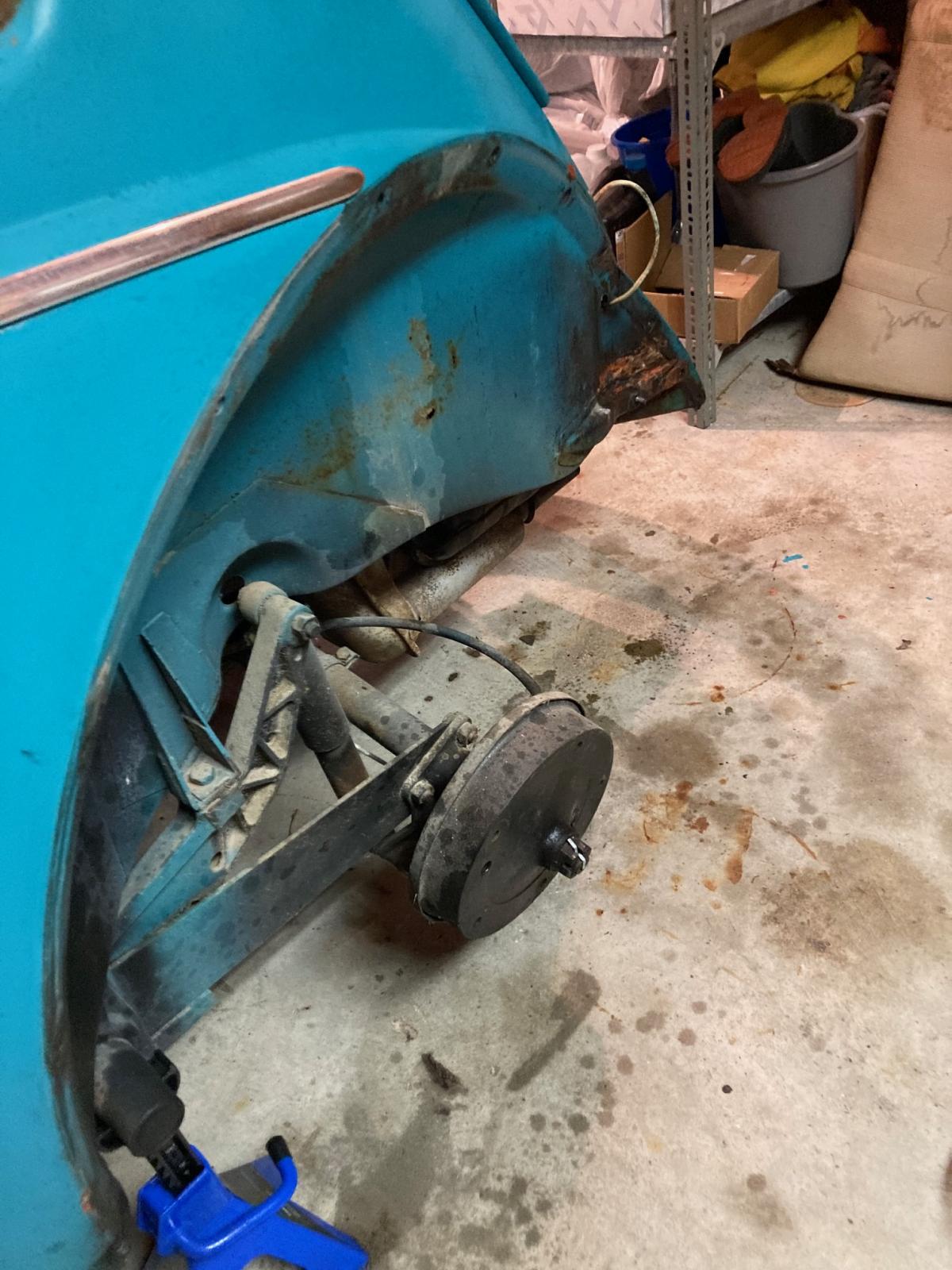

Not bad... rust perforation from rear tray and overall rear panel alignment intact. Bumper bracket mount has saw mark.... needs further investigation. No stripped bolts or body fasteners. Just one bumper bolt snapped.

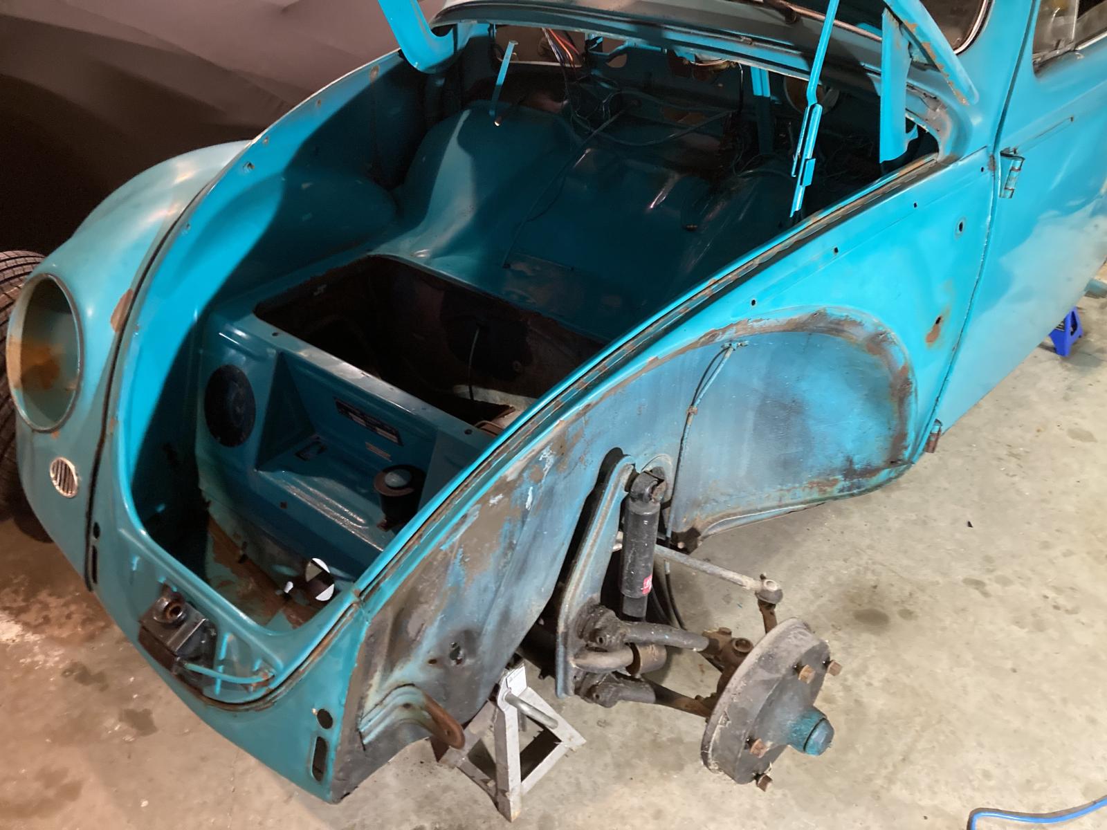

Tear down of entire car continues for future bodywork.... and in no particular order as old rusted bolts continue to succumb to penetrating oil and cautious heat application.
Yesterday the six exterior body chrome strips came off. They had been removed before for the glorious blue 1992 repaint. 1st one taking 30 minutes... the last about 60 seconds. Used thin/and thicker plastic wedges between body and moulding with oil to the clips. Had a metal upholstery tool with a flat blade and notch in it that would compress the clip to release it. No bends to the moulding or damage to the body. Will be polishing them up and reusing them.
Drivers front fender will be off by weekend. Likewise interior of drivers front door being gutted. Two screws holding up at moment. Have new aluminum door trim/rubber scrapers, vent window rubber, etc. and looking at re-chrome of vent.
Glove box door, and speaker chrome grill with screen removed. I am told the the Deluxe speaker screen may have been flocked in black by VW while the standard/Cdn custom screen was painted? Anybody know this one?
Transaxle needs two new rubber axle boots. The old ones aged out when I put the car up on axles stands...... they immediately cracked.
Wide whites now mounted on rims for ease of movement; and all four rims OG dated 08/54!! Rims will need to be trued before final install.
Got detoured on wheel rim colours as I got a spray paint can of ultra maroon to experiment with.
Met another local '53 VW Beetle Custom owner and saw the car last night.... lives in the neighbourhood !! Saw it at our first Vintage VW Club of Canada meet in Winnipeg on August, 1981. Original upholstery with 25 hp motor and some body work required..... being brought back to roadworthy condition!!
On the rear apron front, will keep inner structure, take out spot welds, and slip in Wolfparts apron... Will see what happens!
Scott

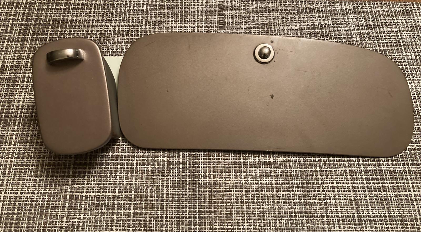

Quick ultra maroon sample on ash tray cover. Small flake amazing!! Even better when professionally done!!
Original ultra maroon glove box door
Ultra maroon paint code
Scott

PostPosted: Thu Mar 20, 2025 6:15 pm    Post subject: Re: New project - 1954 VW Beetle Deluxe w/ VW Canada prodn plate Reply with quote
Drivers side done. Minor tussle with front fender wiring tube to body will require a touch of metal. All bolts came out again .... no strips. Rust hole at A pillar as expected. Couple of items still in drivers door to be removed. Onto passenger side tear down....
Was trying to save OG horn it looks 50/50 with the rust!
Scott

Received an OG ultra maroon glove box door to compare to my respray of the ash tray cover. Almost dead on match.

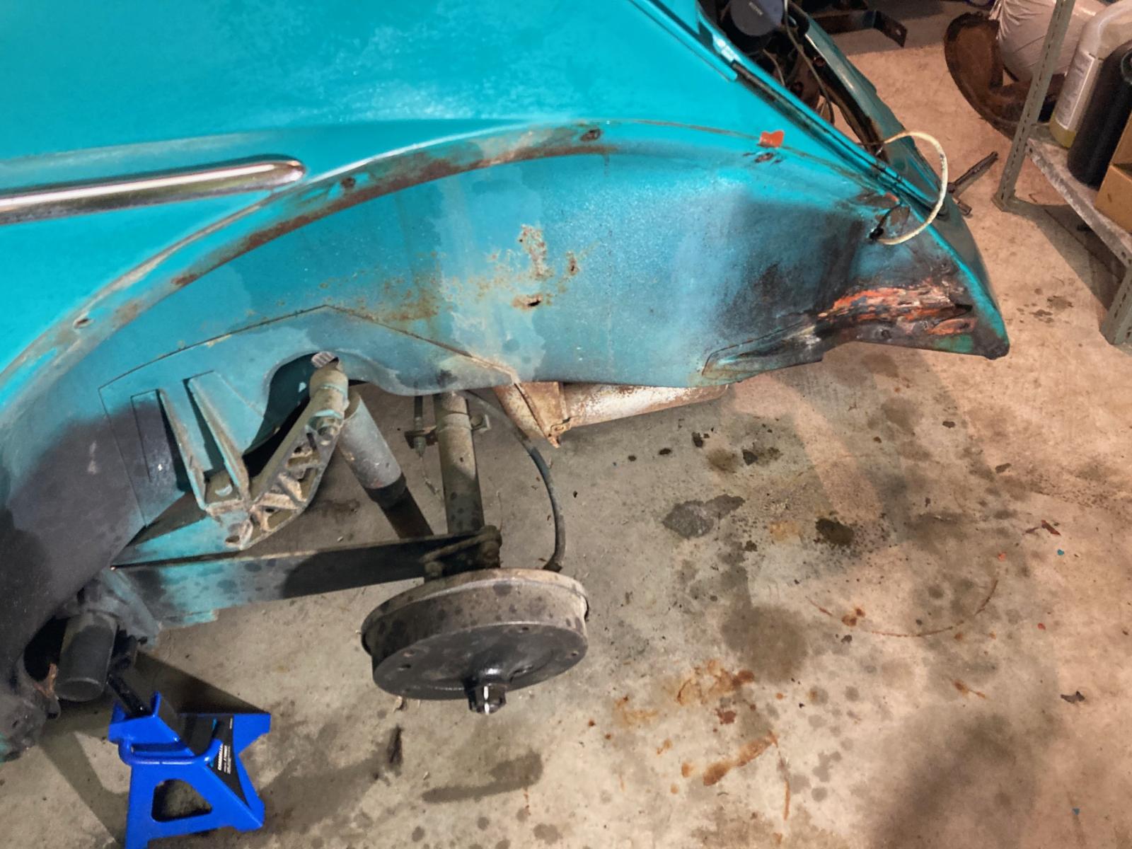

PostPosted: Thu Mar 27, 2025 6:21 am    Post subject: Re: New project - 1954 VW Beetle Deluxe w/ VW Canada prodn plate Reply with quote
The passenger side running board was cut up and sacrificed to the VW gods. Once again another "stovebolt" was used to attach one end and the rear fender had to be preserved. 2 expensive cutting disks later (Dremel) plus two running board bolts that just unbolted from the body with no problem.... done that task.
The heater channel appears solid on this side to the back..... but it and lower door hinge will be replaced anyway just like the drivers side.
The passenger side rear fender has two bolts holding it in place for now that can be easily removed.
Next step..... clearing out what remains of the dashboard switches and some wiring (new harness). Steering wheel stays in place for now to move the vehicle.
Removal of 40 hp motor next...... still plans for 36 hp in the future. In anticipation there was a sale and more $$$ spent of the budget. Note that 4 tailpipe baffles are spot welded in place.

Looks like its had a bit of a tap on this side.
An easy one to pull out tho.

It looks like a tap......but when looking at the inside of the front hood it doesn't.The front fender fits to the headlight conduit.... anyway we can examine this week.
The rear passenger fender held on by two loose bolts!! All fender bolts have come off perfectly. Meanwhile I am looking at a few engine sheet metal screws giving me more trouble in taking them off. Nothing that a lot of penetrating oil and application of heat.... plus time....... for entertainment. I was able to remove some petrified remnants of the old engine rubber to body seal.
Sunroof (Don) planning to come over late this week for an assist in dropping the motor. I am looking at a very long engine bolt for the starter that looks non-stock and entertaining.
Similar to painting underneath the front hood, the motor was removed and the whole compartment, wiring, and all, treated, to a coat of blue paint. With old wiring cut and spliced its a good thing the harness will be completely be replaced. You can also see the rust perforation of the rear parcel tray/ similar to the small hole in hole in the drivers side rear fender well...... picture to follow.
This will also be the first clear look at the transaxle and its condition.
Rear firewall
Driver inner rear wheel well
