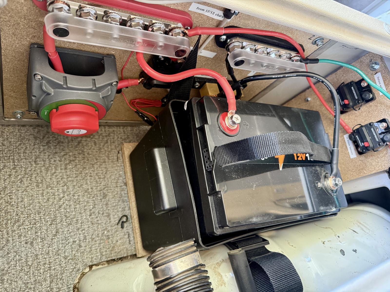

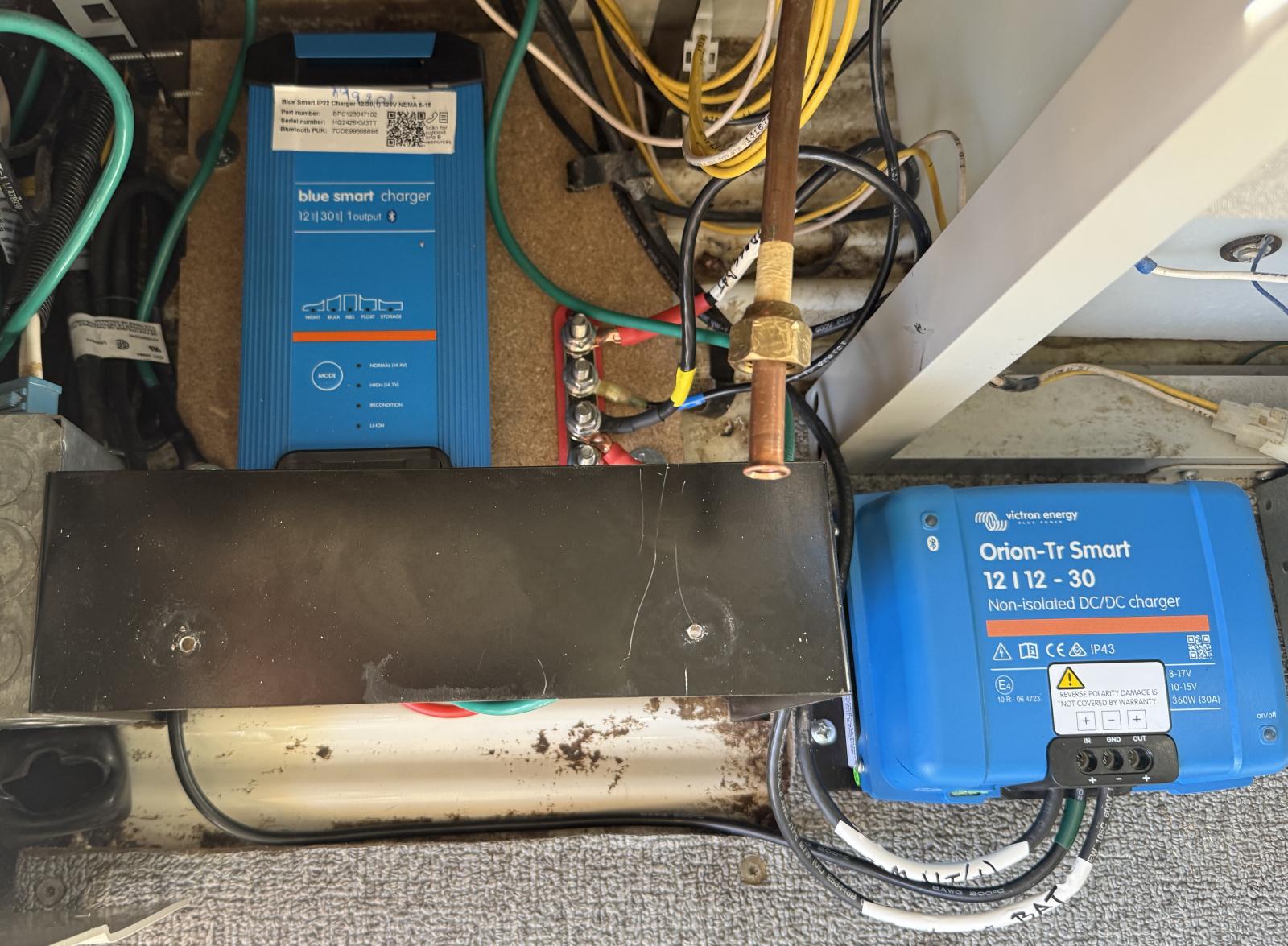

PostPosted: Wed Apr 23, 2025 7:37 pm    Post subject: Re: DC to DC charger install - does this work? Reply with quote
dsh1705 Very clever upgrade for quickly getting to that area.
With everyone's help and encouragement, I was easily able to get the furnace out without removing the back. It went very smoothly.
I removed all the wires from the isolation post and moved all but the wire from alternator to the new bus bar. I then mounted the Victron DC Charger to the floor on driver side rear under where the isolator post was and commented the wire from alternator to DC charger input (+) and ran DC charger Output (+) to the bus bar that included the wire to a 40 Amp breaker and house battery.
Where I had planned to mount the DC charger in the passenger side battery compartment I left blank for next years project of Victron solar.
It all works as it should. I really appreciate this thread and others like it for helping me choose gear and think through the issues to complete this project.
Now to put the back seat back in and get her loaded up for a California beach vacation.
Here are a few pictures of my upgrade.
