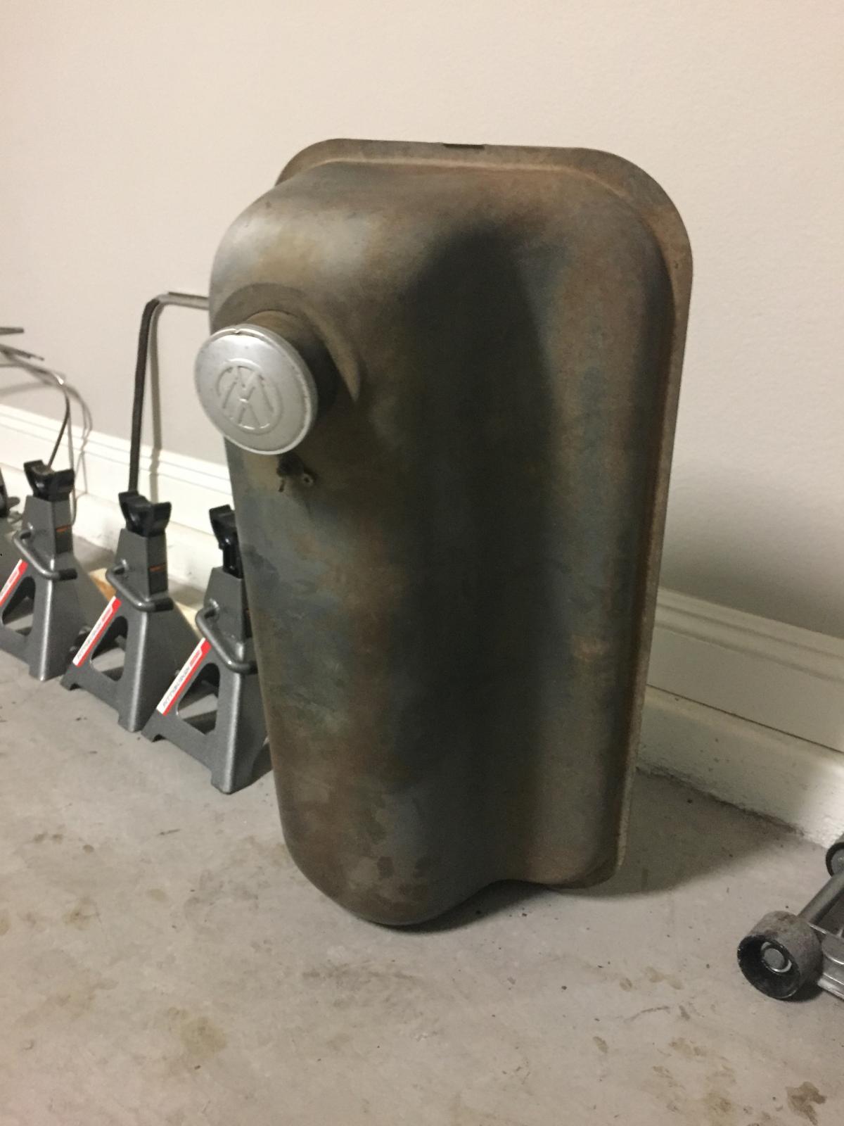

This is regarding the gas cap for my '60. I saw some posts about the '60 only gas tank, but could not find anything specifically about the gas cap. I ordered the "GAS CAP 56-60 80mm" from WW, but I suppose I should have measured it first because it was too big.
My question is this: Is the 70MM cap from the '61-67 the one that will also fit my '60?

Better send us a pic of your tank, doesn’t sound right…
Here is a picture of the tank.

I don’t believe that is a factory tank.
They usually have a step down at the rear like the one below, and yours seems to be tall clear to the back. Looks like your trunk liner doesn’t like the shape of that tank either…

That’s a 60mm small neck tank - it’s factory, but wrong for your year. That tank was used intermittently from late 1952 to 1955, and usually associated with zwitter model 1952 to 1953. They are unusual - I’m going to stop short of calling them rare, as when the word rare is introduced suddenly things become gold plated. That tank looks oddly clean - either someone did a nice restoration or it’s a reproduction… I don’t think the small neck tanks are being reproduced.

Thanks, that's great information. I had no idea it was the wrong tank and no idea where it came from.
Looks like the tank is either restored or a reproduction. The inside of the tank is pristine as well.

I did a little Go Ogling, and yes, they do reproduce the small neck tank… so what’s the fun in that.
https://www2.cip1.com/VWC-111-201-075-B/?gad_sourc...gKEyvD_BwE
If it’s clean inside like you said, and given the outward appearance, I would say that tank is a reproduction. The correct tank would be the hump tank that House posted.
Looks like you found my exact tank! Interesting that whoever bought it went with that particular tank..
Side note, I just ordered the cap from that site. Mine seems to have a nit of a leak.

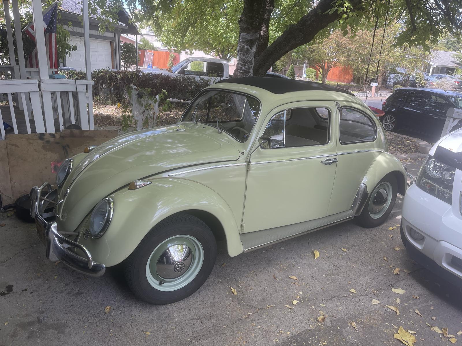

Here's a quick picture of my new to me 1960 ragtop bug. It's fairly original, a bit rough around the edges but serviceable and fun to drive. I surprised my daughter at school yesterday picking her up. She had no idea I drove to VT to get it. She's hooked!
Eventually I'll start a proper thread on it

Still has the original headliner? I see it's cloth.
