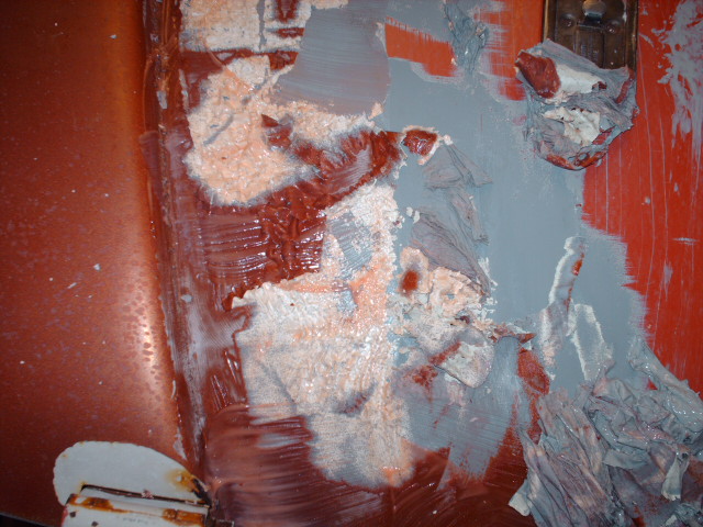

What works in primer? I've been removing the dark green, but nothing touches the thick primer. more pics in the link below....

Paint stripper and fine steel wool have shifted that on mine,try on a small spot.the og paint is really tough and has been unafected on mine

I have been using the steel wool and oven cleaner method, just does not touch the primer.
also tried graffiti remover. I will try some paint stripper.

That primer has been a problem for me too. If it didn't scrape off after 2 or 3 coatings of paint stripper, I carefully sand it down with 1000 grade wet and dry. It seems to have eaten into the paint.

This product takes anything you want off one layer at a time. It worked on primer with no problem and so long as it's removed in a timely fashion will not ruin the paint underneath. I highly recommend it!

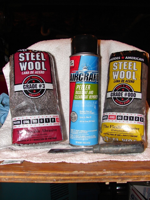

I've had great success with steel wool and aircraft paint remover.
Takes a bit of work to get through multiple layers, but it is very gentle on the OG paint.. Smile

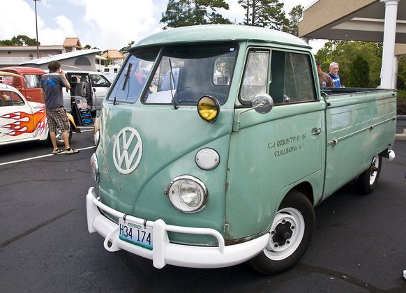

My pics disappeared way back there but I have everything in my Samba gallery now. This was using Jasco Green Strip and a stiff nylon brush, washing everything off with a mild cleanser after each section. Buffed with 3M Perfect-it 3000 and a waffle foam pad on a rotary buffer.
The roof was the only really tough section - everything was super-baked on.
Before:
Progress:
After:

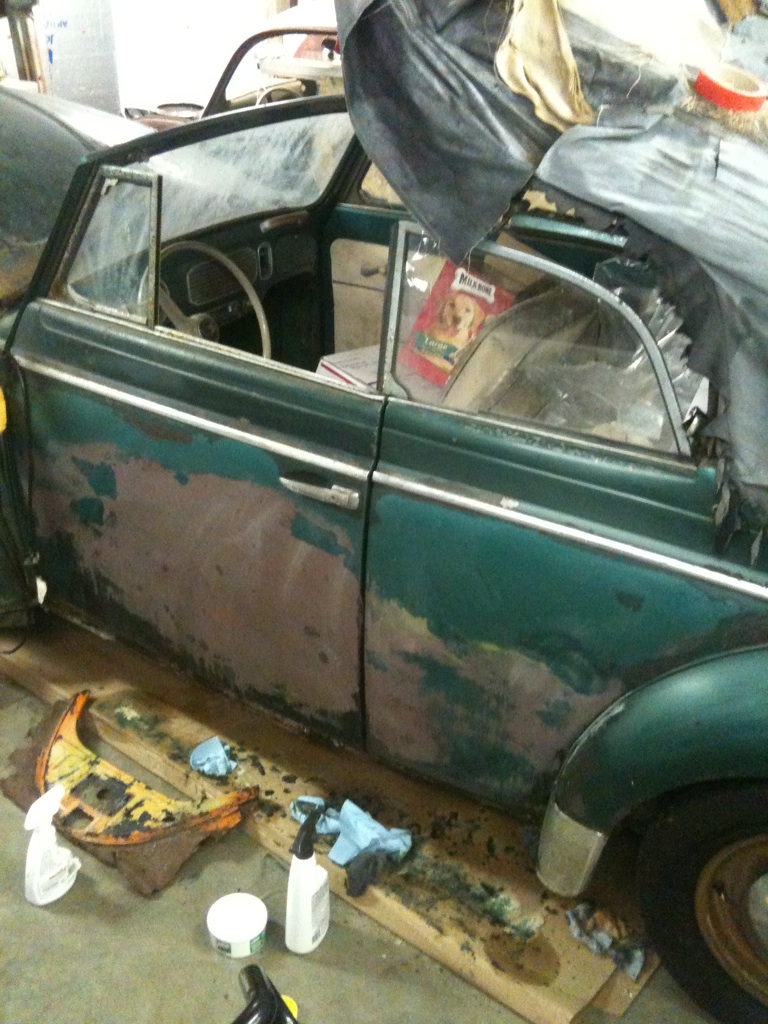

johnnypan wrote:
cru62
Joined: December 31, 2002
Posts: 4121
Location: Margaritaville.....24/7
cru62 is offline

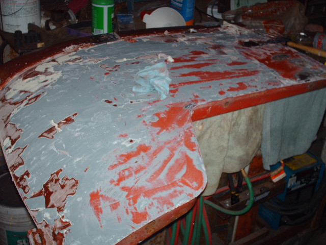

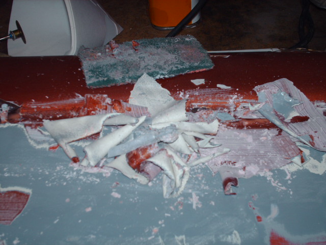

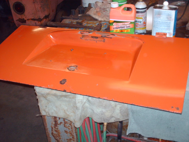

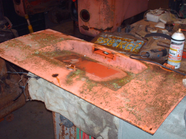

PostPosted: Wed Dec 07, 2011 3:52 pm    Post subject: citristrip Reply with quote
I've had really good luck using CitriStrip.
Before-
After-
Here are a couple showing the mess involved-
All in all I'm pretty happy with how well this stuff works. It WILL soften OG paint if you leave it on long enough, so be careful

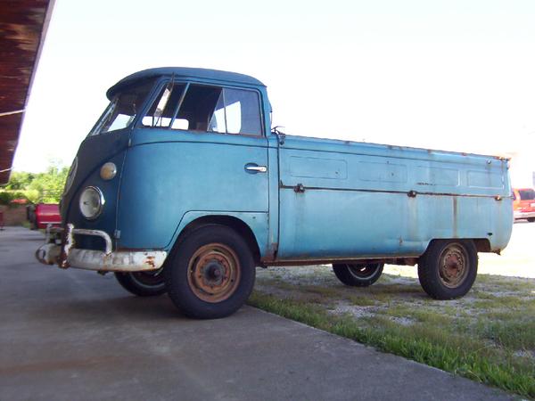

Ok so I just read through 10-15 pages of this thread... hope to read the rest at some point.. but in a bit of a hurry to try and strip some of what looks like rattle can primer off a 69 savanah beige bus I recently picked up.. from the sounds of what I have read it looks like I am lucky because only about 1/3 of the bus has the primer on it while the rest is og... pretty ratty looking bus but, solid enough that I'm hoping to get it on the road again. I saw a lot of examples of stripping paint, but what about just primer... Is graffiti remover the best way to go for primer? My guess is it wil work but will very quickly work through the primer? So don't let it sit very long?
