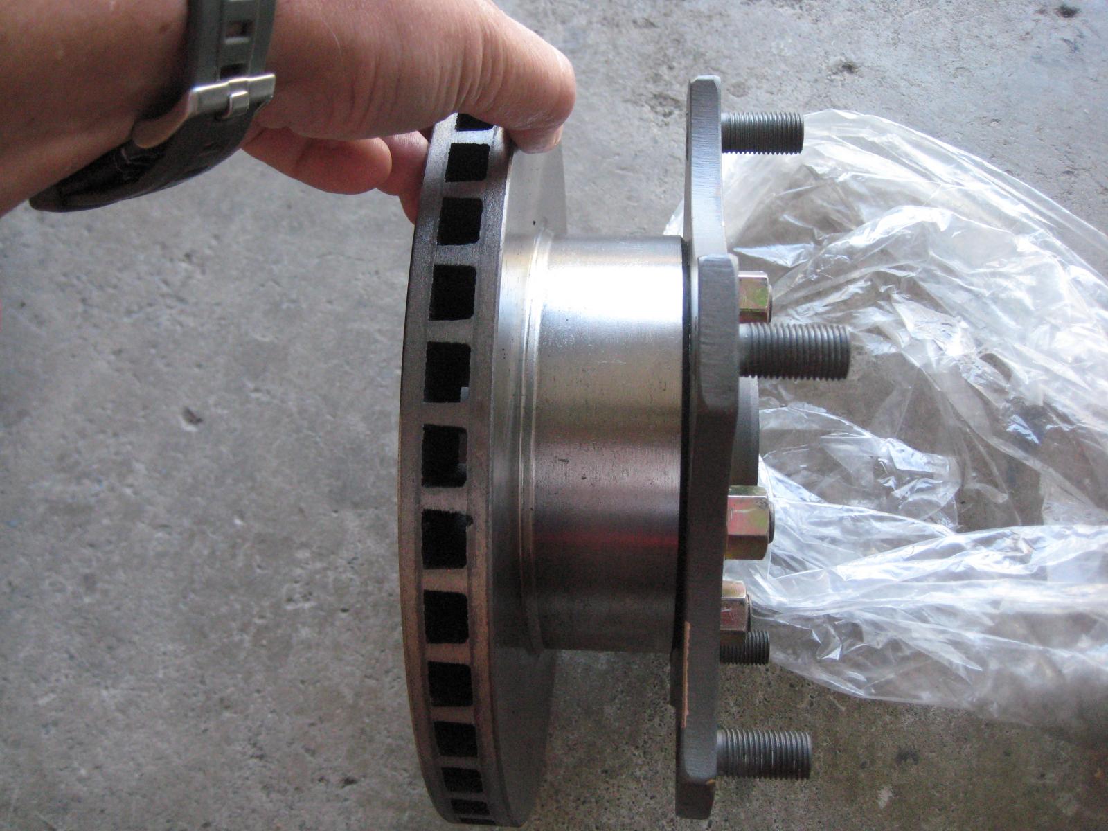

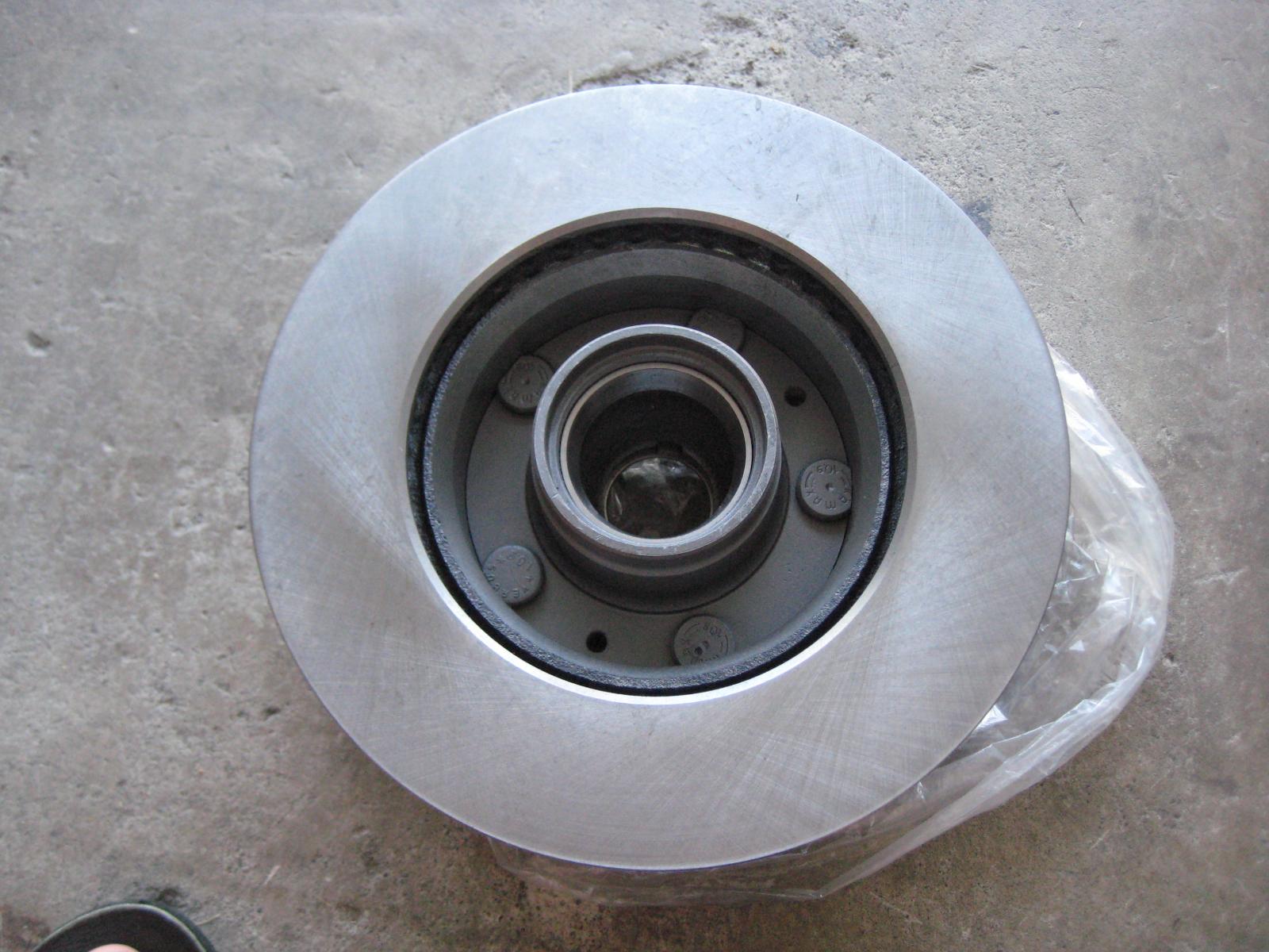

Just throwing this out there but the Old Speed kit uses a Volvo vented cast iron rotor and Wildwood calipers so everything is readily available.
5x205 and stock 15" wheels?
drive your split.
srfndoc
Joined: August 21, 2010
Posts: 3410
Location: SoCal
srfndoc is offline
PostPosted: Wed Oct 31, 2018 8:48 am    Post subject: Re: Front disc brake conversion Reply with quote
sled wrote:
Yep. That's what I run on my Westy (stock 15" wheels with 195R15 tires).

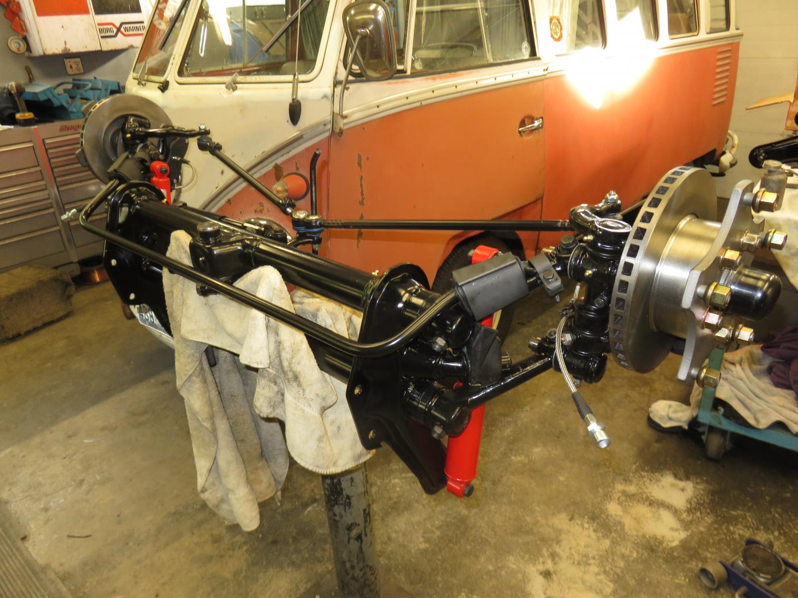

todd do you have any photos from your installation you could share? or could you pop a wheel off and get some pics for this thread?
Im looking for discs for one of my stock buses so I want to know all the available options.
drive your split.
srfndoc
Posts: 3410
Location: SoCal
srfndoc is offline
PostPosted: Thu Nov 01, 2018 9:32 am    Post subject: Re: Front disc brake conversion Reply with quote
I don't have any handy but Splitty1974 posted some further back in this thread:
He also had one installed minus the caliper:

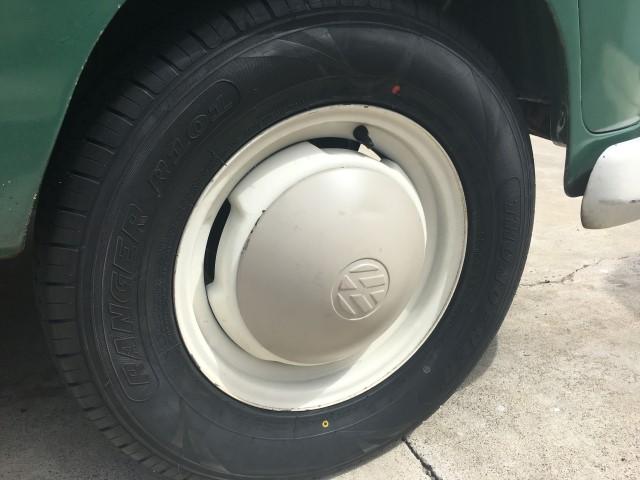

Thanks all for the Old Speed kit info. Do they work fit with 15" bus wheels?
I've always assumed that if it fits a 14" wheel, it should fit a 15" wheel (cuz, logic), but that's clearly not true.
srfndoc
Posts: 3410
Location: SoCal
srfndoc is offline
PostPosted: Tue Nov 06, 2018 8:56 am    Post subject: Re: Front disc brake conversion Reply with quote
Old speed kit does work on 15" bus rims.
