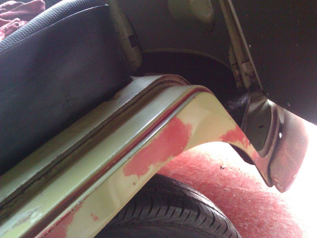

So it's time to start removing the primer off my OG Mango green so23. See:
It's been in California all it's life and was painted in patchy primer around 20 years ago, so the PO believes.
I took some cellulose paint thinners and spend about 10 minutes on the dog leg with the results above - the paint is pretty good but It's gonna take a long time like this to do the entire bus, well just the lower half is my target for now.
Gonna try some of the Graffiti remover now
Lee

Cheers Ben. I've not tried Nitromores yet, but the primer is a single coat and really patchy all over. I don't want to damage the OG paint underneath, but I'll give it a go.
How does meths neutralise it ?

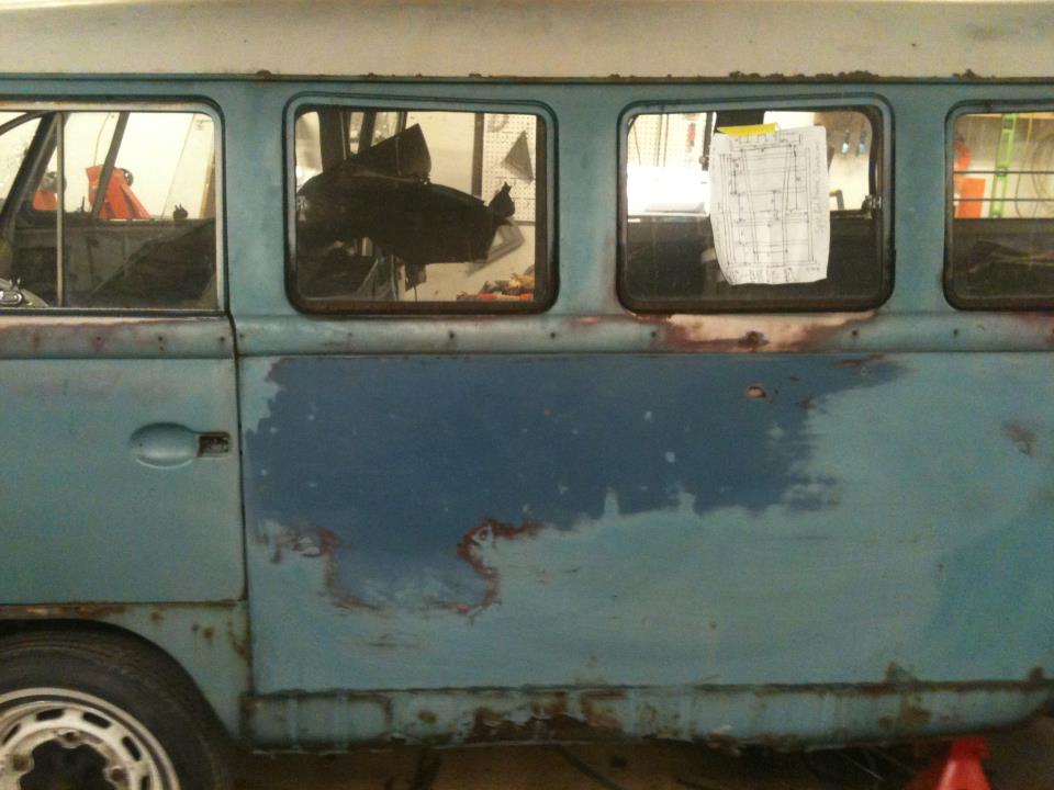

PostPosted: Tue Feb 07, 2012 6:36 pm    Post subject: Reply with quote
who would have figured 6 -8 coats of paint would be brittle. poor prep work by the guy that originally painted it ended up being pretty kickass
10 minutes and a razor blade!

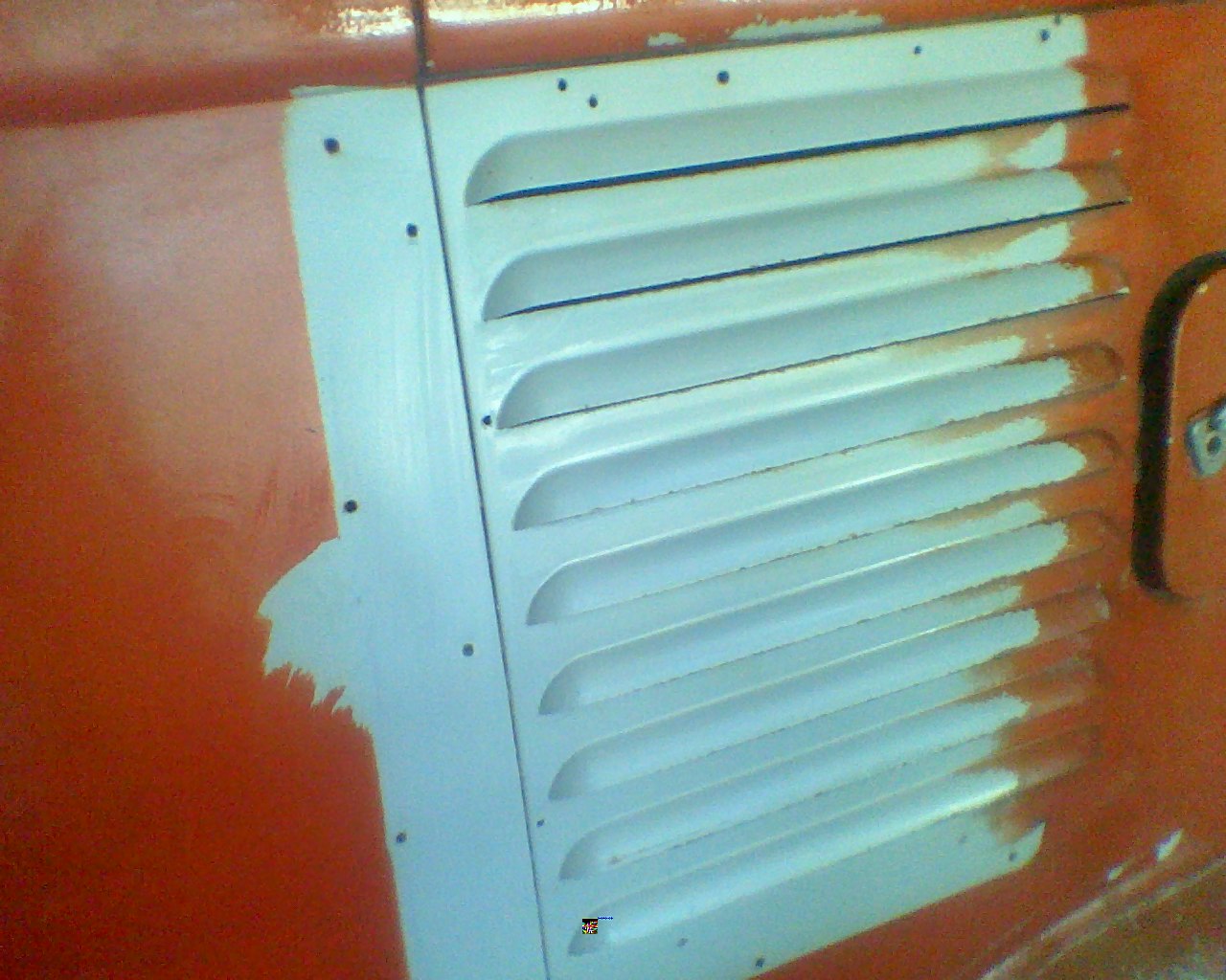

PostPosted: Mon Feb 20, 2012 4:20 pm    Post subject: Reply with quote
You guys have inspired me. I was going to repaint, but now I think I'll go three layers back to OG L90D pastel white Smile
So it begins...
Edit: Due to some damage in the lower half, I'll be repainting that (wanted two tone, anyway), but the top half is in perfect condition, and I planned on respraying it the original color.
Currently using Goof Off Graffiti Remover from Home Depot. Product here:
http://www.homedepot.com/webapp/wcs/stores/servlet...=202676194
I also bought a spray can of Citristrip to compare the two... Graffiti Remover does just as well, activates quicker. The Citristrip doesn't smell too bad, though.
I have some #2 and some #000 steel wool I've been using, but I think I need something in between.
The Goof Off only gets off one layer at a time, so it works perfectly.

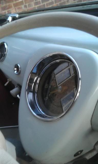

PostPosted: Sat Mar 10, 2012 12:04 pm    Post subject: Reply with quote
cracked on with the dash this week,by far the best paint so far
