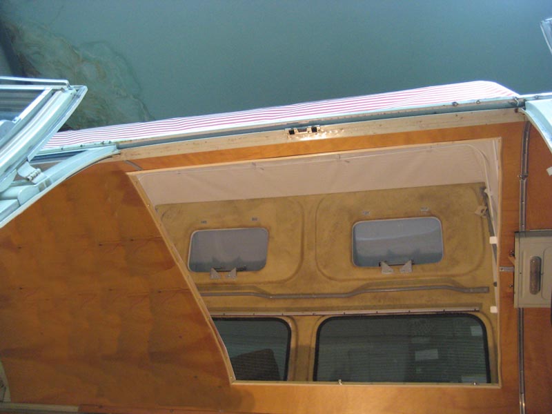

tev wrote:
Don't want to rehash anything, but with a smaller opening, I'm still wondering how you'll be able to pull the rear down or latch it in the up position - it takes two of us to do it quickly with a full opening. Another thing is that a bigass opening is the primary benefit of that top -- it's just huge. Tons of space and you don't have the roof just above you when you're sleeping. Too bad about the belly pan issue. Good luck!
Hi, Tev, I assume you are responding to my query.
In my mind the hole won't be that small, surely I'll be able to reach over to release the catch, even if I have to put a foot up on the edge of the R&R bed.
By the power of (a very rough) photoshop (lifted from xavi's recent image, ta) heres how it would look. Still plenty of light and space IMHO. Anyway each to his own, I would really rather not cut the structure and this gives me more space and light than I could ever need.
Thanks for your input.
Regards
Richard

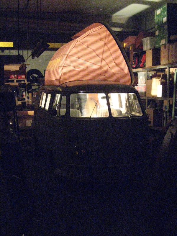

PostPosted: Fri Apr 30, 2010 7:16 am    Post subject: Reply with quote
Pics look great. Dormy tops at night are really cool.
You're right - it still a lot of space up there. While you're camping, you could use that as a shelf.
Regards
Richard
cut the whole hole for the dormy metal frame.
you still need to attach the rear leather strap (unless you change the closing method to another one thaan the strap)

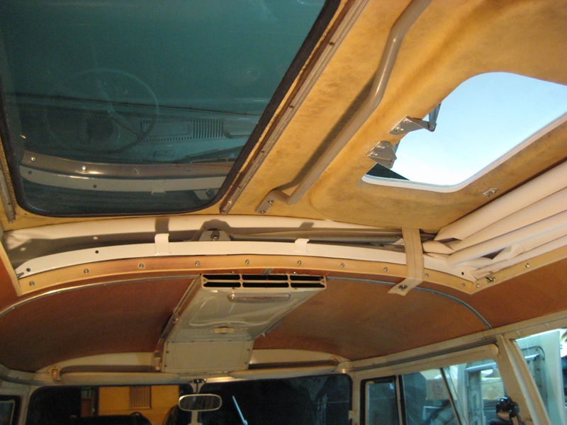

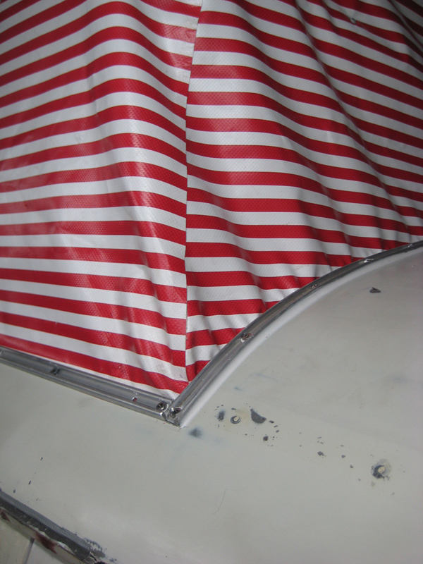

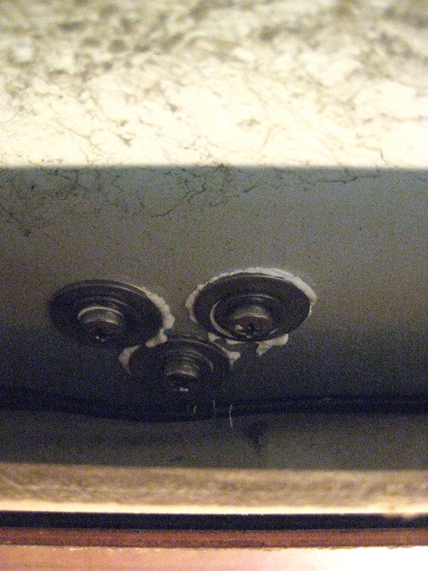

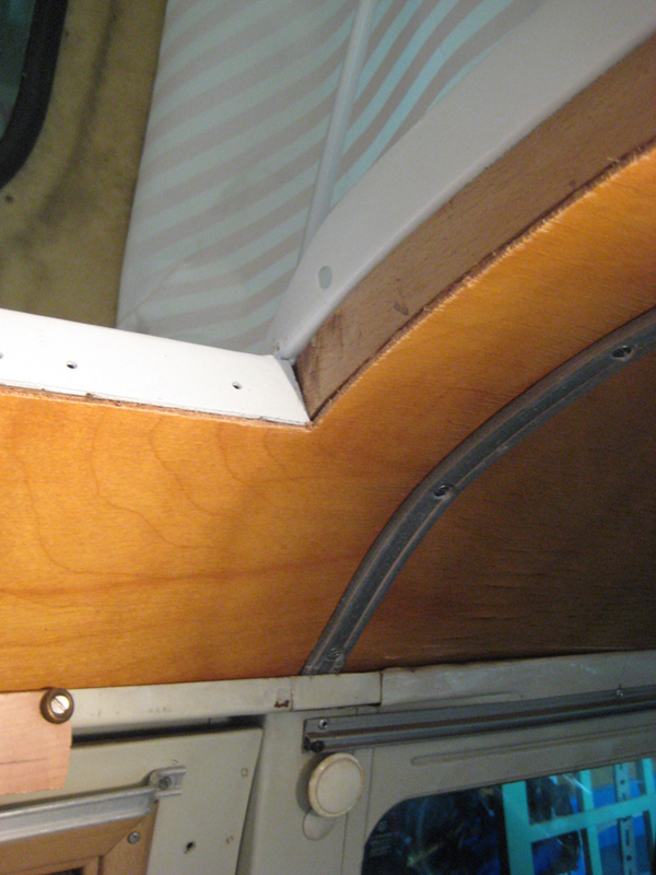

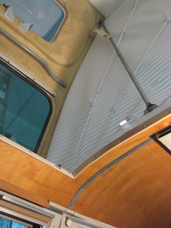

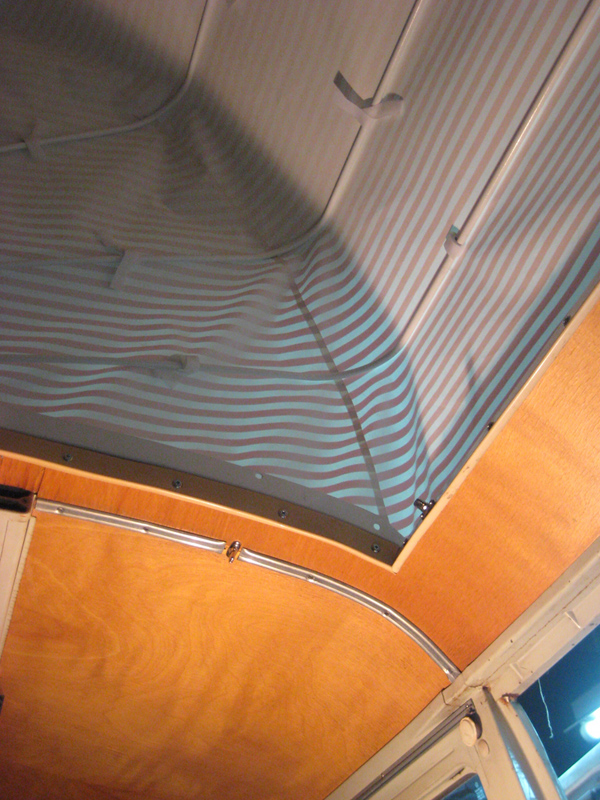

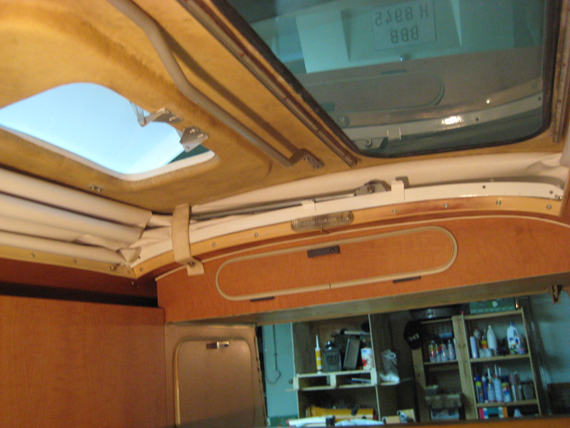

as promised... some process pics I missed to post...
corners...
hinge and aluminium trim bolts with polyurethane sealer
wood headliner triming...
plastic trim corners...
front turnlock installation...
cabinets cleaned and fitted again... that looks a westy again Wink
closed...

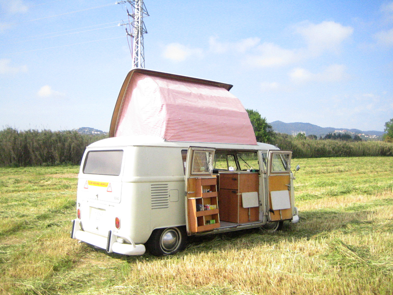

some exterior shoots I took after work...
After all that hard work I have to say that I look at the bus and think that it really worth the time and money I spent on restoring the top. I didn't counted it but I spent many many many hours since I got the top in feb '09... more than a year to see it completed.

PostPosted: Sat May 01, 2010 12:45 pm    Post subject: Reply with quote

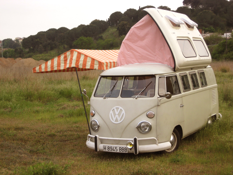

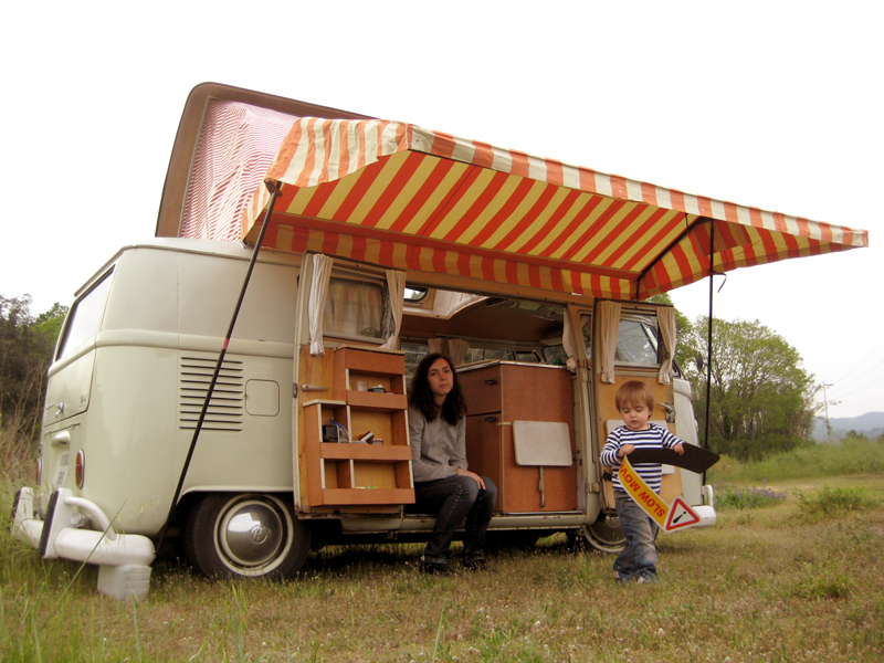

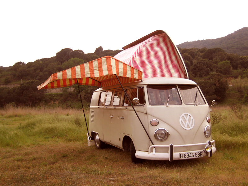

took the Dormy and set the westy tent I also got from BBT for the first time... looks good!
1967 Split SO-42 Dormobile

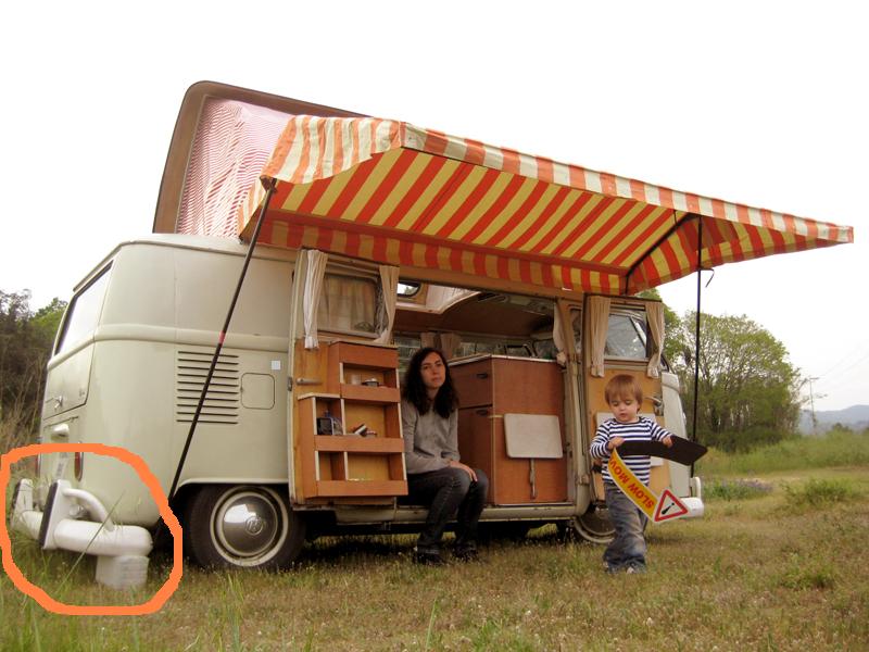

Man! That looks great! But what is the deal with this:
Clara wrote:
...but mainly perfecting my tossing peanuts shells out the window into the air scoops technique.
my guess is that since he does not have splash pans on his bumper, which help reinforce the ends of the bumpers, the additional weight of the tent/poles makes the bumper and tent sag if the bumper is not supported in such a way as pictured.

PostPosted: Sat May 01, 2010 11:50 pm    Post subject: Reply with quote
you're right Jon... splash pans are in the garage ready to install... didn't had enough time.
I always carry my Enders Baby in my spice rack. You'll see it if you look carefully in the pic Wink

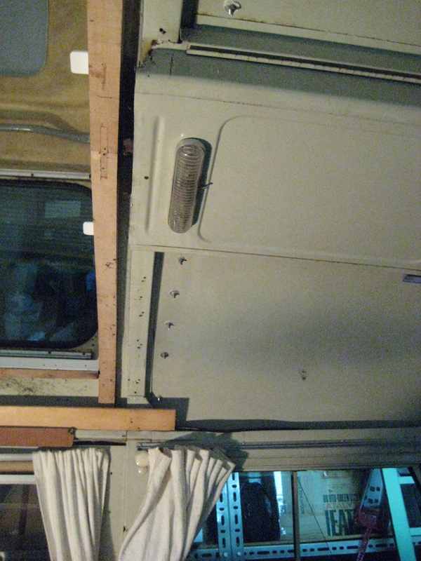

PostPosted: Fri May 07, 2010 3:38 am    Post subject: Reply with quote

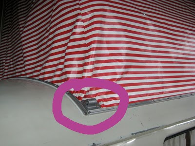

Brilliant work and brilliant thread. It's been a great help. I'm putting a dormobile roof on at the moment. Can you tell me what this is though? I dont seem to have it on mine ...
BRANDEN HOY
Joined: May 07, 2004
Posts: 138
Location: ARIZONA
BRANDEN HOY is offline
PostPosted: Fri May 07, 2010 9:43 am    Post subject: Reply with quote
Tent mount for the Westy side tent.
