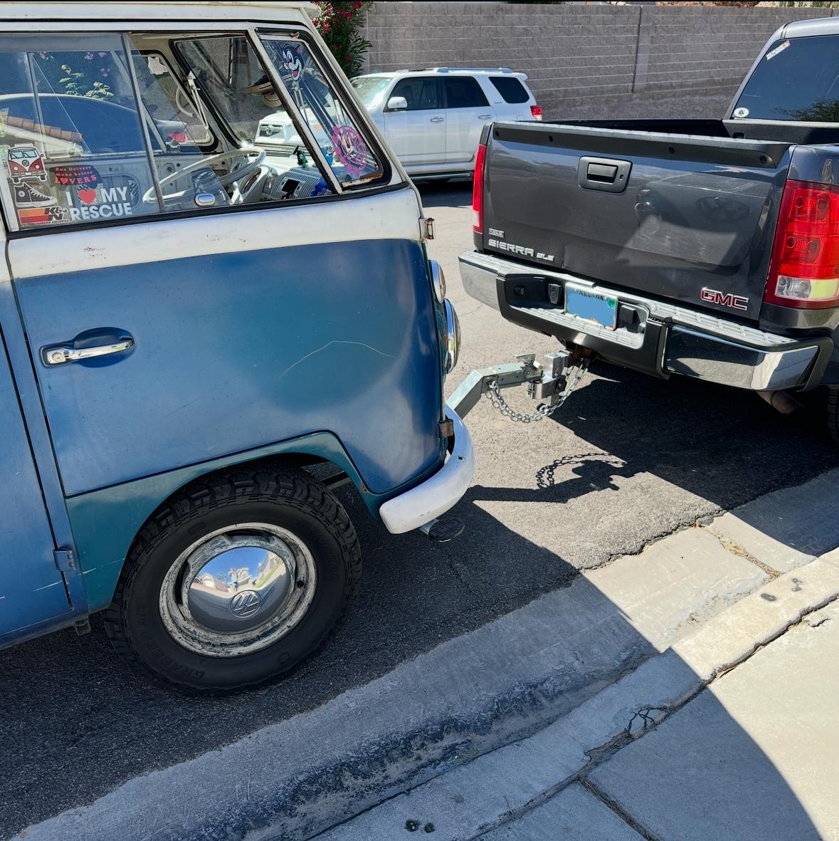

Been a while since I used a towbar for a long distance trip, and I read this whole thread to help prep.
Vegas to Huntington last weekend ~230 miles each way. Used bungee cords on the steering wheel. Not sure if they made a difference. I stayed mostly between 60-65mph. It worked well.

Thank God finally I see safety chains being used on tow bar.

My towbar has safety chains. Not sure I have a picture of it here, but I've had it and used it successfully for almost 25 years now. Towed a 71 bus about 10 miles last fall with zero problems behind my 91 Chevy K1500.

Absolutely. It was setup for them when I got it (also nearly 25 years ago) but I’ve upgraded them in the years since. Can’t imagine not using them.

those pull handles aren't super strong, glad they survived. I see them broken a lot, you are bold to put the bungees on them

we always use safety chains with the towbar.
Yeah, I’ve never done the bungees in the past, and not sure if they made a difference, or were needed at all (all the steering components are new). I did some test runs around town prior, with and without, and couldn’t tell a difference.
Where do your safety chains attach at the tow vehicle? I like that they go around the beam.
