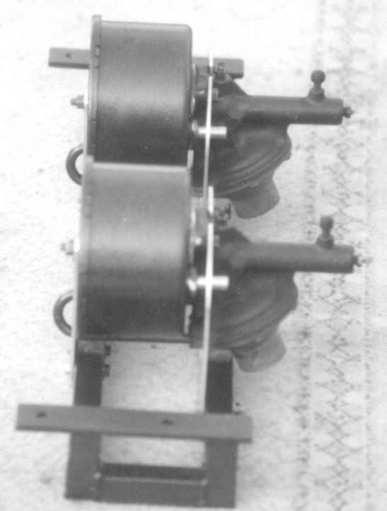

PostPosted: Tue Jan 03, 2023 8:48 am    Post subject: Retro-fitting vacuum brake-servo assistance Reply with quote
aeromech wrote:
The 1971 bus manifold should look like this
The inlet manifold of my 1973 VW 1600 Type 2, AD-Series engine, lacked a half-inch vacuum connection spigot for a vacuum brake-servo unit. I had one welded on to the left-hand side of the inlet-manifold down-pipe, parallel to the inlet-manifold's horizontal pipes.
If I had known of the late-model VW Type 1 Beetle inlet manifold, with inlet-manifold, twin heater pipes from the exhaust system, to improve cold-weather performance and decrease the likelihood of inlet-manifold and carburettor icing (especially with the Minnow Fish carburettor), I might have elected to modify and use one of these instead!
VW Type 2, direct-acting, vacuum brake-servo units & associated hydraulic master cylinders, were not readily available in the late 1980s, here in Great Britain and I wasn't confident about being able to mount such a servo to the front suspension beam, at the appropriate angle.
Consequently, I retained all of the original factory-fitted hydraulic components and supplemented them with two ATE - Alfred Teves remote-acting, vacuum brake-servo units, of the same type that were factory-fitted to some right-hand drive BMW cars.
These were mounted in a home-made, square-section, tubular-steel cradle, suspended beneath the longitudinal chassis rails, rearward of the front jacking points, using existing holes in the chassis rails, to avoid introducing any additional stress concentrations (stress risers in USA parlance!?!).
Whilst I was making these modifications, including replacement of all the original factory-fitted, steel braking tubing with kinifer-10 brake tubing, I also replaced the factory-fitted two-terminal, hydraulic brake-light switches with three-terminal brake-light switches having the hydraulic brake-circuit failure, dashboard warning-light facility.

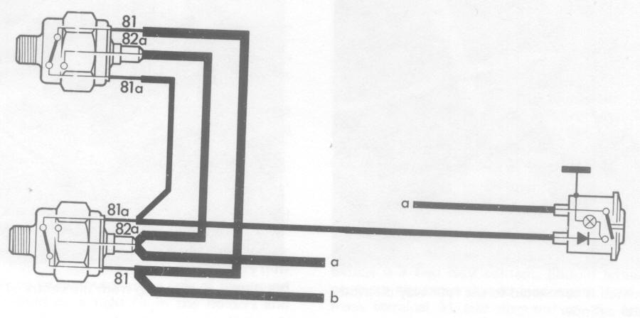

Here are the electrical circuits for the three-terminal, hydraulic brake-light switches, with early & late type, hydraulic brake-circuit failure, dashboard warning lights.
Early Type
a = black-cable connection to ignition-controlled supply terminal 15.
b = black/red-cable connection to rear brake lights
Late Type
A = electric switch inside brake-circuit-failure warning-light unit
B = 3-terminal brake-light switch
C = Dual-circuit brake warning lamp
a = blue cable to brake-circuit-failure warning-light unit's
internal switch-terminal 61 (shared with ignition warning light)
b = black cable to fuse-box terminal 15
c = brown cable to Earth (i.e. Ground in USA parlance)
d = black/red cable to brake lights

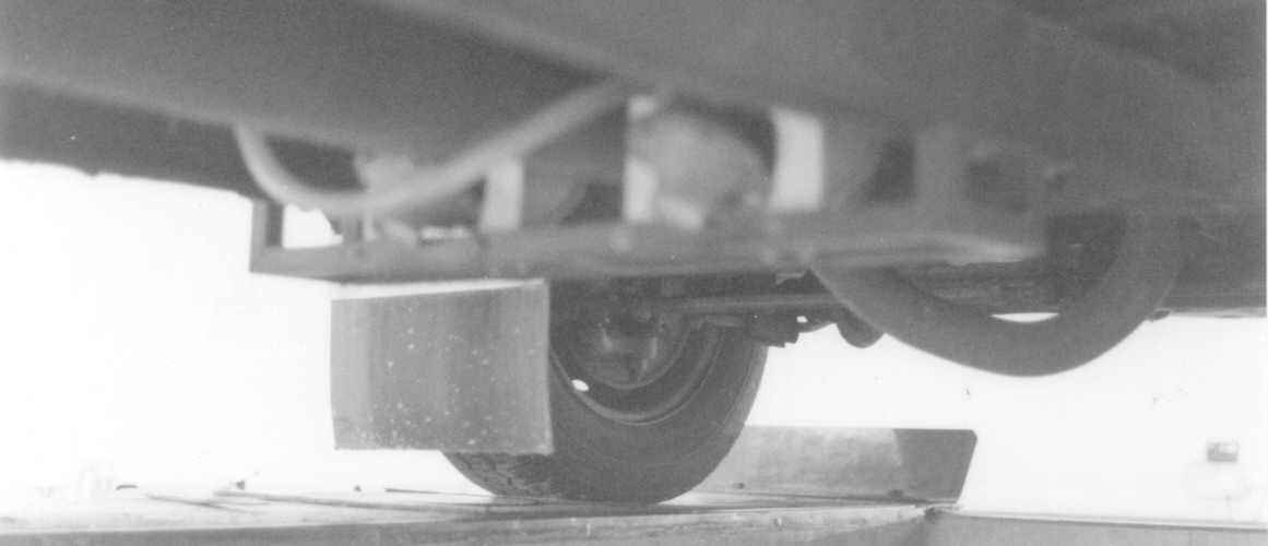

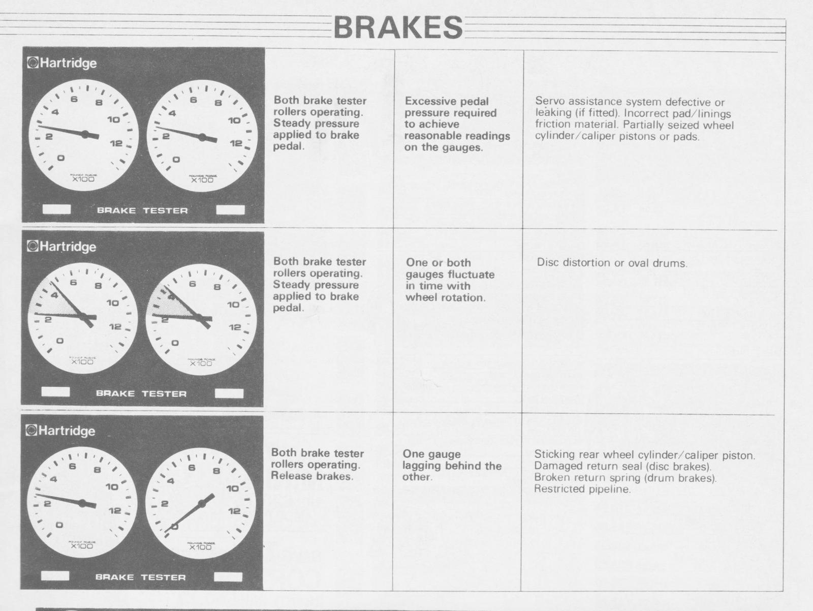

Afterwards, I had the brakes tested on a rolling-road, brake dynomometer, which is a standard, obligatory part of the annual MOT roadworthiness inspection.

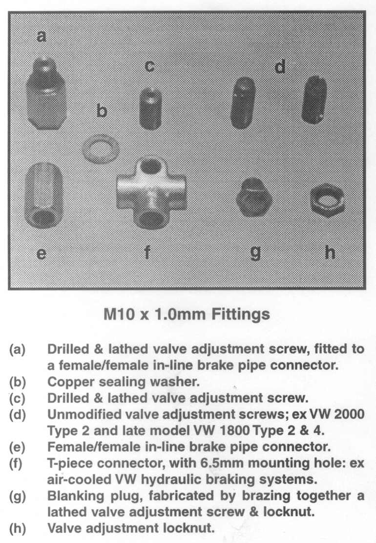

Nice conversion except compression fittings on brake lines are a no-no. You're looking at pressure of 500 psi and higher. I wouldn't trust any compression fittings and now most are made in China.
NASkeet
Joined: April 29, 2006
Posts: 3167
NASkeet is offline
PostPosted: Wed Jan 04, 2023 8:35 am    Post subject: Re: How to: Install power brakes into 1968-1970 Bus (Pic heavy) Reply with quote
To what compression fittings do you refer!?! Confused
I certainly did NOT use compression fittings for the hydraulic system, but I did use proper in-line hydraulic brake fittings, which required a taper to be formed at the end of the 3/16 inch Kunifer-10 brake tubing, using a special tool.
I undertook my conversion 34 years ago, during the winter of 1988/89, before the dawn of Internet shopping. It's doubtful whether any of the parts I used, would have been made in China!
To the best of my recall, there are twenty-three M10 x 1•0 mm brake unions in the rigid-pipe & flexible-hose system.

PostPosted: Wed Jan 04, 2023 8:49 am    Post subject: Re: How to: Install power brakes into 1968-1970 Bus (Pic heavy) Reply with quote
NASkeet wrote:
Sorry if I'm mistaken, but in your 8th photo down it looks to me like the 2 unions shown are compression fittings.

PostPosted: Sat Jan 07, 2023 12:20 pm    Post subject: Re: How to: Install power brakes into 1968-1970 Bus (Pic heavy) Reply with quote
Bonesberg55 wrote:
NASkeet wrote:
If you were referring to the in-line pipe connectors, in the lower of the two following line-drawings, they were special female-female hydraulic connectors, which connected at either end with male unions & flared 3/16 inch Kunifer-10 brake tubing. I bought them from my local specialised clutch & brake centre.
In-line, 25 mm long, M10 x 1·0 mm, female-female, in-line, metric, brake-pipe connectors of this type (labelled B in the following cross-sectional illustration), were also used in the creation of my home-made, oil-pressure, gauge-sender, installation adapter, which I have fabricated for use, on the VW Type 4 engine.
