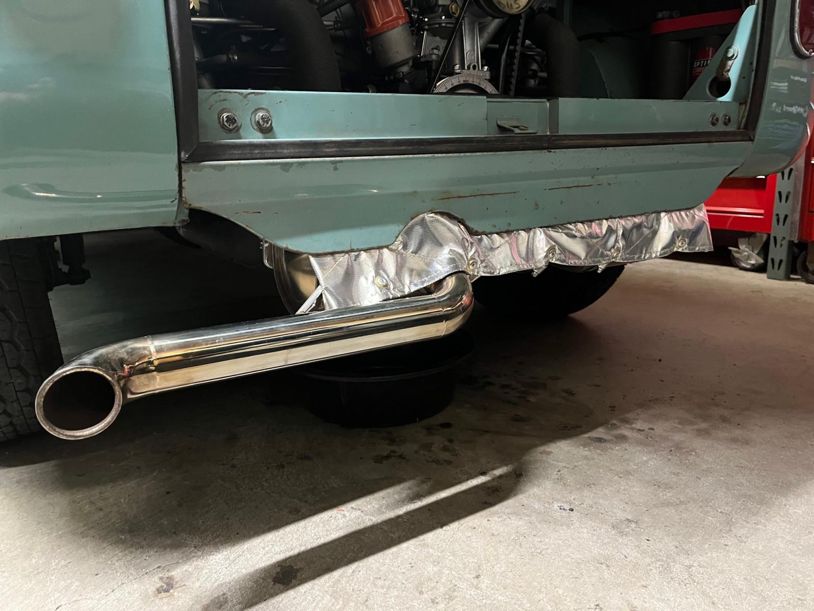

PostPosted: Thu Feb 22, 2024 7:08 pm    Post subject: Re: Vintage Speed Exhaust Recent? Reply with quote
Pictures of the Thermo-Tec Heat shield on my Vintage Speed exhaust. It installs with stainless steel clamps inserted on the inside of the shield so most of it is hidden.
Comments or opinions let me know as this is a first for me and I'm sure others as well. And yes, the 009 is a temp distributor....LOL.

PostPosted: Mon Apr 15, 2024 9:50 pm    Post subject: Re: Vintage Speed Exhaust Recent? Reply with quote
Finally, back at things after vacations and being overworked! I spent a nice hour-long drive in and out of evening traffic tonight which covered about 22 miles. By the time I got home and parked my bus I felt the rear apron and it was nice and warm and good enough to keep my hand on the apron for a few seconds. Not burning hot like melting skin on the exhaust type heat but a comfortable heat to make sure the paint won't blister and peel off. So, end result is I'm super happy with the heat shield I installed and didn't have the bend the apron at all. Definitely recommend it to anyone else!
