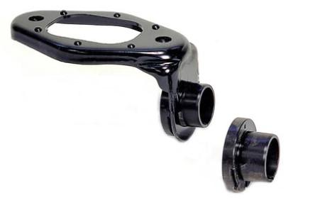

The Youtube review was not very positive. Any reviewers here?
