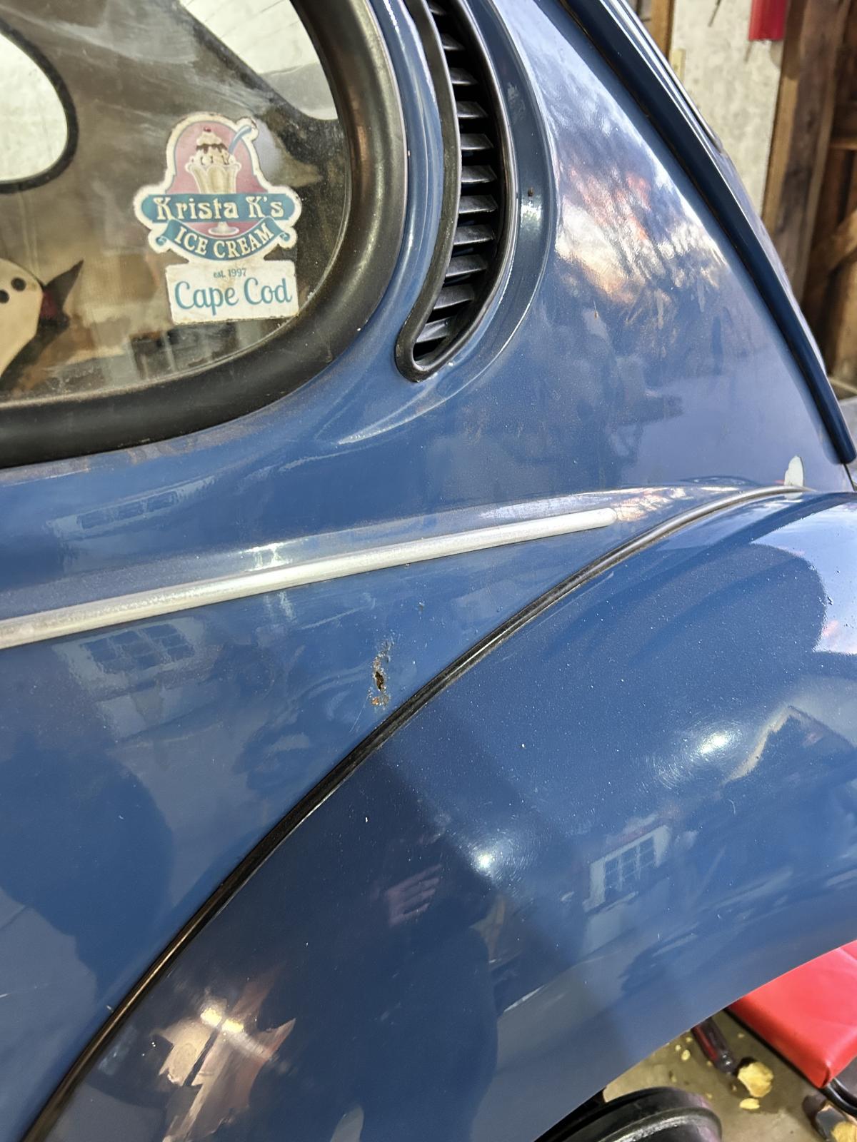

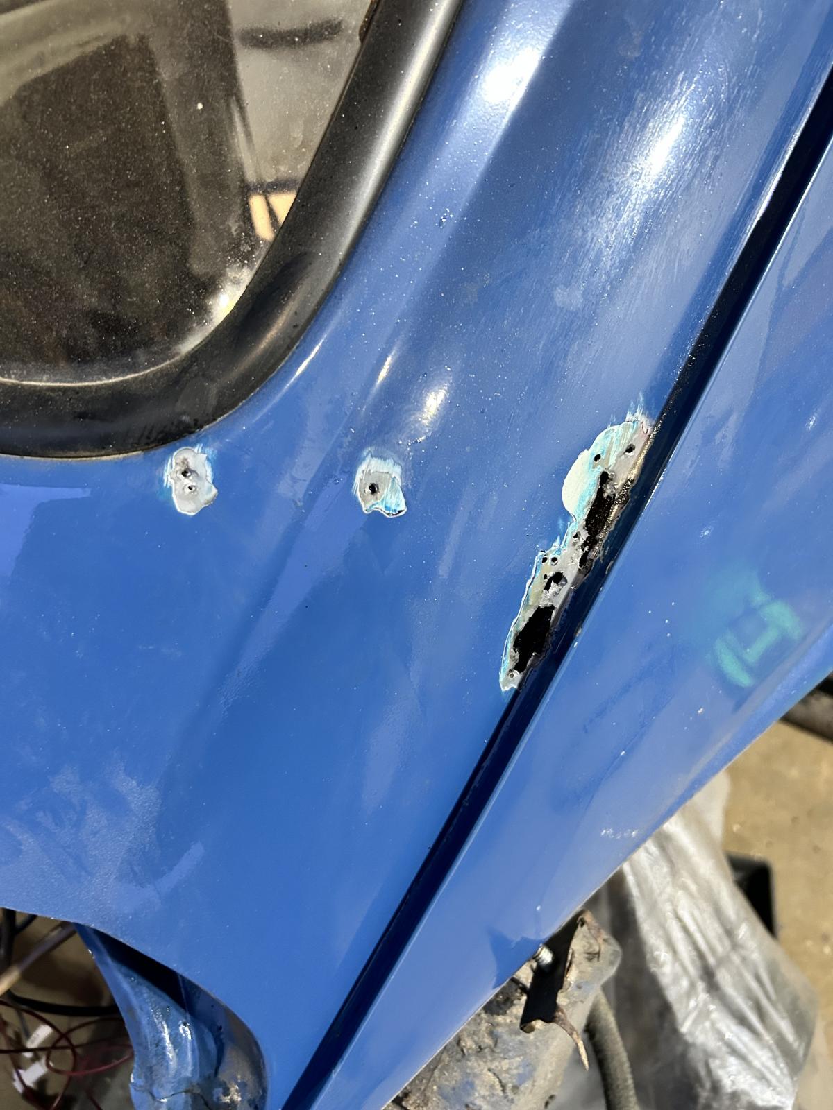

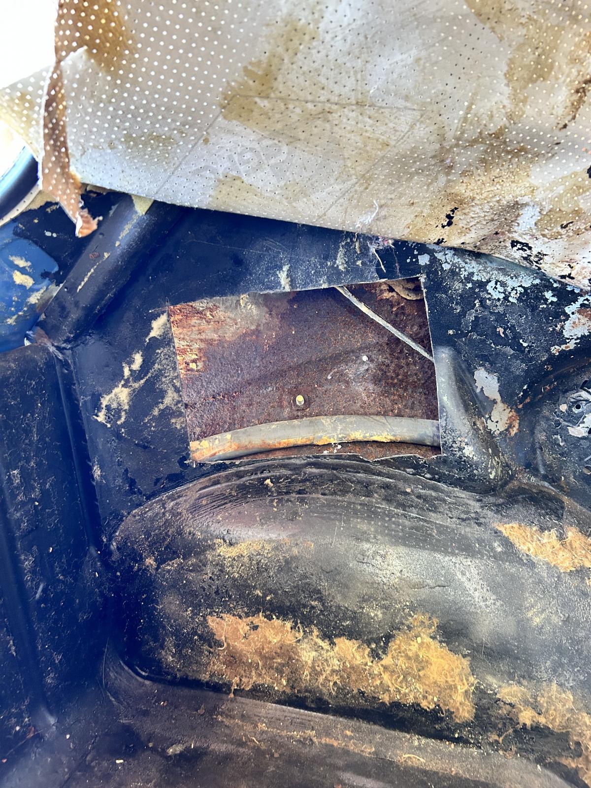

While I wait for some engine parts, I'm picking away at some other areas on the car. One of the most concerning areas to me is the death foam. I already have rot bubbling through in the area on both sides of the car. I was poking at some of the bubbles and sure enough, my pick went straight through in a couple of areas.
Fast forward an hour and I'm knee deep in foam chunks. The body is actually rotted straight through in a few areas inside the car, as you can see from the below photos.
My question is, has anybody successfully attacked this from INSIDE the car? The rust that has come through to the exterior seems minor enough that if I could get at the backside of it, I could remediate what metal is already there. Some threads show folks cutting away large swaths of body metal to root out the rust. I don't believe this is necessary in my case, which is a good thing, because I don't have the skills to do a massive body repair like that. The holes in the outer body shown in the photos are the AFTER of poking, prodding, hammering, and generally removing all loose, crappy metal. There's more rust on the interior panels than on the exterior, which is great, because I don't care how the spot looks on the interior for now.
I do need to figure out a way to seal these exterior holes up temporarily so I can confidently drive the car to break the new engine in and not be constantly worried about getting caught in the rain. Any suggestions there? Duct tape? Wink

Dang, that death foam can really do some damage. Nice job cleaning it all out.
Never tackled the repair myself. Seen a few threads where either the inside or outside skins were cut out to access the other side.
Maybe less invasive to go from inside to access and repair the outer skin first?

Cleaning it out is a pain in the ASS. Definitely top 5 most awkward and imprecise jobs I’ve ever had to do on a car (or a boat). I ended up using some 22 gauge 1/2” x 1/2” angle iron I had laying around. The end of that was sharp enough to pierce into the foam, then with a twist, it would snap off a chunk. Rinse, repeat. I could then bend the angle as I went along to reach farther and farther around the bend. I also found a very useful tool is one of those long reach flexible “grabbers,” the type with a push button end on it and four tiny arms that flex open to retrieve small parts dropped into an abyss. Allowed me to retrieve the chunks with minimal swearing.
Im much more hesitant to tackle the driver side, even though the rust through seems to be worse on that side. The main harness runs through that area and I do not want to create intermittent ground-outs by chafing through the harness…
I think I’m going to use an oscillating tool to cut an access patch from the inside and see what I’m working with. The foam is allegedly very flammable so no cutting wheel for me.

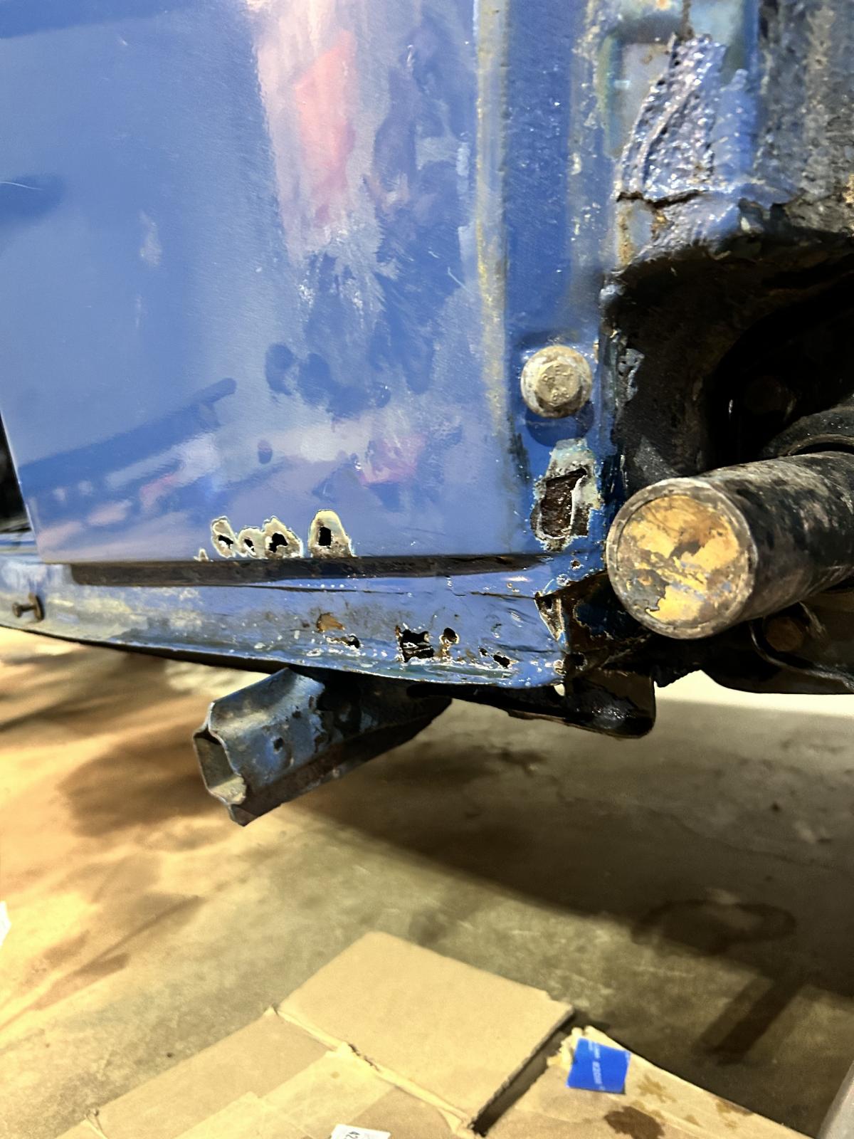

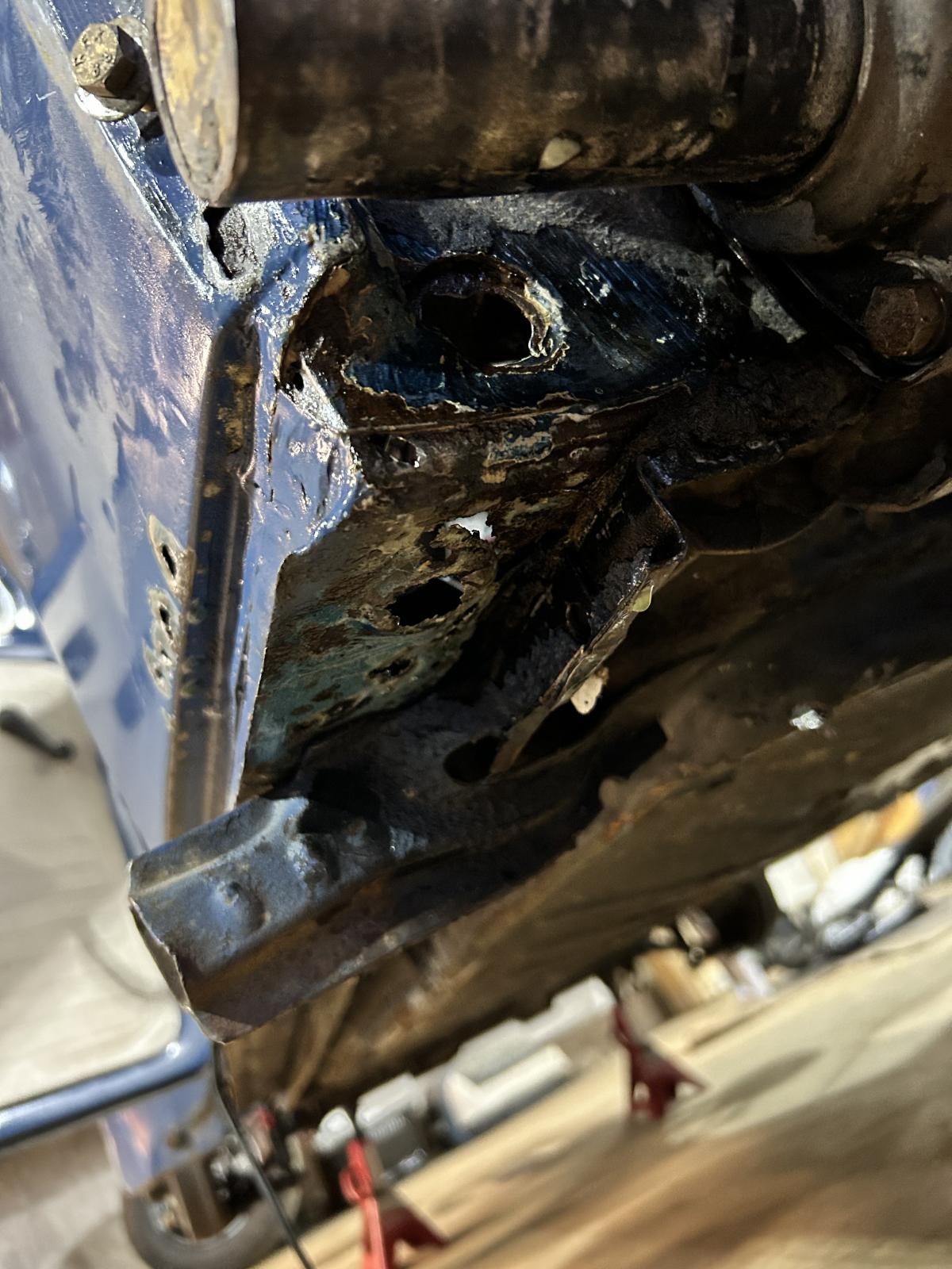

Still waiting on engine parts, but in the meantime I replaced front shocks and tie rod ends, then wheeled the car outside to do an alignment per the Muir book. The bug sure is easy to push around with no engine in the back!
Back inside, I cut open the driver side where the death foam lives, with a fire extinguisher handy. A cut off wheel on an angle grinder makes quick work of it, just make sure you tape the headliner up out of the way. The foam backing on the headliner sure catches quick and makes some nasty smoke. Cutting access like this beforehand makes removing the foam an absolute breeze, although I did come VERY close to cutting into the main loom that sits in there.
The name of the game for me here was to preserve as much USEFUL metal as I could, and get rid of whats totally become rust, as well as the metal that was so thin it just lacked all strength. Using a straight pick from HF, I went around and poked all around the suspect areas. The car had been painted, poorly, and preceding this, whoever painted it had gone around and shot JB weld into all the rust holes in the area, so while some areas had bubbled through, others looked completely fine from the exterior, but one push from the pick, and they caved.
I did about four rounds of this, on either side, alternating between the pick and a body hammer’s sharp end, to locate all the areas where the metal was gone. Once I was satisfied I’d found them all, I went around inside with a wire wheel on the die grinder. This got pretty awkward, and I couldn’t reach EVERY spot, but I could reach most of them. I suppose I could have cut my access holes slightly larger.
Then I blew everything out with the air gun, and applied phosphoric acid from a spray bottle. I used Kleen Strip Metal and Concrete Prep. Throughout the day I applied about four coats of the stuff, even though they say you only need one. I may apply more tomorrow, we’ll see. You can definitely still see areas where there is active rust on the metal (note none of these photos show the “after” of applying the stuff - yet!).
I ran around with the dremel and a small grinding bit and beveled each hole IN, so that nothing is proud of the exterior surface when it comes to fairing all of this in. My original intent was to weld patch panels on the inside of the body, then fill the valleys left outside with bondo, sand, and paint. However, I don’t think I’ll be able to get a good enough, close enough, fit with the metal, so I am now thinking I’ll lay some fiberglass inside, and fill the outside as previously mentioned.
Of course I then discovered there is a similar rot issue at the back end of the heater channel on the driver’s side, so I started the process all over there. This area will almost certainly need metal replaced, the rust is much more advanced. I got to this by removing the heater box wye thingy and cutting an access hole all the way at the aft end of the heater channel, VERY carefully holding the close by wiring out of the way.
I’m hoping the upper areas are ready tomorrow to be glassed, but we’ll see.

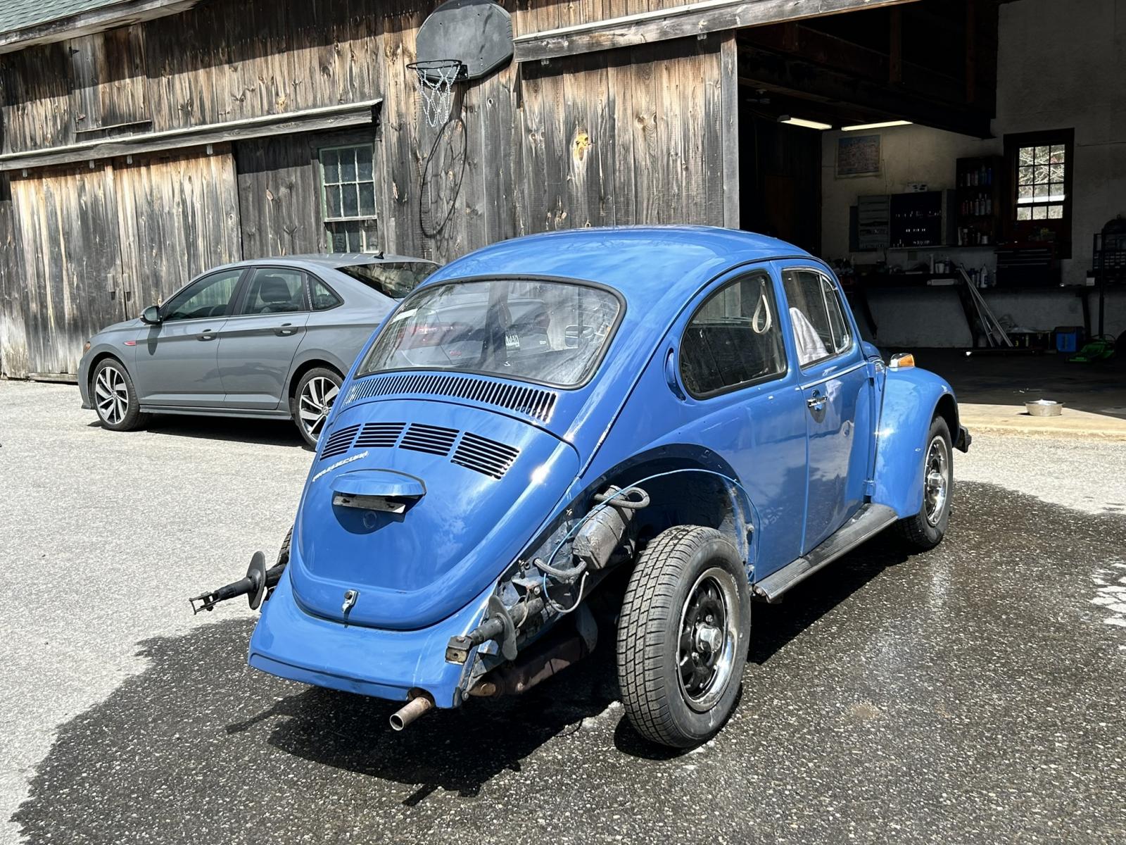

We have a runner! I got a little carried away between these two updates. The engine is assembled, back in the car, and running. I also finished up the death foam repair and paint. The paint match is PRETTY close, but not perfect, and I haven't blended it in with the existing paint because seeing the new stuff made me realize I want to respray the whole car. The new paint just looks so good!
I do, however, now have a mysterious ticking sound. It gets more apparent when the engine is hot and has idled down a bit. It's RPM-dependent. I have checked the valve lash, they are within spec. It sounds like it's coming from the driver-side of the engine, around #4 cylinder, but up top. Is it normal? I have the engine timed to 30 deg BTDC at 3600 RPM with both hoses off (and plugged). I'm wondering if maybe the timing is just a little too hot and it's pinging? That's my next avenue, but open to suggestions. See video below.

Always really liked the late Std FI Beetles. I think they are very underrated.
Nice progress and updates! Sheese, that painted section looks amazing!
Hard to tell in the video, but the valve lash sounds pretty normal. Maybe just get some miles on and check lash again? Lots of new parts settling into each other.

I popped the driver’s valve cover off and checked the lash, even though the engine was a little warm. I know that’s a big no-no, but I had to see if somebody was flopping around in there. The #4 exhaust valve had about 10-thou of lash. I did reset the lash yesterday, cold, when I did the first oil change after the initial break in, and I thought I’d set them all at 6-thou, but there’s a chance, however small, that I neglected to adjust that valve. I had them originally all at 8-thou for first start up. So I reset that #4 exhaust at 8-thou, which is what the #3 exhaust valve appeared to be, warm. I then went and checked the other side. #1 and 2 were all fine, and exhaust valves again appeared to be about 8-thou, with intakes at 6. I was a little worried about the #2 exhaust valve because after initial break in, it had gone from 8-thou to 4, which had me pretty concerned given these exhaust valves are technically used, with 12k miles on them. I’ll be watching all the exhaust valves like a hawk, but especially #2.
After adjusting the #4 exhaust valve to 8-thou, the noise is mostly gone - it’s really just more symmetrical between the sides now.
I did also re-check my timing and adjusted it slightly. In the process I believe I fried my timing light, which is the second Innova one I’ve killed in about 12 months. The first one I thought maybe I’d accidentally connected while the engine was running, which you’re not supposed to do, but this one I was super careful with. This one might be headed back to Napa for warranty!

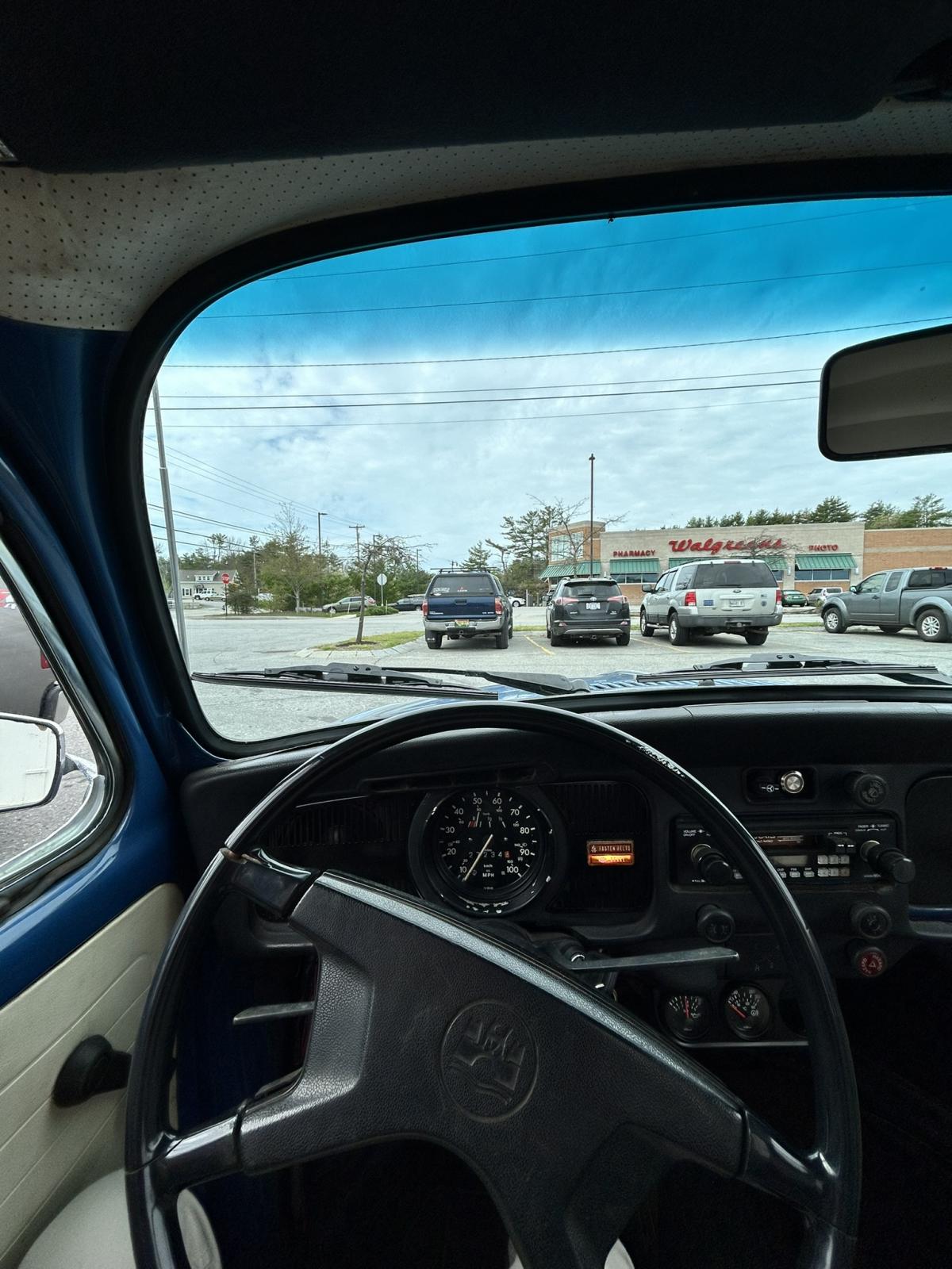

Did my ring break-in as suggested. I -thought- the 100-mile easy-driving period was excessive. That aircooled.net break-in procedure should really be taken down. This way makes much more sense.
I put another new starter in the car yesterday. I'd converted to the autostick self-supporting one, which seems to work for everybody else, but made a horrific clacking noise in the split second after the engine started and before I let go of the key. I went with a NAPA rebuilt unit, which I've had trouble with in the past, but this time works like a champ. We'll see how long it lasts.
I'm now trying to troubleshoot two different (but I think interconnected) systems which are not functioning the way I'd expect.
First, and most annoyingly, my brake warning light is on. In the course of all the work I did while the engine was out, I replaced the MC and all the soft lines, the brakes have been bled and adjusted. The pedal is firm. I'd adjusted the MC pushrod, and my first thought was that maybe I'd over-adjusted it, which wasn't allowing the pushrod to fully return, so I adjusted it back the other way, light still on. The e-brake contact switch is working as it should be. Would a faulty brake light switch cause the system to put the light on? If I recall correctly, the 3-prong brake light switches are a real pain to come by...
Second, the door buzzer does not work. If I understand correctly, the buzzer sounds when the key is in the ignition and the driver's door is open. Looking at the electrical diagram, power is supplied via terminal 85 on the J34 relay when the key enters the ignition cylinder. Then, when the driver door contact switch F2 is grounded (i.e. door open), the circuit is completed and voila, buzz! Except, not for me! I've removed and cleaned the driver door switch and confirmed I'm getting contact on both tabs when the switch grounds. Aside from that, I replaced the J34 relay with a used unit, and that one also fails to buzz.
I should mention, I've also replaced the seatbelts in the car with WW modern equivalents, thus, the two wires for the seatbelt contact switch are dangling. I've tried leaving them like that, twisting them together, it makes no difference. The seatbelt light turns on for a moment when the ignition is turned on, then goes out, no matter what I do with the wires. I obviously don't care about the seatbelt light working, but I'd like my door buzzer to work. Suggestions?
