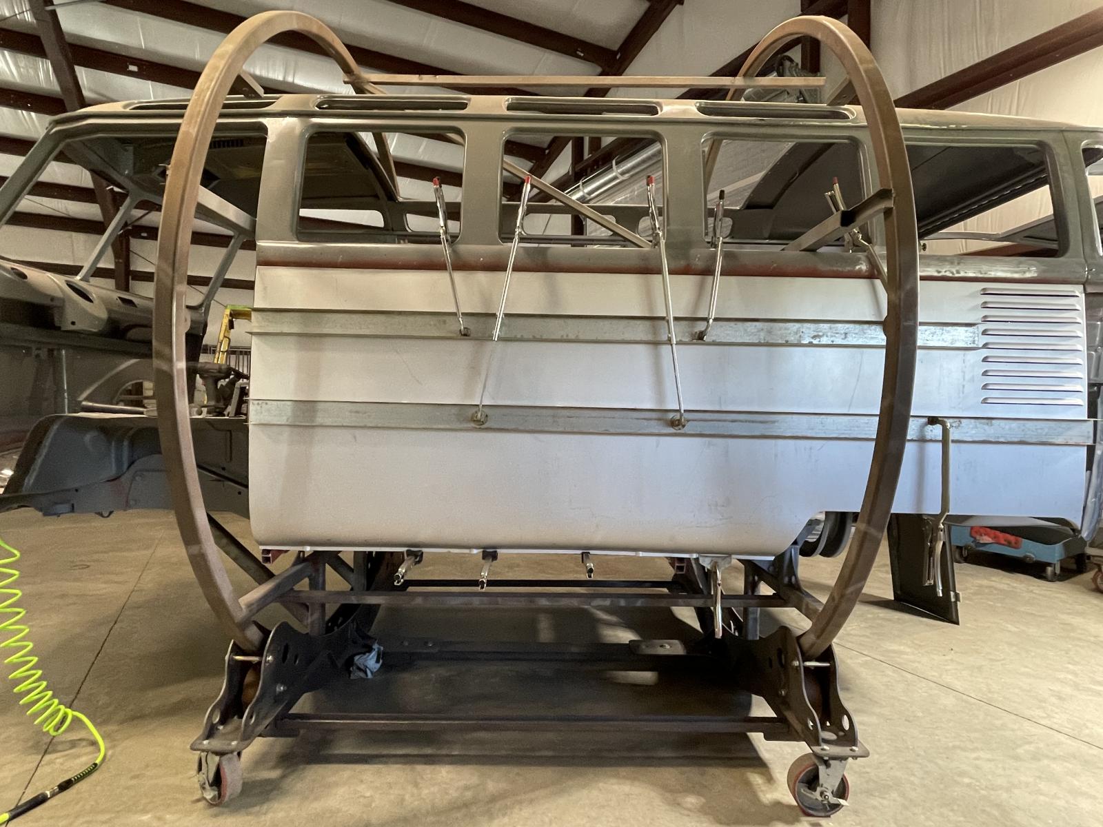

Hey folks…. So I have not been able to spot weld through both layers of “weld through “ primer on the long panel. My water cooled machine was set to coatings but struggled to get through the primer. Some would and some wouldn’t. So to speed up the process I just ended up removing the not so weld through primer on one side. Has anyone else here had issues spot welding through the SWP ?

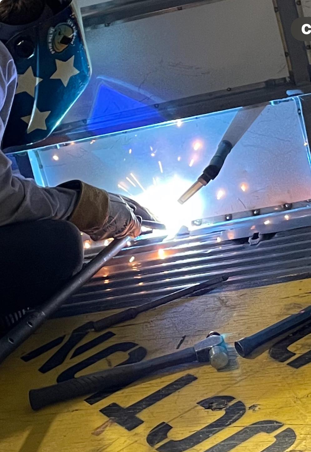

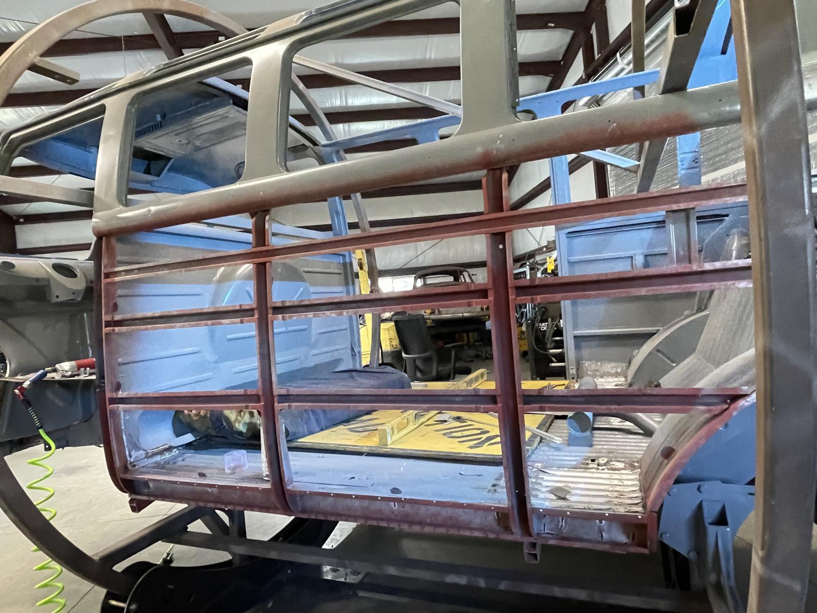

Mig plug welding at the cargo floor through the SWT was no problem.
Spot welding through the SWT even with “coatings” settings on will not be a consistent enough option for us.
When everything was said and done the long panel fit well and is very tight. I would use it again. ☑️

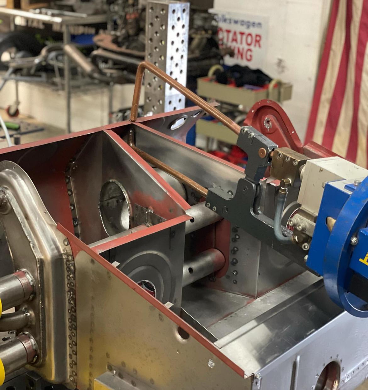

Off topic, but where did you get the long arm for the Pro-Spot. Are they available new?
Mike K
Bulli Klinik
Colorado Springs
WrennMetallWerks
Joined: December 06, 2007
Posts: 3392
Location: Rescue ca
WrennMetallWerks is offline
PostPosted: Wed May 15, 2024 6:58 am    Post subject: Re: Autocraft vs. Klassicfab vs. Wolfsburg West vs. BBT Reply with quote
⬆️⬆️⬆️ Hello there, so this arm was with the machine when I bought it used.
I have been asked often about it from folks that have the PR 10 , I wonder if it was an option to add? Brian from Washburn was asking me the same thing. I reached out to a rep and they said you just have to search one out. Brian and I looked for one for him and he eventually found one. I did not ask him where he ended finding it. Maybe reach out to him and see if he has any leads for ya. The only new arm upgrade I have been able to find for the PR 10 is the “ X Adapter “ I will have a rep out at my shop here in a bit and I will pick his brain about locating a long arm. One rep I had did say that they do hear of things popping up for the PR 10 from time to time.

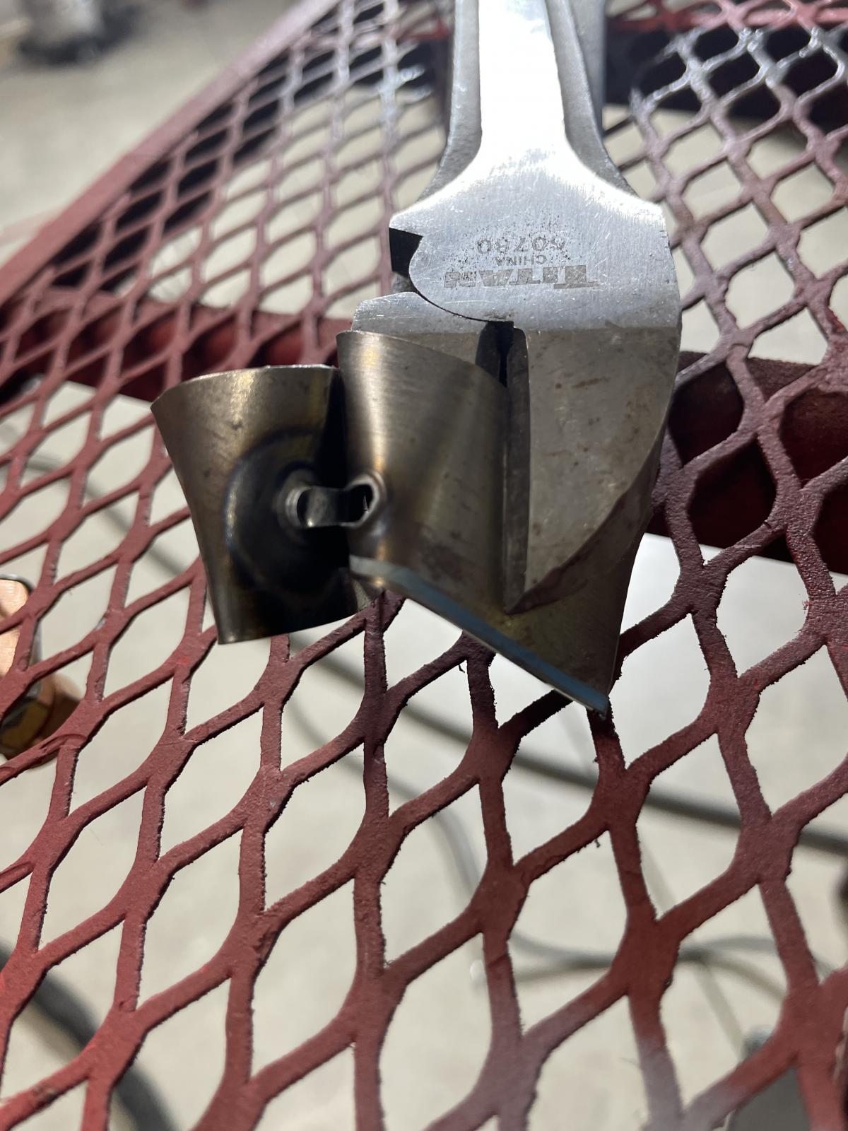

⬆️⬆️⬆️ Here is the X Adapter ⬆️⬆️⬆️
It’s very handy and available at Pro Spot.
The tongs I made from Miller aircooled stock

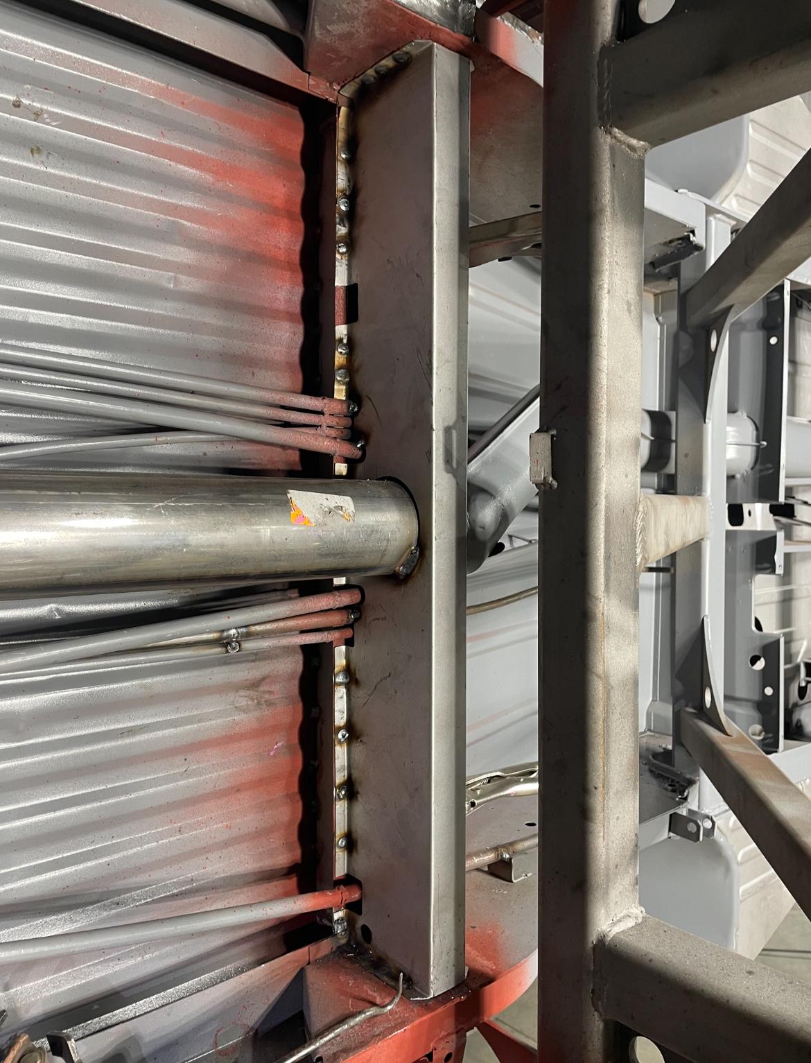

It seems appropriate to note BBT parts that went smoothly as well.
The nose skin , front floor and cross members all went on without a fuss

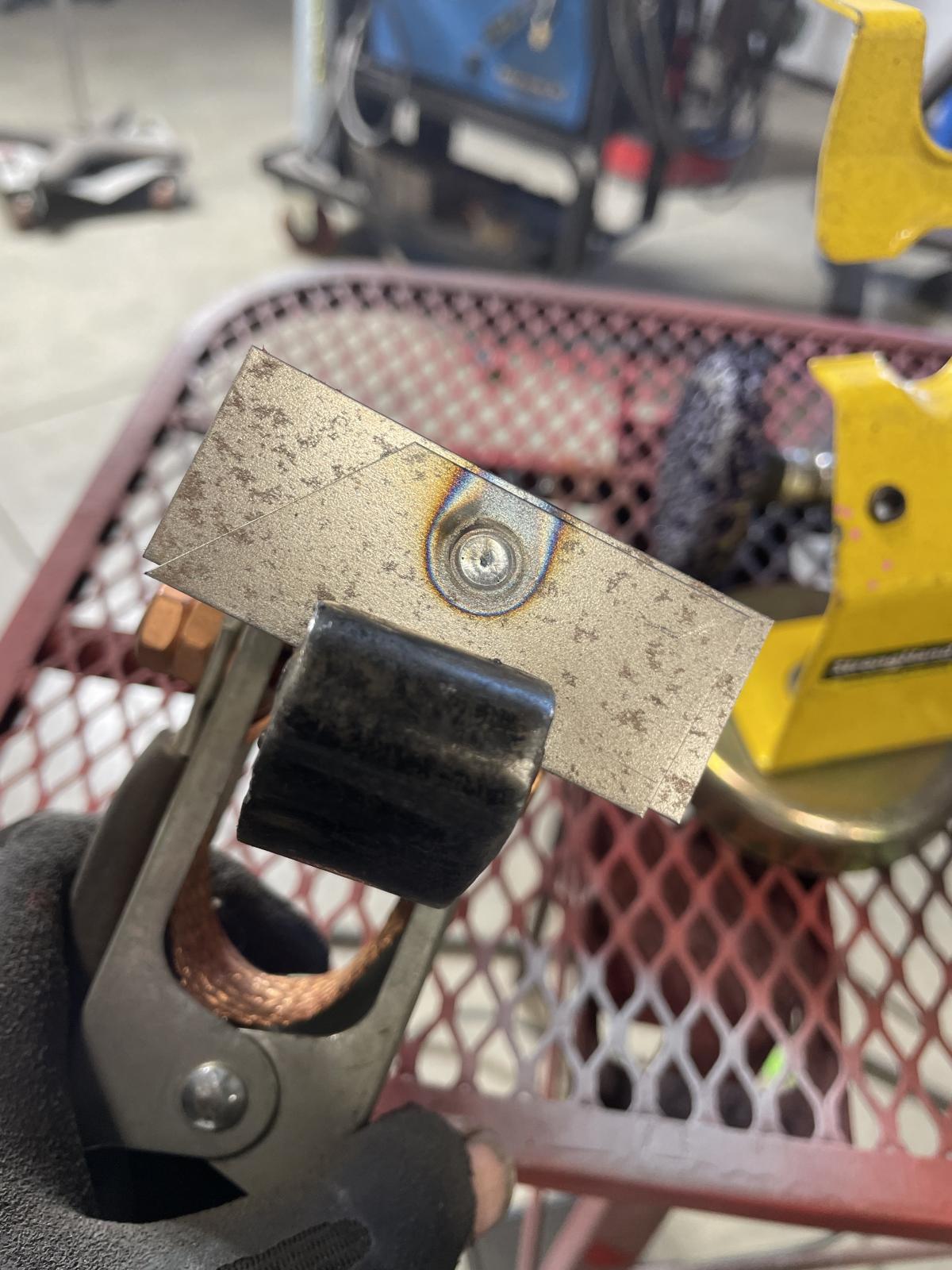

BBT headlight buckets fit very nicely, so tight a Tig fusion weld worked very well

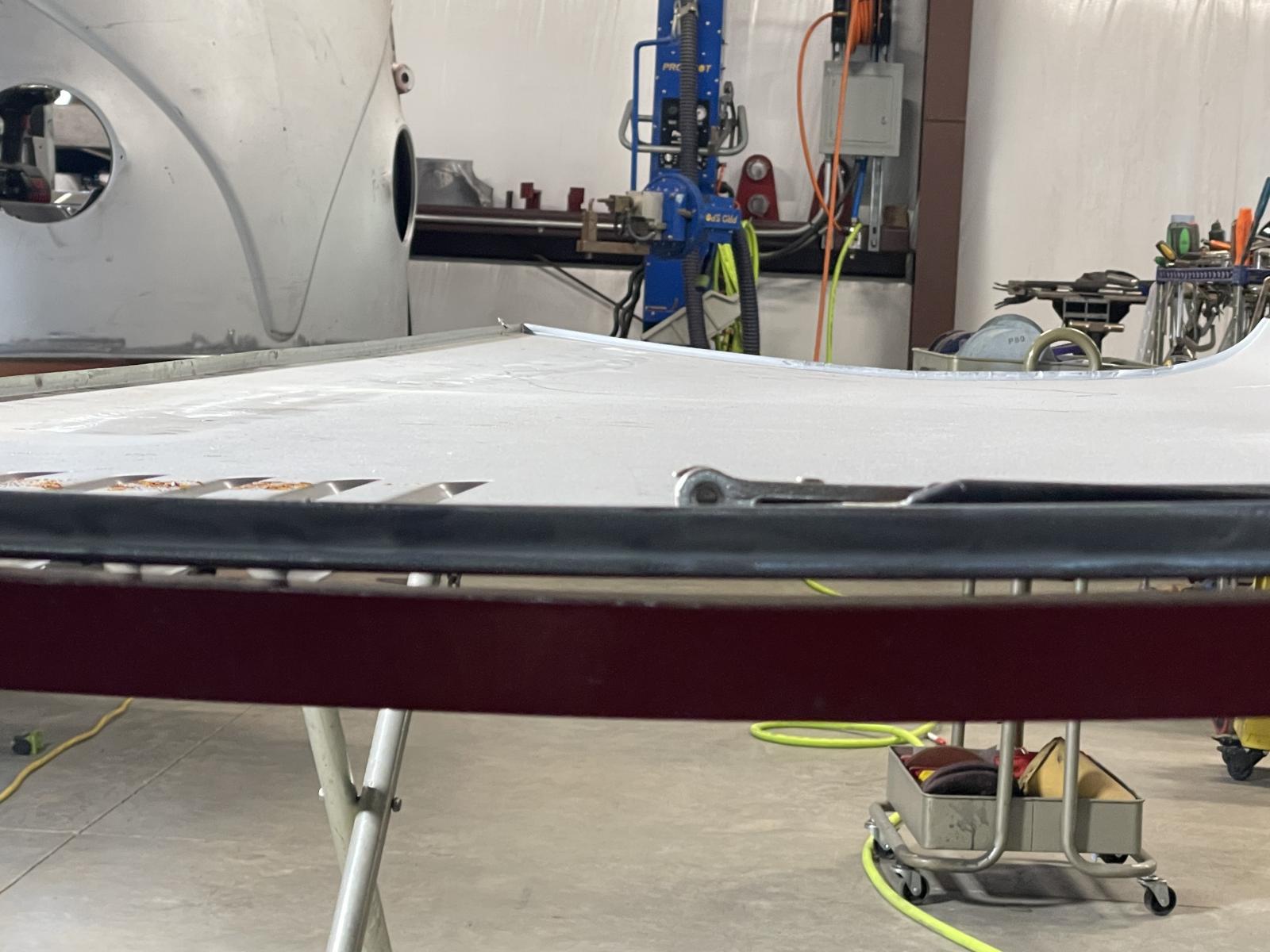

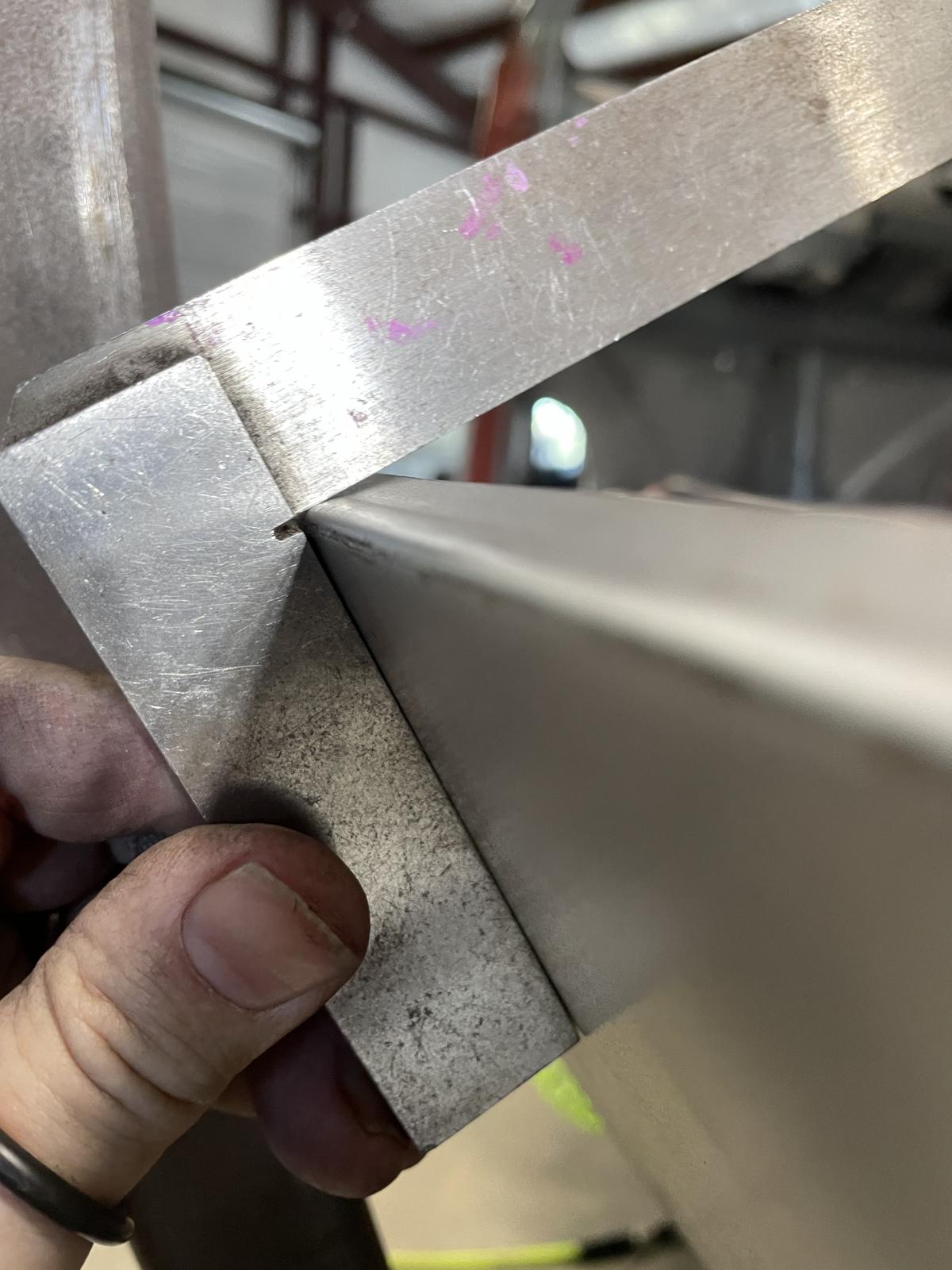

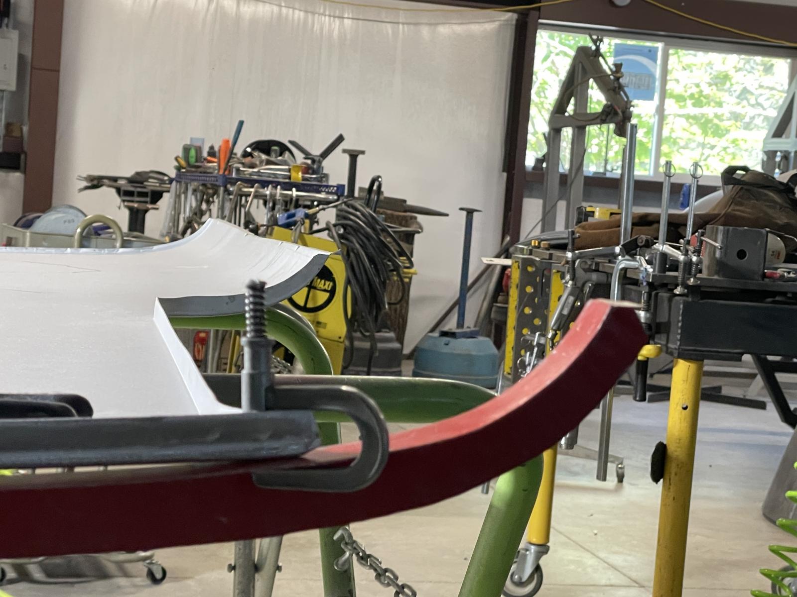

So shrinking both end flanges is all that's required to put more crown in the whole panel?

PostPosted: Tue May 21, 2024 4:04 pm    Post subject: Re: Autocraft vs. Klassicfab vs. Wolfsburg West vs. BBT Reply with quote
⬆️⬆️⬆️YeSir… once the flanges are tuned they really promote the change , out in the field it’s one large sheet that is easily manipulated once it is properly clamped to the framing and rocker. The sheet takes on the shape of the framing nicely. You can really see the effect when you clamp the lower part of the panel to the inner rocker. 😊✌️
(Thinking about it now , I probably should have said contour, arc , profile or radius really, )

can i ask what size hole you drilled for that? trough one panel or both? countersunk?
How many Amps?
