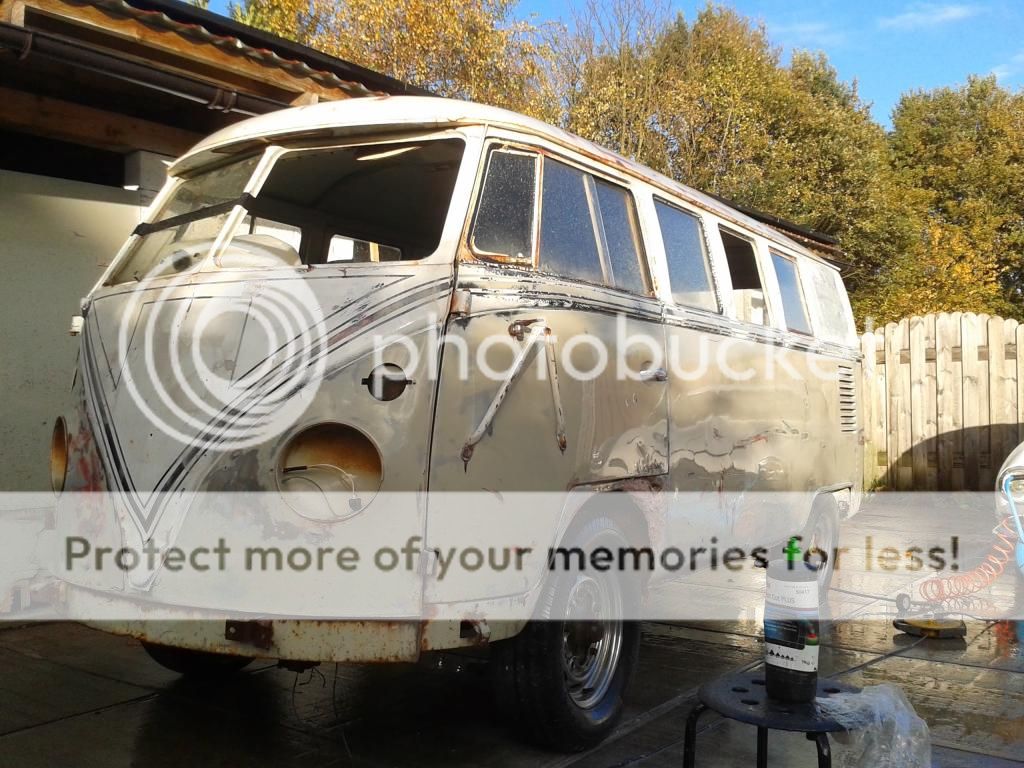

After my PGSG i said I would never do this again....
But then this bus came...
1 side is prettymuch done... atleast below the beltline...
Anuone knows the name of this colour?
Since the windowframes are the same colour I am pretty sure this was a 1 colour bus Smile

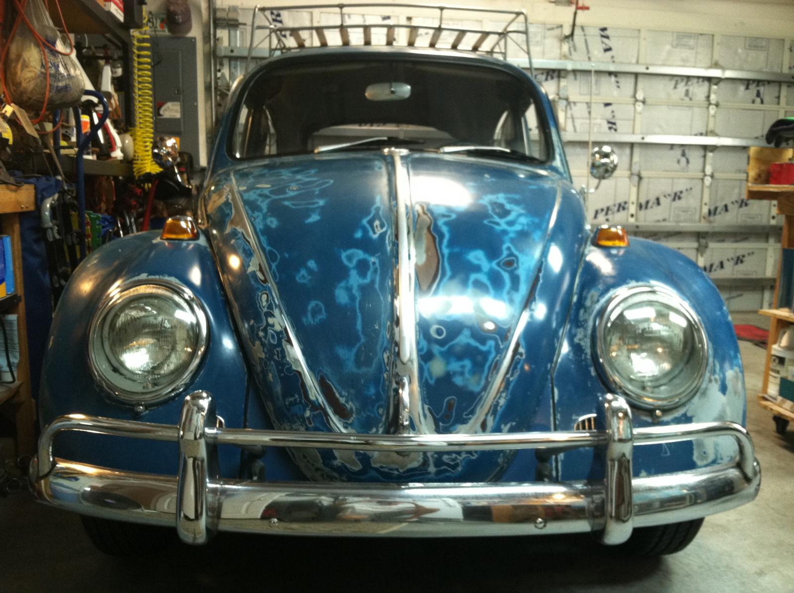

Finally got around to trying this out today after lurking for a while. About an hour of scrubbing away with the steel wool and I got some of the cheap, poorly done, white paint off from the PO.
(Mind the dirt, 'poor guy has been sitting in the garage for the past month and I haven't been bothered to push him down and give him a wash yet)

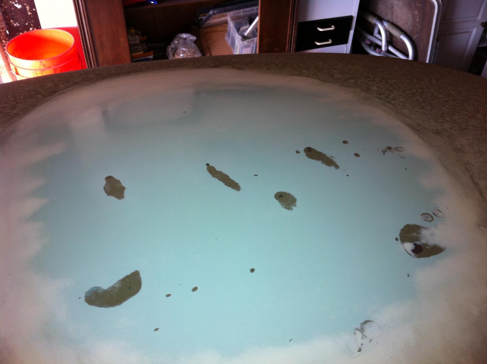

Using aircraft stripper and wet sanding
( Before )
( After )
