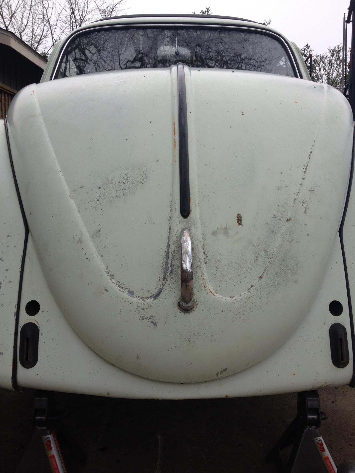

volksheime wrote:
leave that car be. Stripping paint is for crappy resprays. The paint on your car looks nice
Thanks for the quick feedback.
The respray does seem to be done pretty well. And Jade Green is apparently a hard color to pinpoint, or maybe just hard to photograph Very Happy
Posts: 71823
PostPosted: Mon Oct 13, 2014 11:30 pm    Post subject: Reply with quote
slaphappytrav wrote:
FWIW, I agree with that guy.

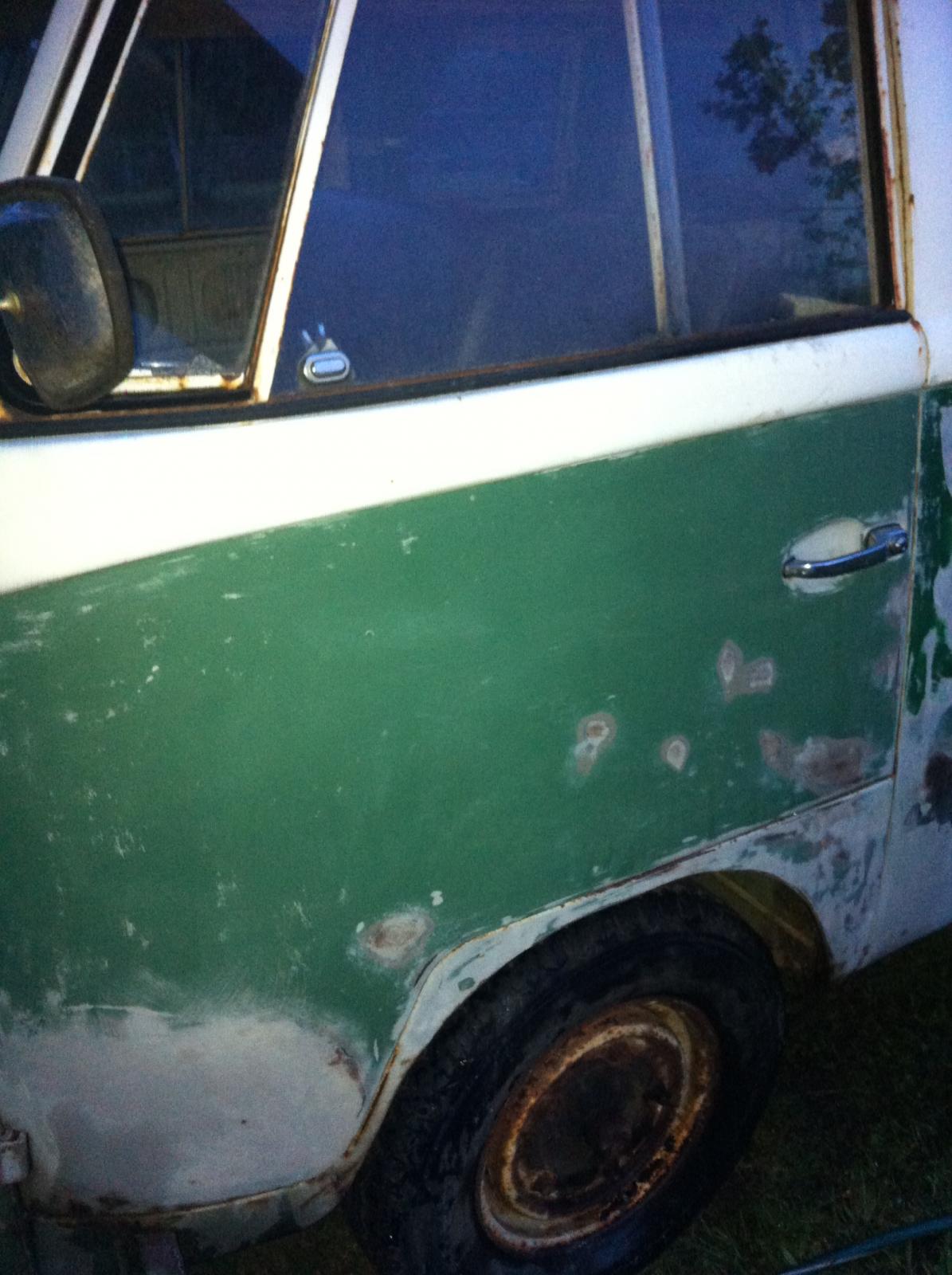

PostPosted: Sun Jan 11, 2015 2:33 pm    Post subject: Reply with quote
What's the color of primer? I started with the Graffiti remover to get off the primer. I then see a brown and black and the original Turkis. Not sure if the brown/black is primer or another paint job.

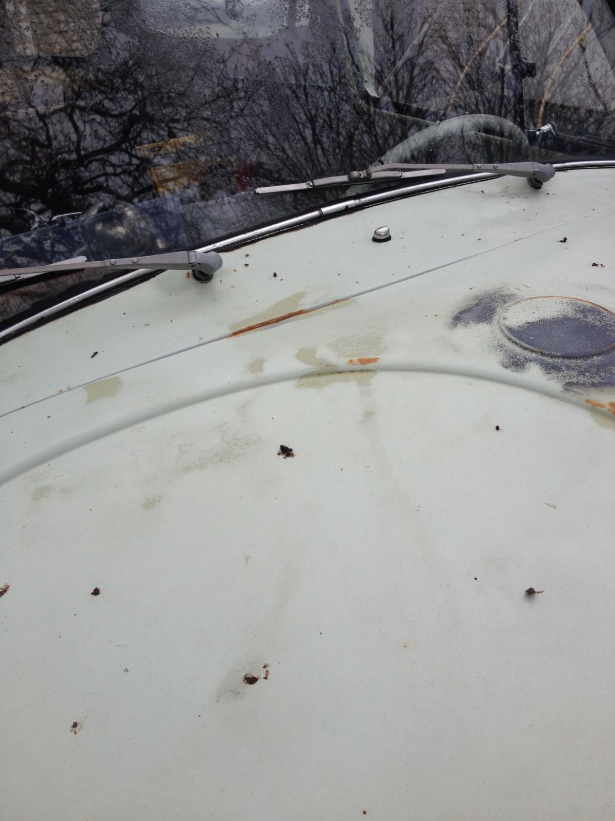

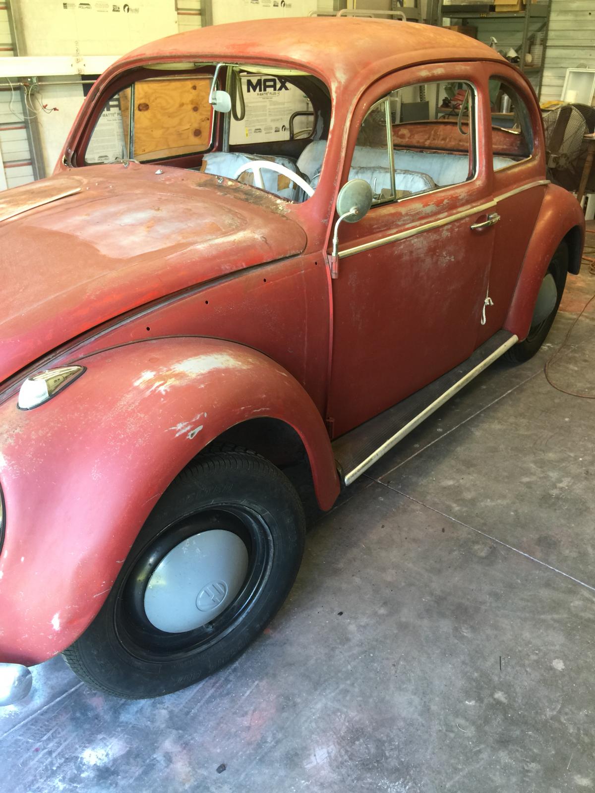

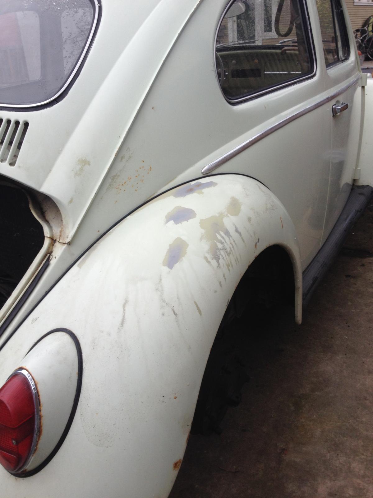

Looking for some advice on my 63 Ragtop project.
I figure for now I will keep it as itd sits until I have it completely mechanically sound and a happy daily driver, just curious for the future, what you all might think on uncovering the OG paint.
All panels on the car are original, each panel has at least a few parts where the respray (A ok/decent home paint job, done in the 80's) shows through to the original Beryl green paint.
From what I can tell, the grey primer shows through a moderate amount. Im guessing the car was sanded to prepare for respray.
Looking for thoughts and advice.

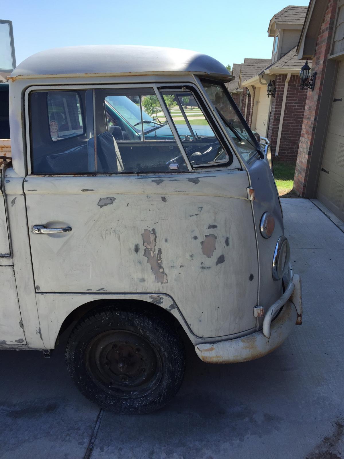

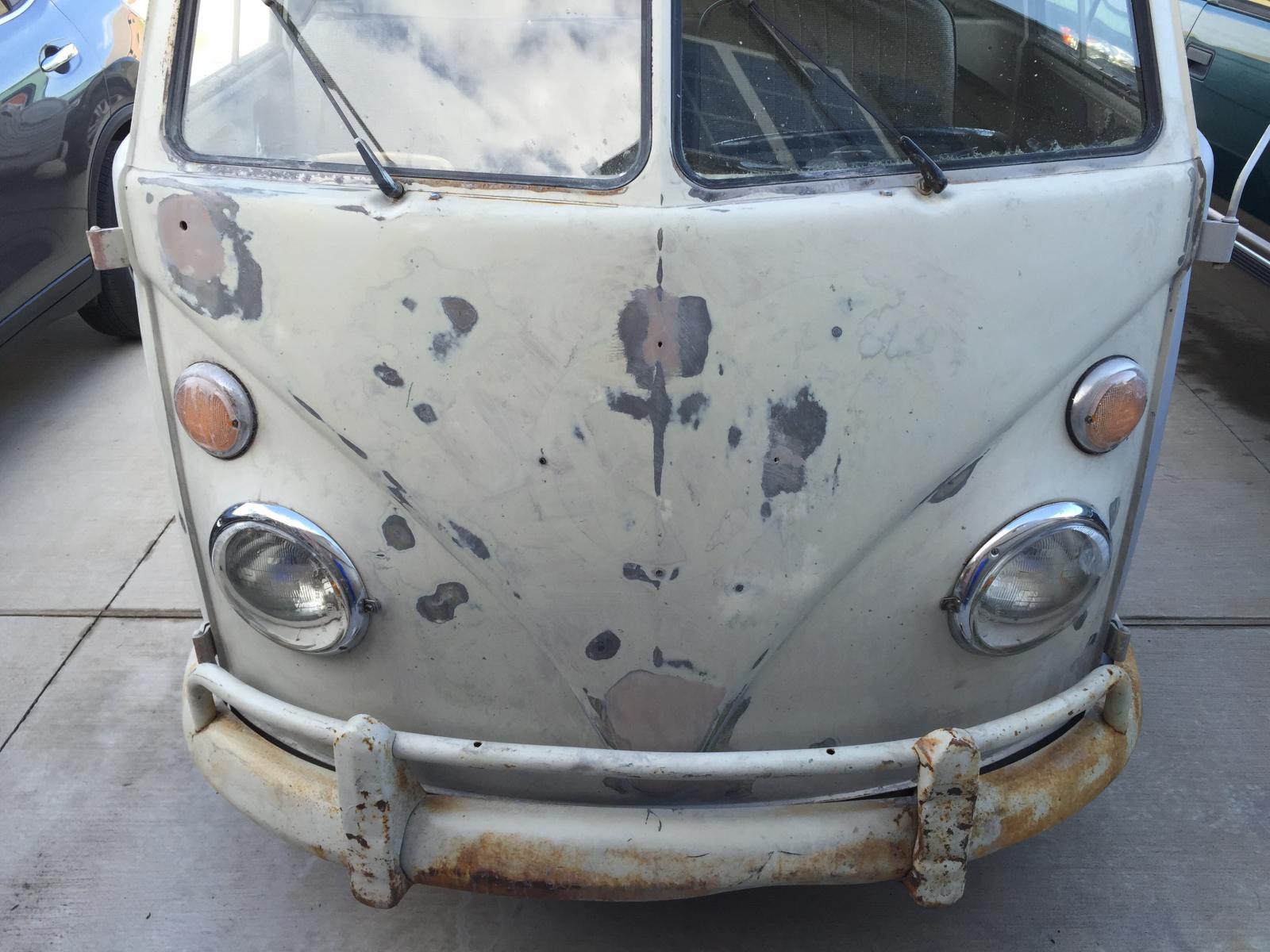

PostPosted: Tue Apr 21, 2015 4:08 am    Post subject: Single cab loosing its spots Reply with quote
Graffiti remover , 0000 steal wool & couple hours of elbow grease
Coming off a whole lot easier than I thought

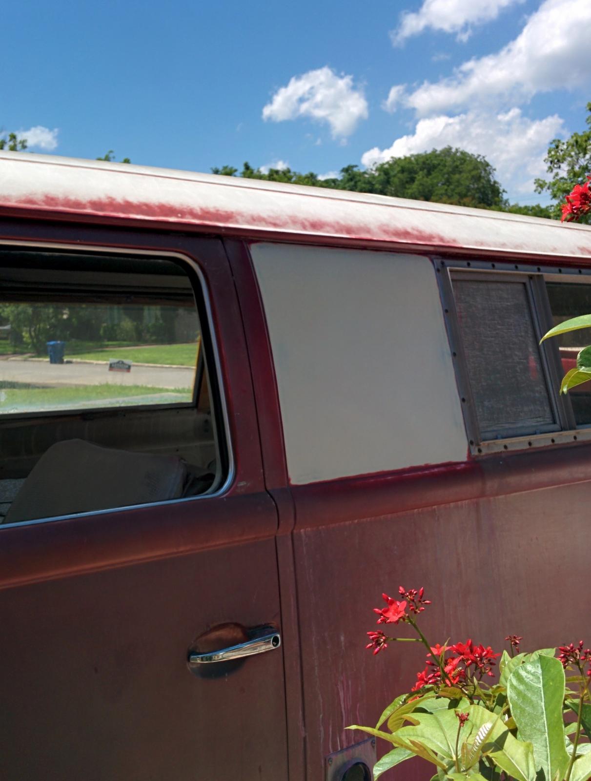

PostPosted: Mon Apr 27, 2015 12:55 pm    Post subject: I think this paint can be saved Reply with quote

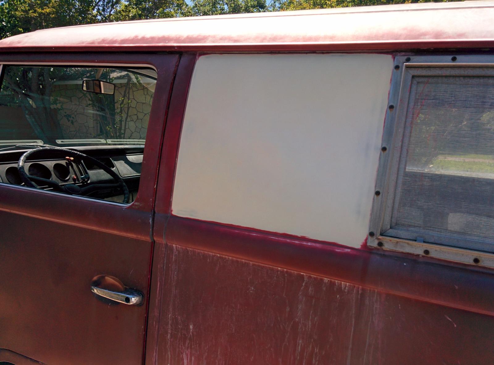

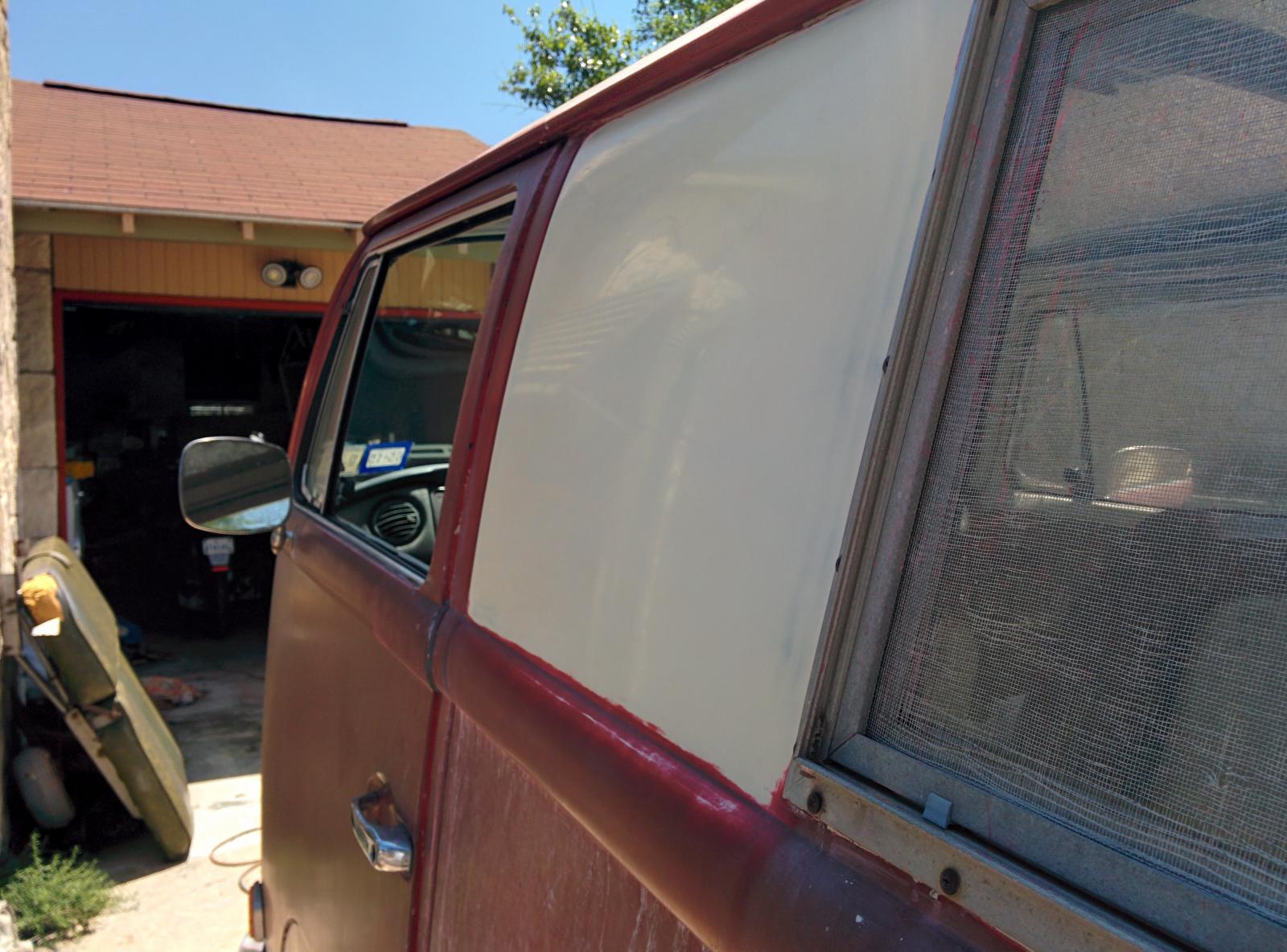

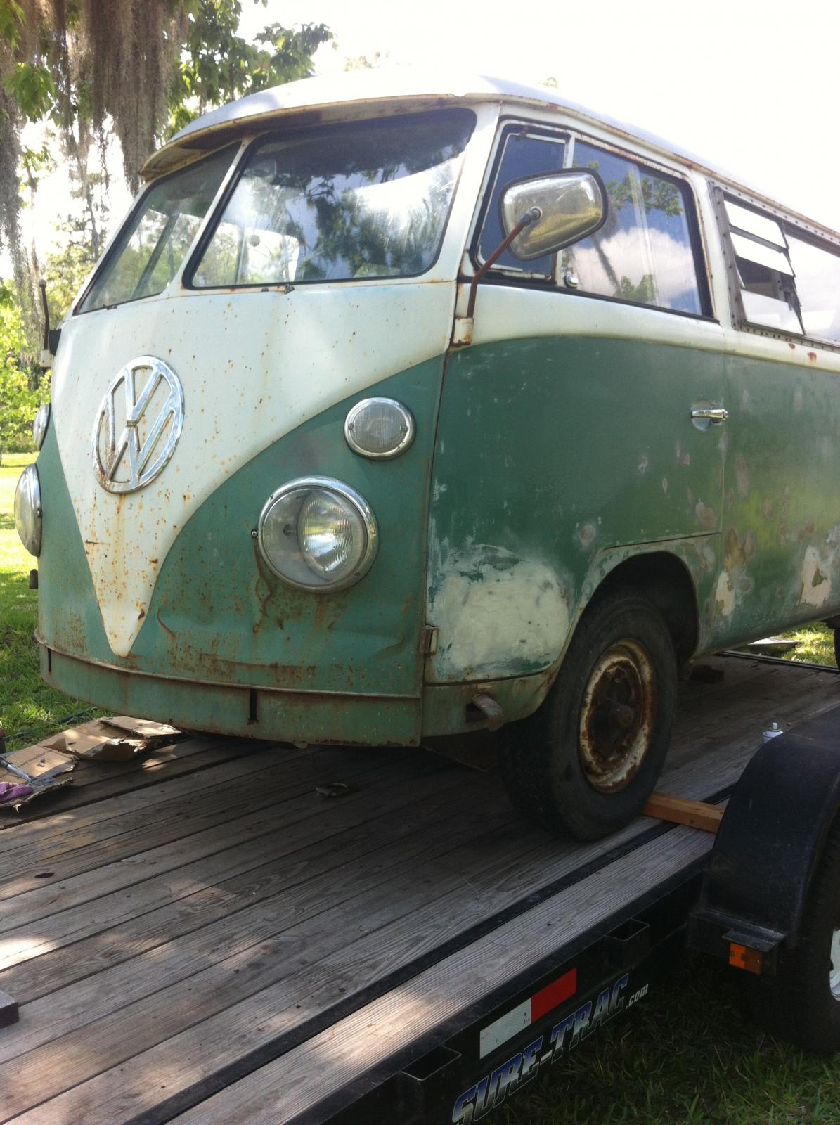

Hello,
I've been reading this thread and was inspired to find out what's underneath what looks like a cheap rattle can paint job. I decided to do a test spot to see how hard it would be to remove the shitty paint, how long it would take, and whether the paint underneath looks any good. I used 600 grit wetsanding, followed by 1500 grit, and some rubbing compound, followed by sealant. I think there's definitely potential here! What do you guys think?
71 Sundial Camper

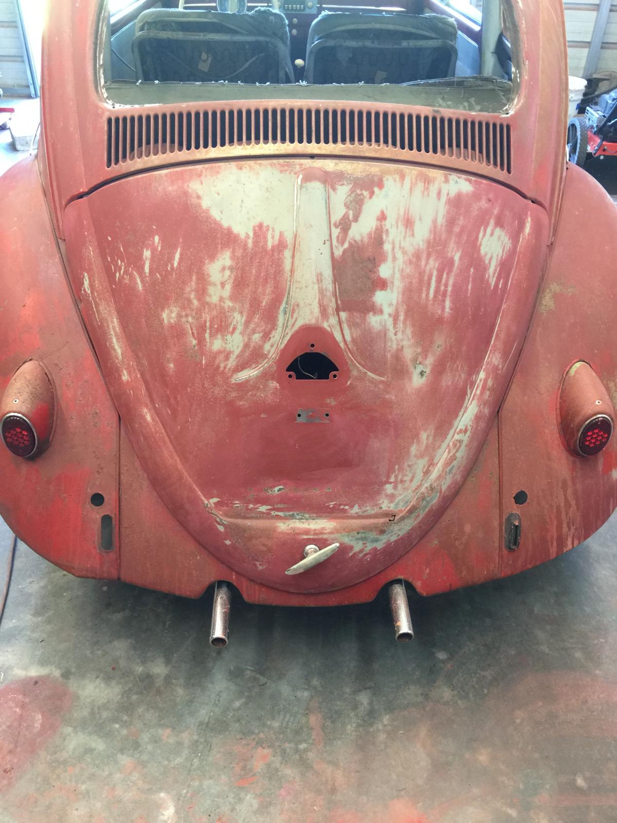

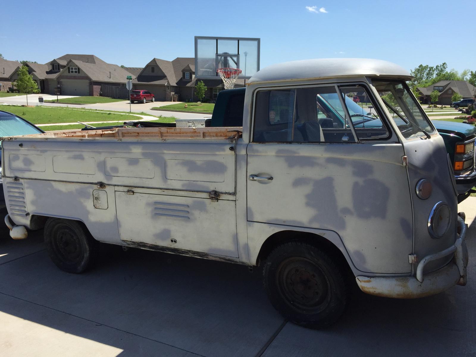

PostPosted: Wed May 06, 2015 6:28 pm    Post subject: after stripping the paint Reply with quote
What should I do after the crap paint is off? The og paint is a bit dull and was wondering weather to buff the paint or not.
Posts: 71823
PostPosted: Wed May 06, 2015 10:30 pm    Post subject: Reply with quote
Yes, buff it out.
