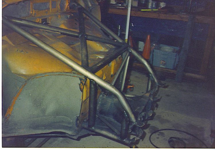

I sawzalled mine with the body in place, approx 3/4 " fwd. Then I welded a piece of 1/8" strap, 2" wide to to bottom of the pan, the width of the frame head, 1" under the pan and 1" protruding for the frame head to rest on. Makes it alot easier to square up with the frame setting on that piece of strap and it adds some welding surface. Then I tied the cage to the beam, I went stock wheelbase per class 5/1600 rules. Heres a pic I stuck in the gallery, hope it helps.

PostPosted: Wed Aug 24, 2005 4:22 pm    Post subject: Reply with quote
Nicely done.

Uncle Dirty--Do you have a website with more pictures? Everytime I see one of your pictures, I see great ideas for my project. I would like to see more!

I'm glad you like my car. I don't really have that many pictures, yet alone a web site. I'll post what I do have in the gallery.

That would be great. I dont know if it just your photography but for some reason your pictures are very easy for me to see what you have done. Thanks Very Happy
That is exactly what I want!! Shocked and am trying to do but with the stock size warrior beam it is really hard to find a place for the clamps to go on by the steering box.
