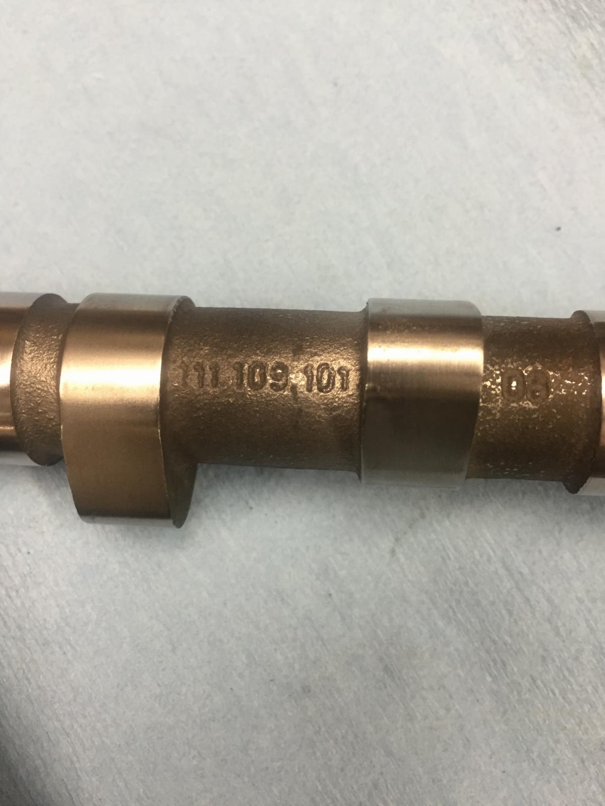

Well I know I'm in the 53-57 forum but felt question would get a better answer here . Found a new motor for my 58 which is 3 weeks off build date of car . One I'm using is a 1956 motor . Split case and found cam is worn on one lobe and followers also . Will get new followers but I have a cam that I think will work the one on right in pics . Will remove gear and rerivet It to cam . Lobe hight is the question can not find lobe dim. Have three cams and find lobe overall dim. The same within .003 or so except for worn lobe cam .cam gear is a -3 so will use it with the case . Also what's up with the rear main bearing being drilled ?? Found this on a motor I split also on a motor I split years ago? Case pin is fine and is not oval.

I recommend you talk with Matt at www.aircooledresearch.com
He can regrind your best cam to his Stage 1 or 2 specs. Go with straight cut gears and the gear size issue goes out the window. I run straight cut gears on my 36, no whine noise.
