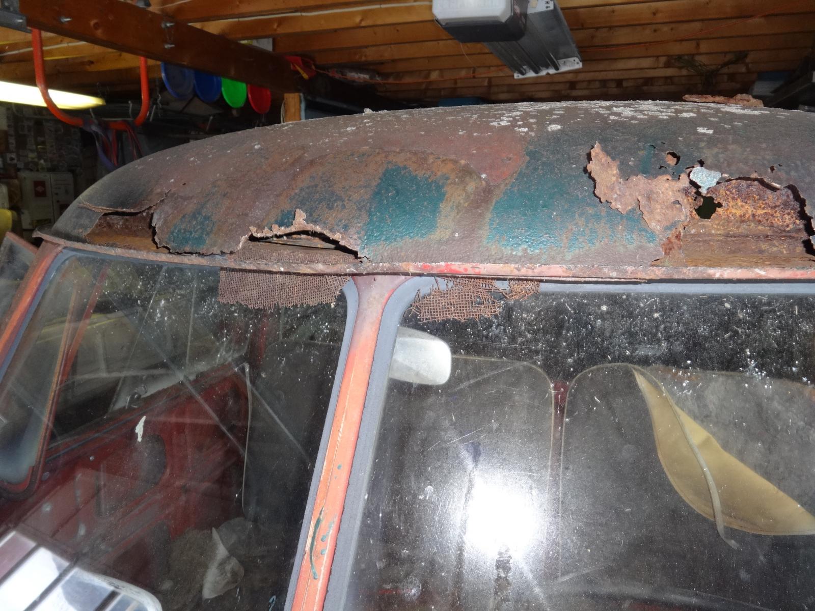

Holes in the roof suck too.... Sad
Read as much as you can here on The Samba, read the "Stickeys" Read peoples Build threads. As Mandraks said, check out Klassic Fabs (Refered to as The Funky Greem Metal) Price list to give you a start on what that Floor/Rockers/nose ect. will cost. Body/Metal work is really pricey if you can't do it yourself.
READ !! Laughing

PostPosted: Wed Apr 13, 2016 4:21 am    Post subject: Re: New guy needs some advice please Reply with quote
I see you are in Indiana as well. Rust is the biggest problem you will find here obviously. As previously mentioned, look underneath it, the bottom of the bus should be your main focus. The main frame rails are especially what you want to be free of any rust through. The body panels/rockers/doglegs and all that can be repaired with replacement metal, so not a big concern unless you do not want to mess with welding in new metal. Also like Crukab pointed out, the roof is also a major problem area and a real nightmare if it has rust issues. Best thing I can suggest is either take someone who is experienced with VW's and/or buses and have them inspect it with you, or post some pics of the bus (focus on bottom side of it and roof/gutter rails). I am also in Indiana (North-west'ish) and I may be able to go look at it with you if you want, I have no interest in it as I already have a bus and no desire for another one so no worry about me trying to snag it from under you. PM me if you want my help. Either way good luck & post some pics!
