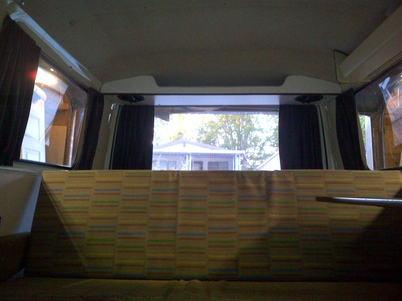

Posted: Tue Nov 04, 2014 2:14 pm Post subject: Re: Anyone make a Rear speaker shelf? |
RocketBox wrote: |
My van has the wires dangling from the ceiling where the rear speakers should go, but no speaker shelf to mount the speakers into. Has any fabricated their own or have suggestions on how to mount some speakers up there? Thanks! |
I did, here are some pics:
Hard to explain how I mounted it but basically it involved carriage bolts, "L" brackets (bent to shape), and carefully choosing 4 places to drill some "non stock" holes in the metal. Make sure you don't drill any holes that go through the actual outside wall/ceiling...
Full visibility out the rear window and way less "headbanging" going on! Dependent on what's queued up on the stereo of course...  _________________ 1981 Vanagon, Aircooled 2.0 AFC

Posted: Tue Nov 04, 2014 2:29 pm Post subject: |
yeah - those look good! are those 6" speakers? better to face them down or forward facing? also, what board did you use? looks good! Did you make a template for the curve first from cardboard? looks like a really good match. _________________ 84 Vanagon - tintop, 1.9L wbx. Complete Rebuild done August 2014. 2000~ miles on it so far... SOLD

RocketBox wrote: |
yeah - those look good! are those 6" speakers? better to face them down or forward facing? also, what board did you use? looks good! Did you make a template for the curve first from cardboard? looks like a really good match. |
Thanks!
I have a background in audio engineering so I should know better but my other design goals made me choose down firing instead of forward. Had to decide if I wanted a stereo with a camper built around it or vice versa.
They are 6" but you could easily fit 6x9 with no issue. Facing them forward will force you to increase the front height and therefore lose rear visibility and headroom. They sound pretty good there though... I have stock speakers in the doors that I blend in just slightly to make up for some of the "harsh & tinny" sound that is missing when the rear speakers are facing down.
The whole thing was mocked up in cardboard first then assembled using white MDF. This itself is supposed to be the mockup for a real birch version but now that it's up I'm pretty happy with it and might move on to other projects. Figuring out the roof curve was one of the hardest parts and was accomplished through much trial and error. No measuring tools or skills I possess could help me so I just kept cutting cardboard until I got it right. _________________ 1981 Vanagon, Aircooled 2.0 AFC

Posted: Wed Nov 05, 2014 6:05 pm Post subject: Re: Anyone make a Rear speaker shelf? |
a2d2 wrote: |
Full visibility out the rear window and way less "headbanging" going on! Dependent on what's queued up on the stereo of course...  |
Are the speakers in any kind of enclosure? If not, the out-of-phase sound wave from the back of the speaker will cancel the sound from the front, causing a very tinny sound (and less "headbanging for" sure).
Although, I notice now that you have a background in audio, so I'm sure you already knew that! _________________ Now:

Posted: Thu Nov 06, 2014 1:40 am Post subject: Re: Anyone make a Rear speaker shelf? |
ChilliConCarnage wrote: |
Are the speakers in any kind of enclosure? If not, the out-of-phase sound wave from the back of the speaker will cancel the sound from the front, causing a very tinny sound (and less "headbanging for" sure). |
A good point, and from a theoretical perspective pretty spot on. In practical application it doesn't seem to be an issue. I think having them off-axis is a bigger concern but it still sounds a lot better than when there were no speakers back there.
I considered enclosing them but once I took a listen to them in the first plywood "proof of concept" mockup I was happy enough with the sound to stop there. I know just enough to know that improper porting and cabinet dimensions could just have easily made things even worse... and it would have been more work... so I took the easy way out!
The MDF front panel likely shields enough of the sound from the rear to minimize the phase problems and I do keep my rear hatch bug screen and front curtain stuffed up there as well and that probably helps. _________________ 1981 Vanagon, Aircooled 2.0 AFC

Posted: Thu Nov 06, 2014 8:08 am Post subject: Re: Anyone make a Rear speaker shelf? |
a2d2 wrote: |
RocketBox wrote: |
Please, could you post more pics of the install, if possible from the back.
I was thinking about something like that (not for speakers but now it makes a lot more sense....) and your mod look really nice and clean.
Thanks _________________ 86 Syncro Tintop G60

Posted: Thu Nov 06, 2014 10:56 am Post subject: Re: Anyone make a Rear speaker shelf? |
This is a nice idea!
And if you wanted to keep the high frequencies forward facing, you could get a component speaker setup that has separate woofers/tweeters.
Just mount the tweeters facing forward, and the woofers as a2d2 did.
You could also easily enclose each speaker area with a small vertical piece next to each, still leaving the large middle section open as a shelf.
This might be a good idea anyway, as it would keep the backside of each woofer protected.
