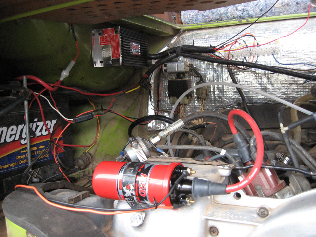

I've used the Blaster 2 coil on my westy for a couple of years now. Never a problem. I've used it with a Summit Racing CDI (aka Mallory Hy-Fire - which you know all about), and my present use is with a MSD 6 unit.
I also used a MSD Blaster 2 coil on my '68 Firebird with MSD 6 for about 15 years (sold car 3 years ago), no problems, which is why I use one now on my bus.
Darryl
'78 Westy, Boston Bob built 2.0 L, FI, MSD 6A

Do you have a ballast resistor between the coil and your ignition (points or electronic)? I don't think you need too with an electronic ignition. Just Curious.

No - no ballast resistor.
Darryl
