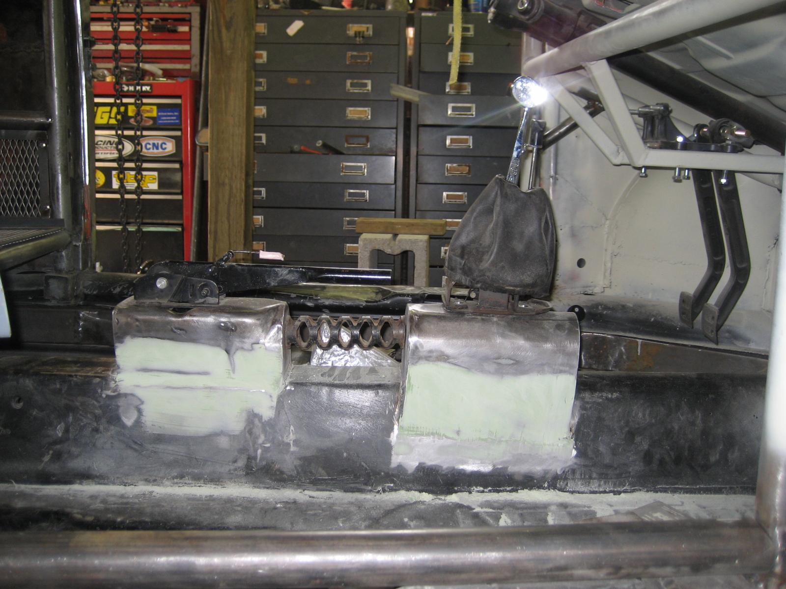

Thanks, i will look at them. I was considering the bugpac shiftright but was told it only bends back about 2".
In the photo below you can see how i raised the shift plate and brake plate. The body has a 3" lift and 3 rib trans.After mounting the seats i realized i should of moved the shifter back.
Anybody know how far back the Early Scat handle is bent?

PostPosted: Tue Apr 28, 2015 11:55 am    Post subject: Reply with quote
Is that a steering coupler I see between your shift box and P-brake box???
Brian H.
OrangeCrushERBerrien Warrior-2.4L Quad4-2x3 arms-1.5Fox coilovers-094-930CVs
LAZY MARY1970 Baja 2110cc-82mm CB forged crank-AA pistons/cylinders-Grant rings-1.1 vw rockers-CB serpkit-CB chromoly PRs-CB maxiflow filter pump-wix51515 filter-Dual 44IDF-cut/turned front beam-AEM wideband-Auber CHT-Donaldson Dual PowerCore filters-custom AL air boxes
DWP
Joined: September 11, 2007
Posts: 577
Location: Pa.
DWP is offline
PostPosted: Tue Apr 28, 2015 12:12 pm    Post subject: Reply with quote
Yes I was having a little fun with design. The shift rod itself runs inside the steering part and out the back and to the trans. I have to stop looking at Steampunk sites!!!!!!!
