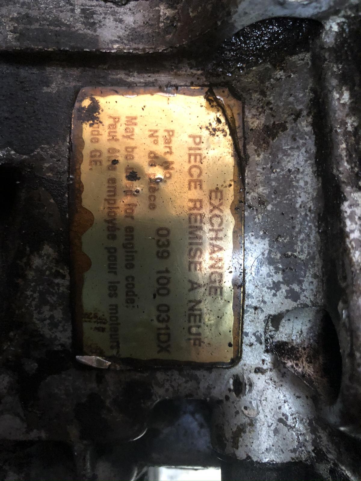

Turning to the historians here to better understand my bus. I made some discoveries while working on it and have myself a little confused.
I have a 1979 Riviera that come from Portland OR to the east coast 10 years ago. In working on the engine I found to stickers from VW implying the engine was rebuilt by VW of Canada. As best I can tell this is where official rebuilds were done.
I have to assume this is a different core than originally come with the vehicle? The M Code says I have a GE engine, but I suspect it is perhaps a GD now (per of my confusion).
Does anyone have better Information on the official VW Remanufacturing process?

You are correct. VW replaced it with the same specs as original. 2.0 FI with hydraulic lifters. As far as I can tell everything about the vehicle is stock original with only the exception of the remanufactured motor. Which of course matches the original production specs. Though I am not really concerned about stock authenticity or matching numbers I am glad to have an unmolested specimen to work with. (No P.O surprises)
Honestly I am just interested in learning more about the process VW used and notice not much was documented about remanufactures in the forum.
Anyone know what the sticker # means? Did they simply ID rebuilt engines in sequential order?
What are the differences between GD and GE? ( however minor)

Its a big blur, between some GD and early GE engines there were virtually no changes at all, but between the earliest and latest GE engines there were some substantial changes, like the switch to hydraulic lifers and a difference in the exhaust port design.

VW North America had a remanufacturing plant in Scarborough, Ontario which is a suburb of Toronto. Until maybe the mid-90's you could go to the VW dealer and buy a remanufactured engine, so these would get installed either by a dealer, independent shop or individual. They are all serialized. I think these engines were shipped all over North America, I've only ever seen the VWOA stickers that say the engines were manufactured in Canada.
The VWOA remanufactured engines have a spotty reputation. You'd think perhaps that if they were supplied by VW they would be top quality but this is not always the case. They churned them out and I don't think this facility did the greatest work. Not terrible either.

Some differences listed here:
https://www.thesamba.com/vw/forum/viewtopic.php?t=470486&start=0

Looking at that thread, there is a mention that GD were all dual port. All the GD I have seen are single port. Some solid lifter and some hydraulic lifter. There is a change VIN and engine number but I don't recall where I saw the bulletin.

Well. I am glad I asked about this. I definitely have a bunch of research and investigation to do. I had assumed many of the attributes based on the Mcode and model specs, but perhaps that was far to presumptuous.
I have always simply trusted that things were correct for the model year (even after realizing its a rebuild), but clearly that may not be the case. I’ll have to determine if I have hydraulic lifters and what kind of ports?
I have been lucky enough to enjoy the bus without too much work until a recent fire (I know you guys probably hate to hear that, but there no time like the present to start deep repairs). Replacing a FI harness is quickly turning into a total refresh. 😀. Life in pandemic times has some benefits after all!
