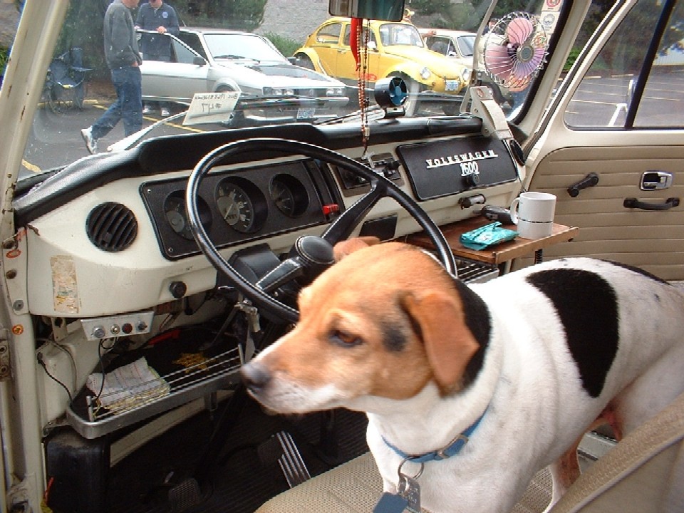

Here is another one. There are factory holes in the passenger side for switches for rt hand drive models. They could easily be plugged with something. I think it is a great way to utilize an original dash and not toss it in the trash. It only takes about a half hour to strip the padding, longer to strip adhesive and sand/paint. Fun project!

There was a recent thread about this. From what I have seen, European models may have come with the steel dash with no padding. If you look close at the Bentley manual, you'll see the white westy with a steel dash.
Warning: before you decide to strip the vinyl and foam from your dash look at the backside near the corners. There are vertical slotted holes in the american dashes under the air vents. The cut out areas will need to be filled. I converted my first bus by getting a used dash from the junkyard. This allowed me to strip, fill holes and paint while still driving my bus daily. It's an easy swap (couple of hours) if you're ready ahead of time. To fill the slots you'll need to weld in new metal or use a lot of bondo!

The glove box bolts right back on, regardless of padding. With the door on it looks just like the gauge panel.

You can still use the glovebox door on a stripped dash, they were not always equipped with them on the euro dashes though. Here's one I shot locally:
The early dashes don't have those vertical slots, but the later ones do. Various other holes still remain however - one in the center under the radio, a few others on the pass. side, etc.
