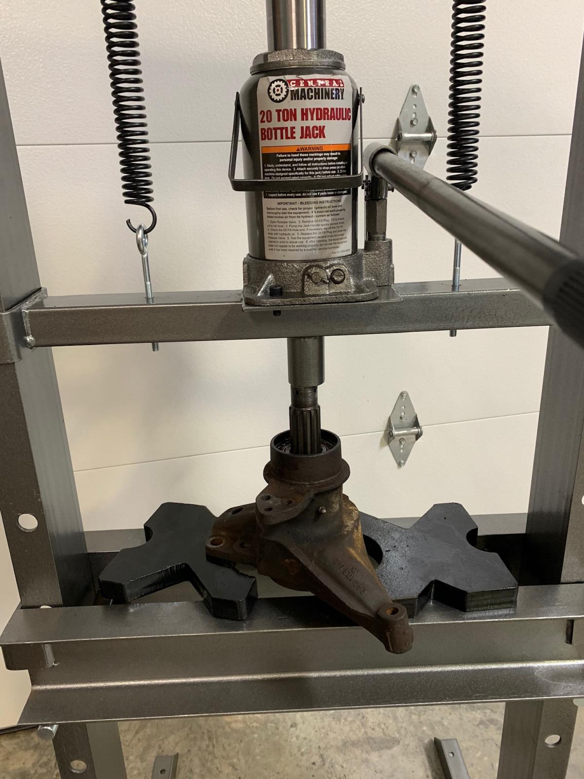

Brought a 68 Campmobile home a few weeks ago, so happy to have a bus again. Very Happy And, all it needs is everything.
I’ve disassembled the passenger rear stub axle from the bearing housing and all went pretty smooth. However, the driver side stub axle will not succumb to the hammer. I’ve tried copious amounts of map gas heat to the housing and had the axle nut flipped and screwed on flush to allow fairly large rasps with a 5lb hammer. Will not budge.
Any other tips? I’ve read every thread on rear bearing replacement, here and on IAC, and it seems most stub axles aren’t frozen to the bearing stack like mine is. Remove housing and take it to a press?

maybe. Sounds like water got inside. If you remove the hub be sure to mark the spring plate top and bottom against the hub with a fine mark so you can align the marks when done and not affect alignment.

I think you’re right on water intrusion. I thought about renting a big puller, Harbor Freight was on the way to parts house..... brought a 20 ton press home. I’ve needed one for far too long anyway.
Alignment marks made and bearing housing off the bus. Once I get this press put together, hopefully it forces it on out. I’m preparing myself to hunt down an early bearing housing and stub axle if it’s as bad as it seems. I’d imagine the housing will be in rough shape if water has sat inside?

Press was the ticket! Axle was definitely frozen inside bearings.
Of course the stub axle needs cleaning up or polishing, but those of you with the experience, does it look serviceable?? Housing looks ok, a little rust just inside of inner seal area that I’m sure will clean up.
