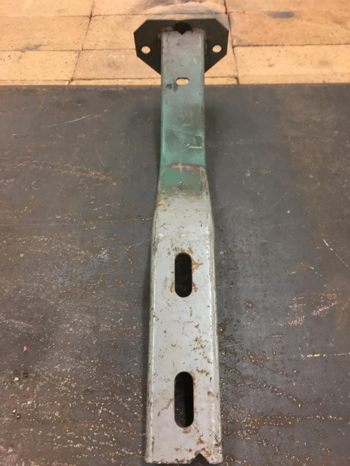

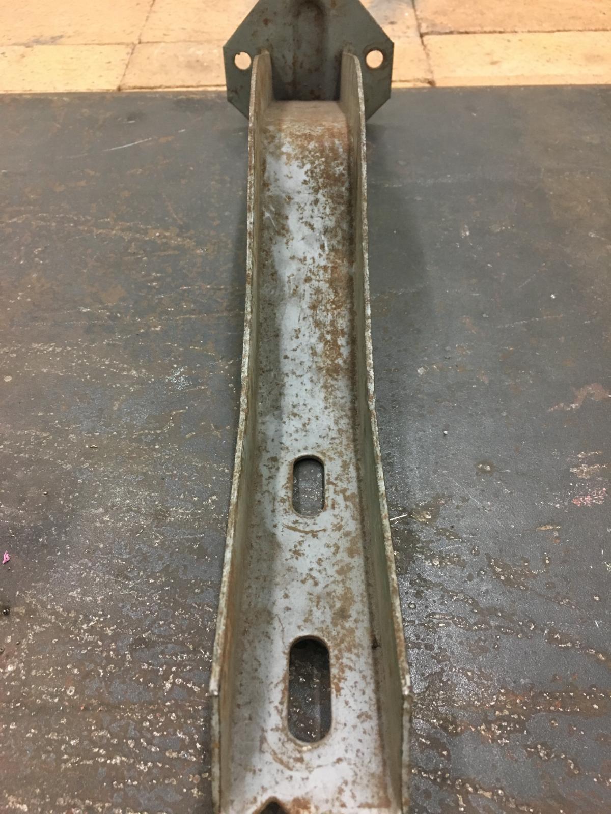

I have one NOS rear bumper mount and one original that was on my bus.
The other original to my bus is all bent up and has been welded back together from a previous hit. It was poorly fixed and is just not right.
I was getting ready to media blast them and I noticed the NOS is slightly longer than the original one by 1/4". NOS one is the gray one, the black one the original.
Am I correct to assume that since the holes to mount the brackets are slotted, it will be ok that one is slightly longer by 1/4"? I can just mount the longer one 1/4" back so the brackets are even?
hitest
Joined: September 30, 2008
Posts: 10323
Location: Prime Meridian, ID
hitest is offline
PostPosted: Wed Sep 11, 2019 3:30 pm    Post subject: Re: Rear bumper brackets Reply with quote
Your black bracket has had a little bit of a parking lot bender- indicated by the slight flaring at the rearmost bend. The silver one is quite straight- and as a result, does not sit flat on the bottom of the screen- lower left. Clamp both of these brackets side by side to a bench and you'll quickly see they are not parallel on the middle transition or the final straight section at the bumper bracket- then measure and compare the widths of the flared bends. Sometimes you can use a vise and mash those flares a little closer and undo the accordion-shaped damage to the bracket. If you can straighten the black bracket it will come closer to the silver as a match.
Also, the silver one is not NOS- they did not come from the factory with washer scratches. Wink

Spitty1974
Joined: September 30, 2011
Posts: 647
Location: California
Spitty1974 is offline
PostPosted: Thu Sep 12, 2019 12:26 pm    Post subject: Re: Rear bumper brackets Reply with quote
Thank you for the tip about straightening it out, I'll try that now.
Just an FYI, it is a NOS bracket. I bought it from a reputable source on here who has sold thousands of parts to many customers. I know for a fact he would not try to pull the wool over my eyes; he's an honest, well respected fella.
You can still even see a blob of weld in one of the holes where a bolt has never even been put through the hole with factory gray on it. What you thought was washer marks is just surface rust from age.

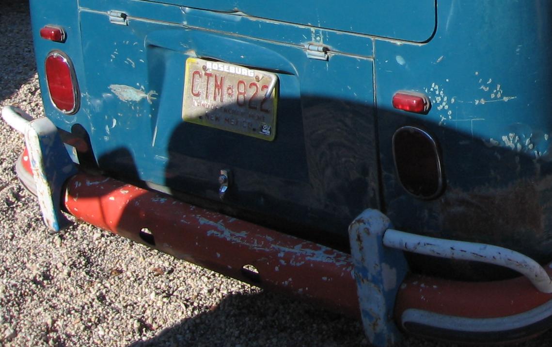

PostPosted: Fri May 13, 2022 10:01 pm    Post subject: Re: Rear bumper brackets Reply with quote
Weird, I don't remember seeing those Vs before but I may have forgotten.
I have this old pic of rear bumper brackets with the hanger and I don't see the V on them
I don't see it in this photo of my restored original '64 Bus rear bumper either
richierich
Joined: December 23, 2004
Posts: 912
richierich is offline
PostPosted: Fri May 13, 2022 11:43 pm    Post subject: Re: Rear bumper brackets Reply with quote
I think it is there if you look really closely
Blah.....
Posts: 71422
PostPosted: Sat May 14, 2022 12:58 pm    Post subject: Re: Rear bumper brackets Reply with quote
You are correct, I looked at some of my old detailed and larger photos and it's on that one bracket but not the other one.
Weird... I would be surprised if anything was replaced on that Bus as it was low mileage but it's always possible.
